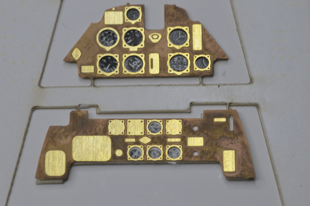

First up was the instrument panel..
The kit part is nice but its quite small and the kit doesnt include decals for it. I decided to buy a PE set but this was pretty poor as well. Incidentally although marketed as HGW, once unwrapped its all marked Eduard.

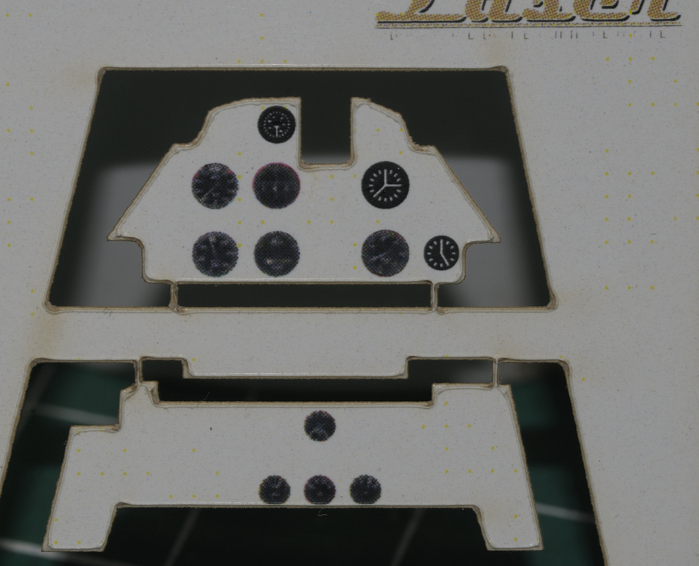

The dial have not been printed very well... or at all in :) I did comment about this too #Hannants and they said, they had looked at the others in stock and they are all the same but it wouldn't notice on the finished model.......well if it wouldn't notice, why sell them :) They did in fairness offer a refund.
I gave it some thought and i have some individual decals from airscale so i decided to use the parts above as a template and simply put new dials over the old and then give them a coat of future to fix them...
First test fit showed......i had got some dials all crooked and some just didnt line up.lol :) Come on Paddy, pull your finger out ....

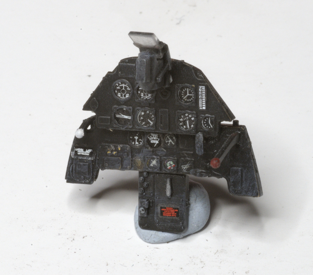

Anyway the 2nd attempt has worked and i now have a passable instrument panel
Bit rough round the edges but that is intentional

Passable?!! Your idea of passable is very similar to my idea of spectacular! That looks frikken awesome my friend.
