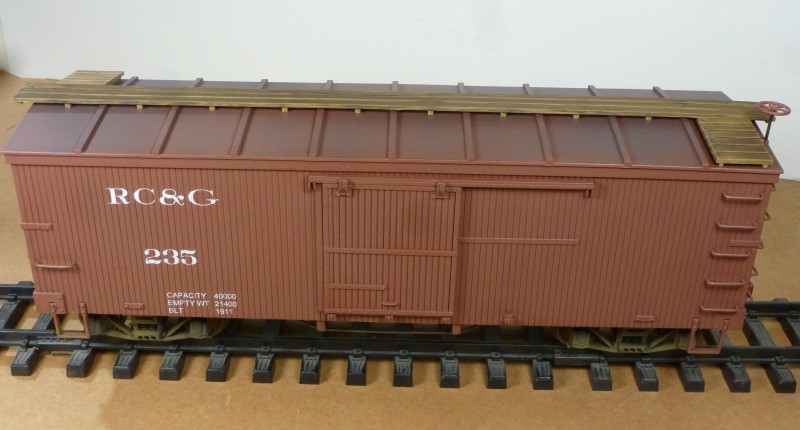

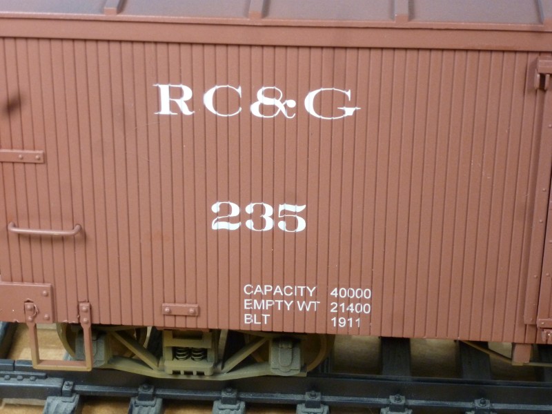

Some of my train fun will have benefits for aircraft modeling when I'm ready to hit the bench again. The boxcar shown below was recently painted and lettered. The road name and number were painted using stencils cut on my Silhouette cutter, nothing new there but the data lettering was printed on my laser printer using a white printer cartridge. It was printed on Micromark decal paper and set with Microsol due to the heavily scribed surface. The printing got one light coat of Testors decal set. The sheet was the first print on decal paper, I did one test print on black paper first. I was impressed, opaque even on the rather dark surface of the car. For reference the car is 1/24 scale, about 16" long and the font size of the data is 12 point, about 1/8" high.
Uh...as an old school laser printer repair guy I gotta ask. What laser printer has white toner? :geekon:
