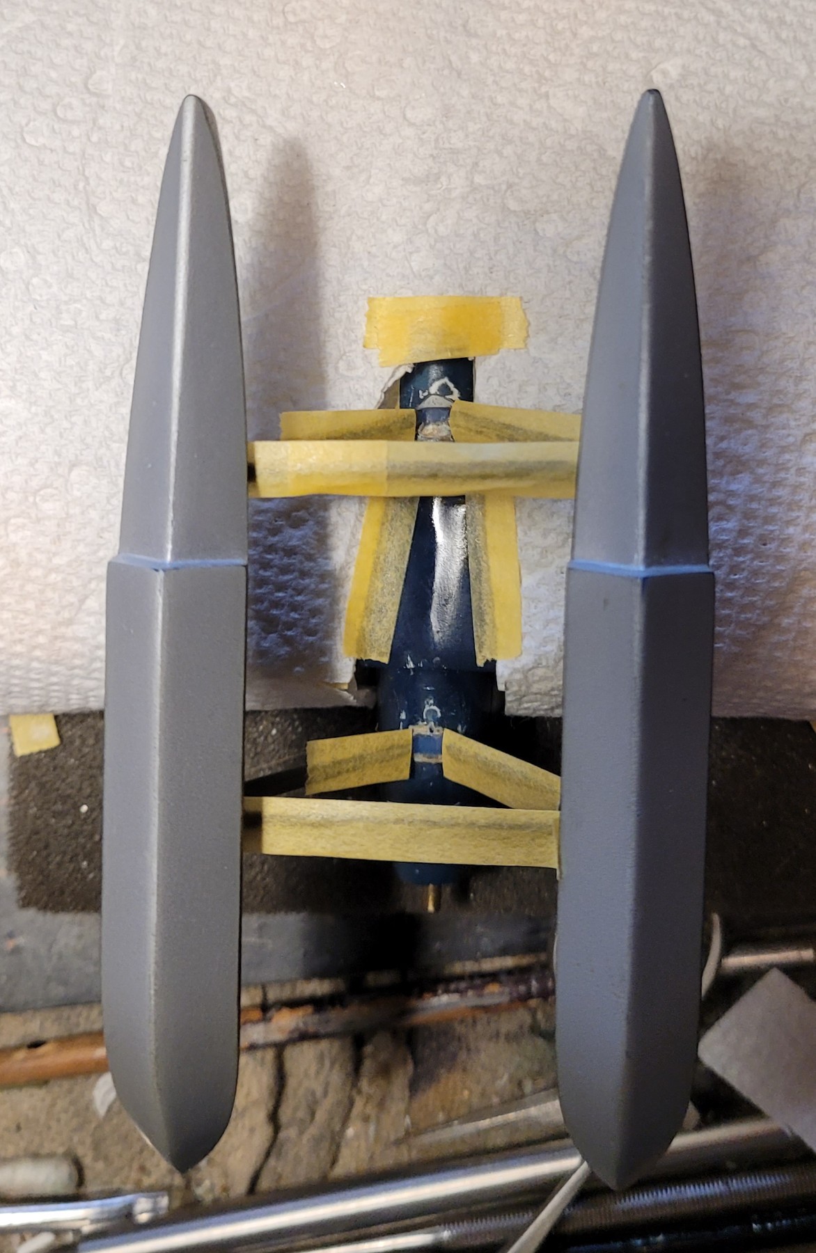

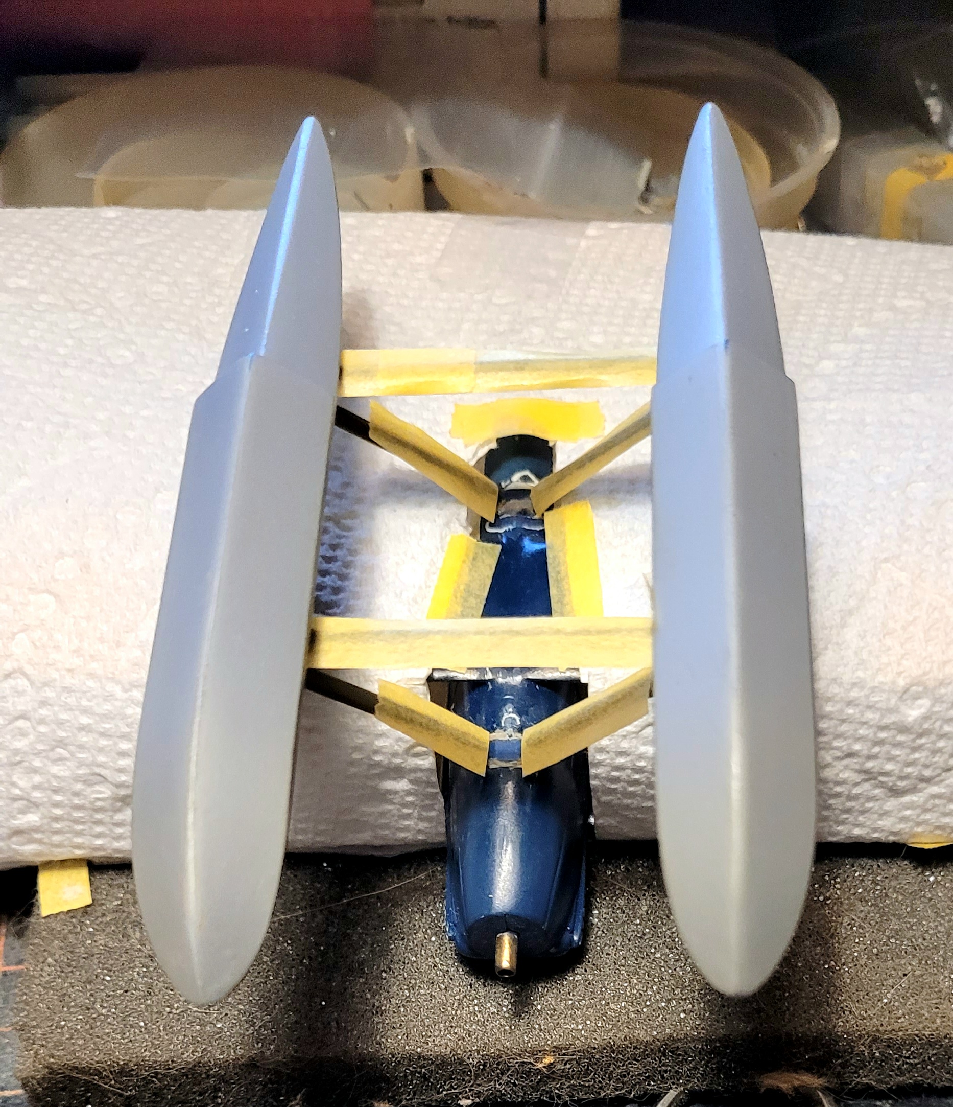

Yep! Rigging! I started by making 4 of these:

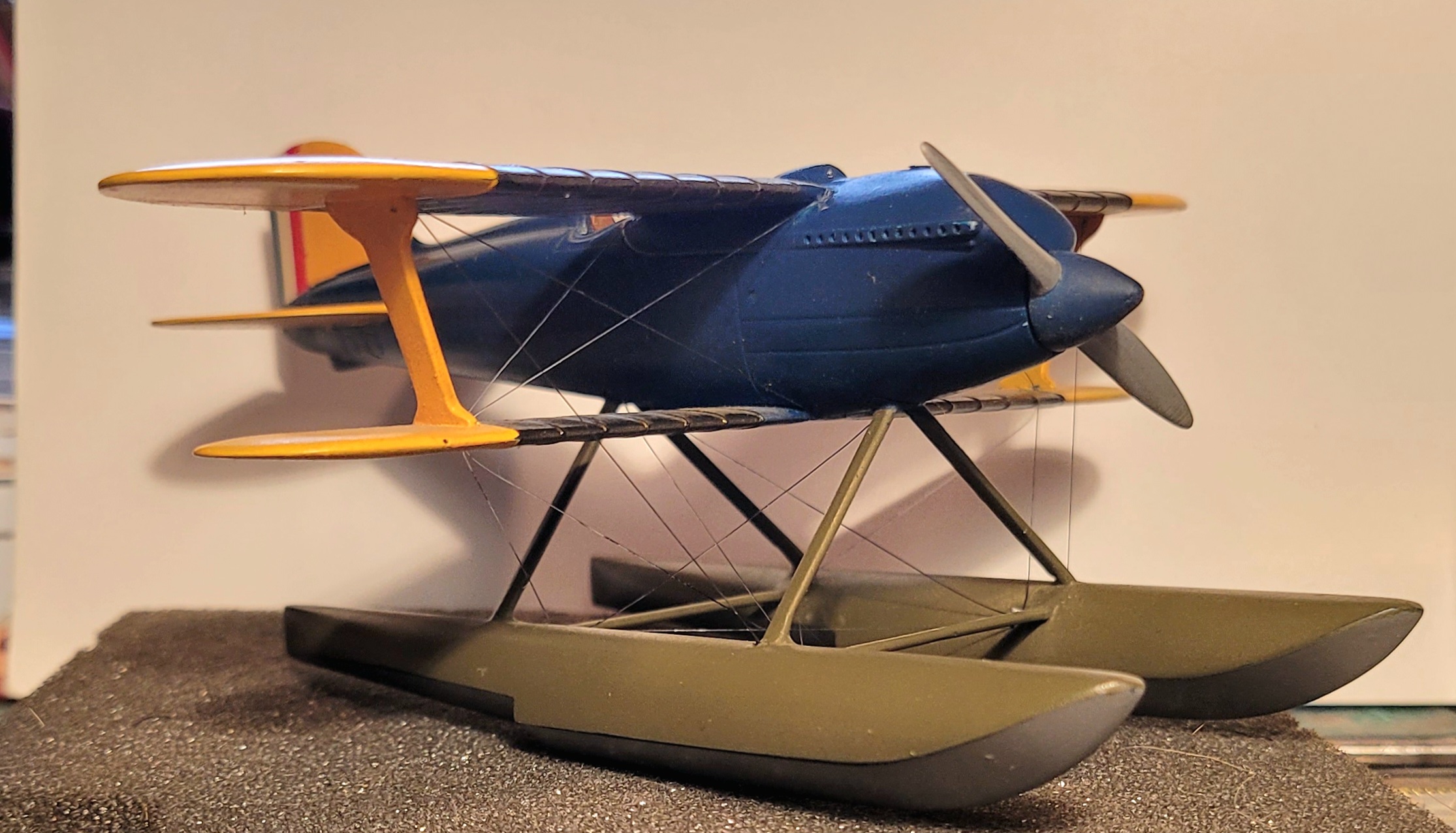

A teeny bit of ship rigging experience helps here. The Uschi stuff is springy, so I untangle every time it "BOINGS"White paper & good lighting is a MUST!
Insert the point end into the float, I drilled a .070 hole, which is plenty big for this dinky stuff! Ran it thru a similar hole in the wing strut, then doubled back, so I have plenty left to attach to the lower wing. 1 piece, 2 wires!! see?! Pull a bit of tension, then a little dab of CA glue to fix it.

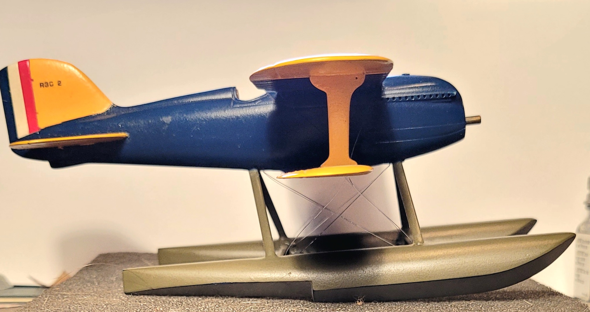

Uschi fine rigging stretches! Lookie!!
Spings right back in place! Handy, but not without it's foibles.
Swipe of a sharp hobby knife, and the left over double-back is GONE!!

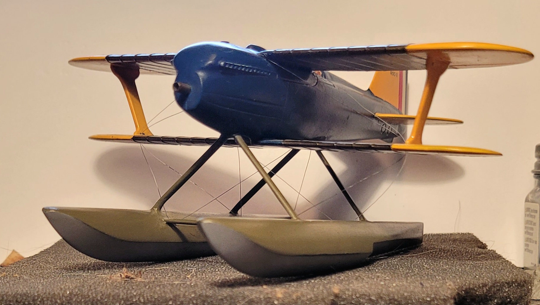

Umm.....They look like they snug up nicely!![]()
Cigarette smoke snugs invisible thread. It did come out pretty nice. Thanks!I was talking about the rigging.
