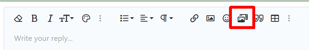

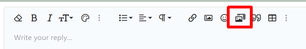

@Tim A., when posting, use this icon so the link works immediately and provides a thumbnail:

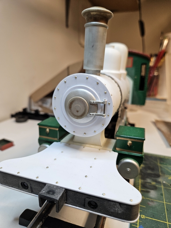

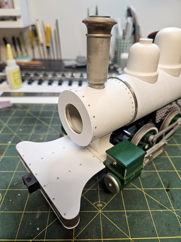

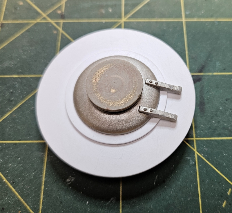

The more I looked at the smoke box the more I didn't like it. I've put fresh styrene on the smoke box and simulated the rivets with brads. I'm also making the smoke box front with a mix of styrene and the original door.
The difference with this build , being a working model, and others I've done is most of the major parts need to be removable, yet secure. That requires screws or other creative means. The pilot deck and cow catcher has been quite the challenge for me to scratchbuild. I came up with a pressure fit design to secure the cow catcher. It's working well and it's straight!
Here you can see the blind nut and screw that secures the rear of the boiler to the frame. The boiler back plate will cover all of this. The front boiler screw goes up through the smoke box.
