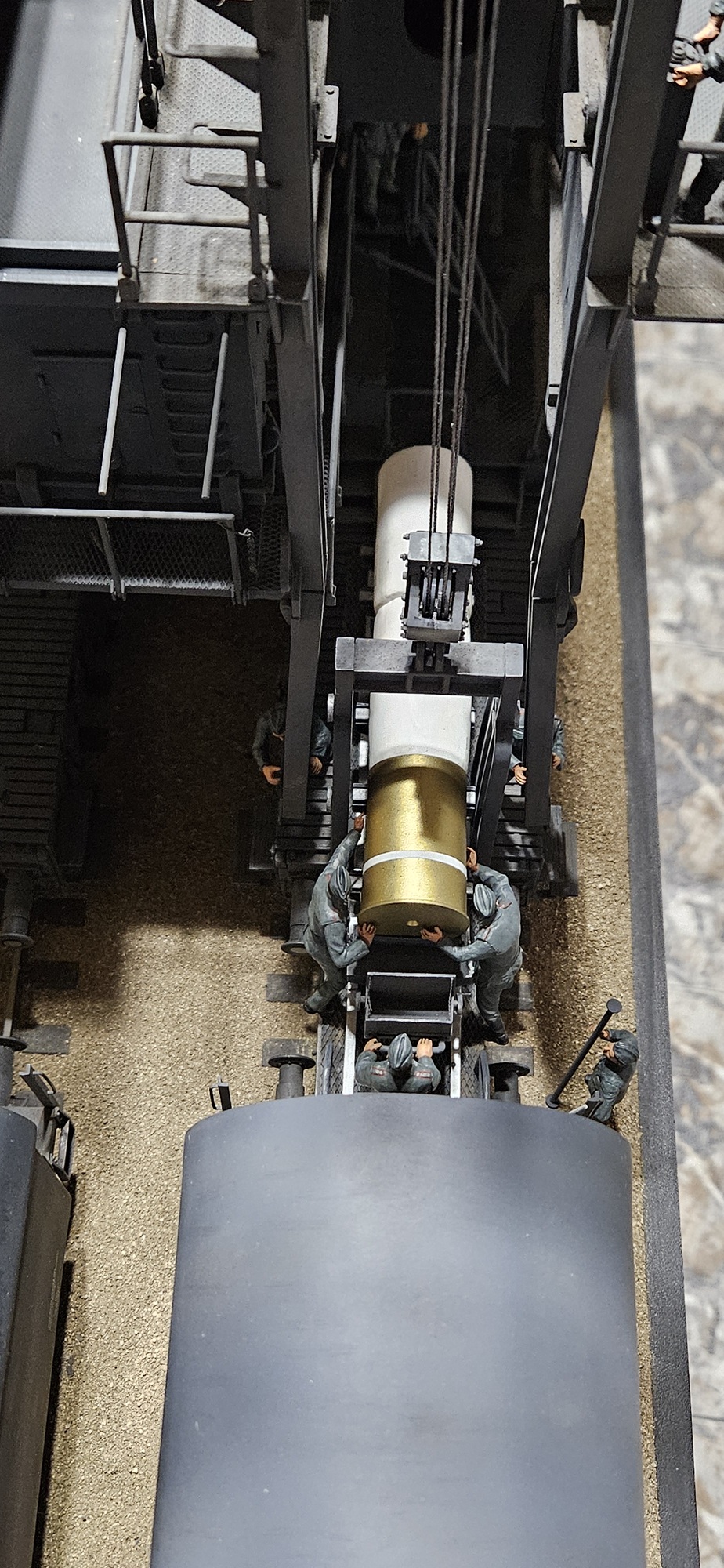

Hi my friends, finally have taken some time to do the last chapter of the Dora journey. its being a while since my last post, but finally ended the work I started so many years ago, currently have being working on about 5 models at the same time, but made a halt to finish the Dora and here it is

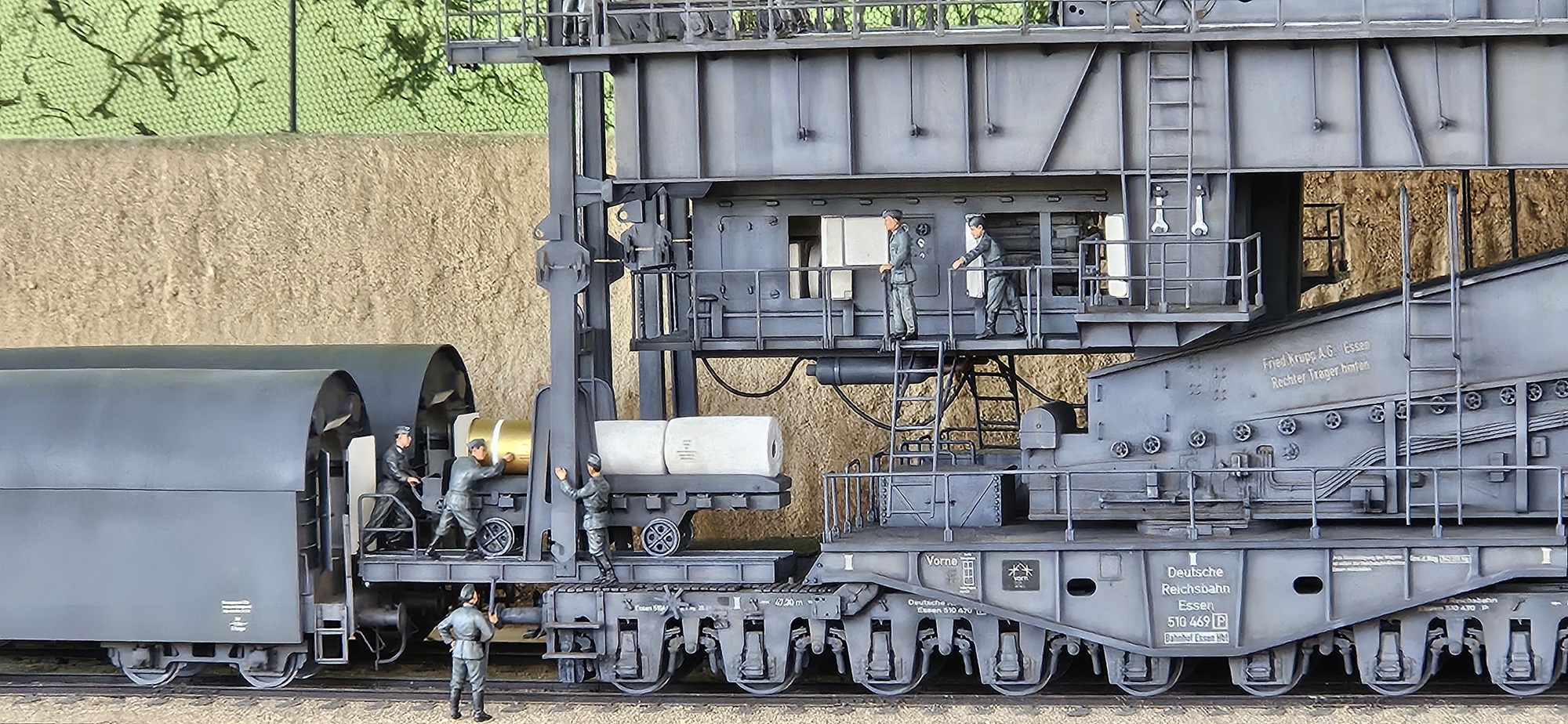

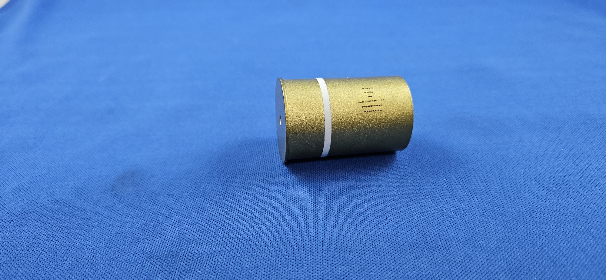

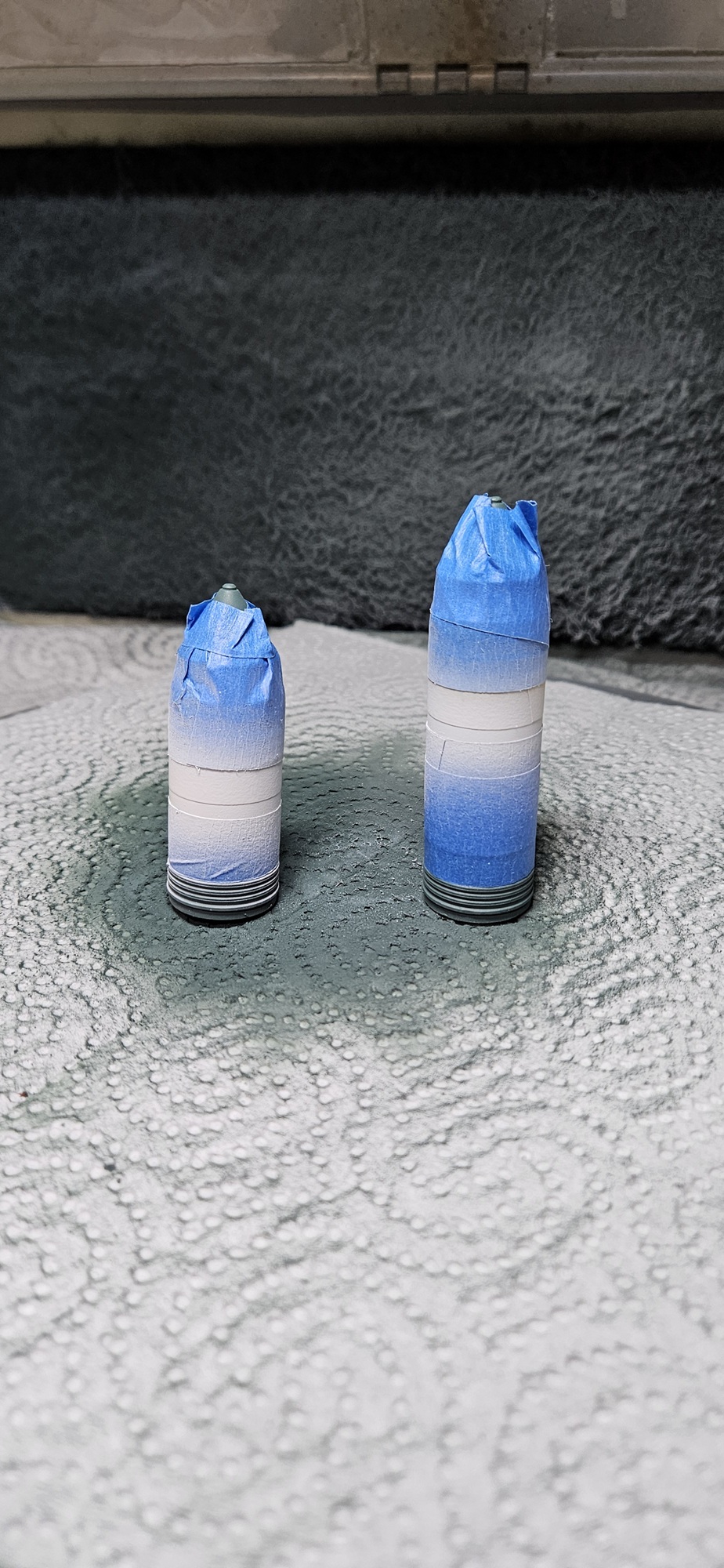

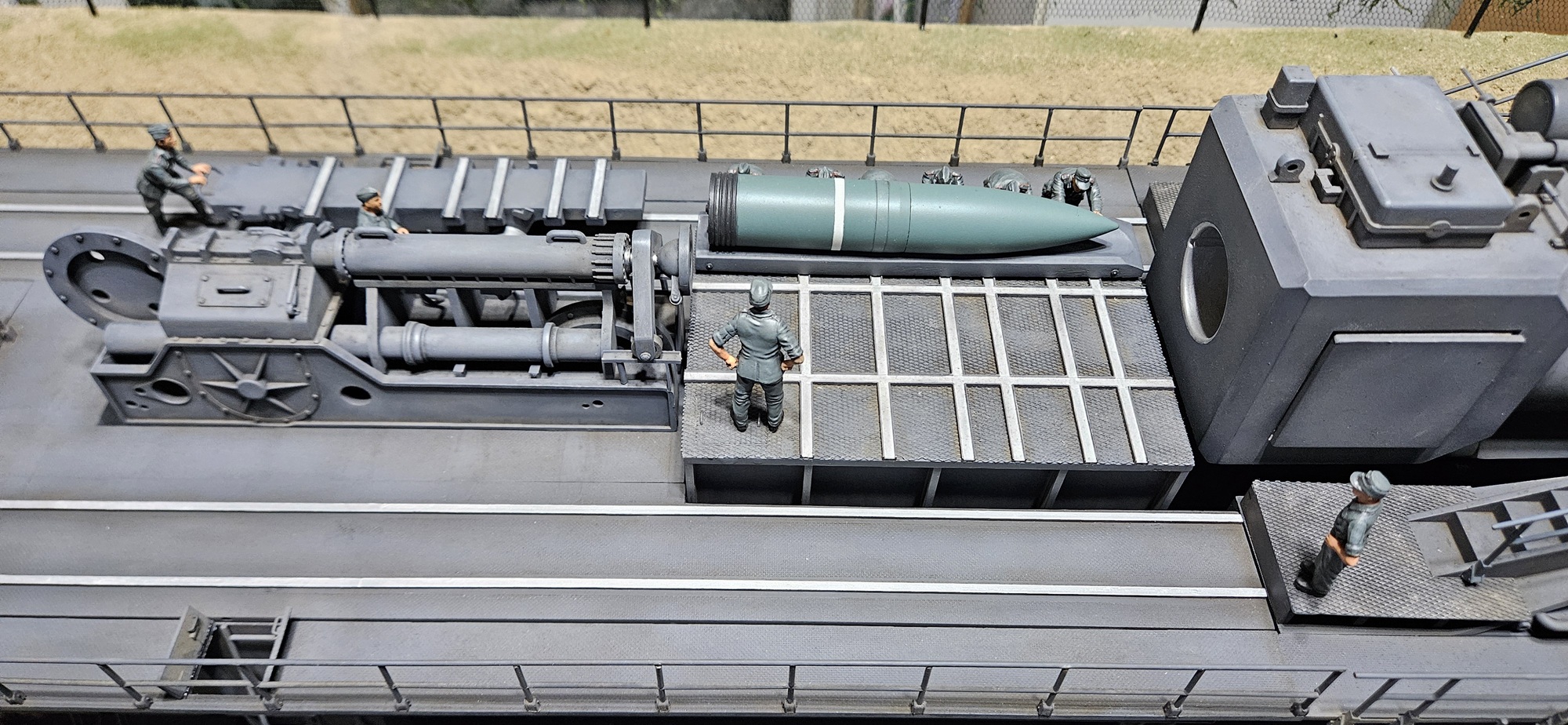

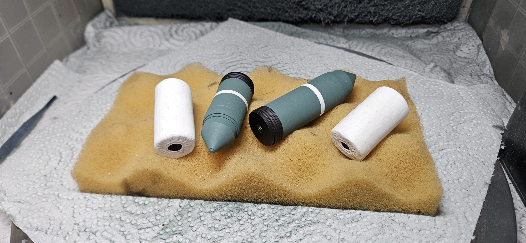

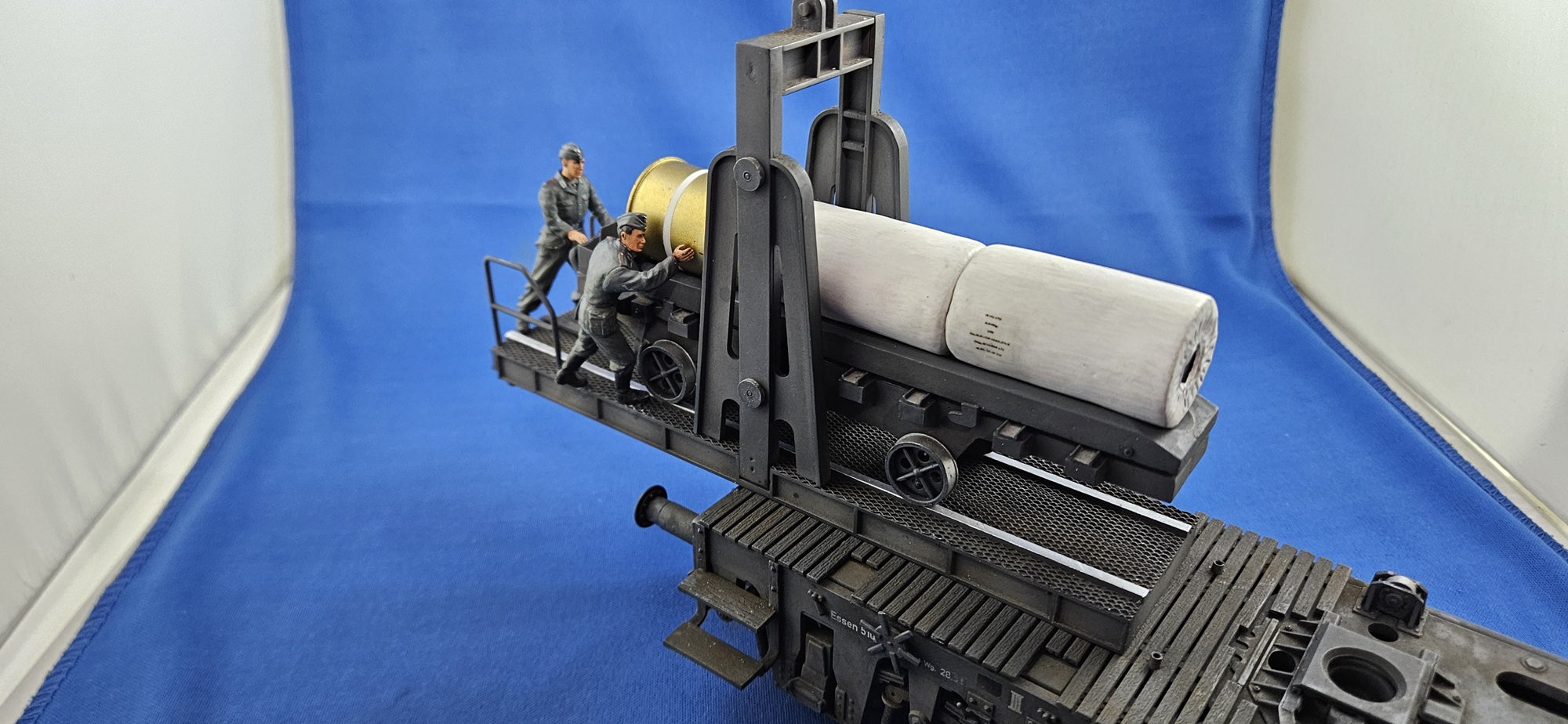

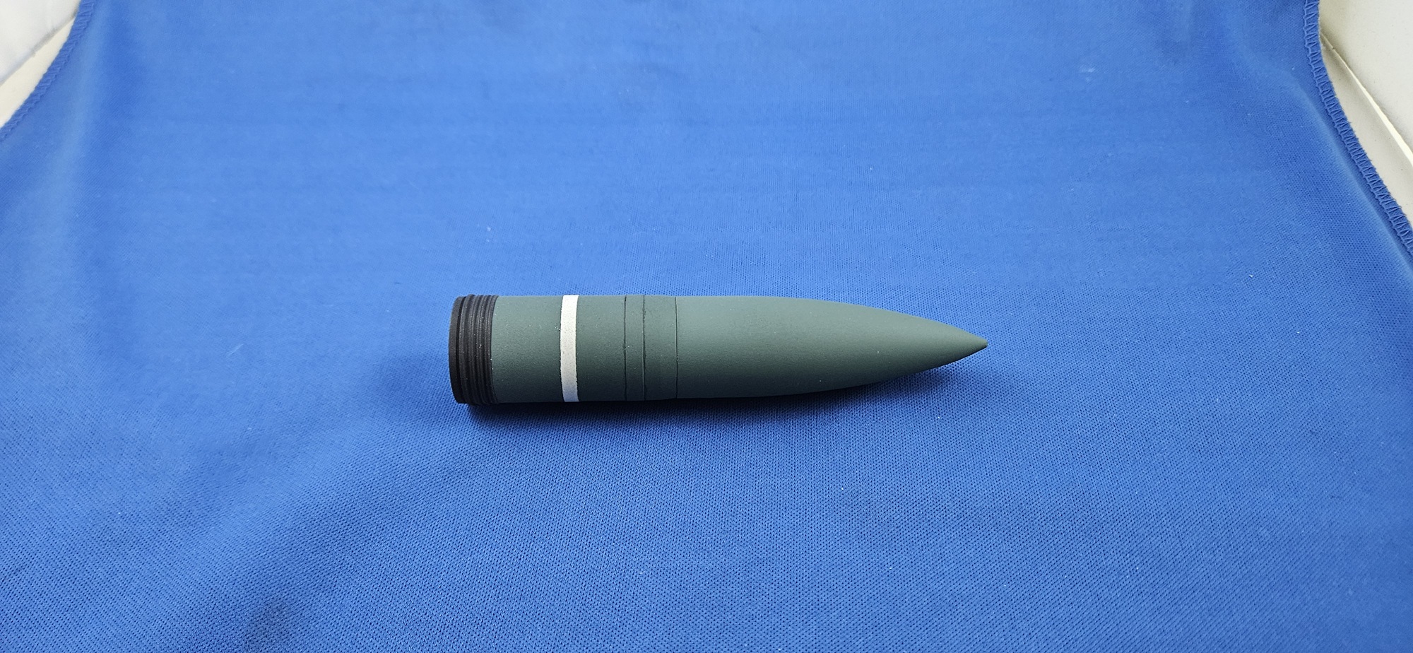

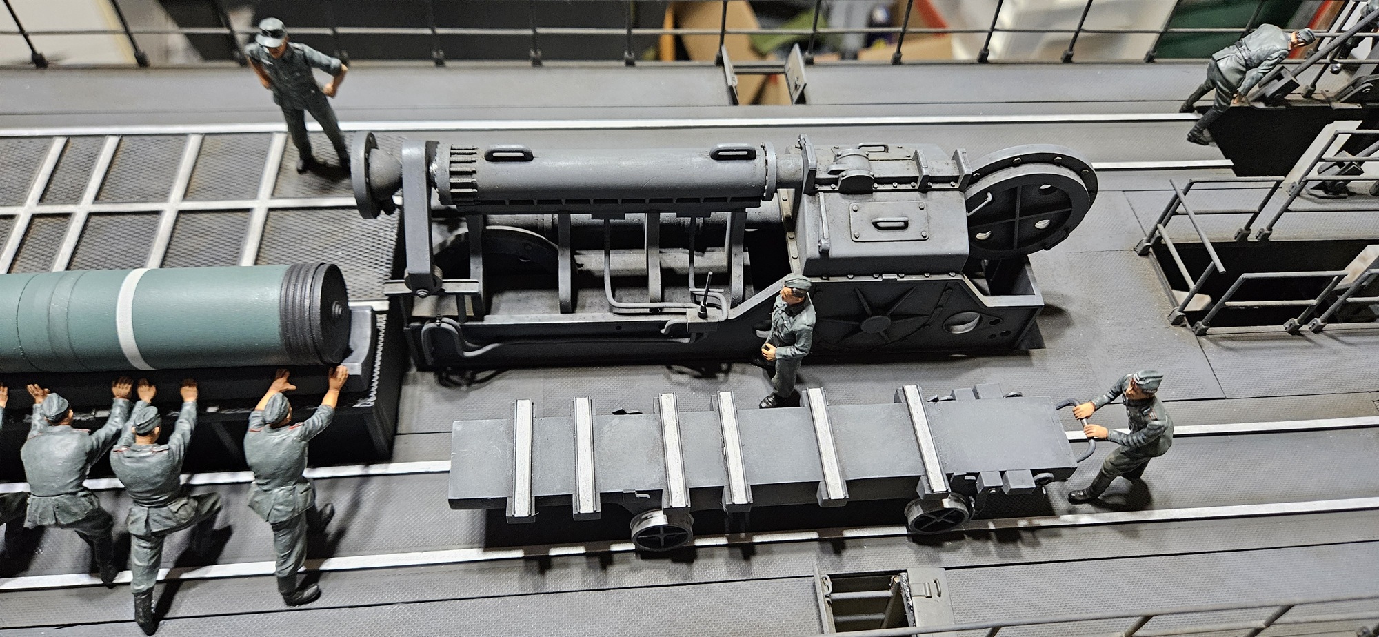

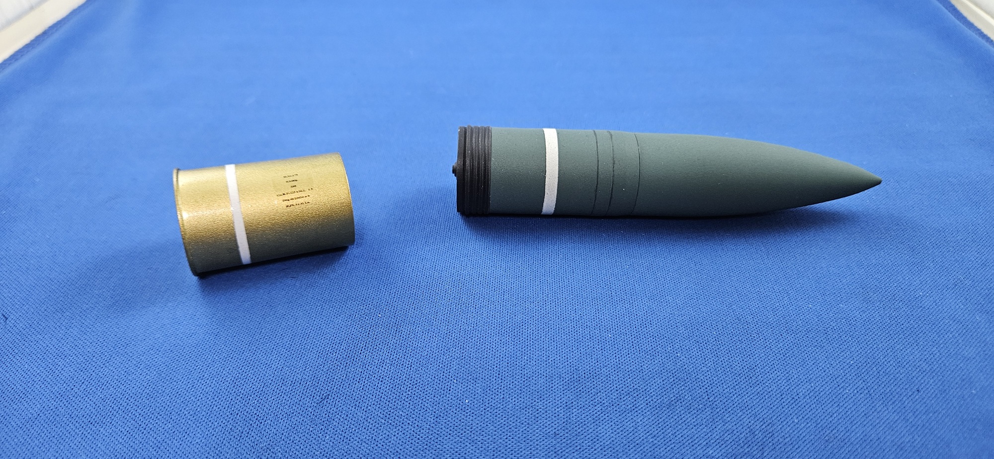

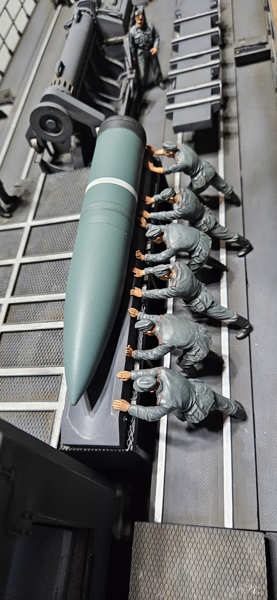

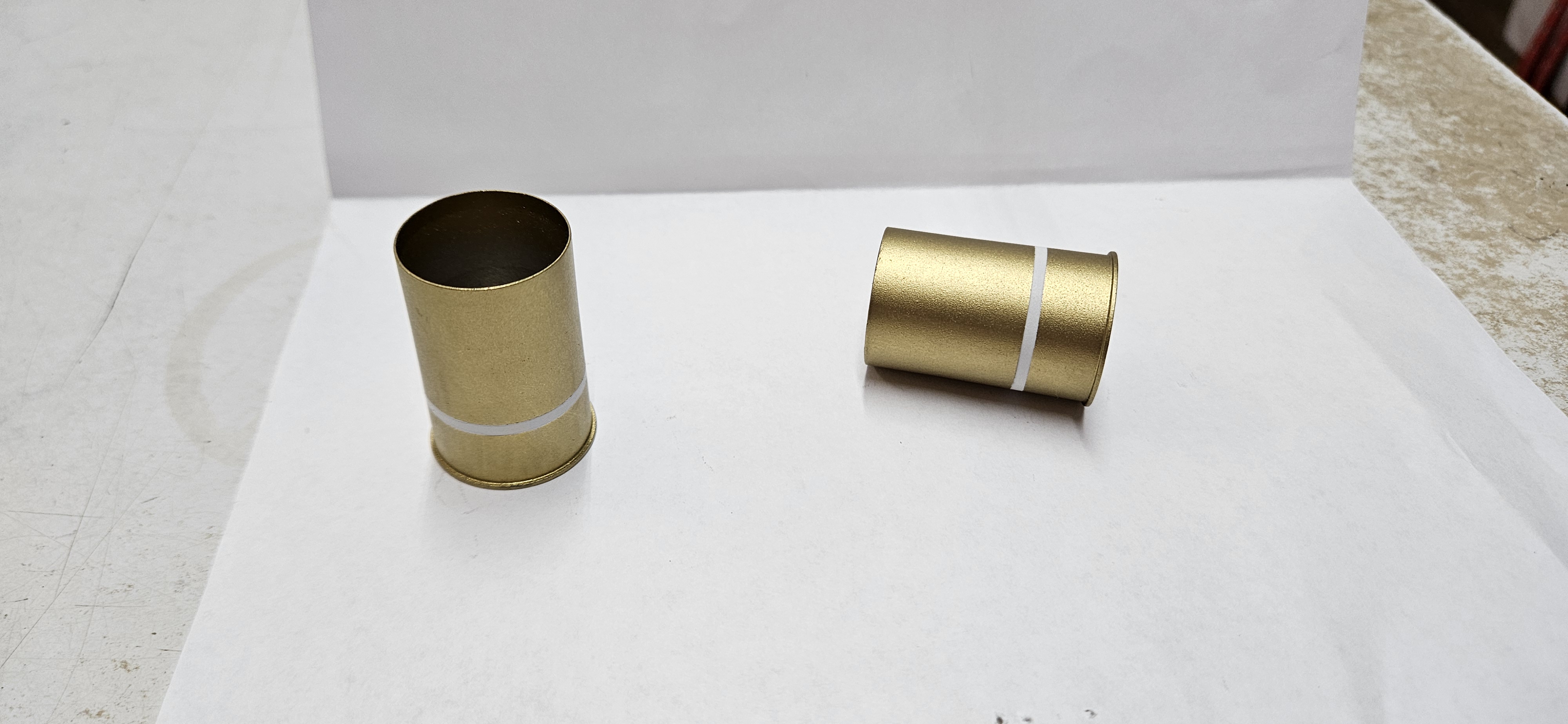

The schatton aluminum shells and cases are primed and painted. a white stripe is painted on the shells as seen on some of the videos of the gun
the same with the case, I have seen a thin black line on some photos but on the videos it has a white band painted on it.

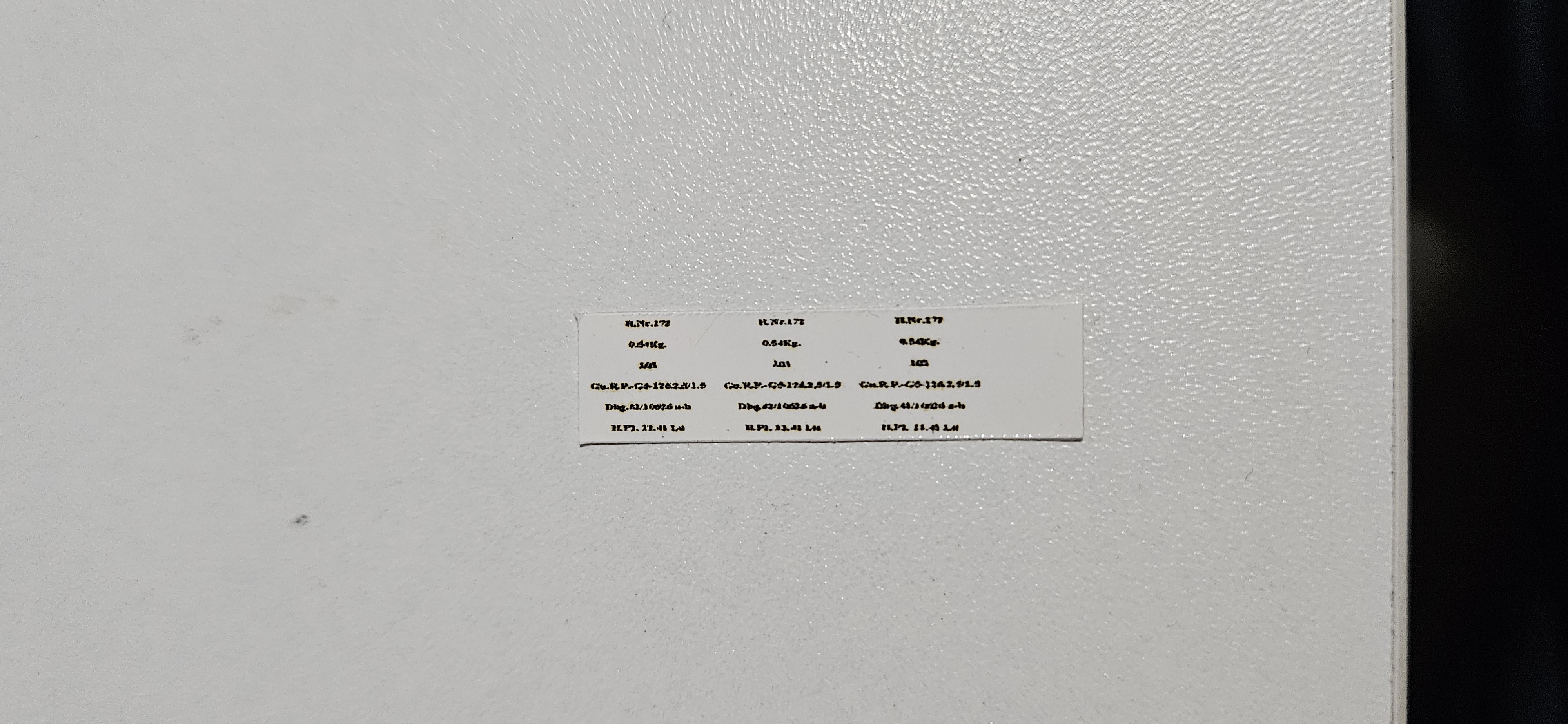

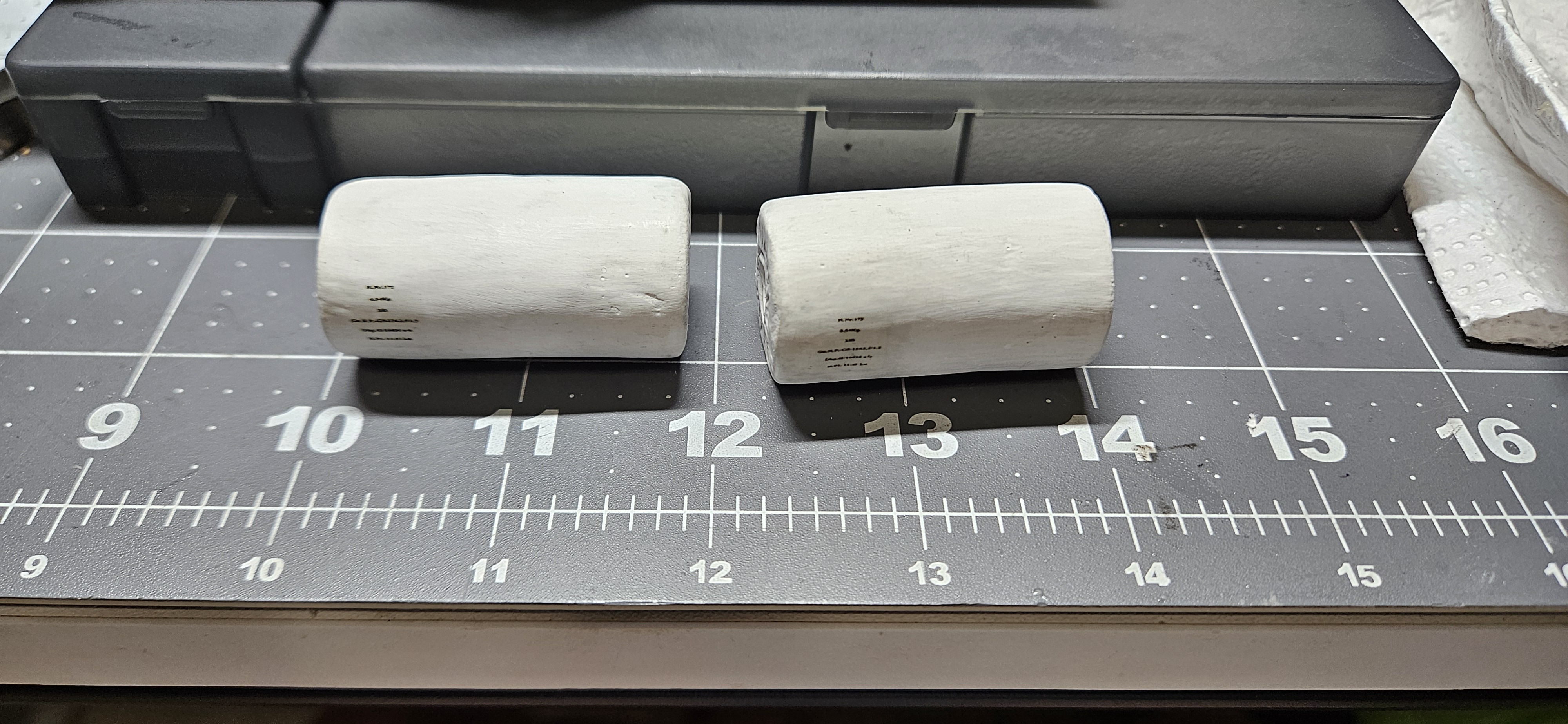

next I printed some decals to simulate the markings on the cases and powder charges

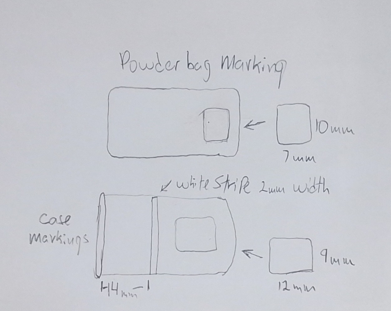

again looking at the videos I made a scketch of the position of the markings

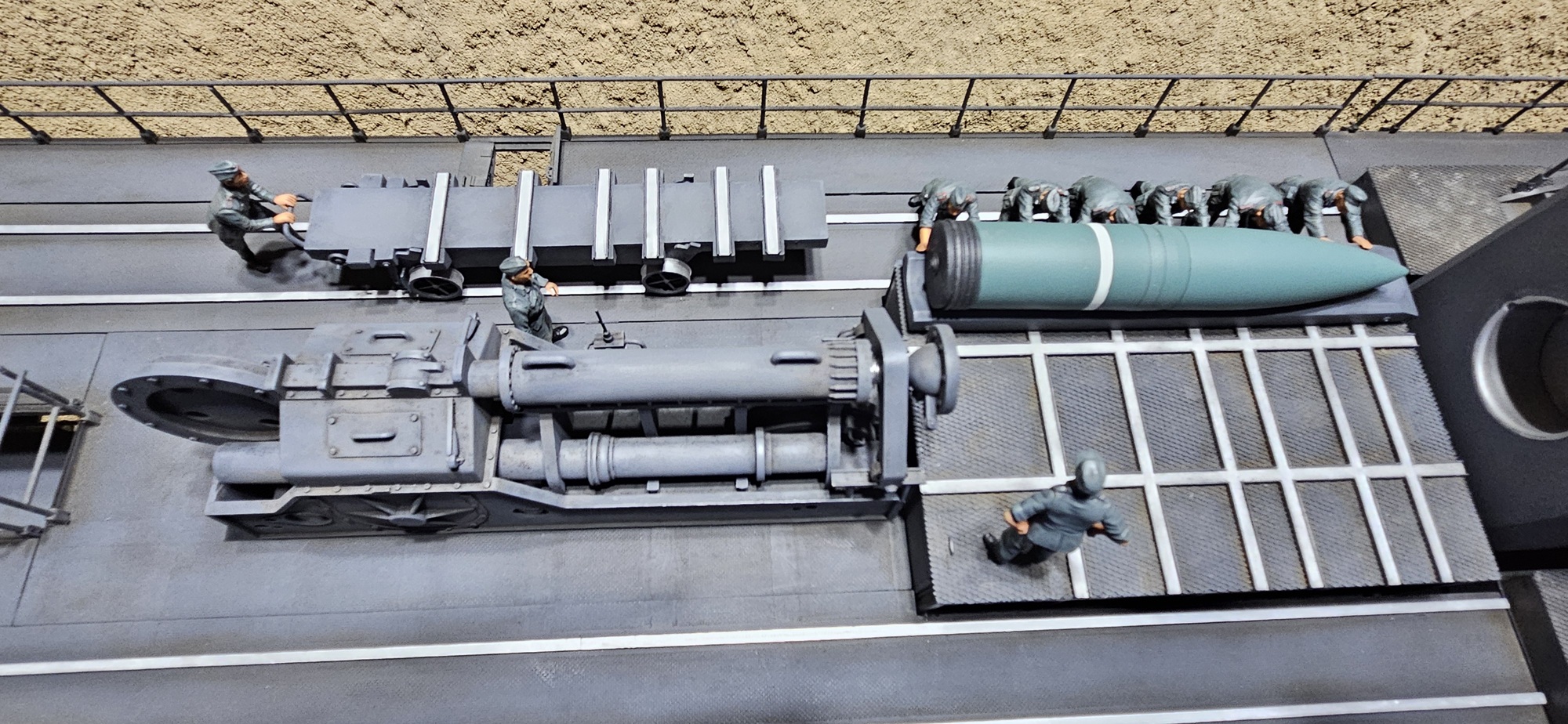

powder bags with markings and shells with white stripes
case with markins and white stripe
and my reference photos, captures from video

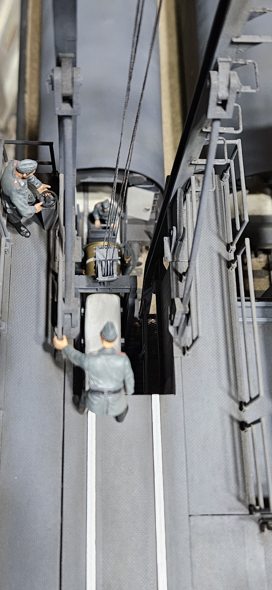

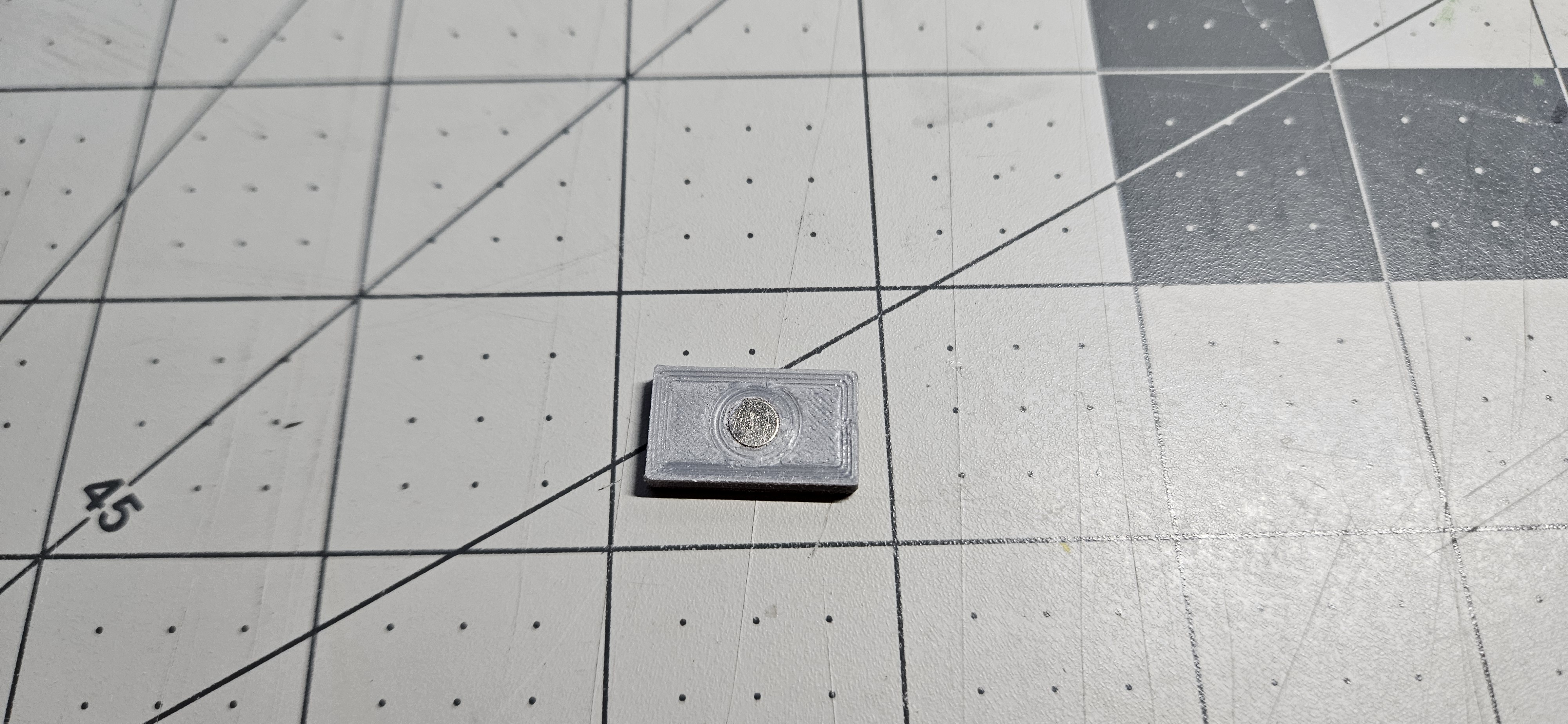

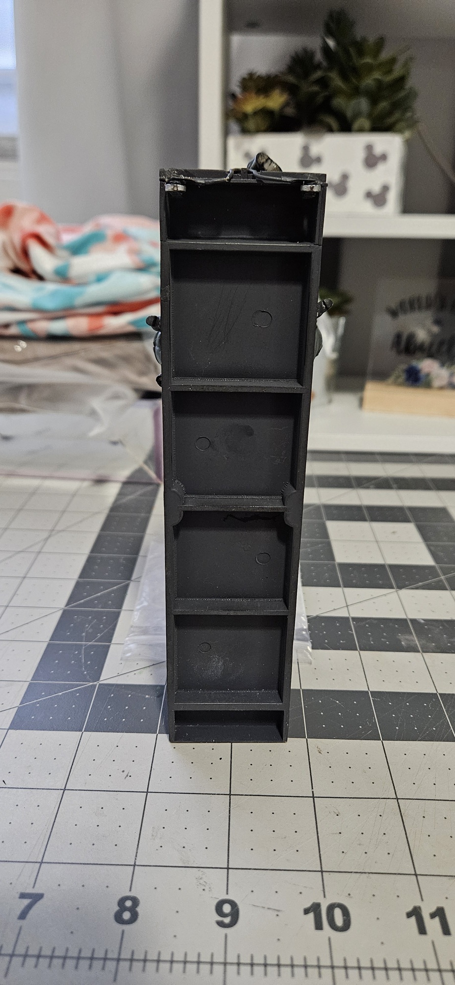

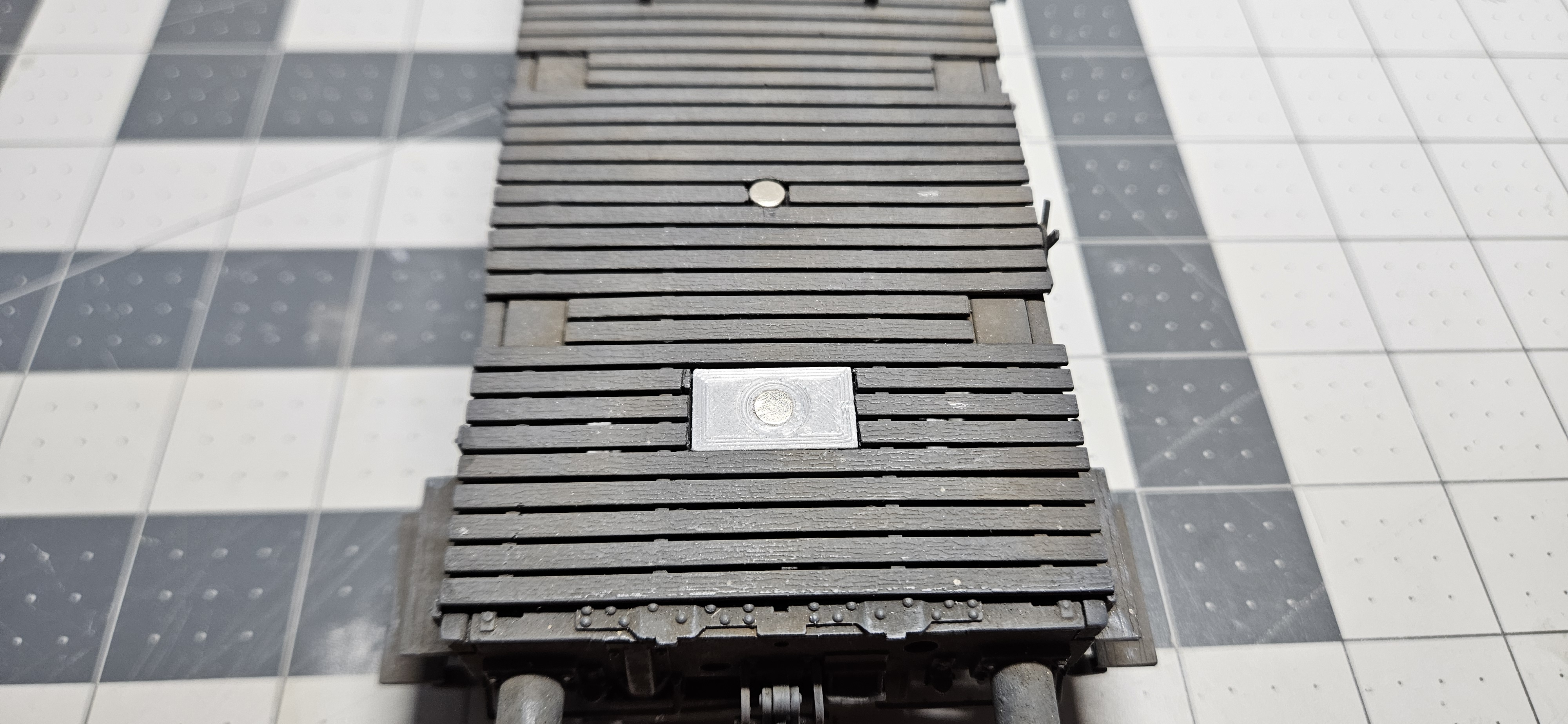

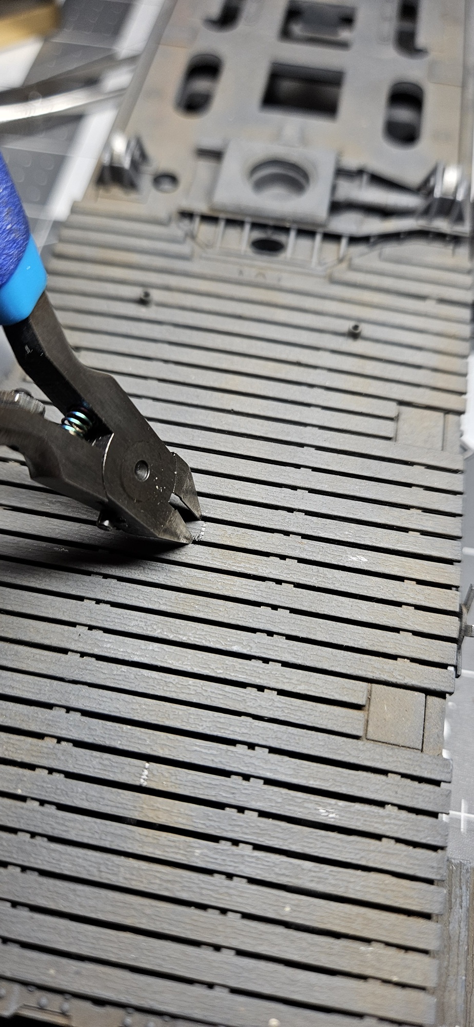

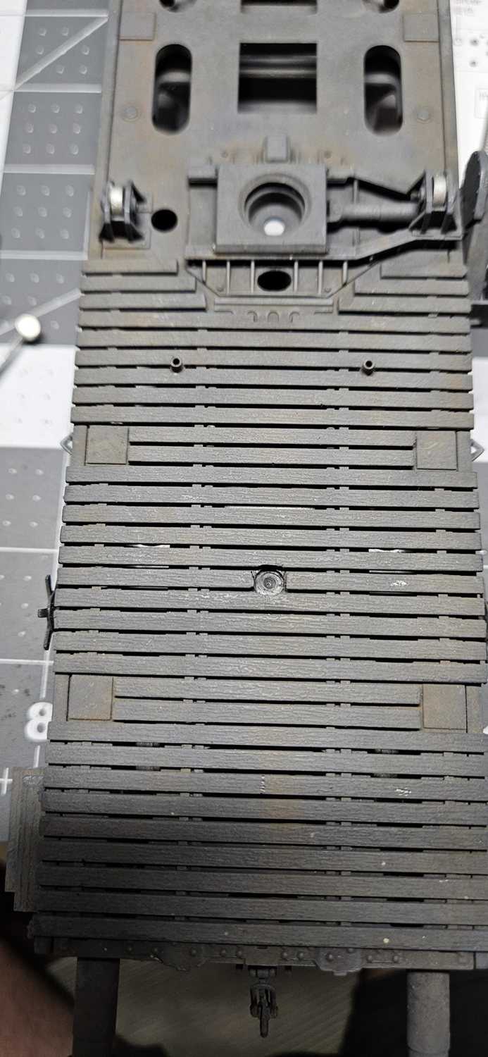

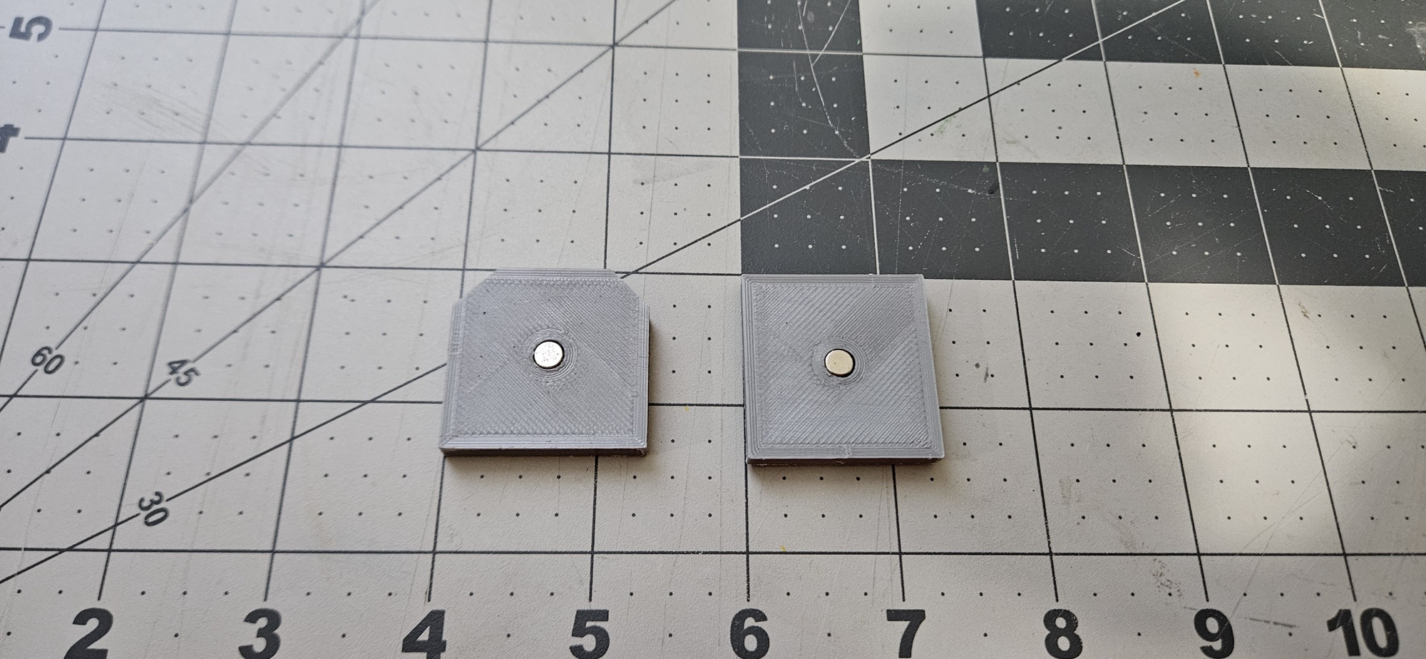

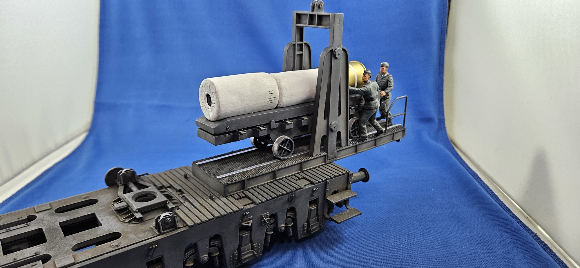

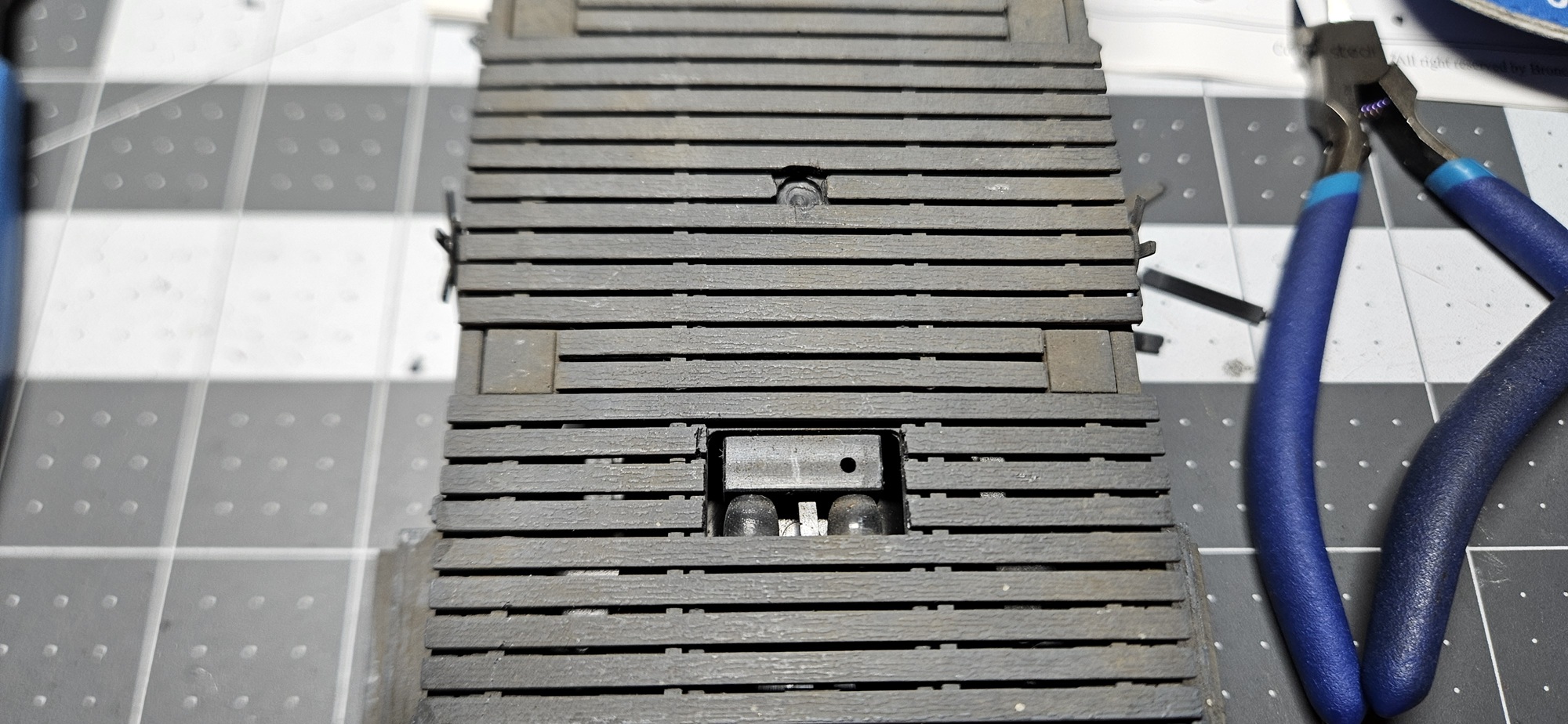

now I modified the elevator car and the elevator with magnets in case I need to take the elevators platform appart for transport.
a hole is drilled for the first magnet

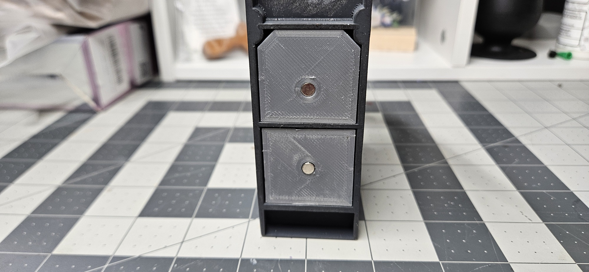

next a rectangular hole is made for the second one
I 3d printed a rectangular base for the second magnet
now the elevator received two bases for the corresponding magnets
the 3d printed bases ready to install under the elevator
now the elevator stays in place with out the need of gluing it, if I need to remove it just pull it up and disconnect the pulley from it

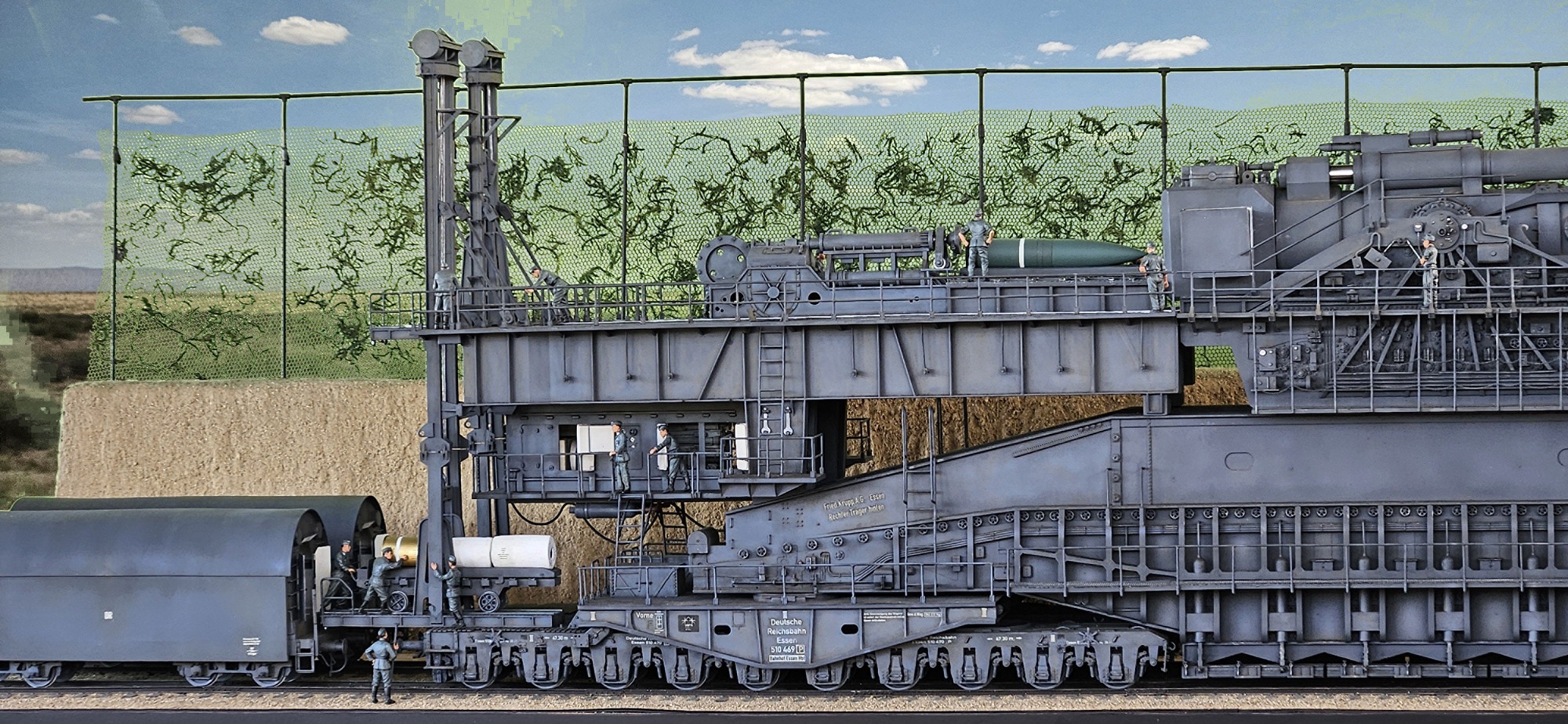

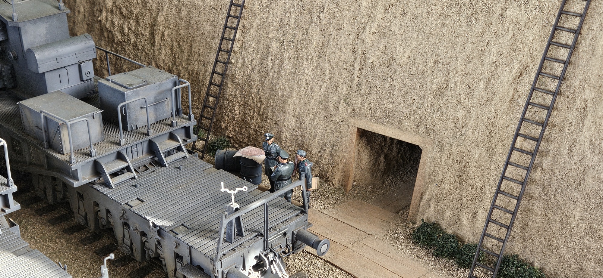

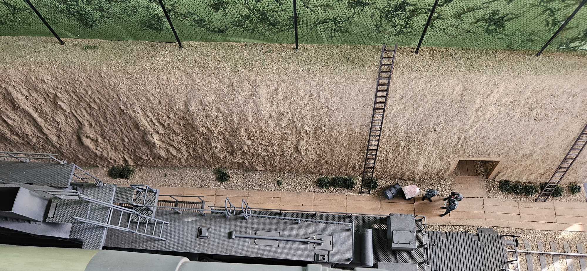

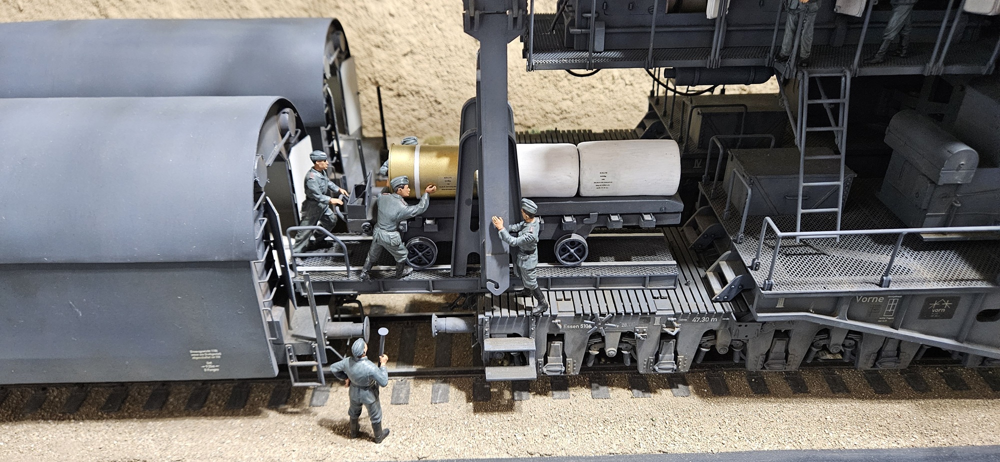

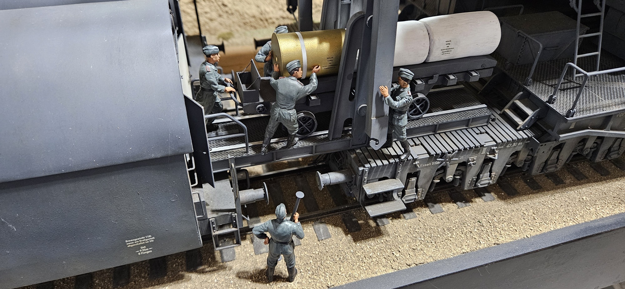

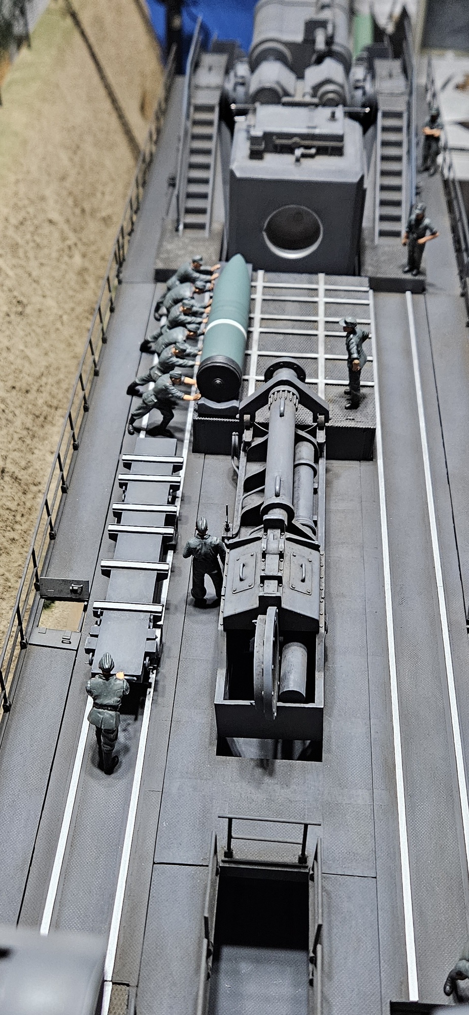

playing a bit with photoshop I added a background photo

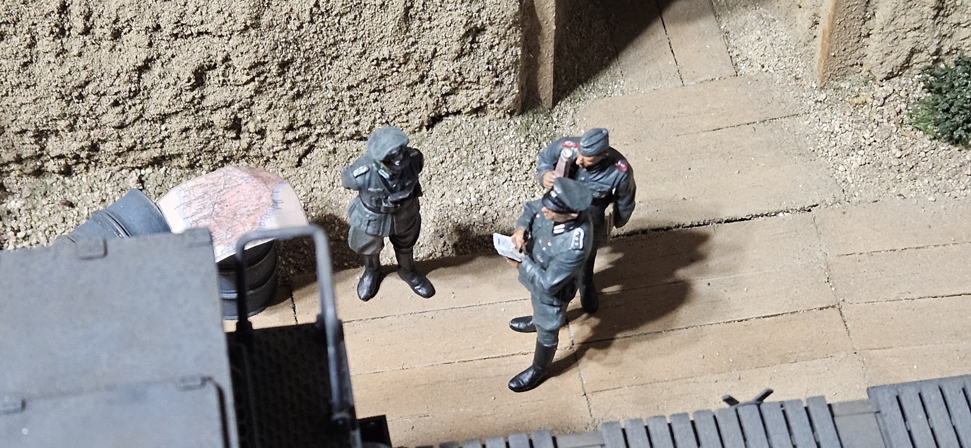

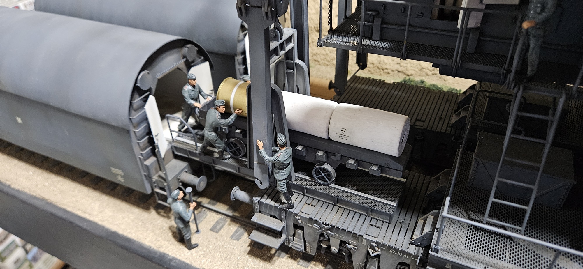

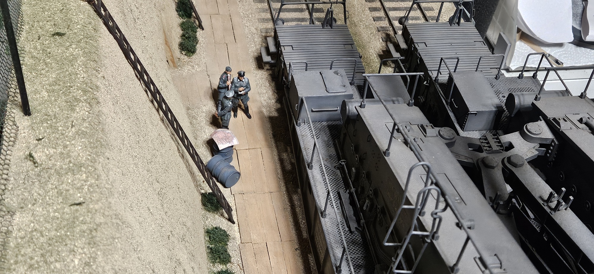

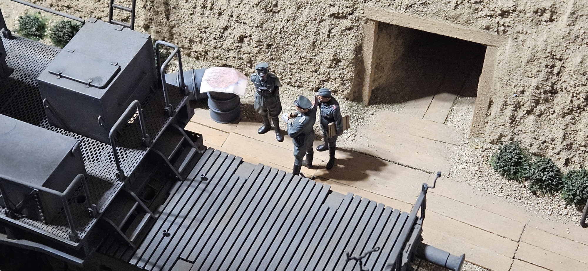

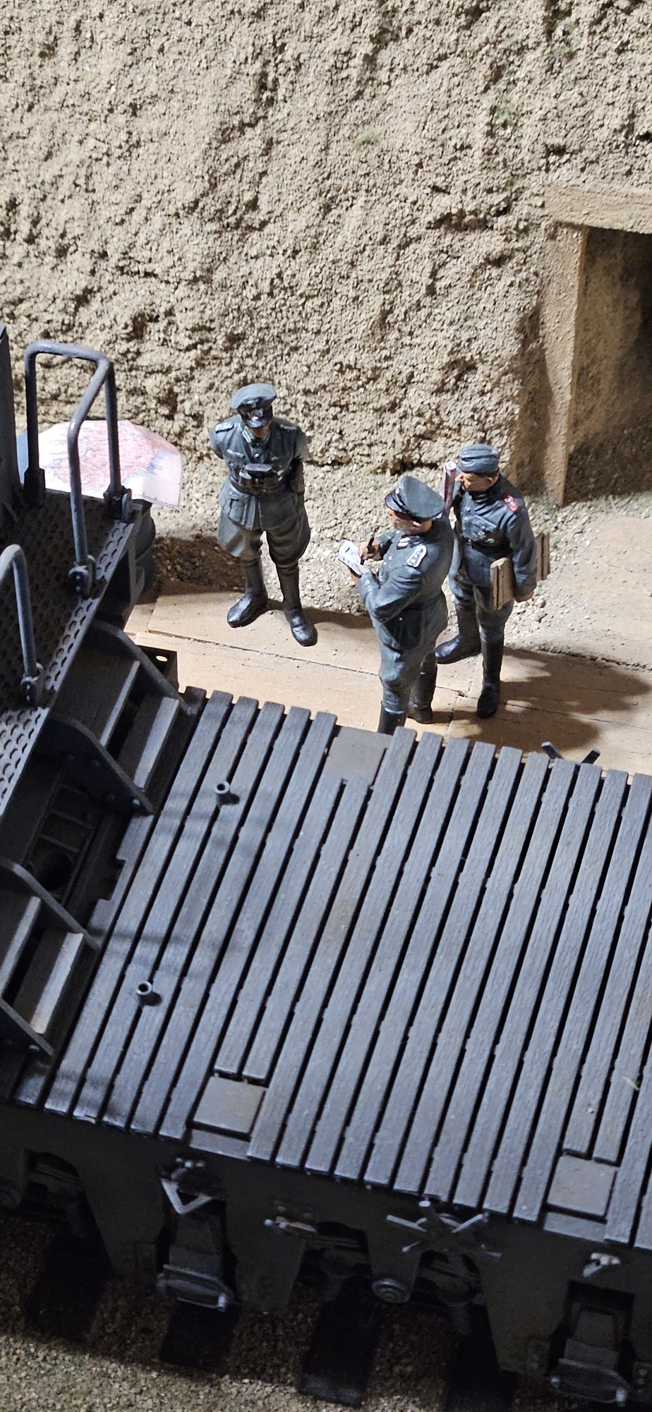

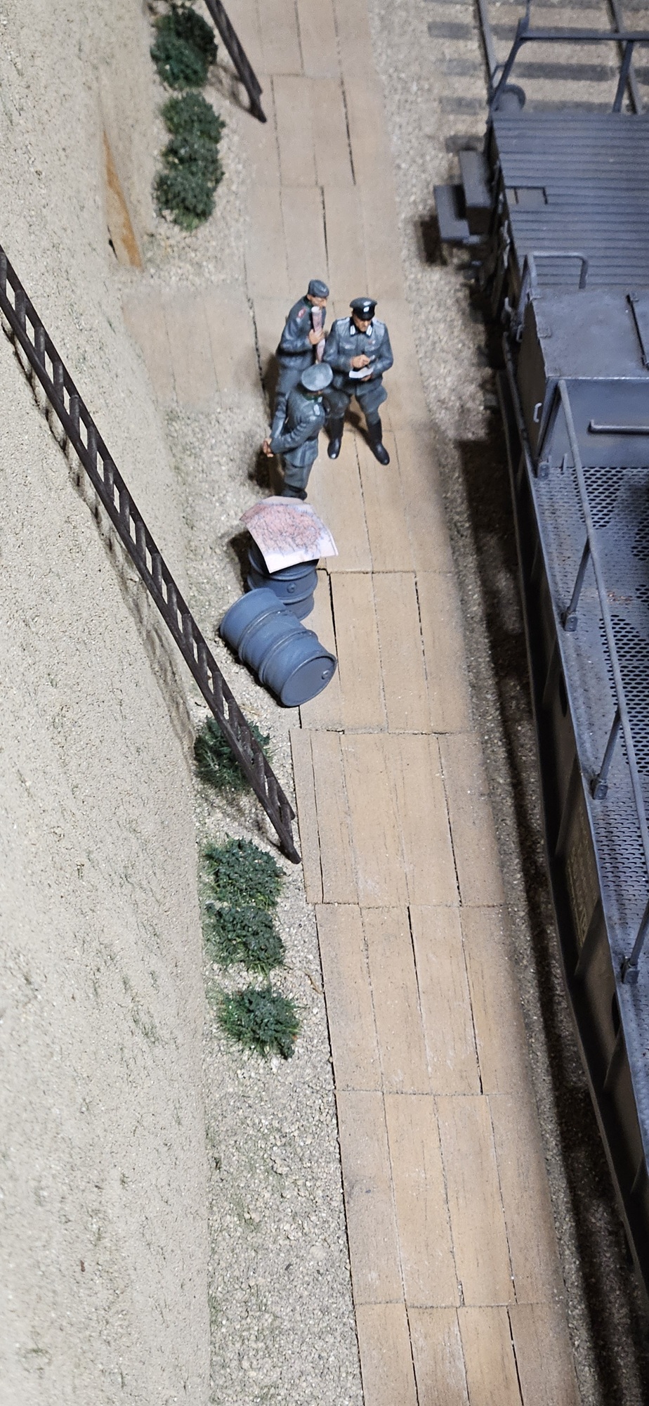

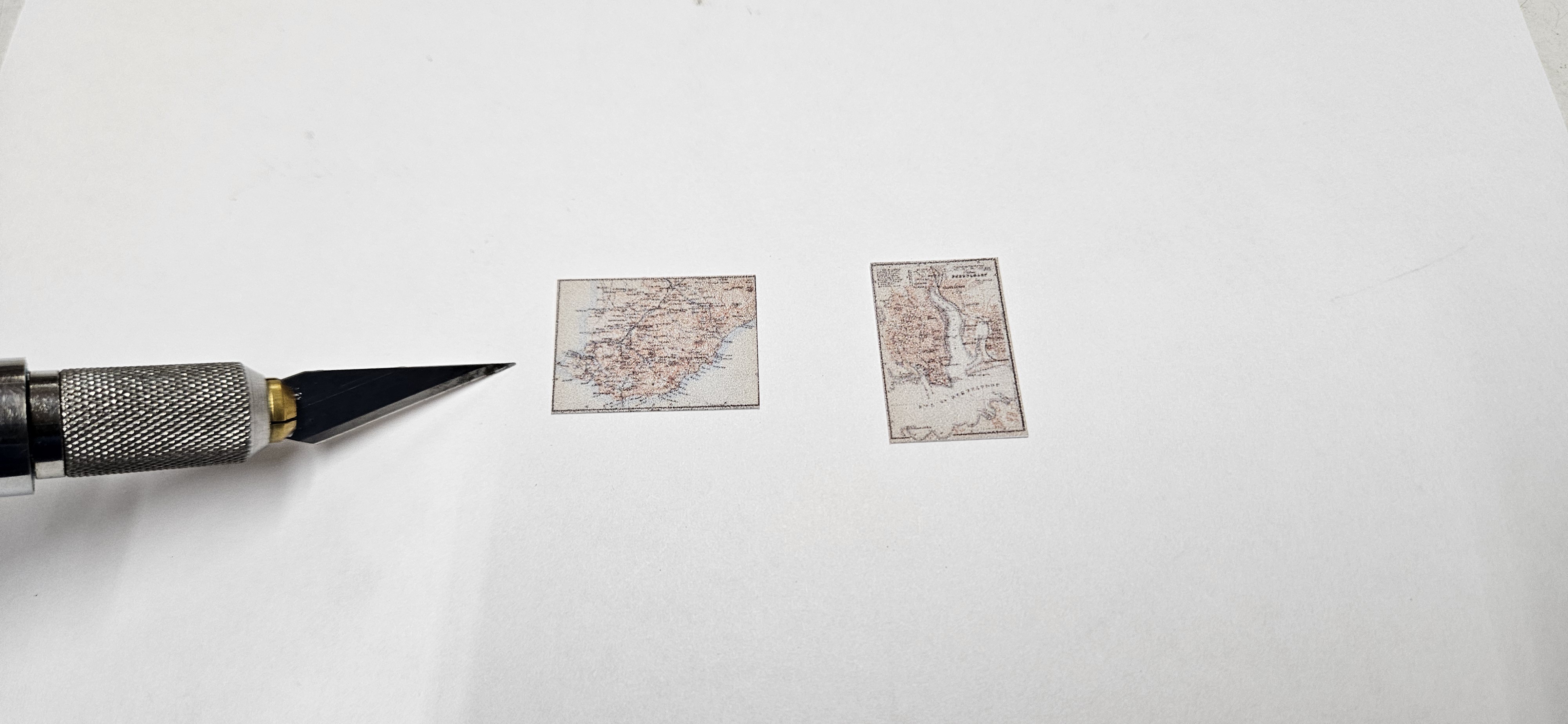

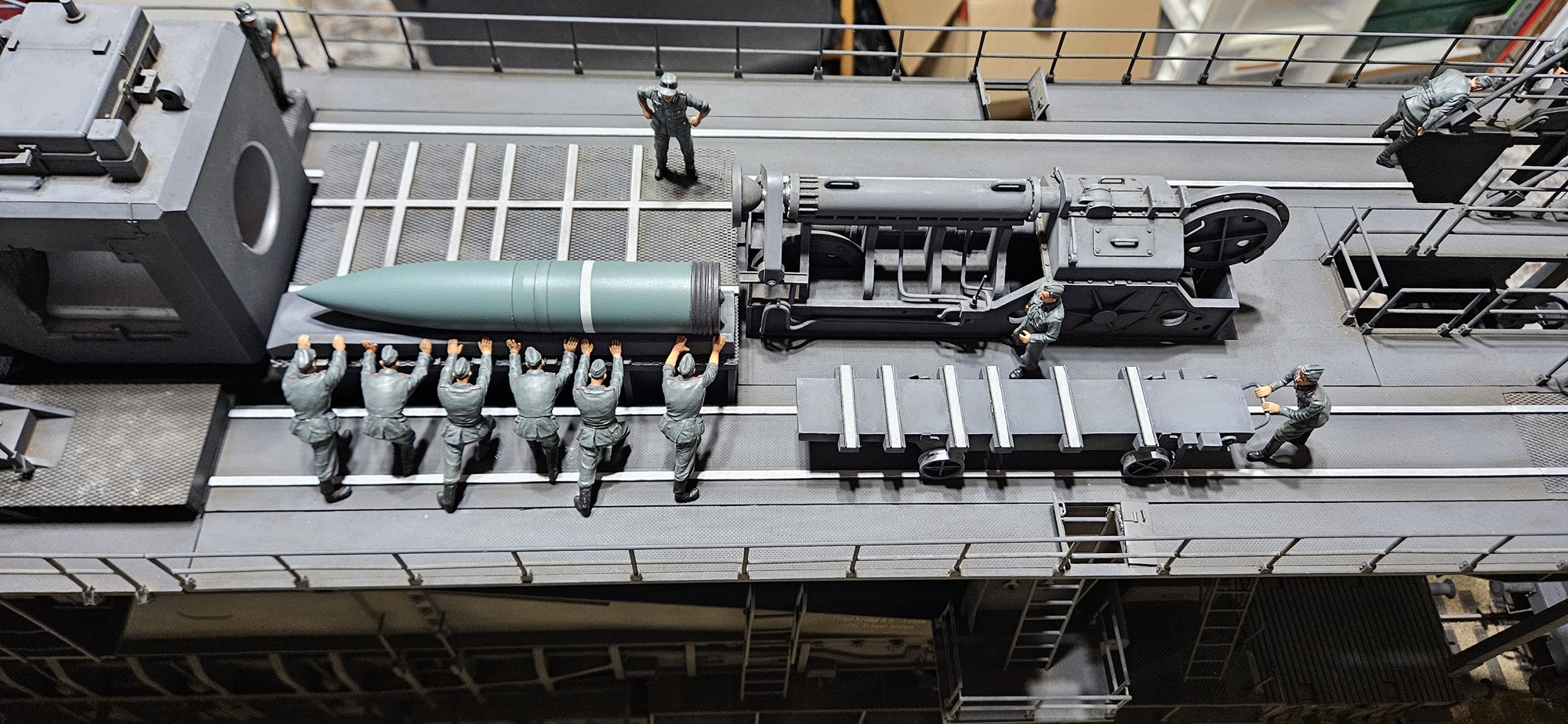

I printed a couple of maps of the savastopol area for the officers

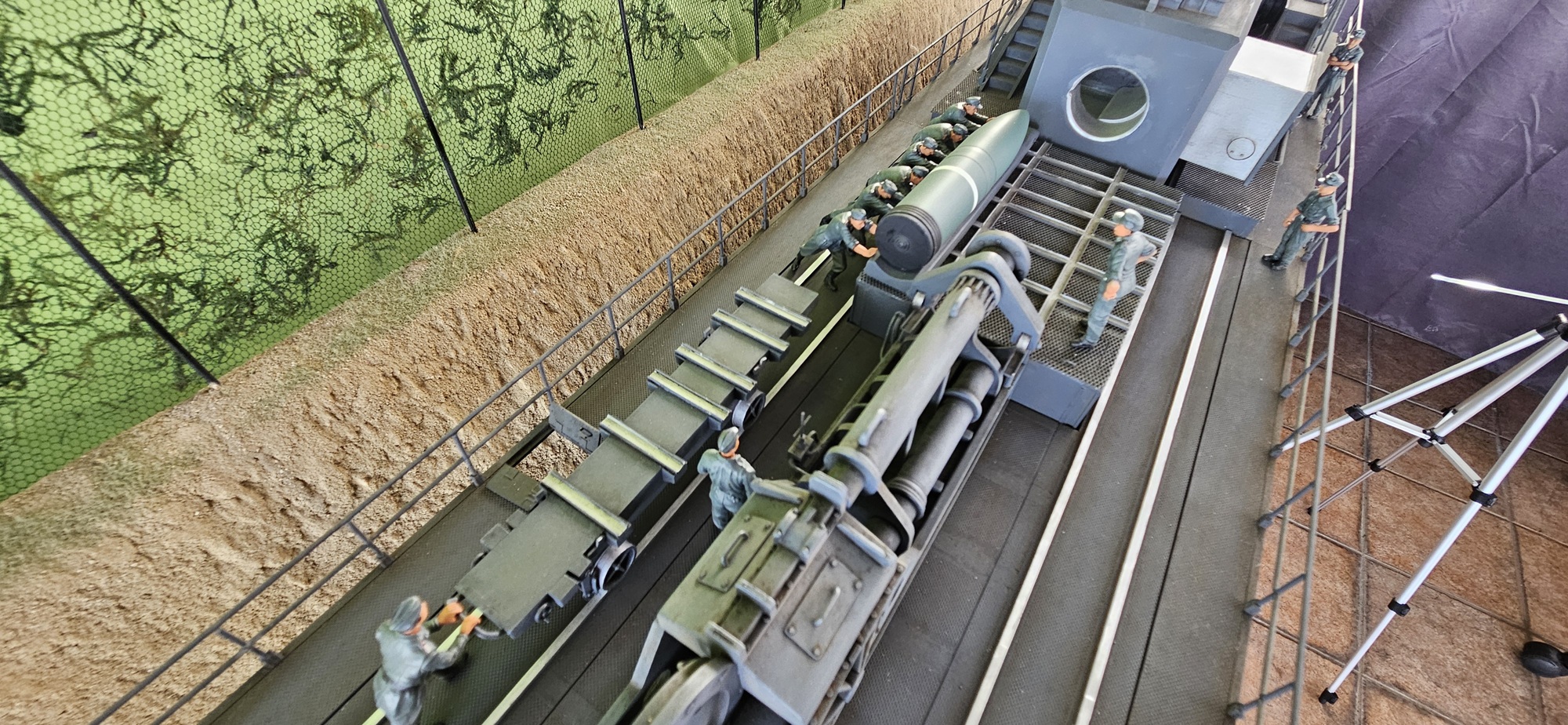

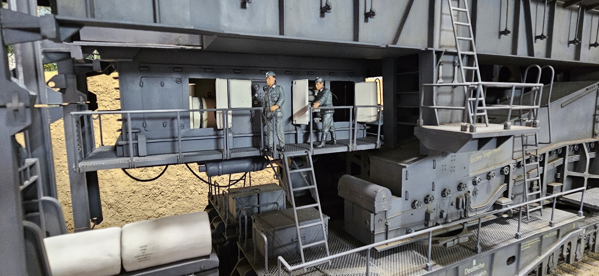

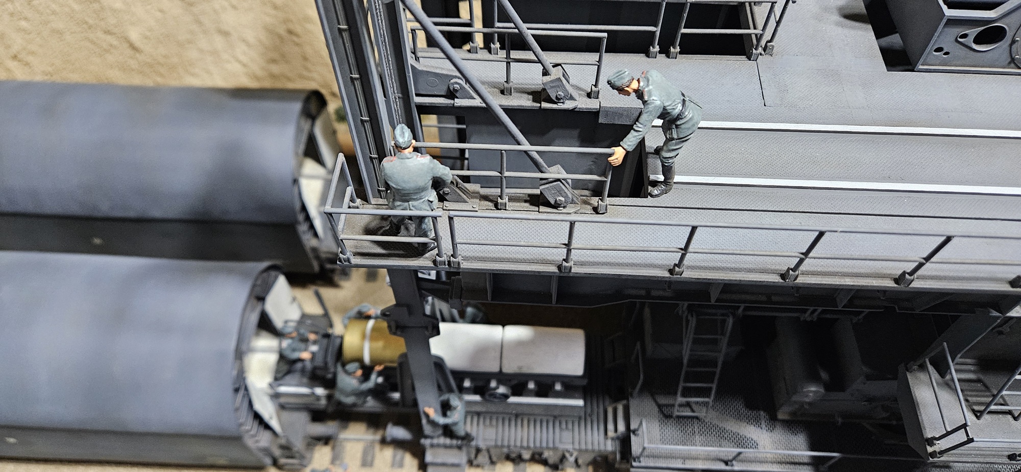

all the figures painted and in place

with a background

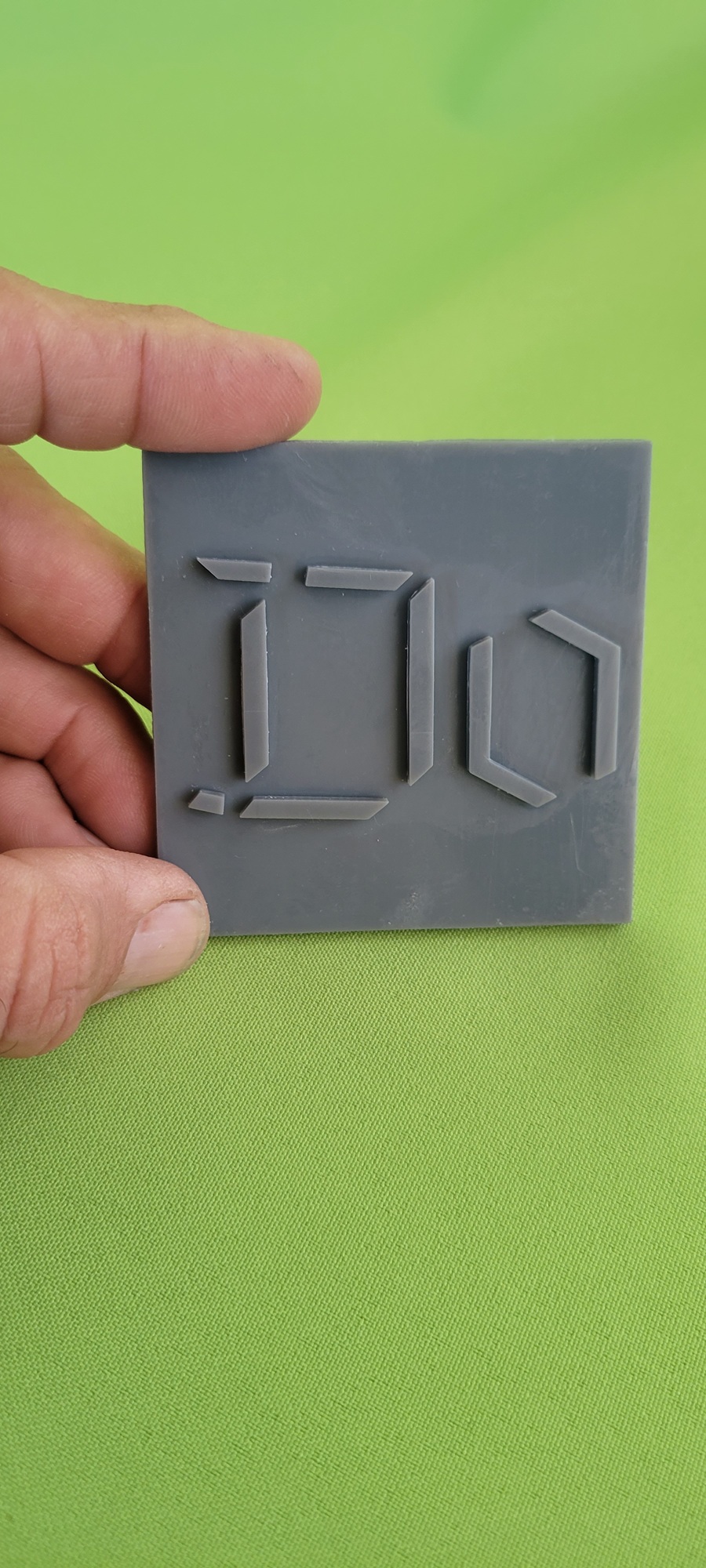

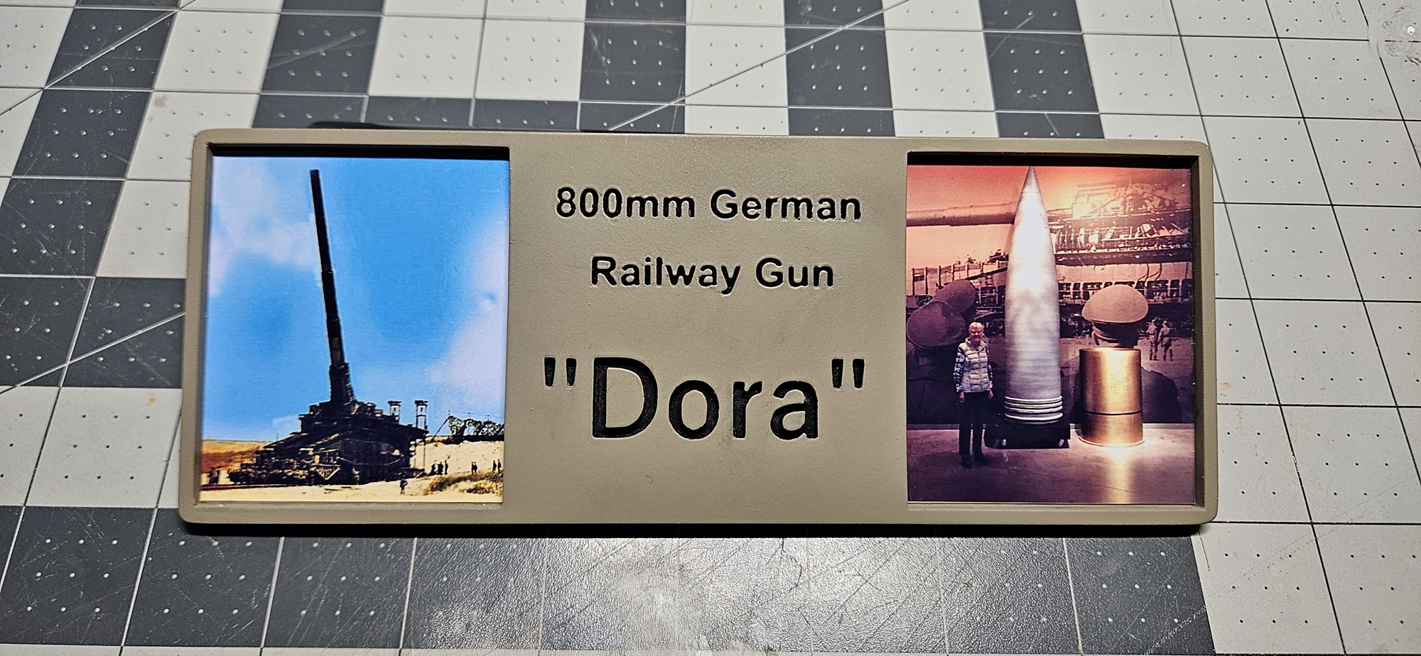

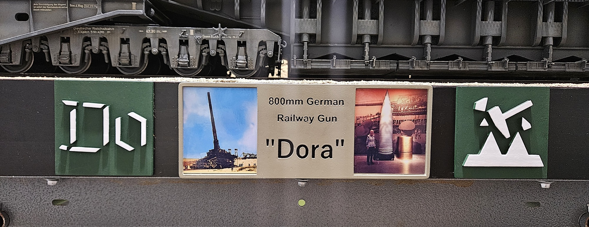

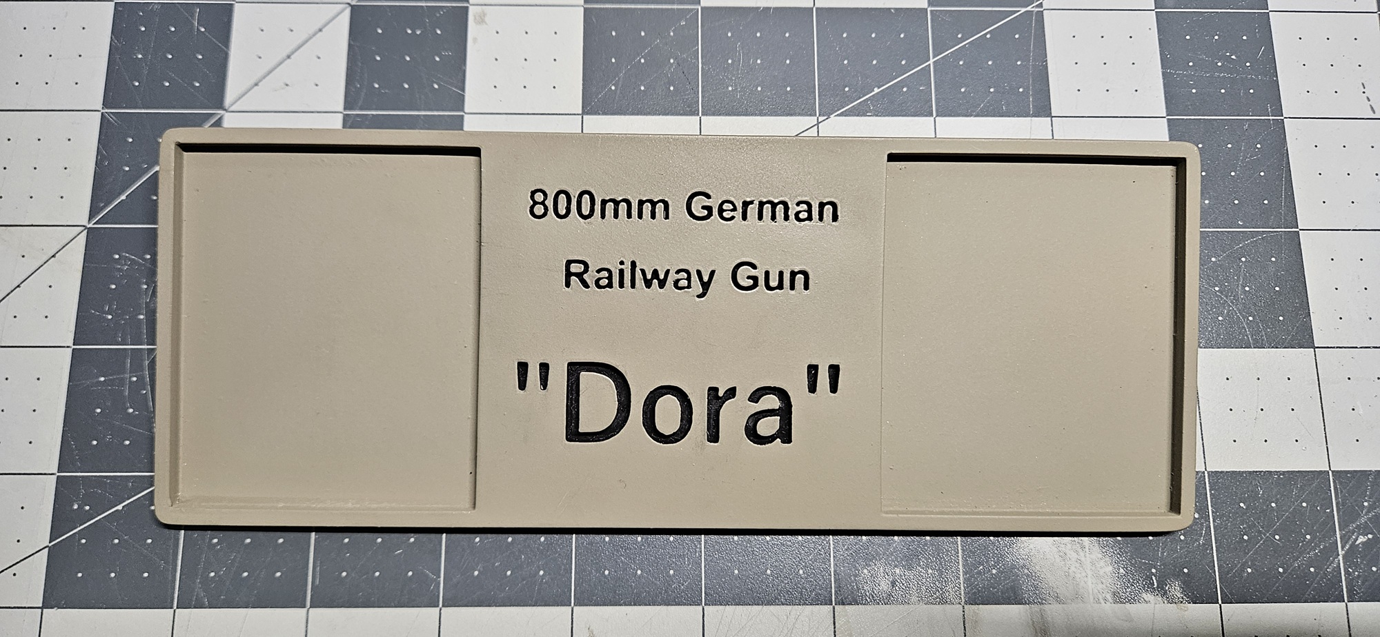

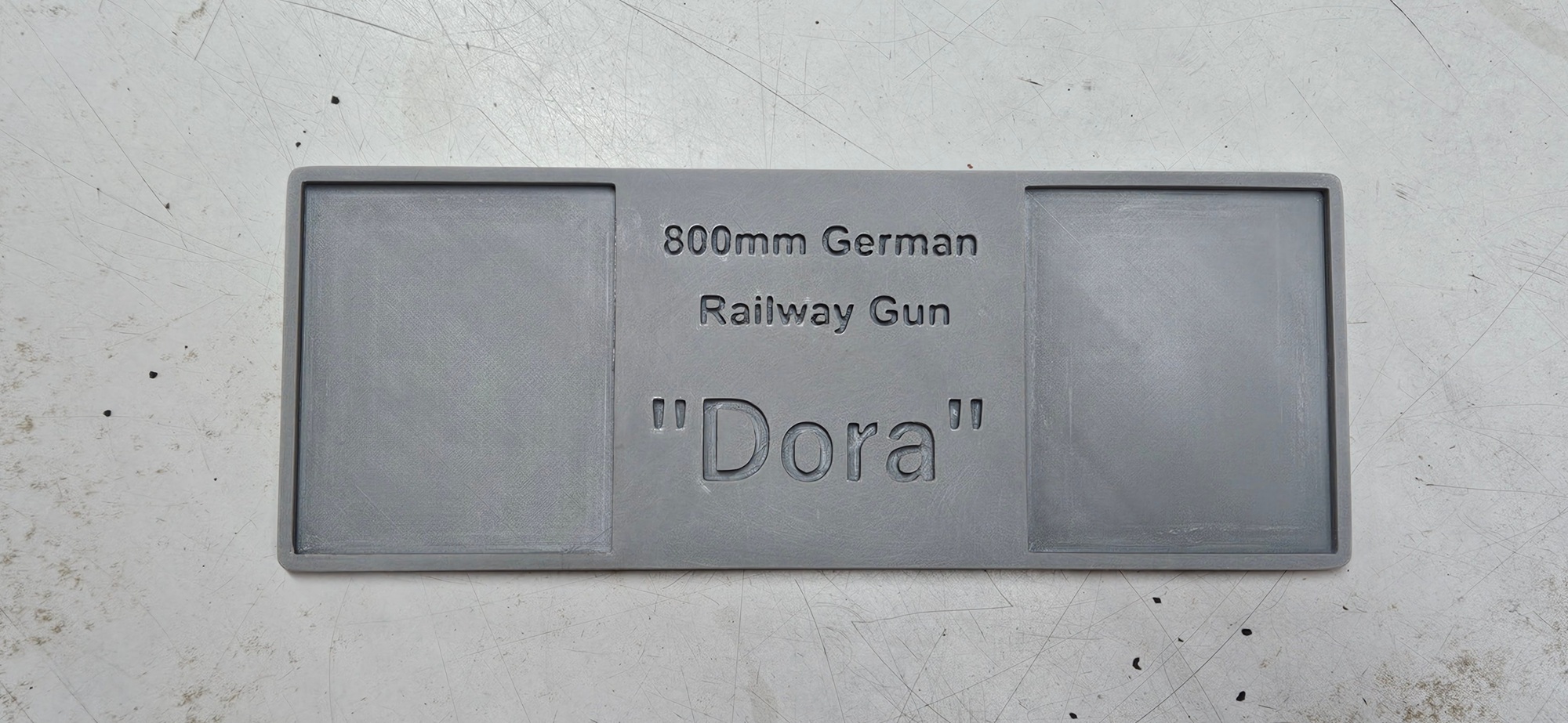

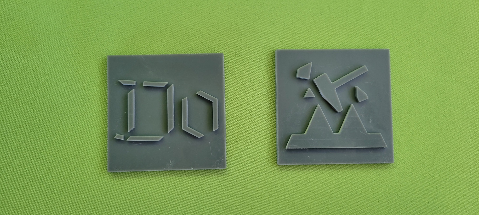

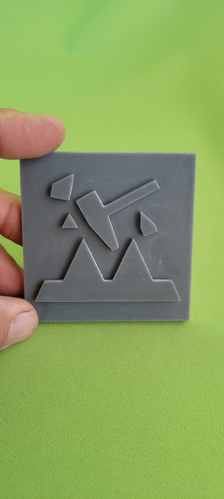

I made a 3d printed nameplate
painted and ready

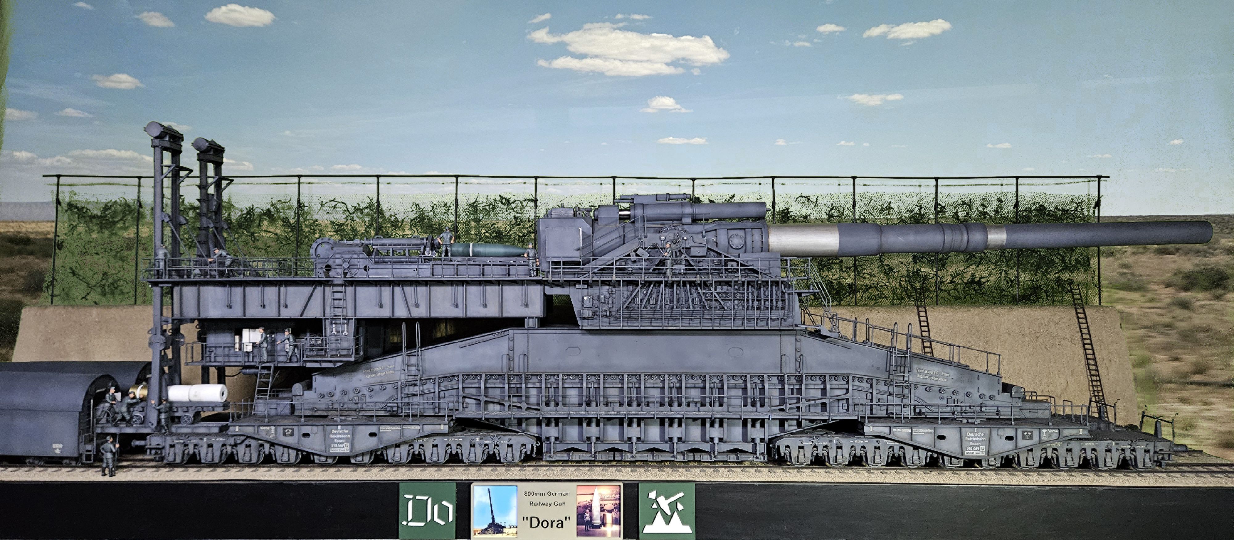

unit logos are 3d printed
unit logos are painted and installed along with the name plate
the name plate in place with the painted unit logos

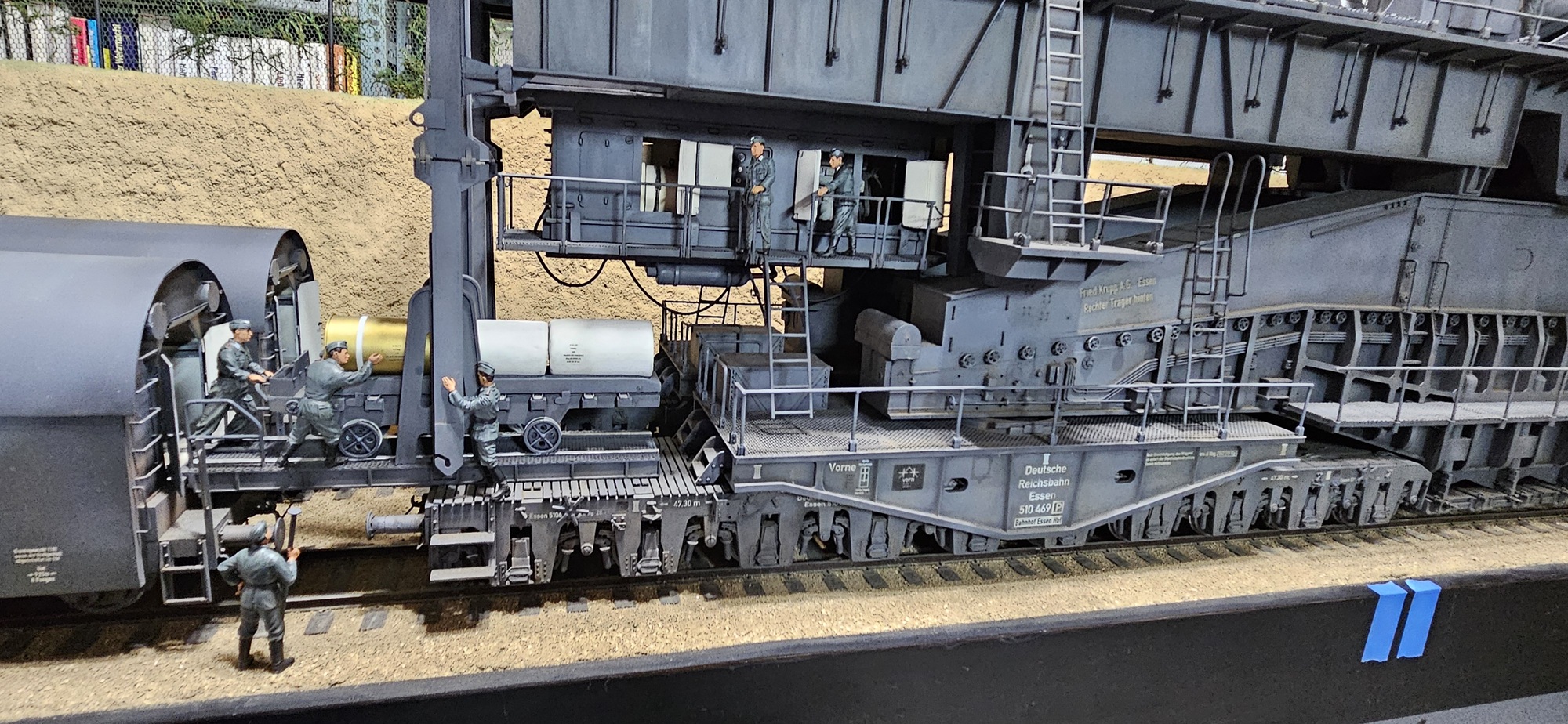

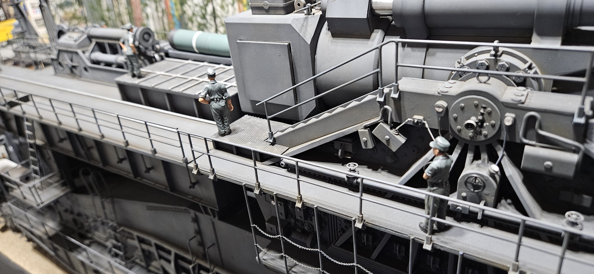

and now I think I can call this finished, it was a long journey but finally got finished. lots of work went into it and Im proud of the final result. dont now if I will be adding more figures in the future, will see...
want to thank you all that followed the evolution of this build and hope to see you Im my next proyects
