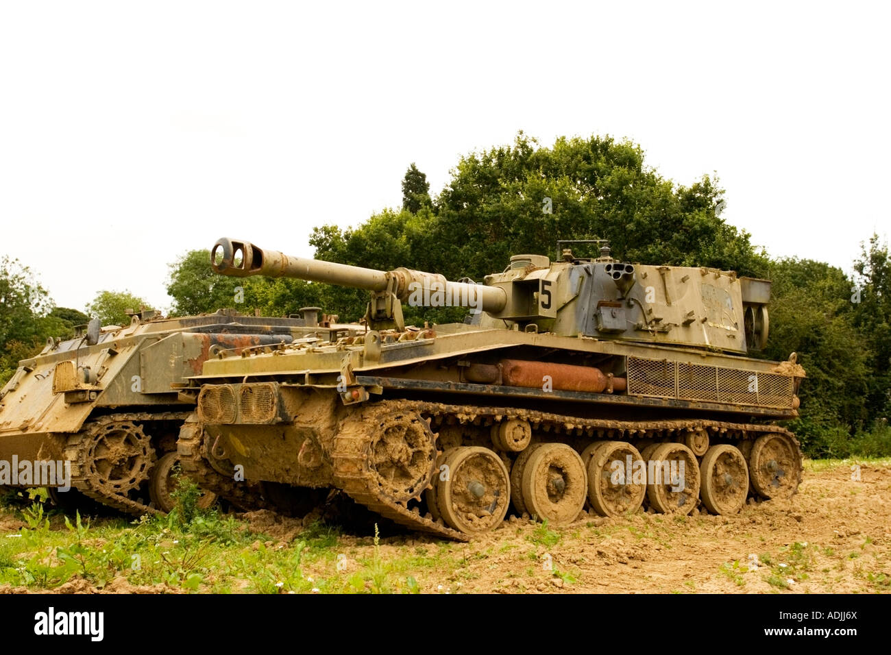

Then there is this photo - one of my favorites. MUD get friggin everywhere. Wasn't taking it personally Tony, just answering with enthusiasm!
Here is the thing - Everyone can build their model anyway they see fit - no skin off my back. But over the years I keep seeing tanks only last 2 weeks, paint doesn't chip, My sargent won't allow my tank to get rust, on and on and on. It gets old. Tanks drive in the ground, not on it. Paint chips, rust happens and not every army in the world had the logistics train of the US military in peacetime, let alone combat on the Russian front in February 2500km from home.
I have probably spent more time looking at photos than building and finishing models - can't, won't shouldn't just doesn't apply.
