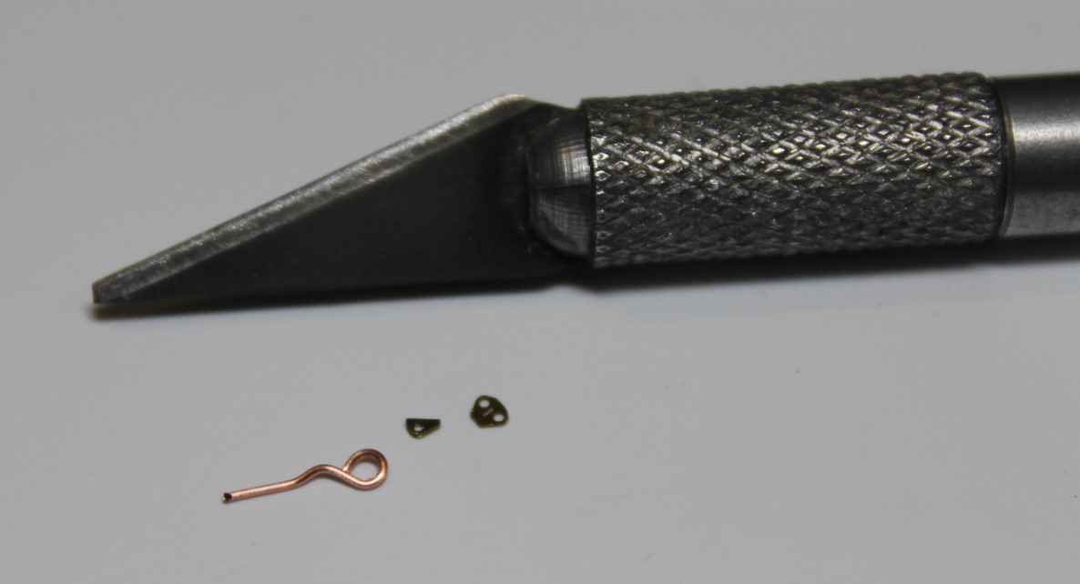

The kit does not include anything but the thicker anchor chain. The other one is going through one of the links and then through the eyelets left and right. The three eyelets (don't really know what the proper marine term for these is) come with the aftermarket kit. The photo shows one of them, as it appears on the PE fret. It must be folded along the median line, then you get the correct shape, with a 0.5mm hole in it. Perfect for 0.5mm copper wire.
How many of these must I produce? Only 9 ...!@#*$(#&%^*#&%^$#*&^. Three that can be seen in the original photo, two other bow anchors x 2 each, plus two more for the stern anchor. I have done 5 so far, photos soon.

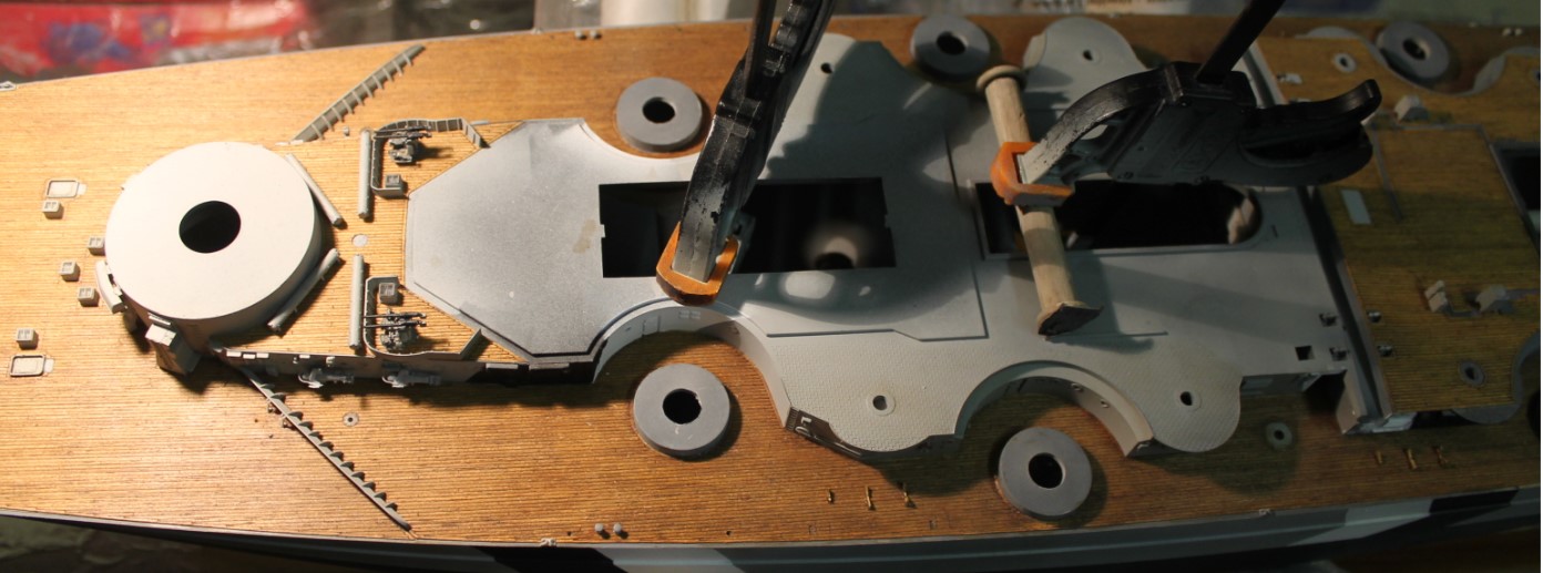

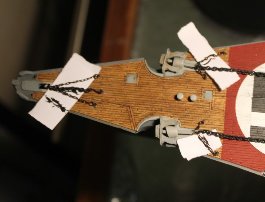

An update - more stuff going in on the main deck. Anchors, chains, missing PE bits and the first level of the superstructure. Some PE parts are not painted prior. Easier to do so when in place, at least that's how I find it.
Some pieces of paper to protect the deck from being panted over.
Stuff at stern - most of it unpainted PE parts.
First level of the superstructure. Comes in two halves, the bow facing half is clamped, the stern facing half was done yesterday.

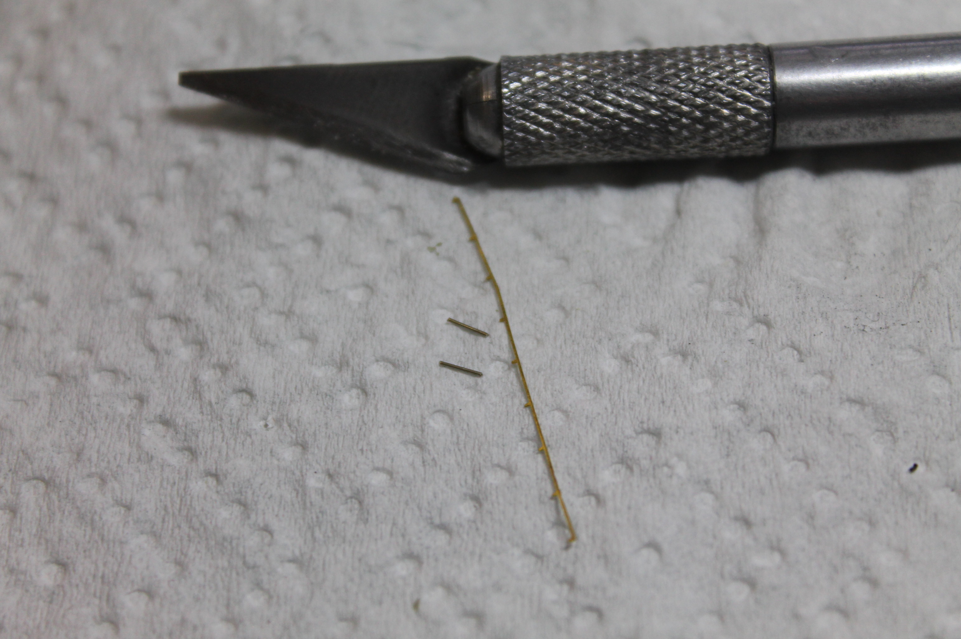

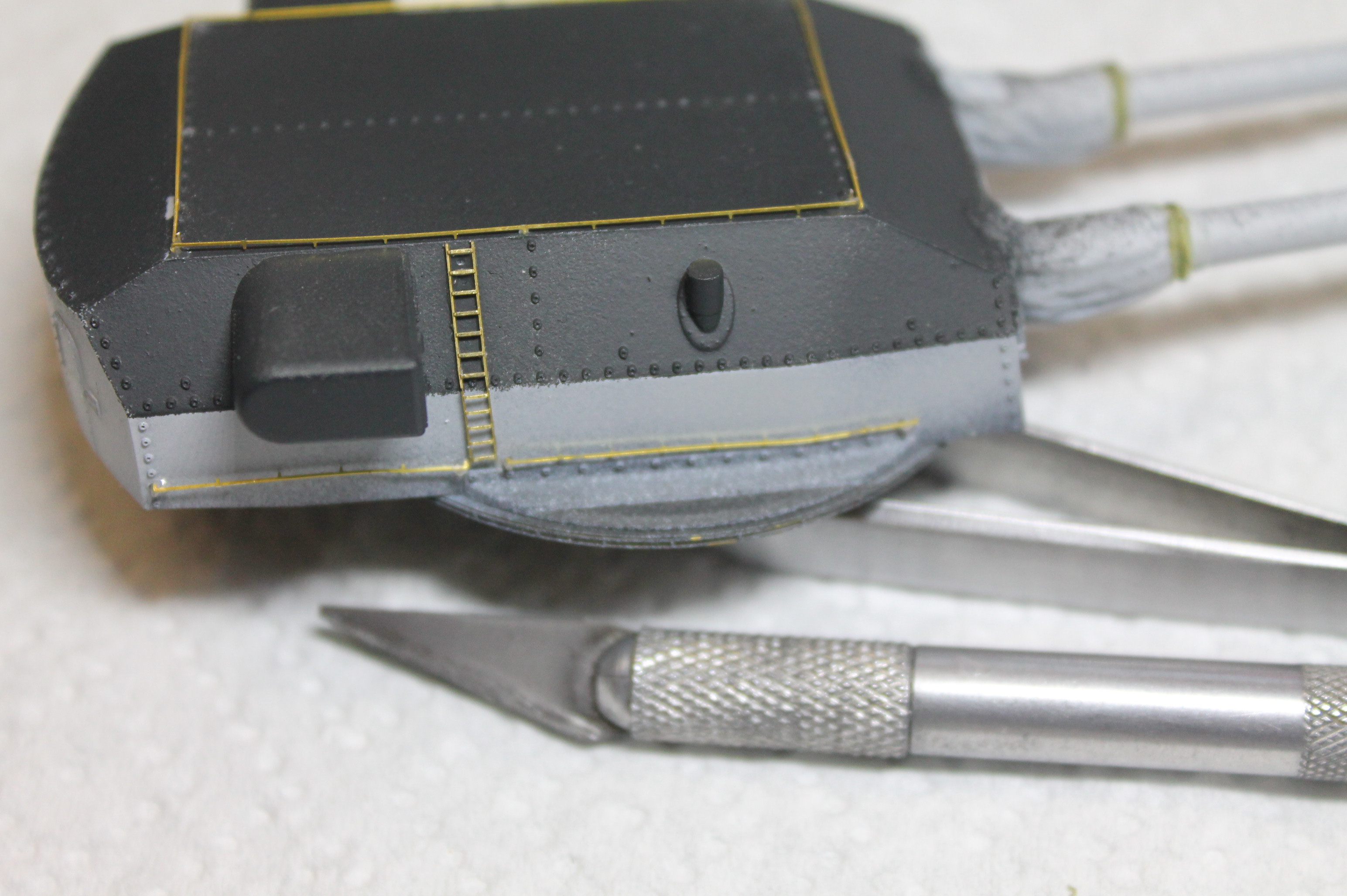

Working on the big turrets - 15" guns. 4 pieces of massive turrets, two guns per turret. Slight differences in terms of hand rails. Turret A - Anton was the only one without a range finder.
Working with PE is not my idea of fun, but in the end it's worth it - having said that, the pain is infuriating, especially since whoever designed the thinnest pieces of PE ever, never spent a second imagining how to glue them to the turrets.
After a couple of attempts, I decided to drill 0.3mm holes, use 0.3mm pins (Albion alloy tube - splendid stuff), then glue the rails to the pins.
One more photo, with all PE in place using the pins.
Pins were not used for the ladders (one on each side), only for the rails - 4 on top. then 2 x 2.
Two other turrets have a different rail configuration, with three smaller segments at the rear (on top) instead of one segment.
Have a few more turrets to do, happy with the drill & pin stuff so far.
