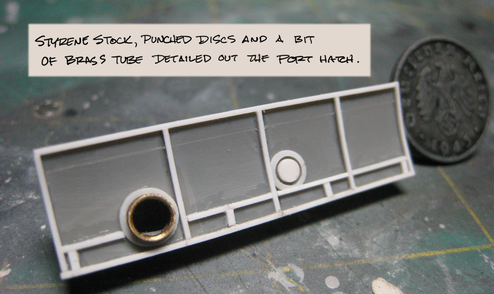

Excellent as always chuk, I'm interested in you hole punch set up ?? i have some hand held punches but if i had tried to do what you did here, punching a hole near an edge i would have got swelling and a bulge on the edge. Are you punches like a pastry cutter on to a hard surface or do they have matching dies ??

Paddy, I have both Waldron punch sets. They have a two-part die base- aluminium and clear acrylic, and a matching set of steel punches. I use an overly-large ball-peen hammer to tap the steel. ;) I do the tapping over my cutting mat, just in case I go all gorilla on it! These are probably the best modeling tools I've ever bought- I use them in every build.
Thanks for that Chuk, i wondered how you lined the punch up with the die but all is explained here
http://www.hyperscale.com/2011/reviews/tools/waldronpunchanddiereviewbg_1.htm

Punch sets are so helpful, I just wish the Waldron punches werent so frigging expensive. I was going to make my own set, while working at my last job since I had access to a machine shop, but just never had the money to get the required materials, and now I dont have access to the equipment.

Aw, thanks, everybody! UMM USA makes some nice punch sets as well- might want to check their prices.
