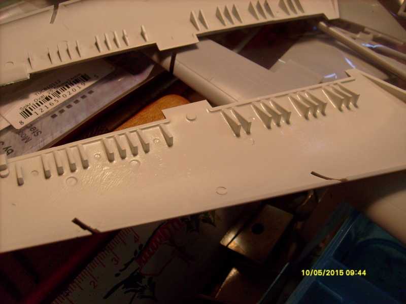

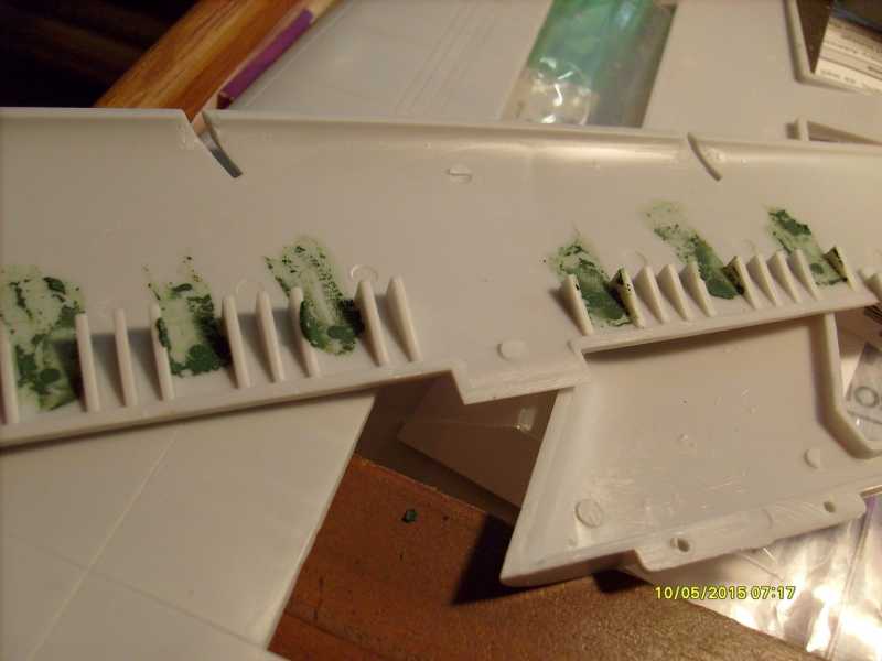

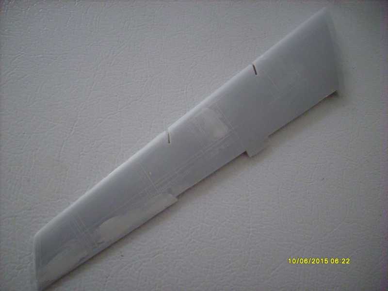

Pin marks on the flap area ... I'm trying Green stuff to fill them
Then there were some purdy good sink areas on trailing edge of wing ... :pilot

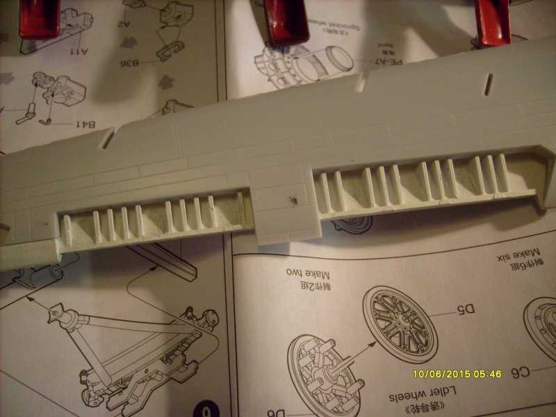

Thanks Sack ... I'll see what I can get done on this one today ... I must do a little research 1st ... I just painted the inside of the flaps flat white ... Waiting for the dry ... Yep found what I was looking for ... ? Camo or Dark gray ?
Wings ....

Oh nice pin marks & sink marks thar Gerry! Don'cha just love it when ya have ta cover up detail to get rid of them? Looks like a rescribe is in order... :hmmm

Thanks for the :zen :zen :zen for the sanding ... but it's only a 1/144 think how big the wings are on my 1/72 ... :pilot
Re scribe ... I finally have the right tools for the Job ... just they want the inside of the fuse black ... I don't think you'll see it ... Weird ... :woohoo: on the Camo back during Nam they ran camo ... those may have been G's ... but this one looks like a H ... So Camo-shamo ... :pilot

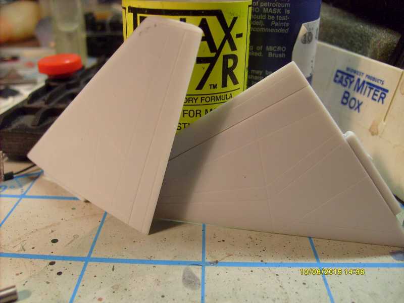

Time for a Update ... this is the first time I've built 3 or four models ... at once I can't even keep up with myself ... So here's where I'm at on the Buff ... Thanks MP for the sanding :zen :zen :zen

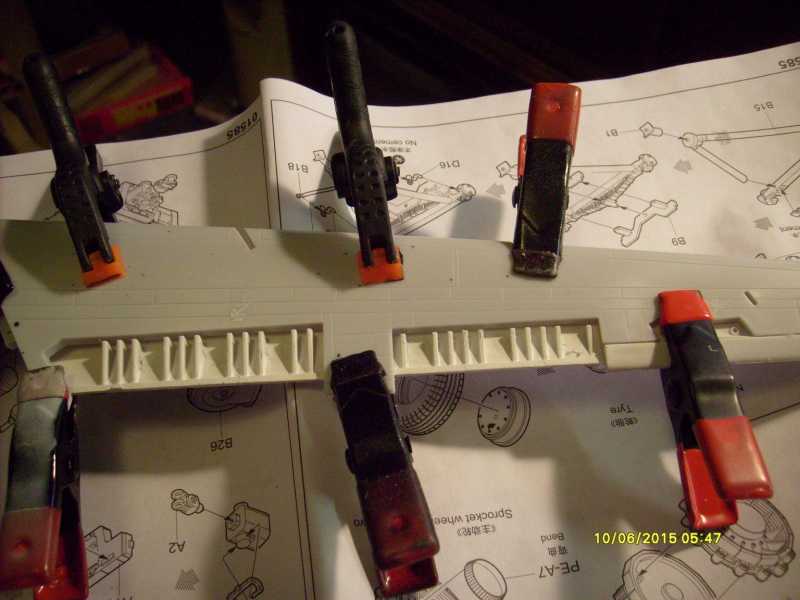

I camped the two halves together and lit them dry ....
I sanded them down ... they look Ok .... :skipper :woohoo:

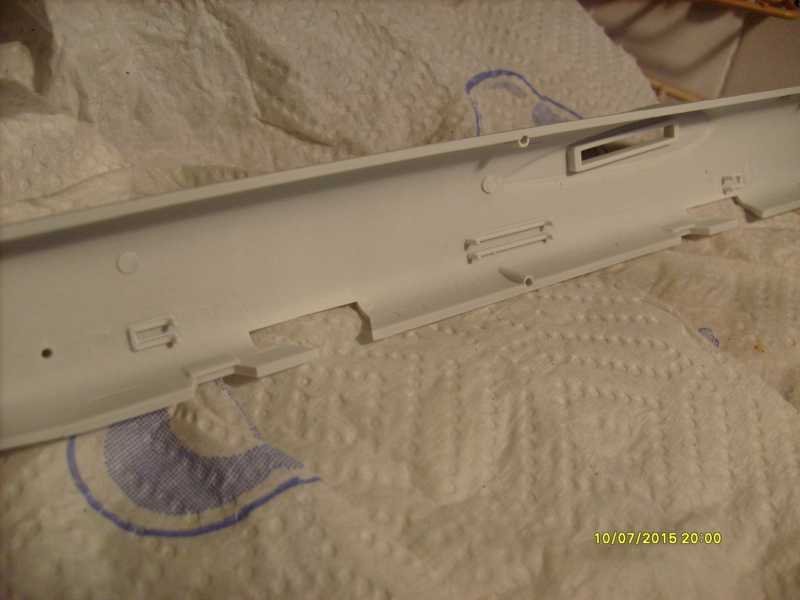

And I Cemented the stabilizers now I just need some Flat black spray to do the inside if The Fuse Black ... not sure why ... just what the destruction say ... :woohoo: :pilot
I didn't get much done ... last night so I painted the inside of the wheel wells with Flat white paint tonight I'll try to get the inside masked & painted Black ...
That is all ... :D
Now why on earth would they paint the interior black? I can see white in the wheel wells to help see oil leaks, etc better :hmmm Gerry, ya might wanna check your references before ya commit...
