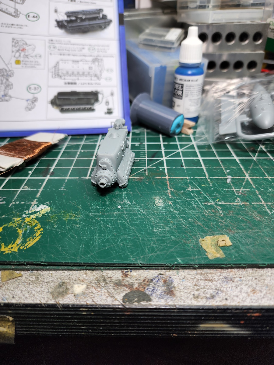

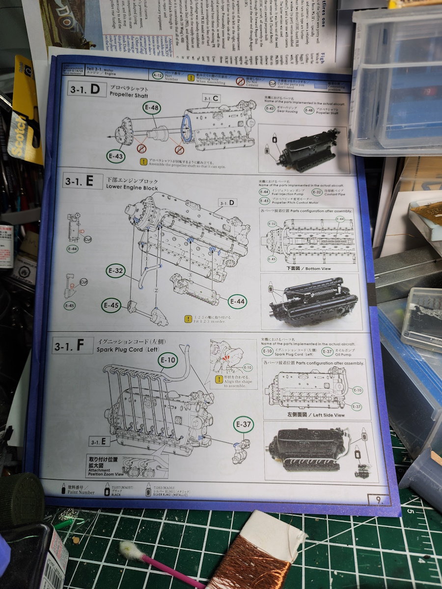

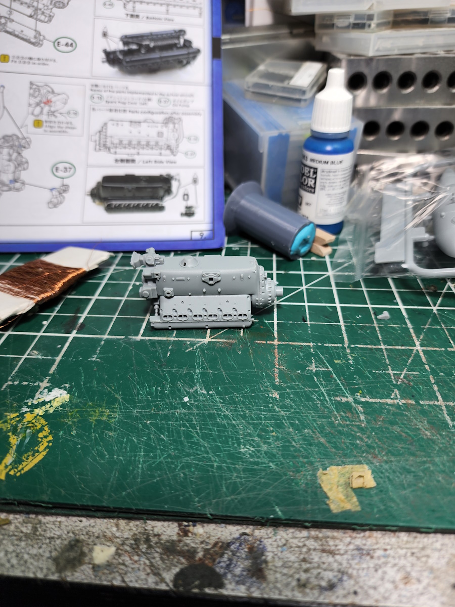

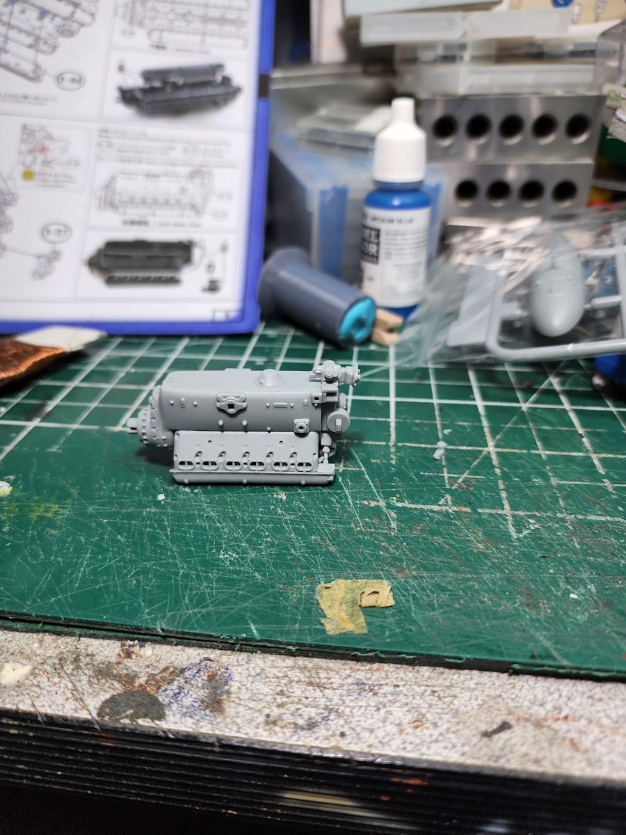

Okay after watching Paddy's builds I have gotten the urge to do a FW 190. Unfortunately I have not yet sourced one, but I do have a ZM 1/32 Bf 109 G-4/U4 to build. I have some extra decals for it, but the bird I want to build has a tall tail and this kit doesnt. I have the other version of the kit coming and maybe I'll luck out and it will have the tall tail. So right now its a short tail bird flown by either Hartmann or maybe a slightly less flashy bird from the decal sheet. When in Germany I had a chance to meet Hartmann, but my wife wanted me to stay home and do some chores so I missed out. One of my true regrets. So starting at the beginning with the engine. I assembled it according to instructions, but either they have mistake in the instructions or I did not read the part numbers properly. So I split the cylinder banks apart and swapped them around. Lucky it was freshly done and not left till much later. Carried on and then painted in prime which looks plenty good enough to act as the engine colour. Then sprayed all the pipes and wire bundles aluminum. The cockpit will be a bit as I have a Quintas cockpit upgrade coming. Trying to think where you would need the pistons, but there is no easy way to make them viable and so they are really a bit of a waste.
If you are interested in seeing the instructions they are here https://www.zoukeimura.co.jp/en/download.html#dl_sws18

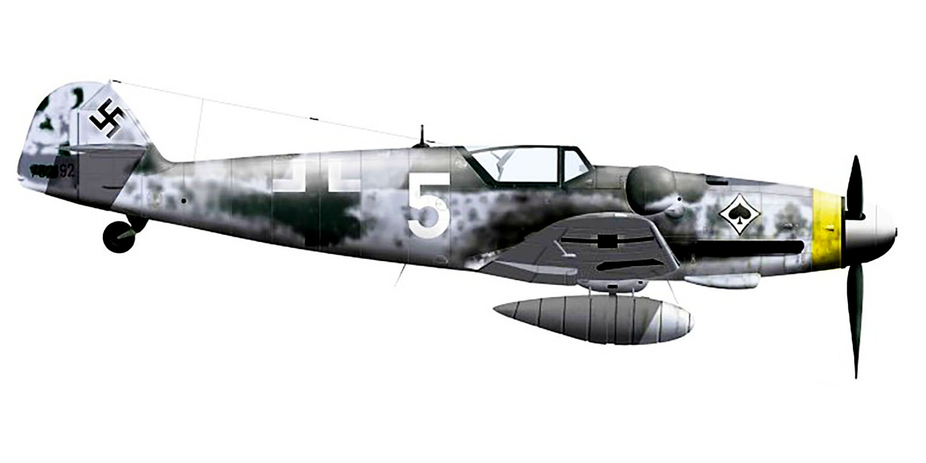

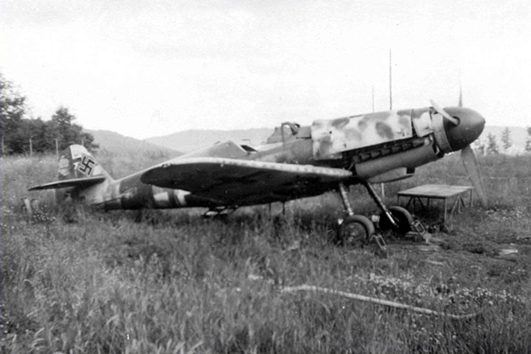

Okay nothing today, but yesterday I did paint the engine mounts and some other parts RLM 02. I hope to do some more tomorrow and will have piictures. Until then I have decided to do this aircraft from 3.JG53 Yellow 5 WNr 782192 Bad Aibling Germany 1945 0A. According to the Eagle Cal decal sheet this should have a spiral spinner and a Gelb band on the tail. The print I found does not have that. Although looking at the picture it could have a yellow band on the tail. Will check my decal sheet to make sure the picture and print are the same aircraft.

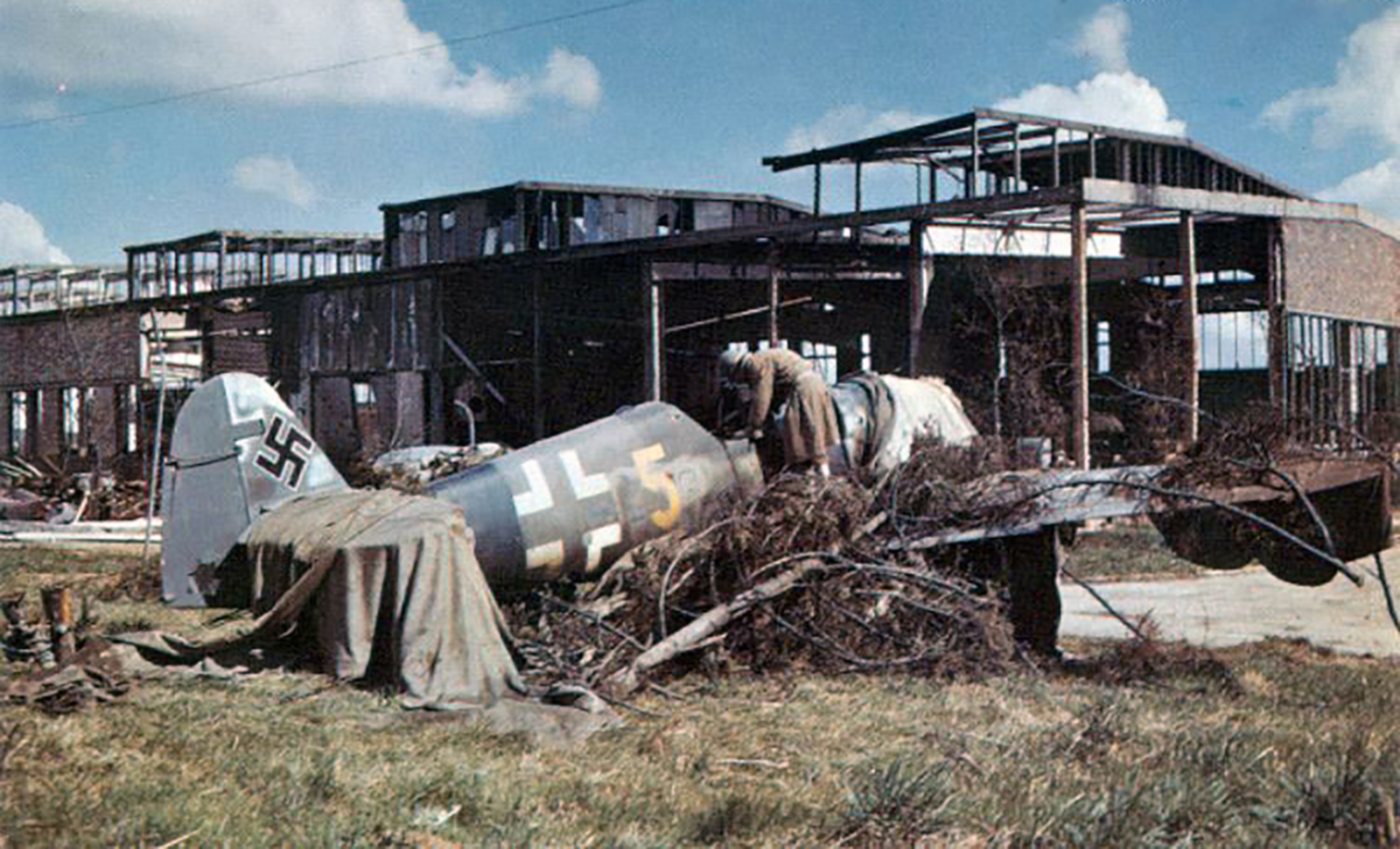

You are right James, it doesn't look like there is any kind of band around the tail. Notice the flaps and radiator vents are all drooping as well.
If you look up to the nose in the photo, there is a lighter band behind where the prop blade is located. A yellow band around the tail should be about the same shade and it just is not there. Looks like it is just the camouflage colors in front of the empennage. The large side view you have just below the EagleCals pics seems to be more spot on.
The photo caption says white five over painted on a white Severn so maybe the original white five did have the band.

Some caption refer to the White five pic as yellow five and some white five (same pic) ? am i missing something ?
This however is definitely yellow five
Messerschmitt Bf 109G6 3.JG53 Yellow 5 Attenbaum 1945 01
Also yellow 5

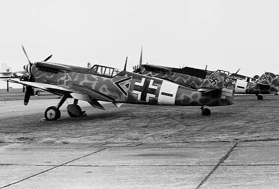

You do have to be careful because in among the period pictures i found this :)
Merlin engine Hispano,s :) with what looks to me like a Catalina PBY-5 tail on the left. The obvious answer would be the BoB film but i dont recall this camo on the BoB aircraft which were all RLM76 Blue and were quote "yellow nosed bastards .... coming down now ".

I get a vibe they are not the same #5 aircraft. Yellow 5 has a solid painted rudder, White 5 has a scatter camo.
I see that and yet even the print they show has a white 5. More research.. Eagle Cal did an amazing amount of research into Luftwaffe subjects so I feel i have to trust them some, but the photo does not lie either.

Well cant find any more pictures of the bird I want to do so sending an email to Eagle Editions to ask if they might have more info on it. If they dont will go with the data I have and not paint a yellow tail band. The over painted lower cross' on the fuselage will be interesting in their own right. From the picture I am also leaning towards no spiral, but maybe the 1/3 white spinner. Might be my imagination but it kind of looks like a demarcation line at the top of the spinner and almost the bottom. Will still do a white 5 despite the caption saying yellow 5 as the 5 looks a bit more stark than the yellow nose band. Also something not show on the decal instructions or the profile I showed that to me stands out on the photo is an over painted number behind the 5. Maybe a yellow 5 that was repainted?

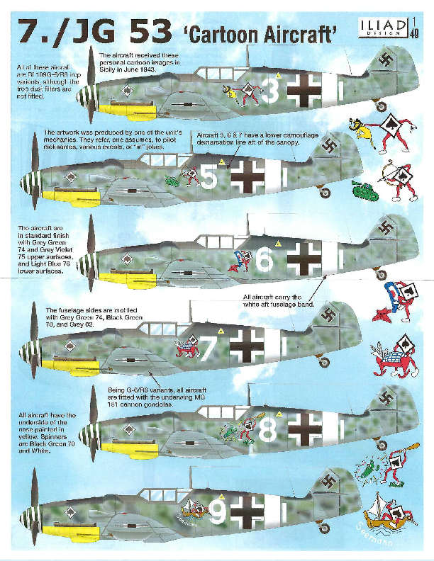

As you mentioned Paddy, this is the thing i find very very enjoyable. Getting a bird and decals and then finding a ref photo or more and trying to come to a satisfactory compromise on accuracy. So many neat schemes to do. I'm really itching now to pull out all my Revel Bf 109 G6s and doing the Mediterranean paint jobs of 7 JG 53 in Sicily. They were so colourful. This is the decal sheet I have for them but in 1/32.

Agree James the Aircraft in my opinion is White five and i also agree it was white seven before being over painted . This implies that the aircraft in the picture is not the original white five so that might explain why the tail band is missing ?
