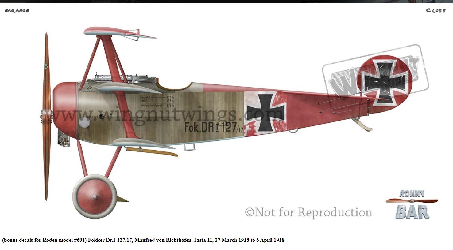

I sat down started working on the Roden kit, I could never display these two together they are so different. Roden has some weird wing details that I'm not even going to start scrubbing off.
I guess I got my bluff called on a pair huh.
BTW, I got these decals in the WnW Albatros DV "MvR" version, it was a bonus set along with Albatros DIII decals. I was able to find a link to the instructions. WnW website is still hosing the files but there doesn't seem to be any browsing of the old site.

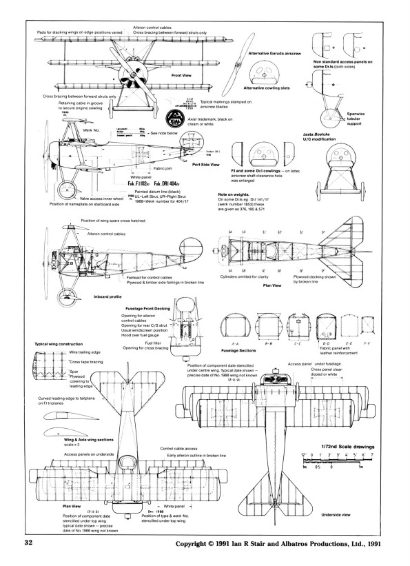

The triplanes had faces so I have references. What are you referring to about the wings?
I have a lot of the windsock magazines in print and other formats. They are so well done that you should have some form of them available.

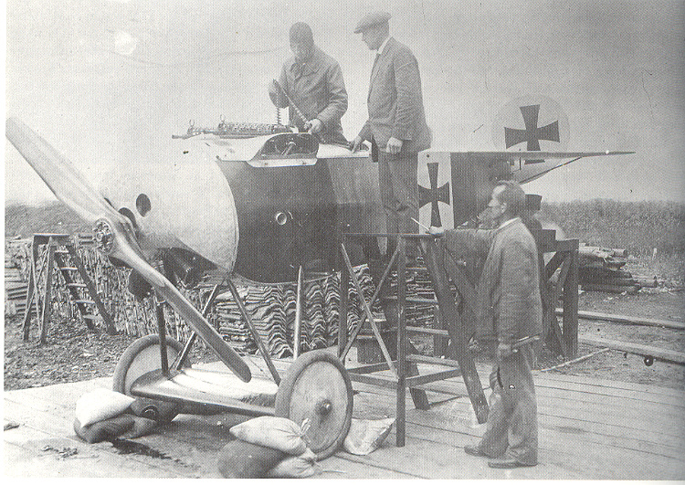

Not polished but the dope paint they used was not a flat paint. It was usually a clear gloss. Like the old model airplane dope that my dad painted stuff with as a kid on the balsa airplane kits. I think the WWI German stuff in the Air Force Museum were all gloss.
I think after aa few sorties the gloss would have retreated pretty quickly on a material base. Even the polished WW2 fighters and bombers had to be regularly maintained to keep gleaming and thats metal! Sun, wind and rain, especially winds at high speed in high altitude sunlight would have had a dramatic effect. Not to mention not much time at this end of WW1.

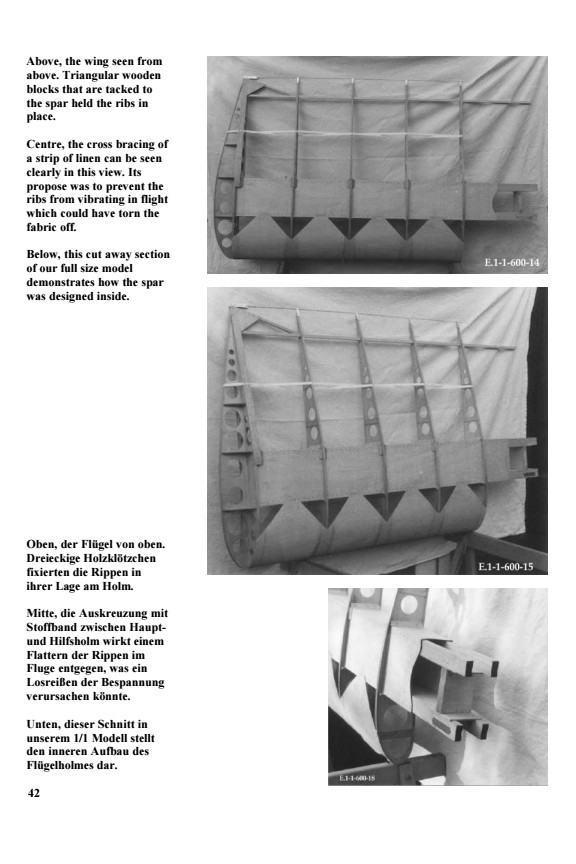

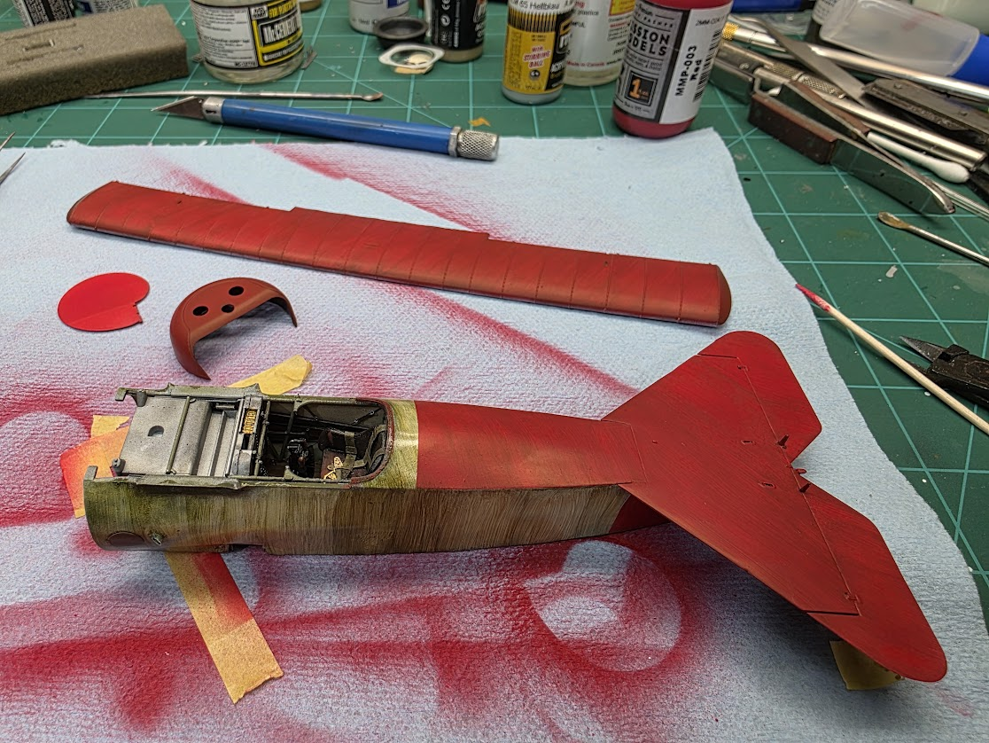

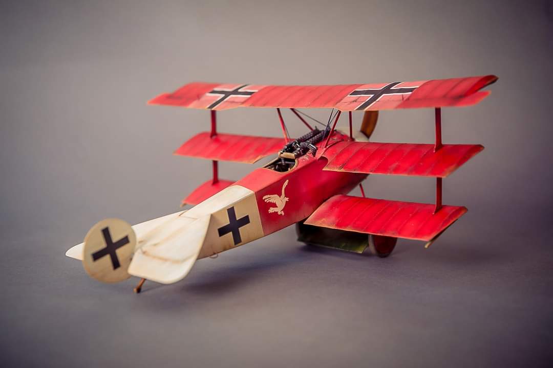

Nota lot of shine happening anywhere here... though admittedly I am a 'not much gloss' kind of guy :bigrin:

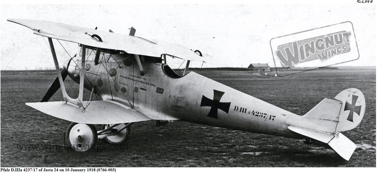

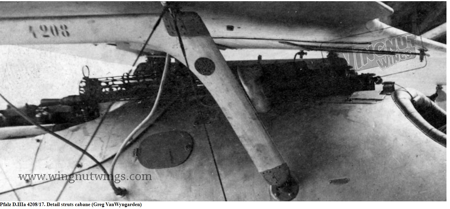

And here is a good example, a white Pfalz with a very matt finish and quite dirty too.

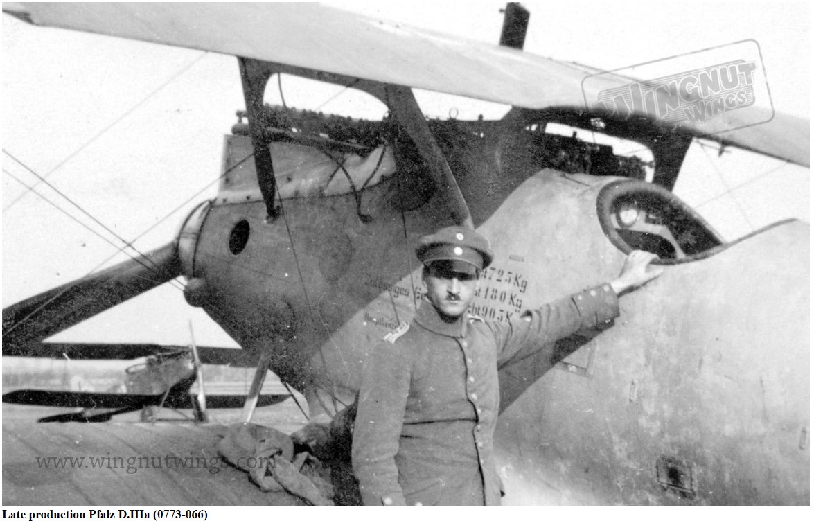

and another, all very dirty and matt.
