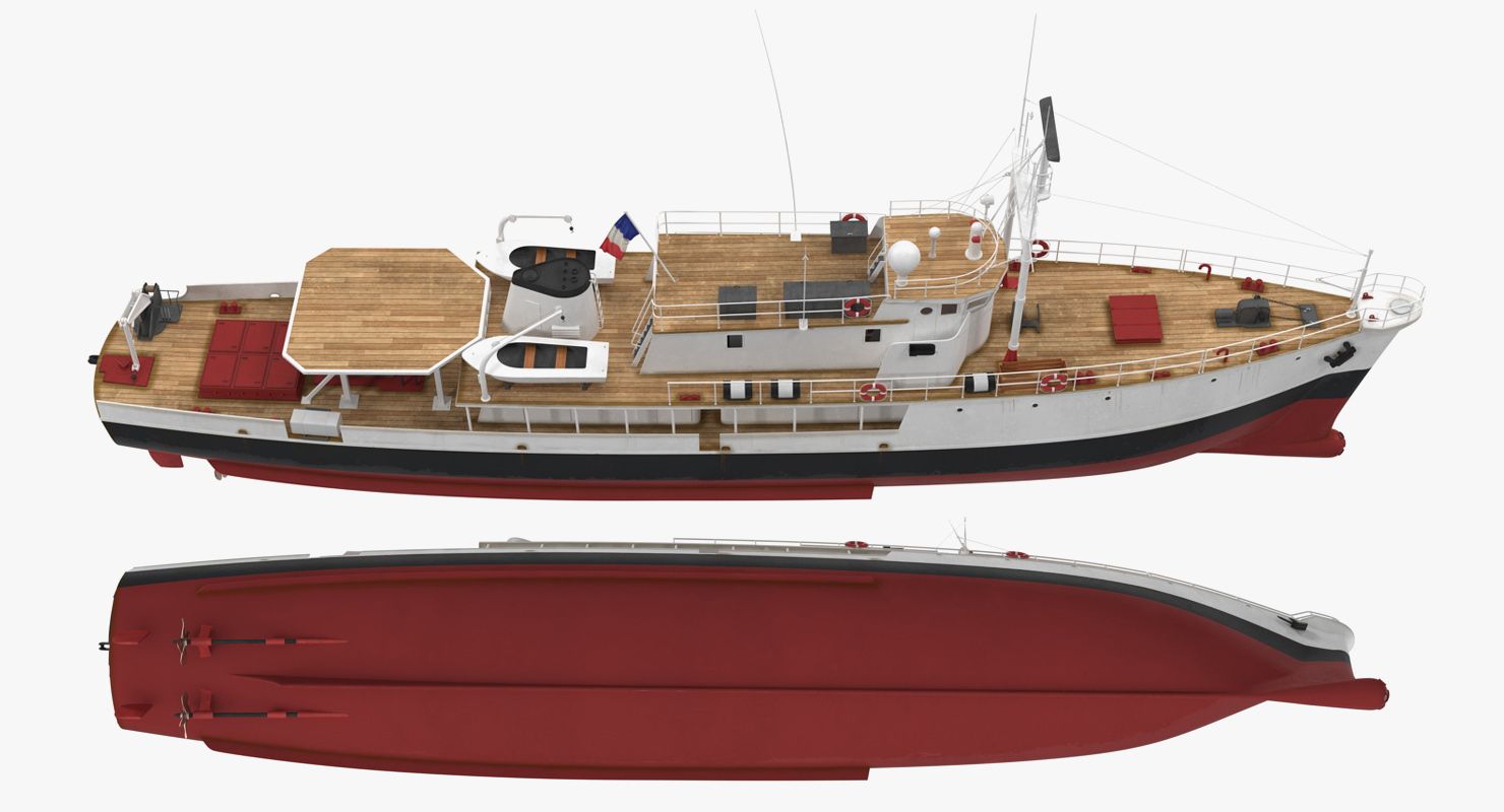

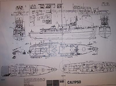

A picture, a 3-view plan, some math, some measuring, some music, some drinkies and some nicotine.................

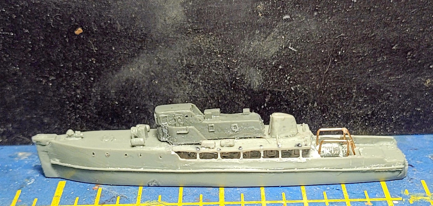

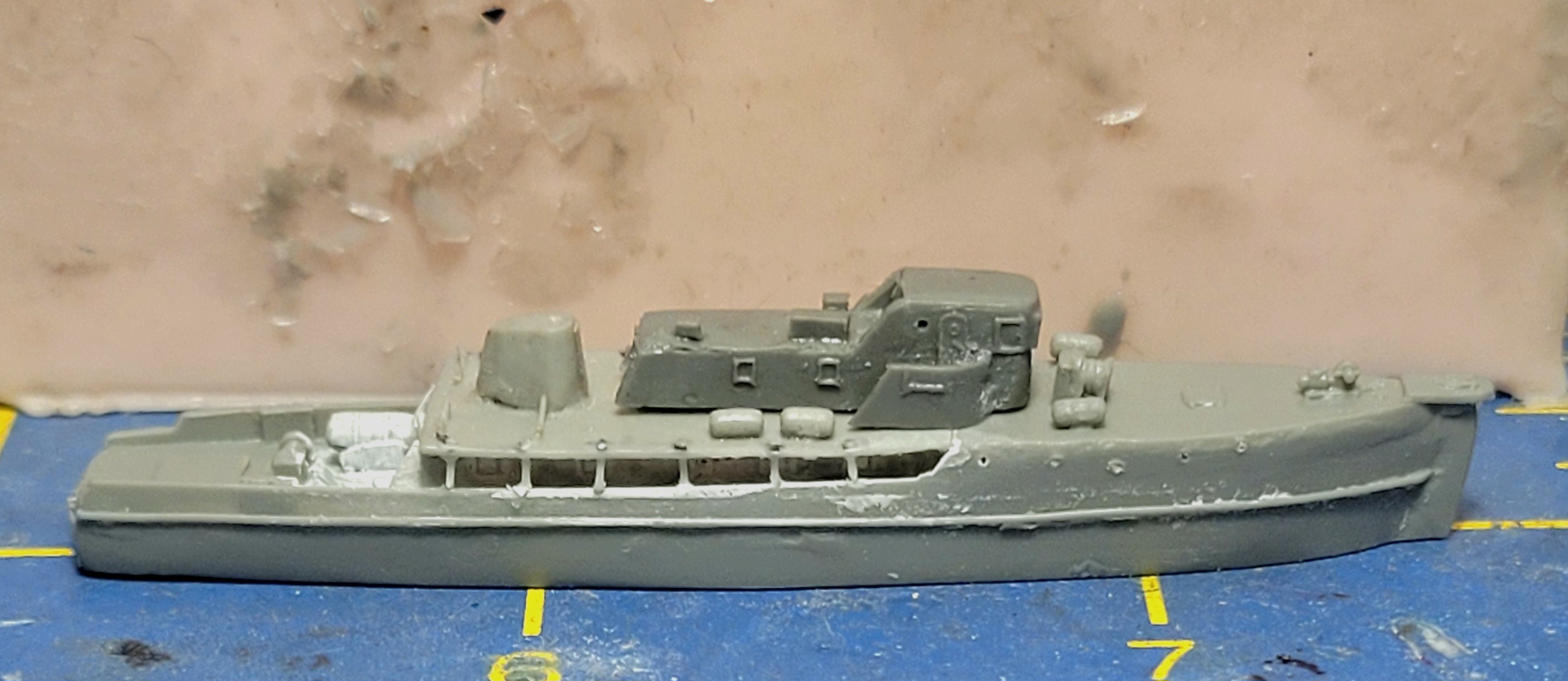

...........................yielded my solution to this Unpresentable 1/700 Present! Want a closer look? Okay, If I must.

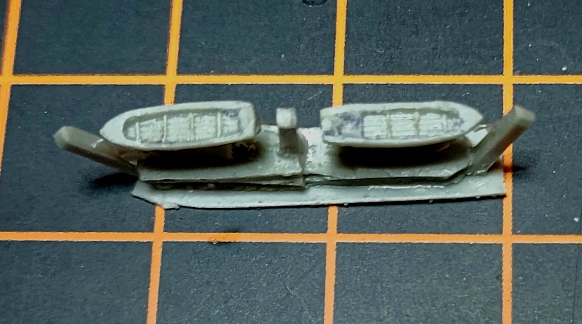

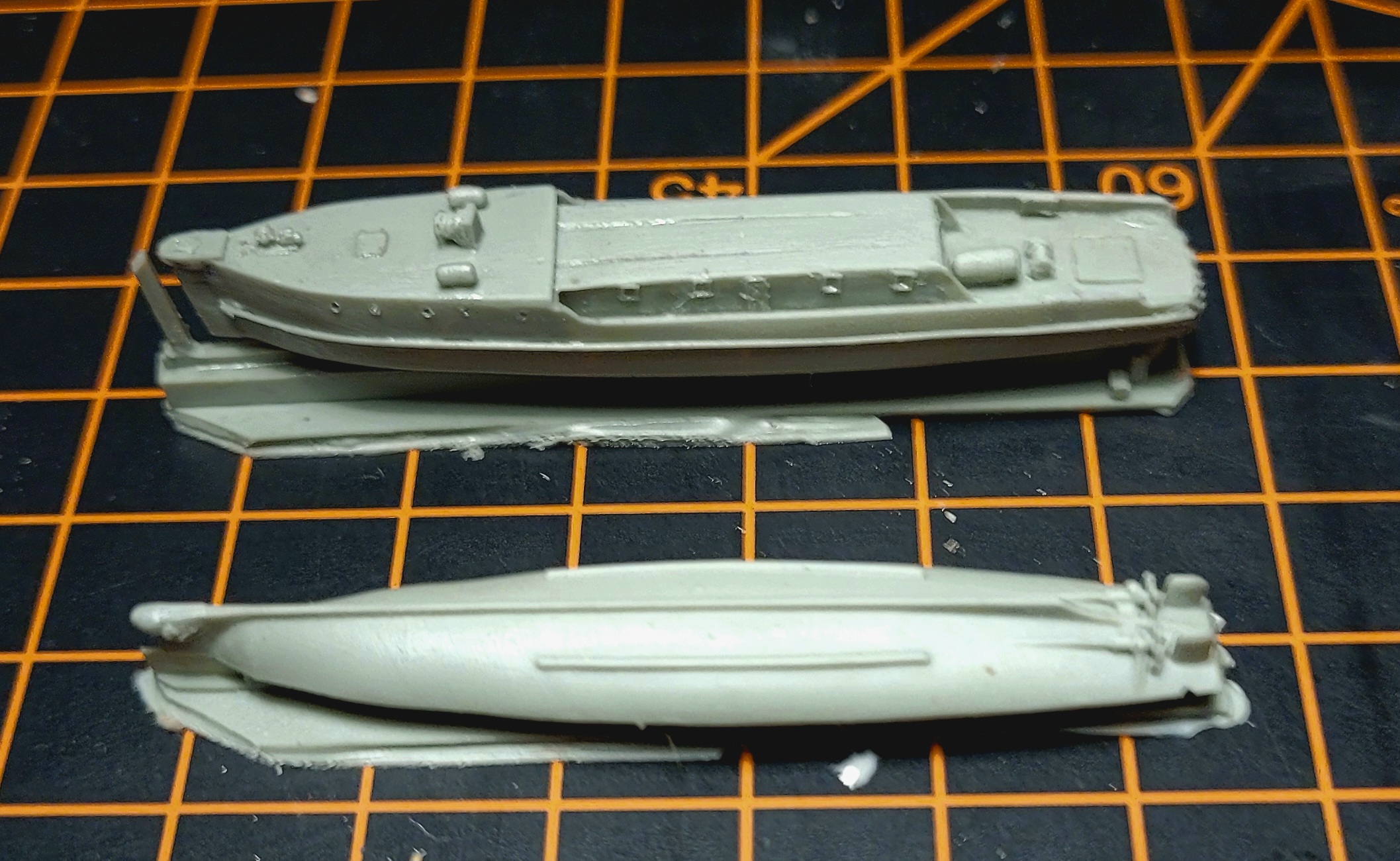

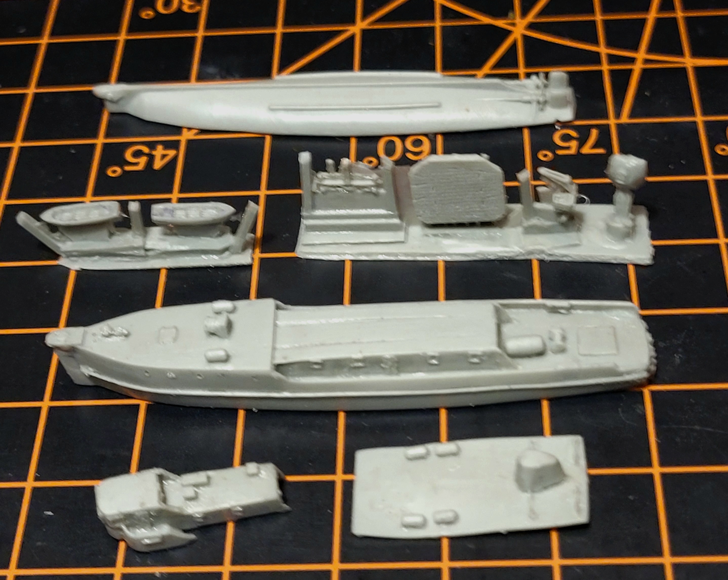

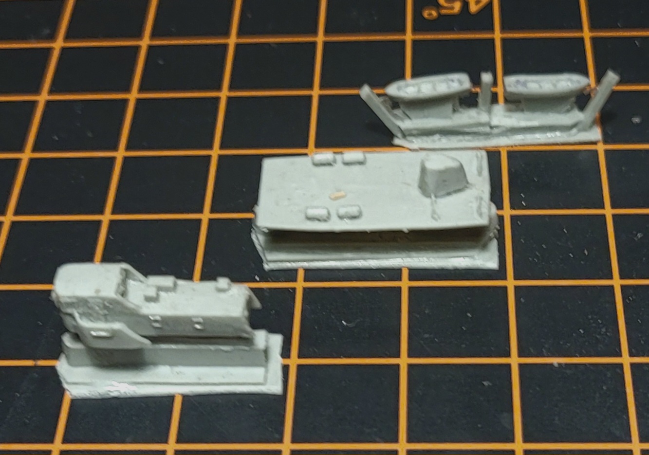

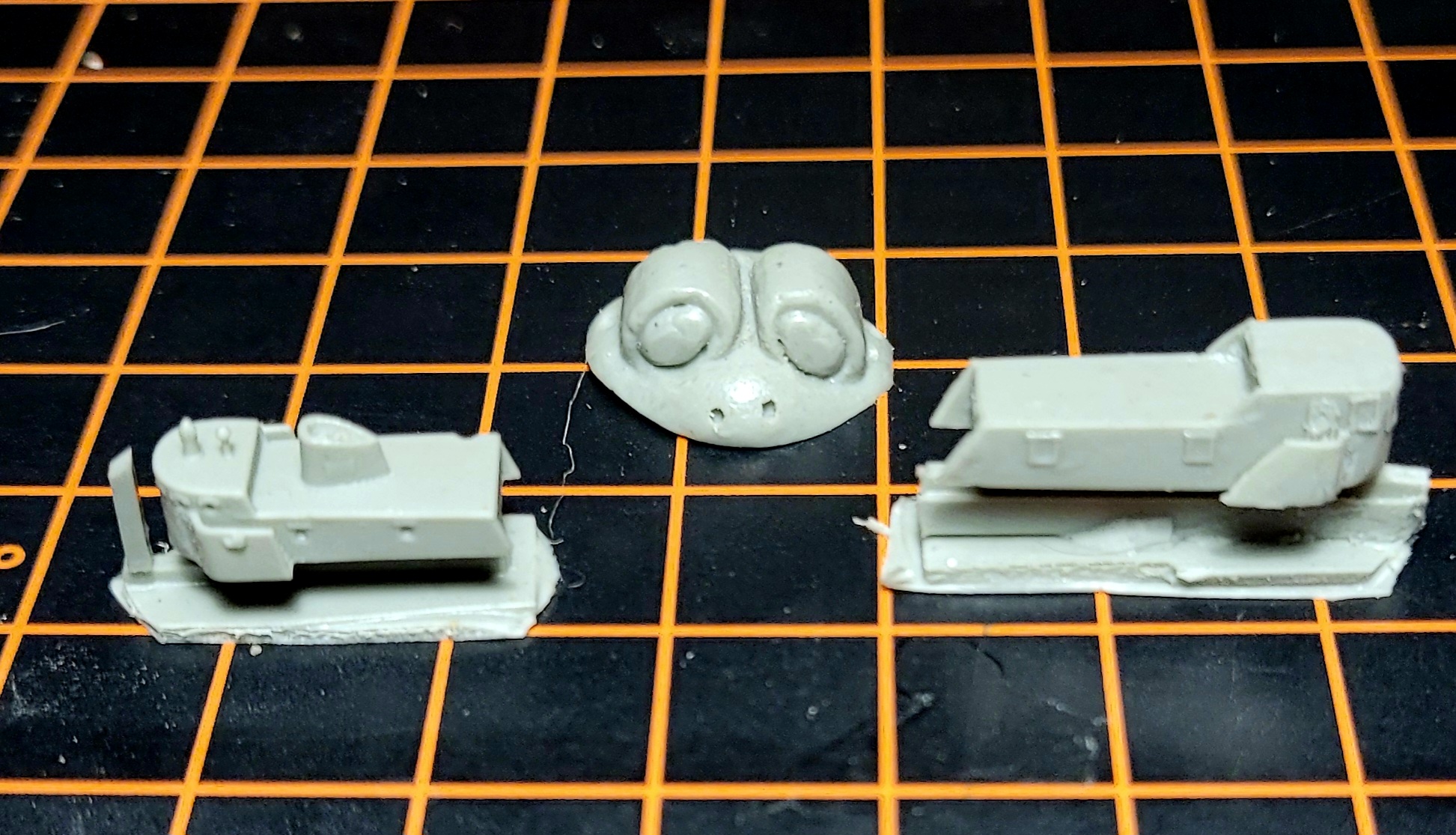

Main and lower hulls, with stern diving platform in the folded position. Add your own mooring bitts. Proper pilot house, upper main deck and proper French 24' Runabout boats. Foremast goal-post top (supply your own posts and radar) properly shaped heli-pad, stern crane and diving saucer.

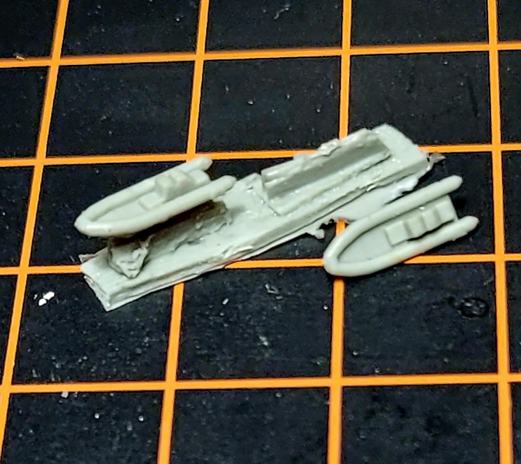

24-foot modern RHI boats that are too big for the boat cradles. Tenders? The original, horrible 3D kit (WRONG) Pilot house and the "Too Big" Pilot house that is, well, too big, but was a shame not to cast. You get the RHI's but not the other pilot houses in the kit.
The first casting was yesterday and I am delighted with the results!
RV Calypso is French, so my Sneaking Frog was included in this molding.
French and Calypso flags are included in my issue of this vessel. Such a beloved and documented ship deserved better!!

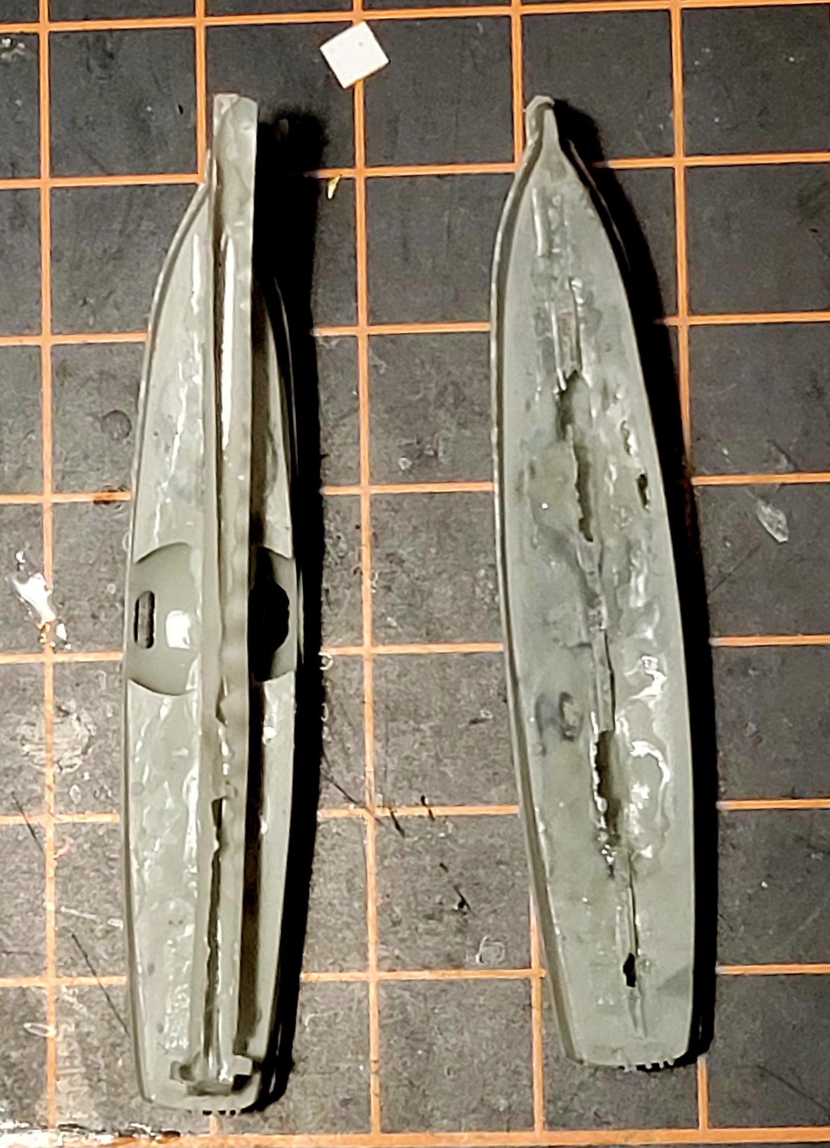

I got so fired up about casting the Big Cutter's hull, I may have skipped a casting step on Calypso. Maybe more than once. OOPS.

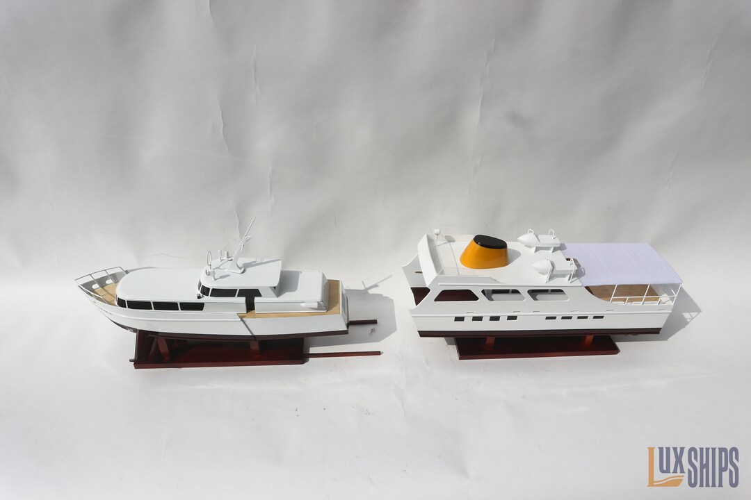

Not this version. She looks too much like a floating apartment house. I wonder how The Duke would have felt about that.
This is the fit of Wild Goose I will make. The vessel where the Wayne family spent their good, quality time relaxing in Mr. Wayne's "Place of respite" Newport Daily Pilot 2018 quote. Powerboat, swim platform, lots of space for sunning and funning with wife Pilar and children Michael, Ethan and Marisa. More Yacht than Condo.
This should make the ol' Pony Soldier smile from On High.
That being said, somebody already built a nice model of Wild Goose.

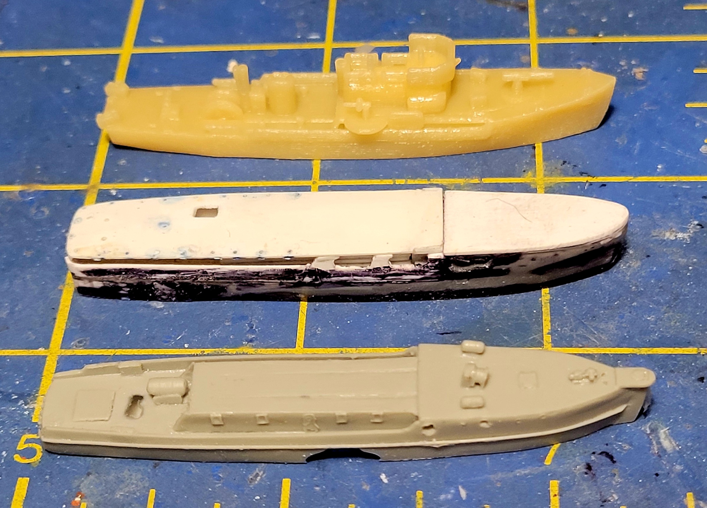

Loose Cannon Models proprietor, Hugh Letterly asked after a waterline 1/700 YMS-1 Yard Minesweeper. Since Calypso got her make-over and I am making a Wild Goose kit, his request seemed a reasonable one.
Shapeways markets this same 1/700 model in tan fine detail plastic. I will comment that their waterline Yard Minesweeper is a fine little model. The guns and mast are a little chunky, buy otherwise She scales out to 165 feet almost exactly. At a $15.00 price point, it is unlikely TLAR will produce this vessel in this scale.

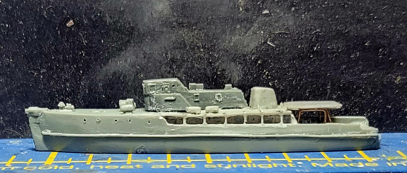

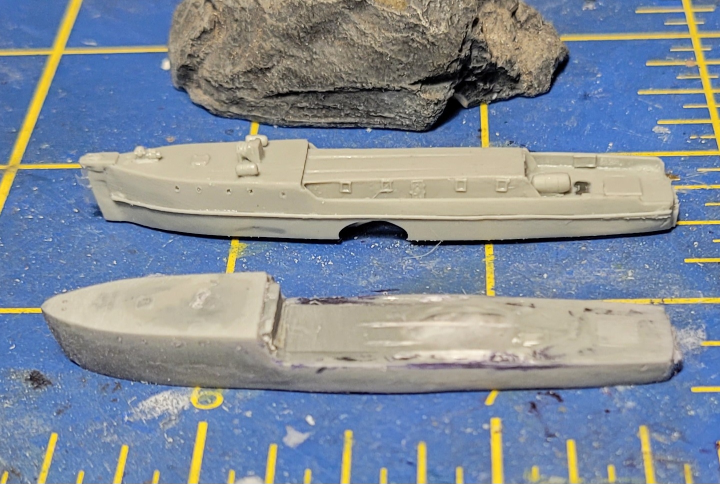

I'm working on the instructions for the Calypso kit. How-to's tips & tricks. One solid "warning" so far. I cast another hull so I could get a start.
None of the tardy Christmas present recipients are mind readers.

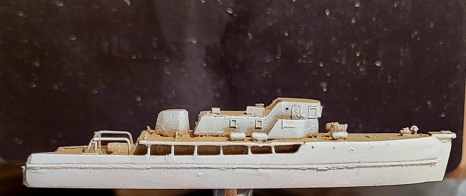

You can see better dry-fitting of the bridge was needed. The support frames for the helipad are a cast-iron bitch to get "just so".
Level fore and aft and port to starboard took lots of, ironically, dry-fitting. I wished for a helicopter to play with, UM! Include in the kit, but the 300D isn't made in 1/700 scale that I can find. How about an MH-6A Little Bird? AH-1Z Cobra? A Hughes 500D would be more accurate than what came with the 3D printed model. The Undersea World of Jacques Cousteau meets Magnum P.I.?

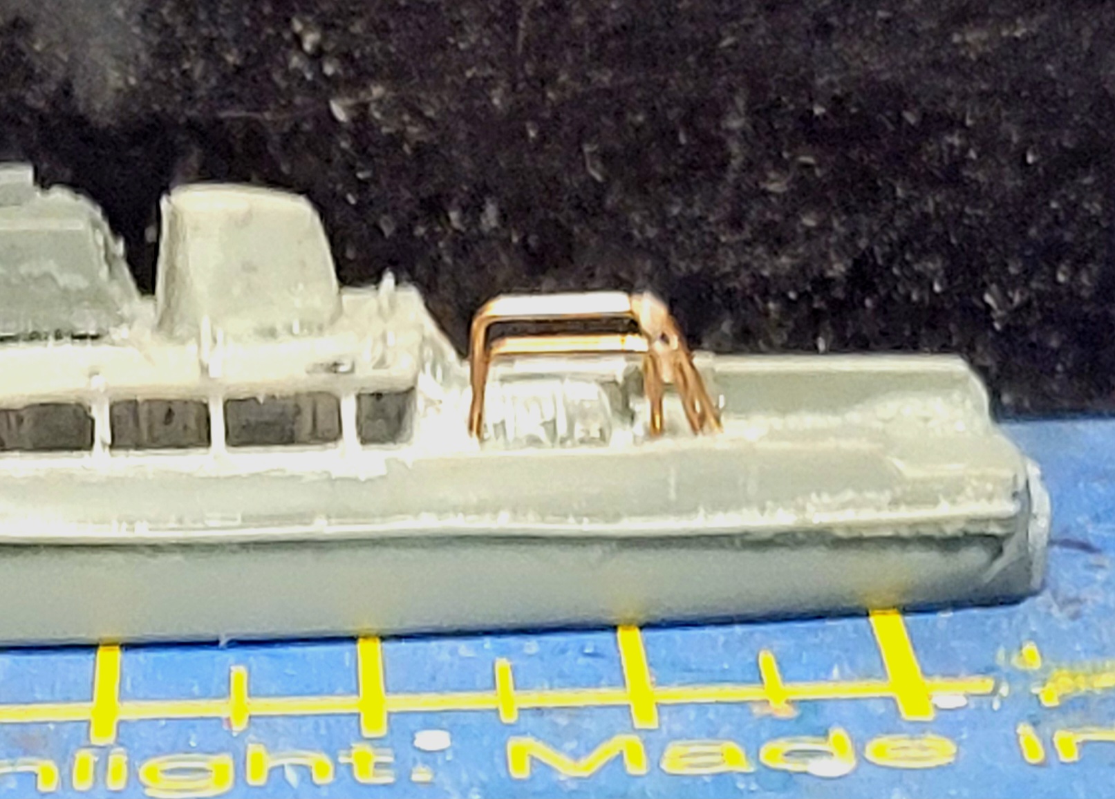

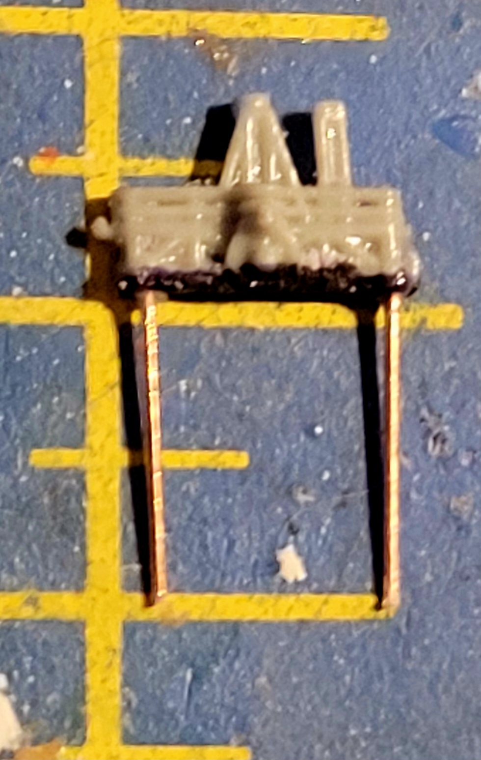

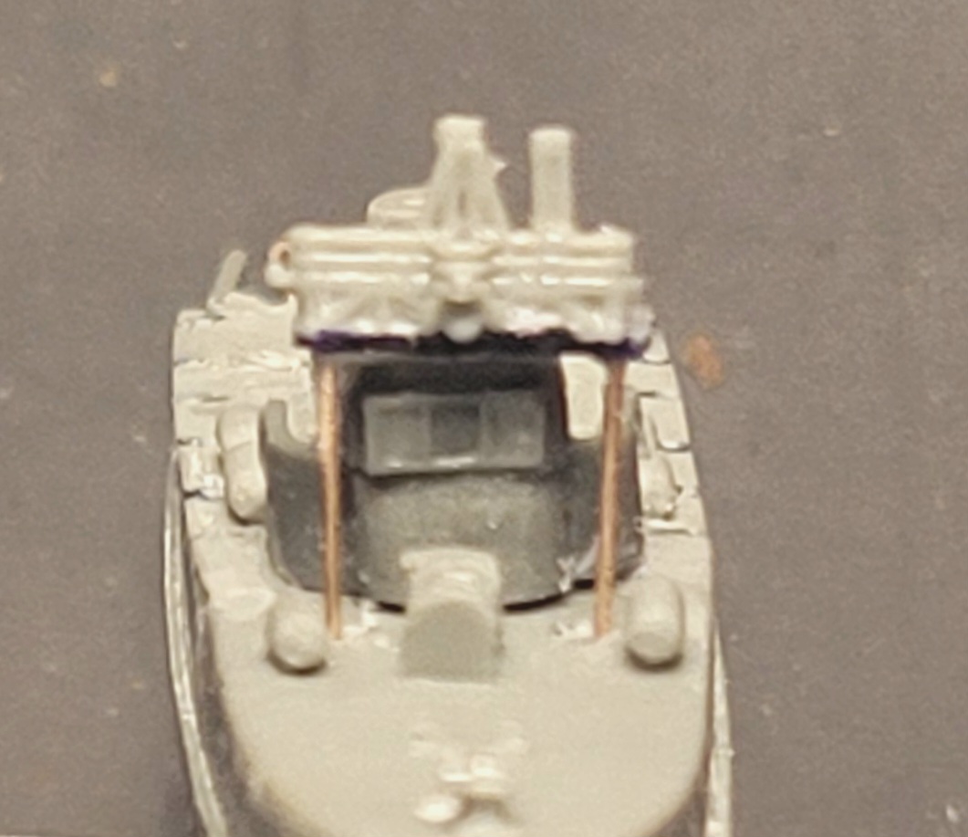

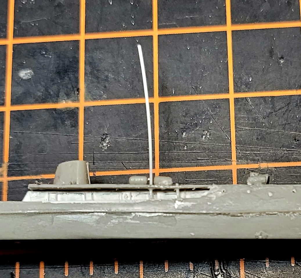

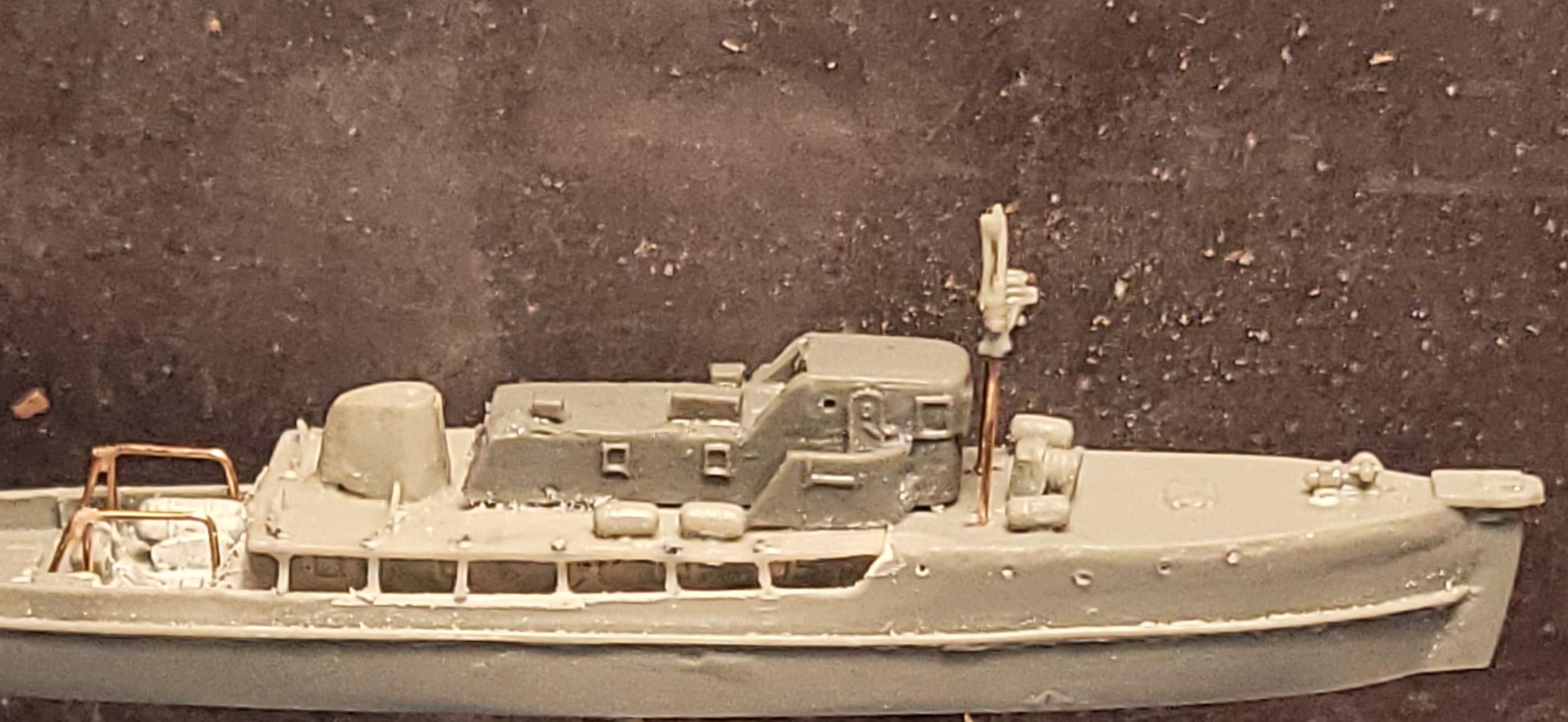

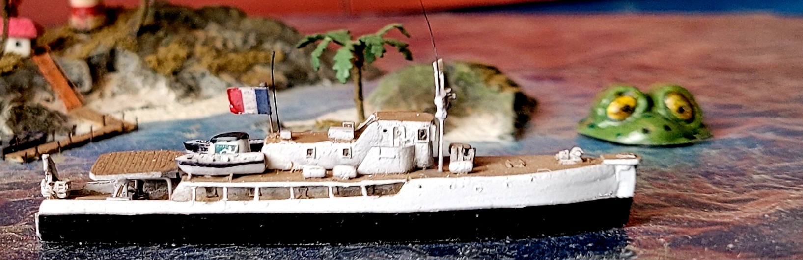

Foremast, trimmed, sanded flat and blacked for drilling VERY carefully for .0125 copper wire. The crow's nest should face the bow. The tiny surface search radar antenna cast, but I broke it off handling the masthead. A metal replacement will be found. The mast will be straight and square when final installation occurs. The dry-fit is a little wonky.
I advise against installing the mast before painting, the masthead is pretty delicate. That, and getting to the bridge winders for paint would be more difficult.

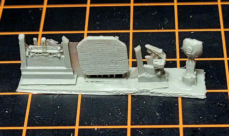

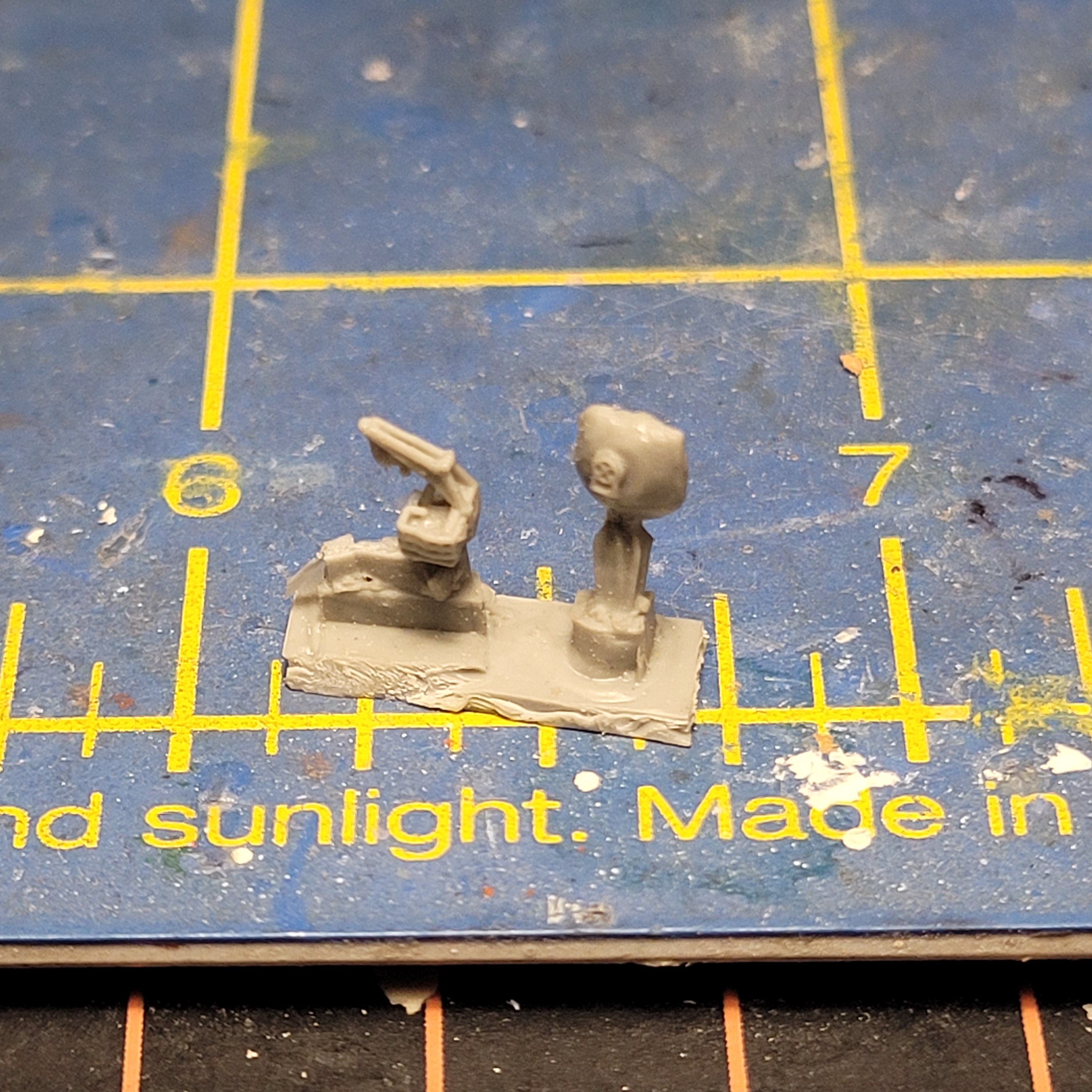

Diving saucer and crane. The French cutters will be an easy deal. That horrible gap in bridge to main deck join will need attention.

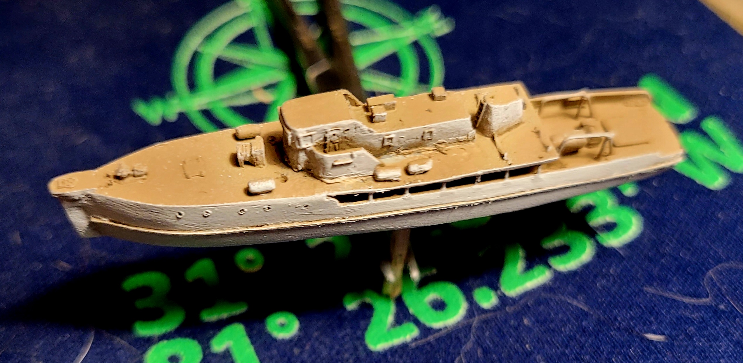

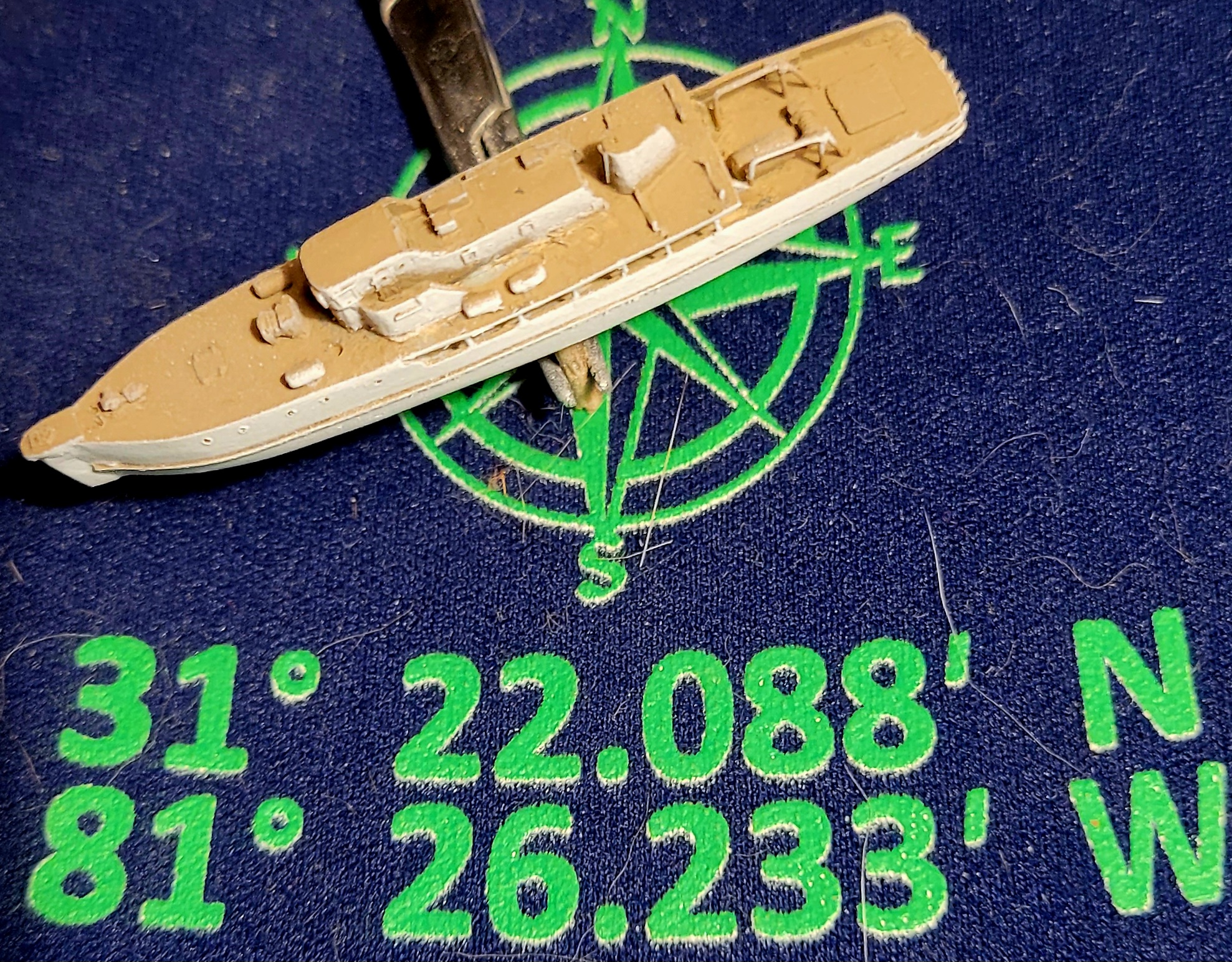

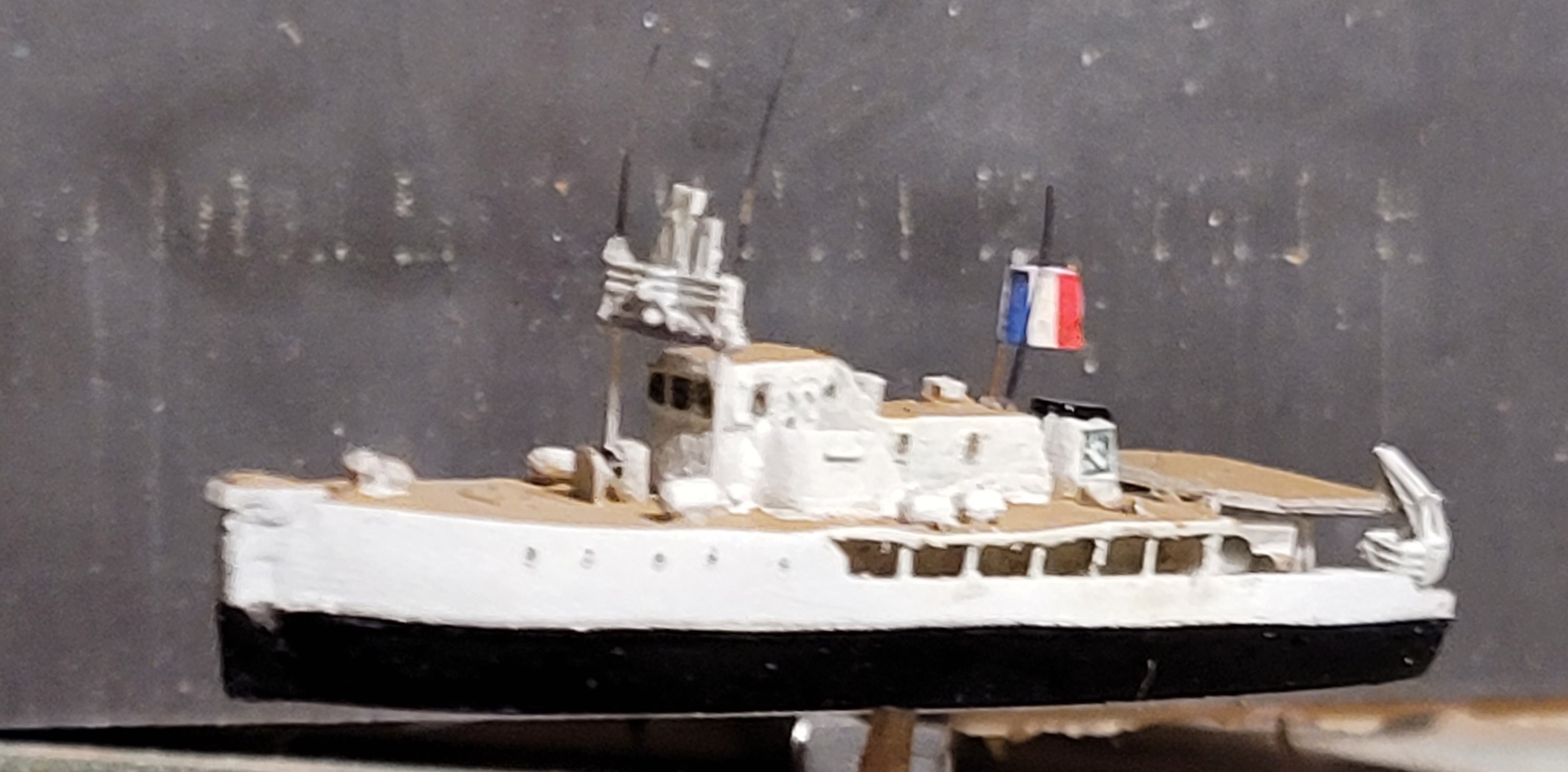

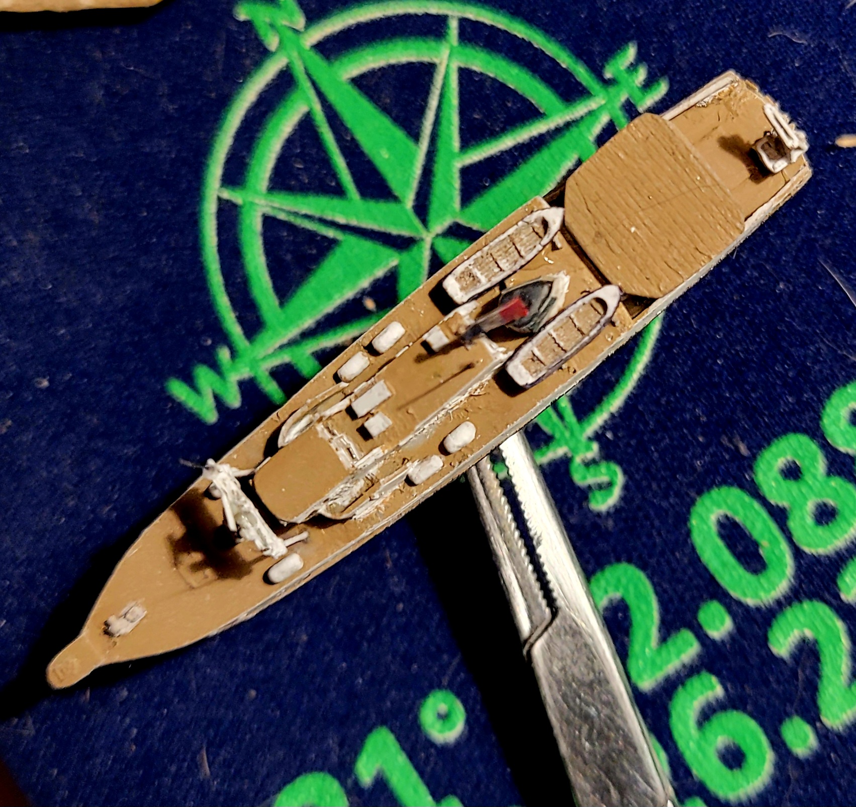

Calypso's Tamiya flat white base coat went on tonight.
The deck tan doesn't look so dark now.
Remeber the awful gap I had between the bridge and main deck? Short bits of stretched sprue, a bath of Tamiya thin glue and squinch the plastic into the gap. Old-school model gap fix!
Thanks for looking in!

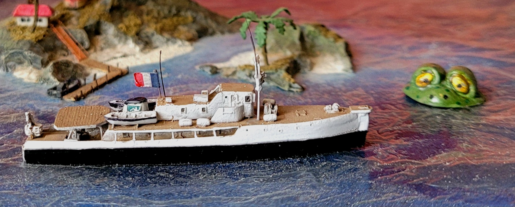

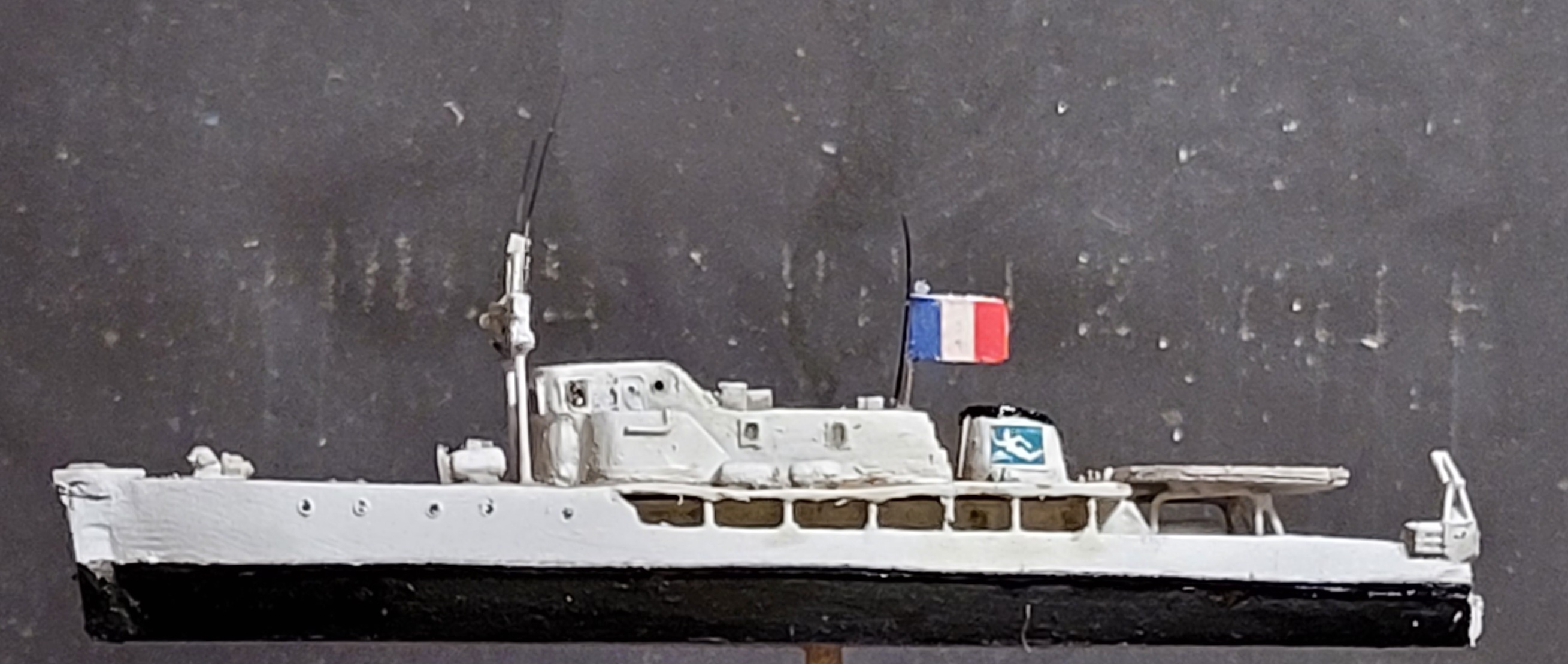

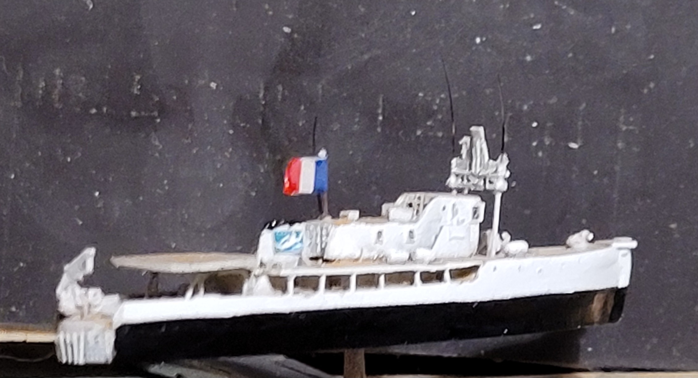

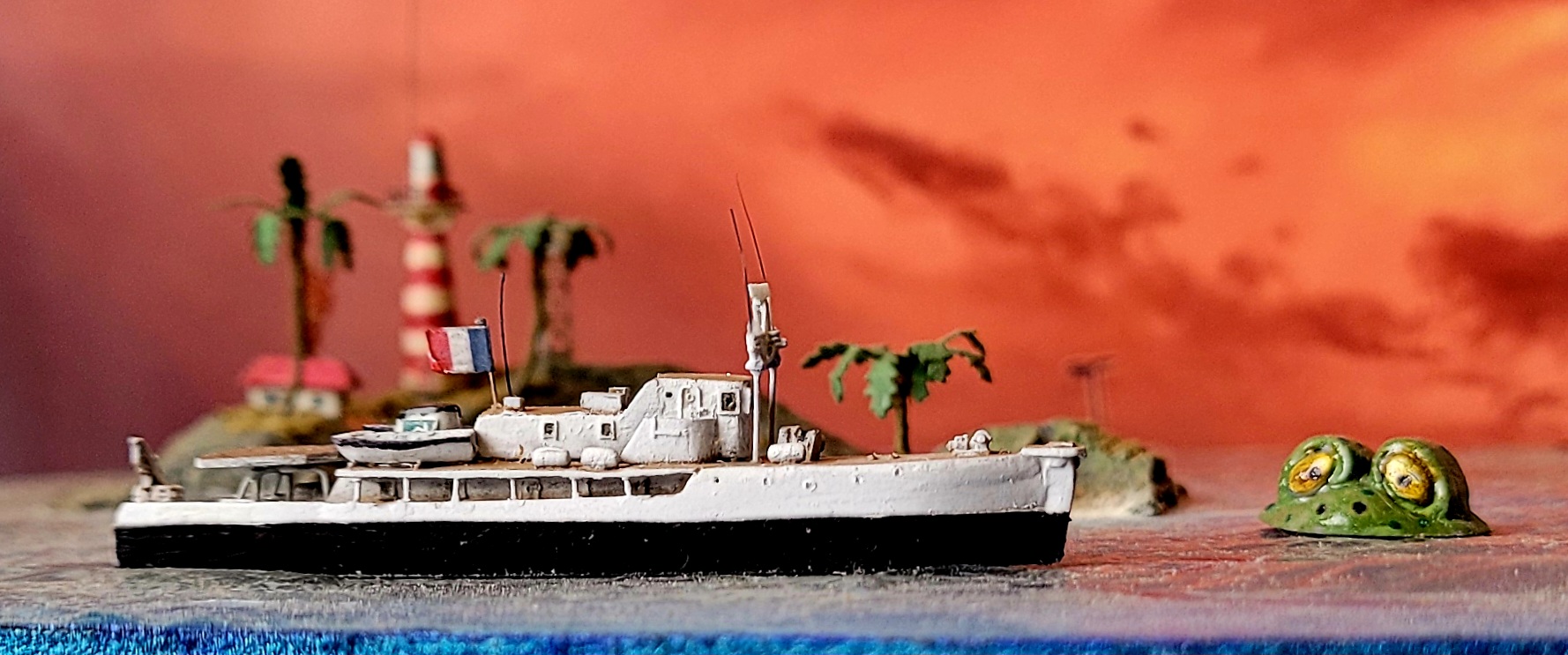

The finish line is drawing near! The smallest Calypso Flag on the decal sheet makes a dandy nameplate for the funnel. The middle-sized French flag is in use here.
The deck tan looks swell after the rest of the model comes together. The helipad could use a light dry-brush of silver.
