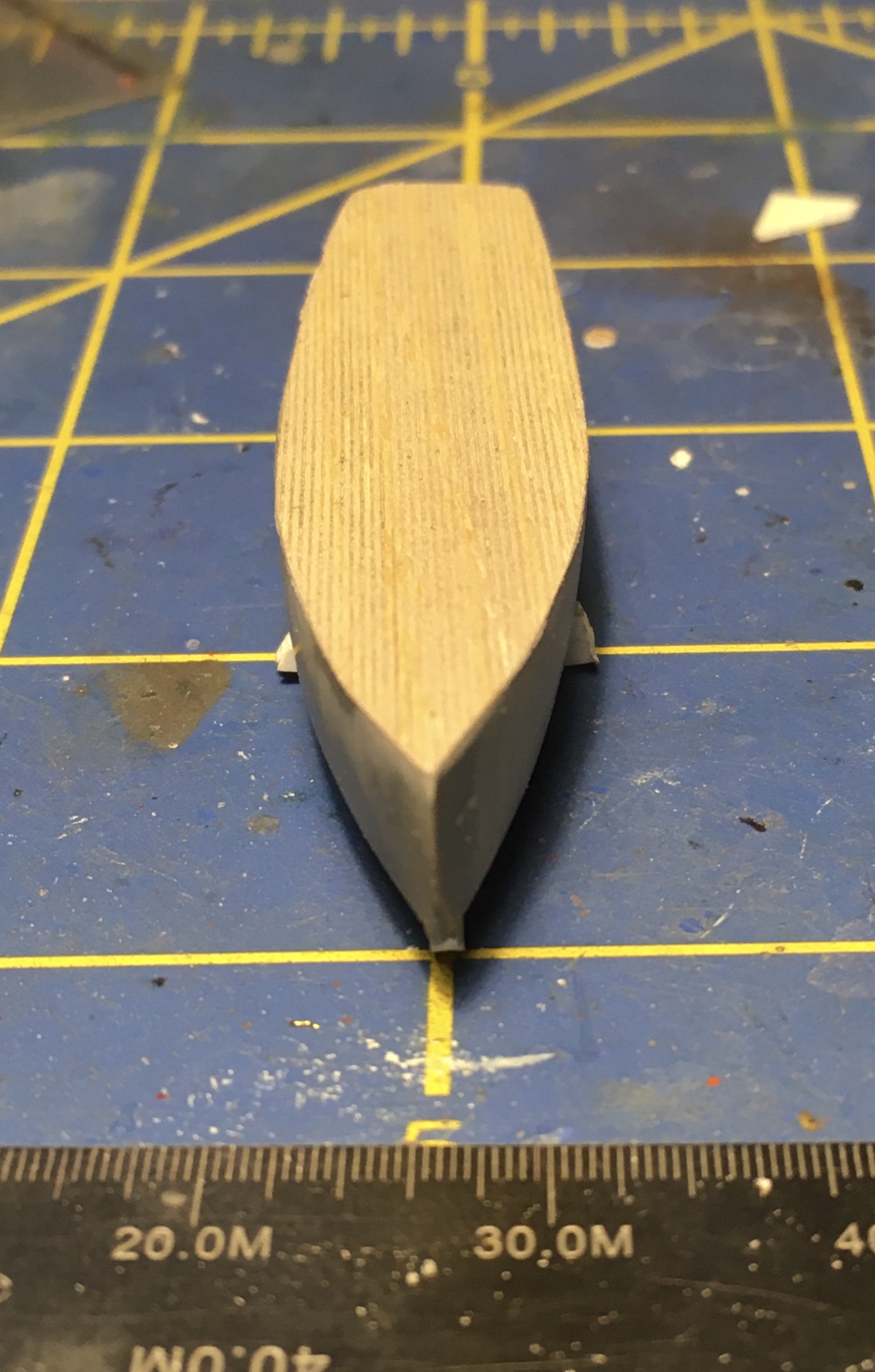

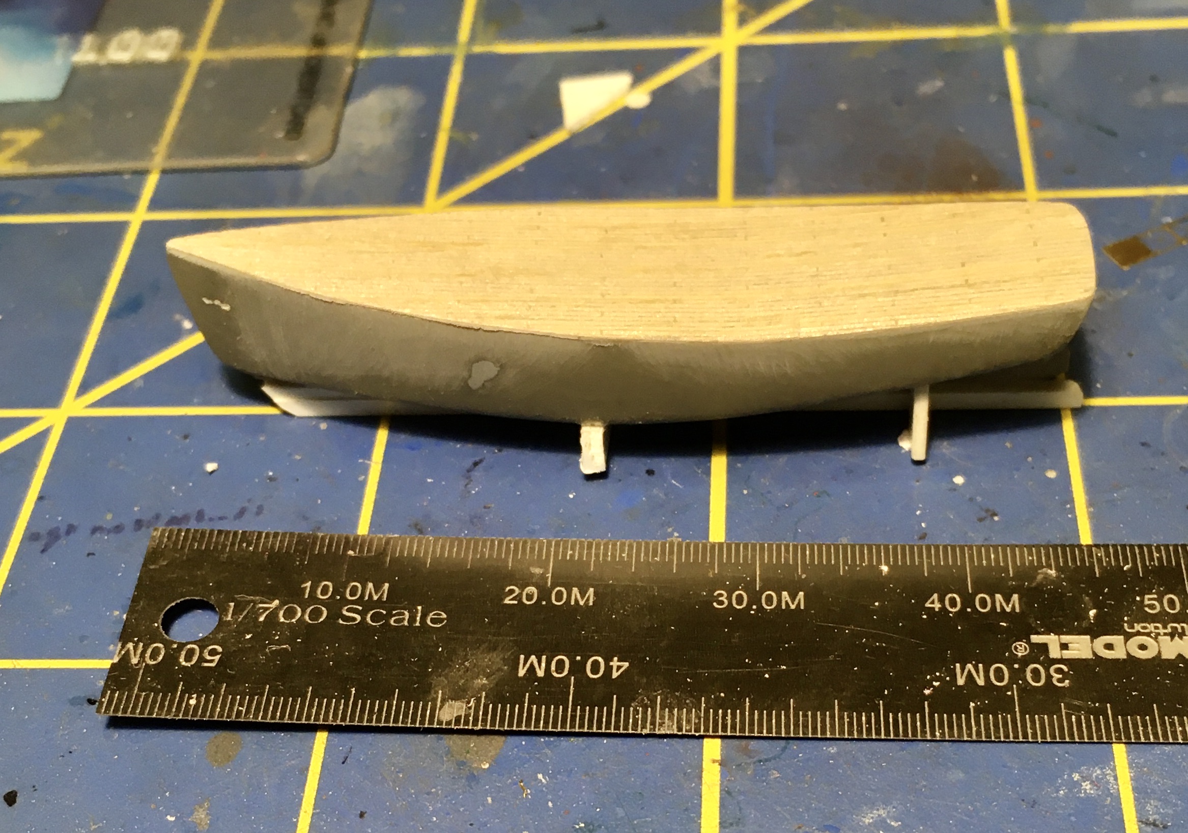

That being said, I have a dilemma. Input is most welcome! My big buddy Don gave me a mystery ship mold. I used a casting not unlike this one as a basis for the popular 1/350 USCG Point class Cutter. She measures a little shy of 150 meters in 1/700. What to do? Add rails for a generic Ship hull kit? I believe she began Her life as big scale ships cutter/rowboat. She's way too sleek for a 1/350 Shrimp boat. Not "muscular" enough for a Tug.
Your thoughts?

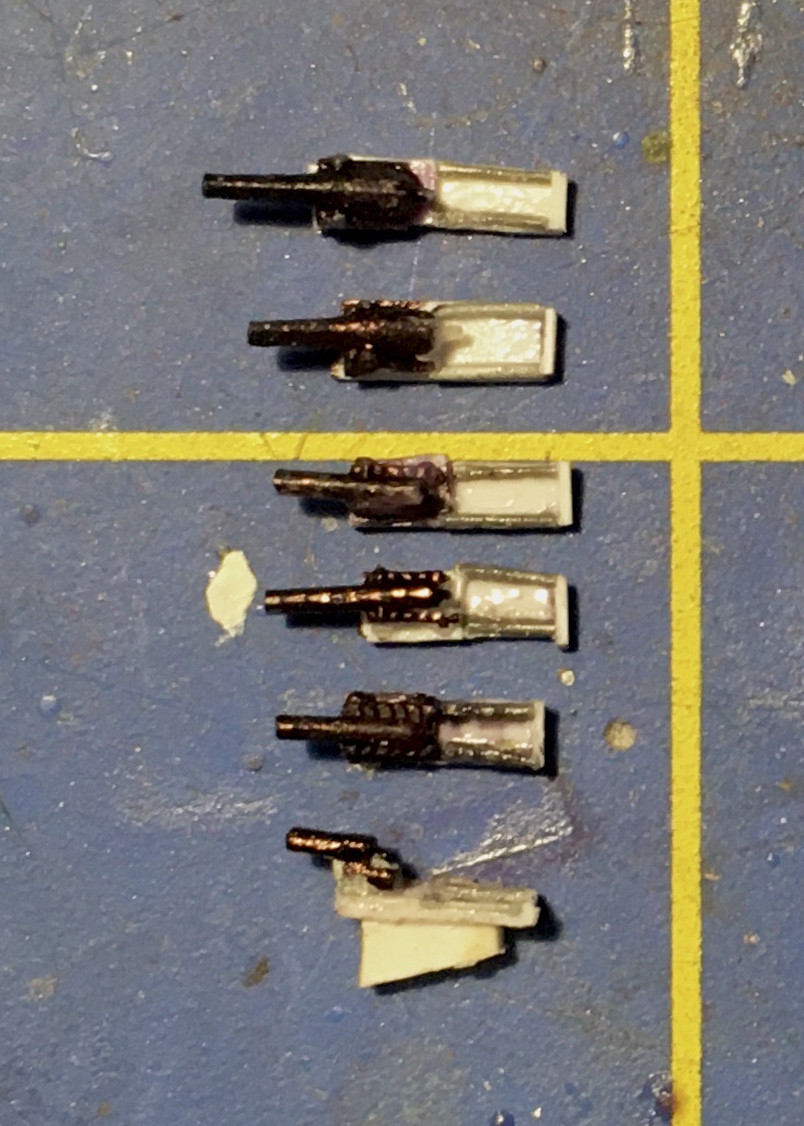

This morning's exercise. GUNS! Find here from top to bottom, on pivot mounts, 9 inch Dahlgren rifled gun, 7 inch Blakely rifled gun (Alabama) 2 18 pound cannons, which will stand in for CSS Florida's 7-inch rifled guns in this scale, a nine pound cannon and what once was the 81 mortar from the stern mount of a Vietnam era PCF Swift boat. (waste not, want not.) for USRC Cushing.
I can't think of way to de-complicate masts & rigging. Molded and resin cast, these lil' guys will make arming the Confederate Raiders simpler and more fun!
Thanks for looking in!

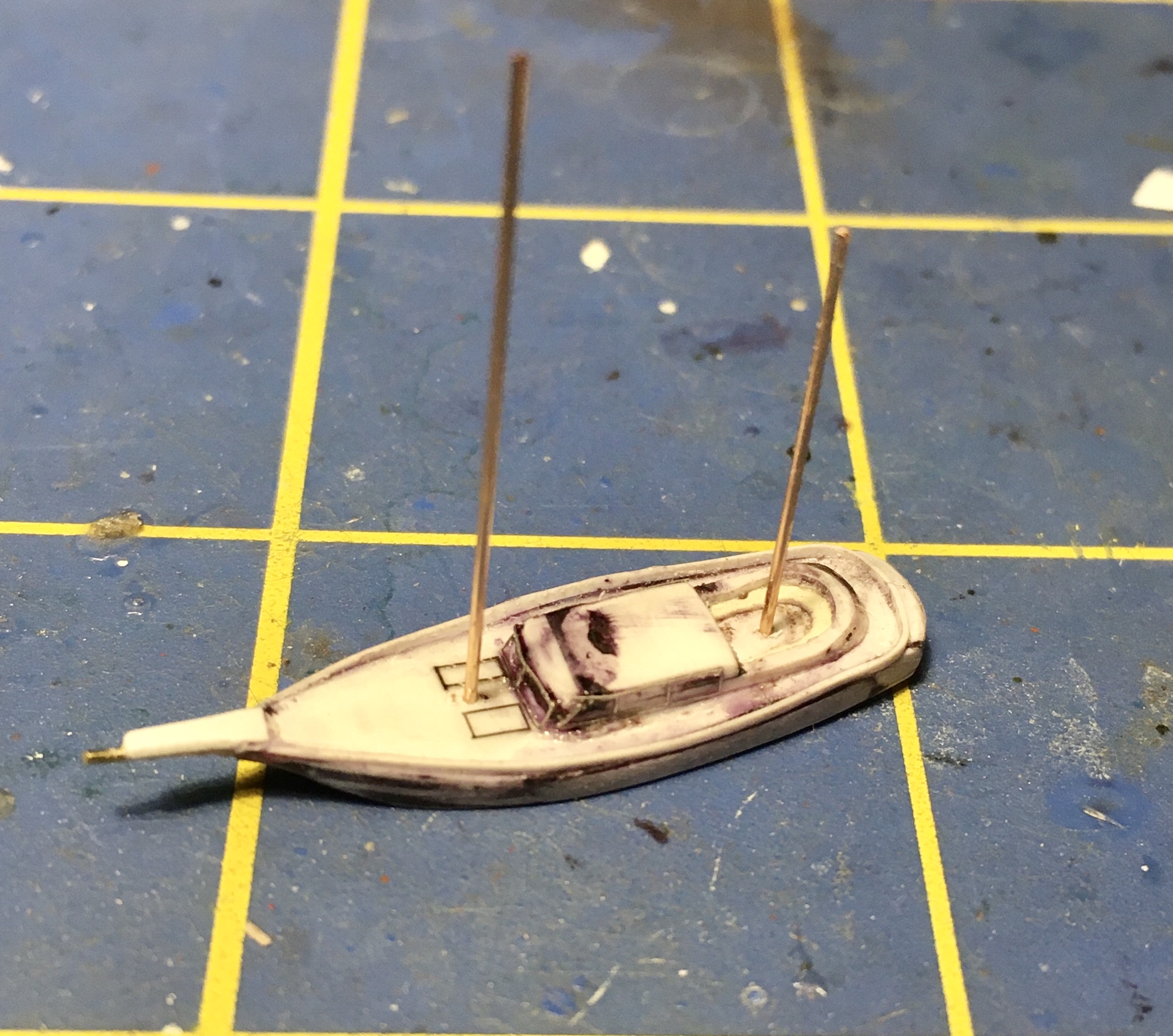

The little CT-56 Ketch tries on Her .015 wire masts. I was trying to model "Nauti Dogs" of Sailing Doodles YouTube fame, but there are several big differences in lay-out between the model and the fo' weel boat. :ph::bm:

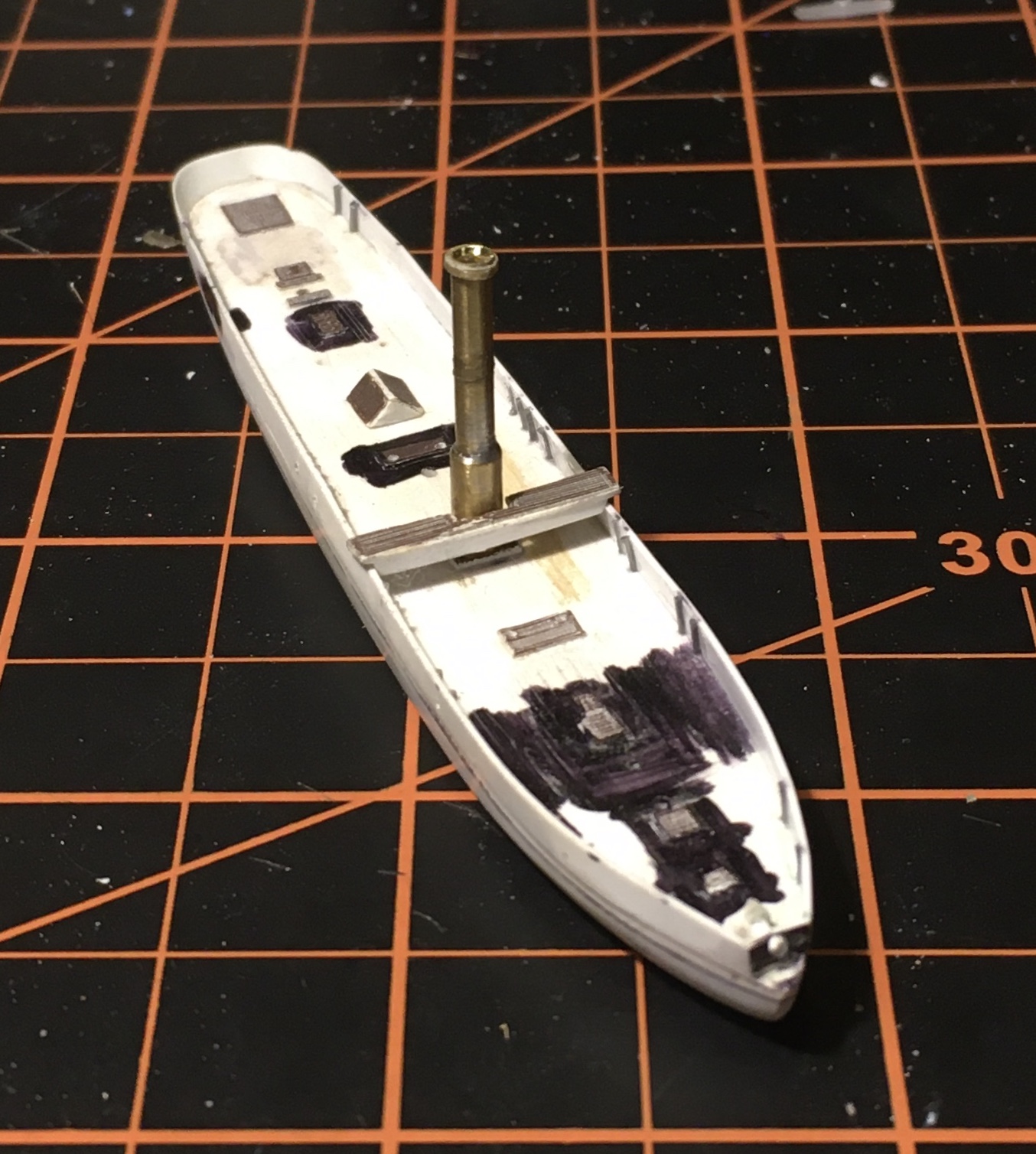

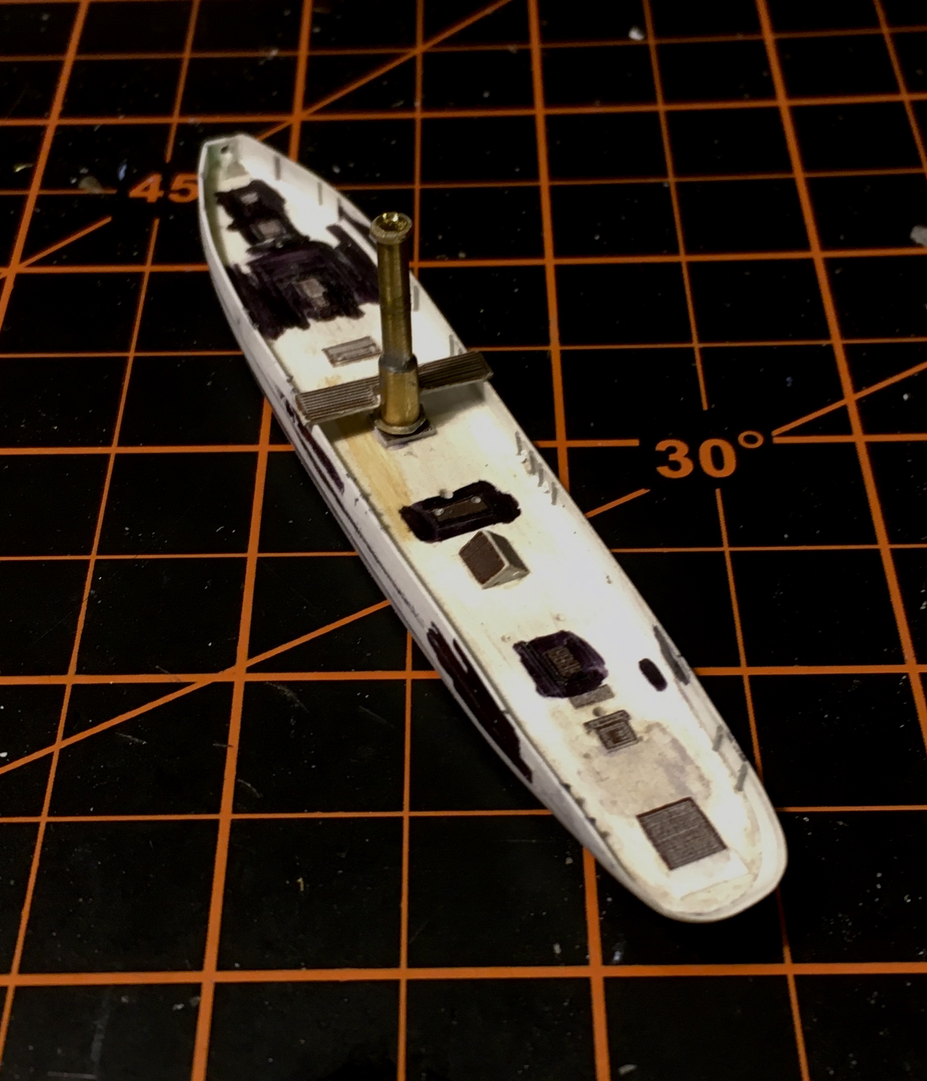

CSS Alabama got her smokestack and vents. The bridge needed to be fitted to the stack and the ship. On the actual vessel the bridge is a little higher than the main deck rail. The Master will bear that out. still plenty of details to add to the ship.

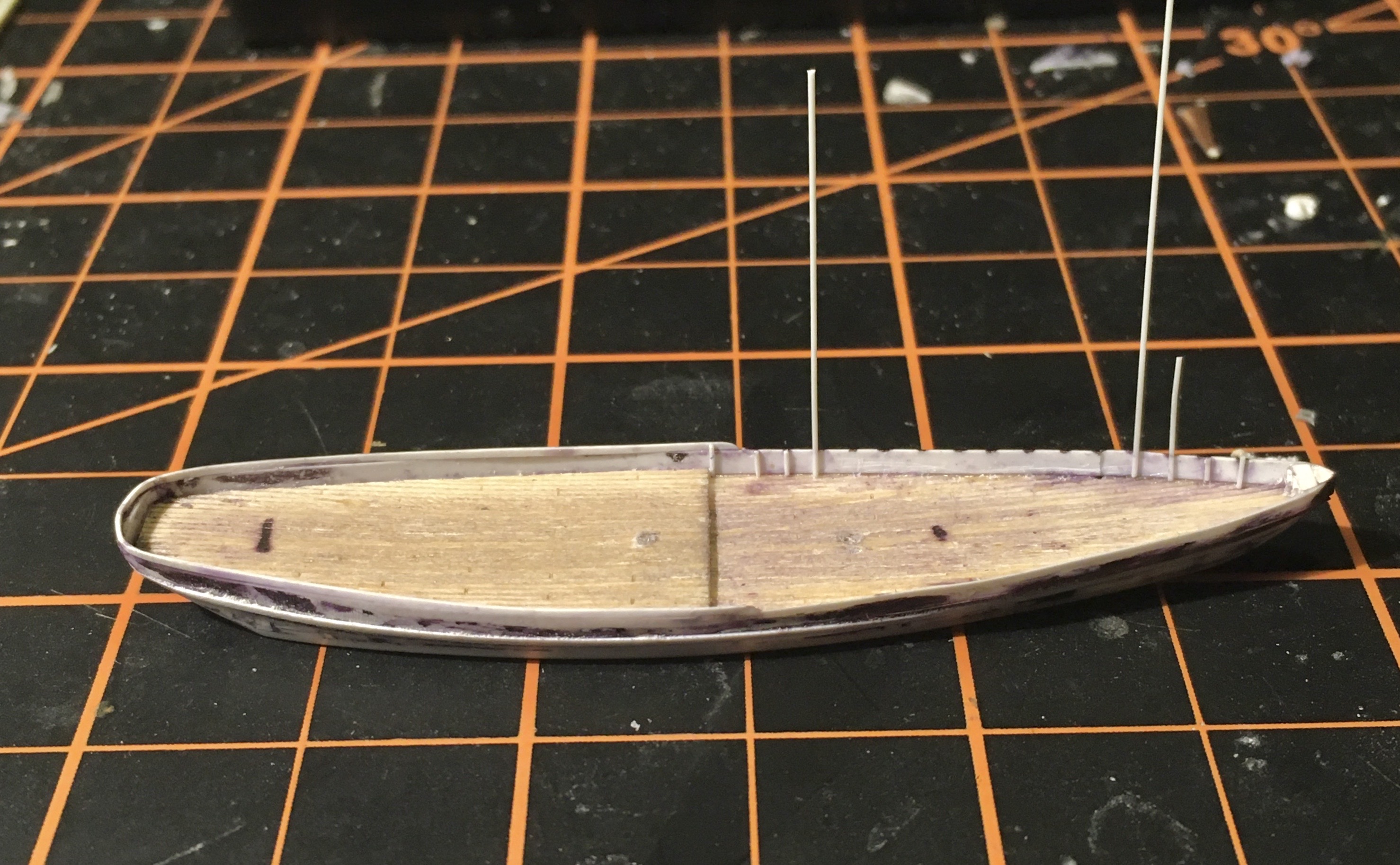

Snow (sorta) Day progress! I suppose since Bluenose/Lucretia is wind-driven, She can stay in this thread.
Even though USS Carondelet beckoned, I did some of this instead. I wasn't going to do this. The braces inside the rail. I needed .010 X .010 styrene strip to make it look uniform. I stretched some sprue and decided to err on the side of detail. At the time of this posting 1/2 of the schooner's braces are in. Once they are all done I'll add the foundations for the ratlines and cap the rails with .020 X .010 Evergreen strip. I'm not positive the spacing is correct. I am also not drilling the myriad deck scuppers (drain holes) at the base of the rail. They would never mold or cast well. Once all the rail stuff is done, I can complete the deck hatch details and boat cradles.

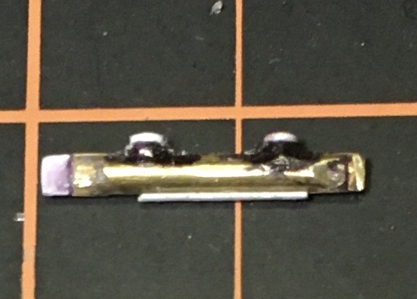

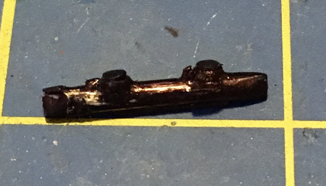

Horace L. Hunley's Master is finished! You can't see them, but the little vision ports in the towers are drilled in!
The spar will be .010 copper wire with a scale Going BOOM Underwater thingie stuck to it!
Can you hear it? That sound?! What's that noise?!? The sound of every Yankee sailor in Charleston harbor shaking in his boots? NAH!
More likely The sound of Hunley taking every member of her crew to the muddy bottom of the Cooper River one more time. Brave men embarked on Hunley. Few survived.

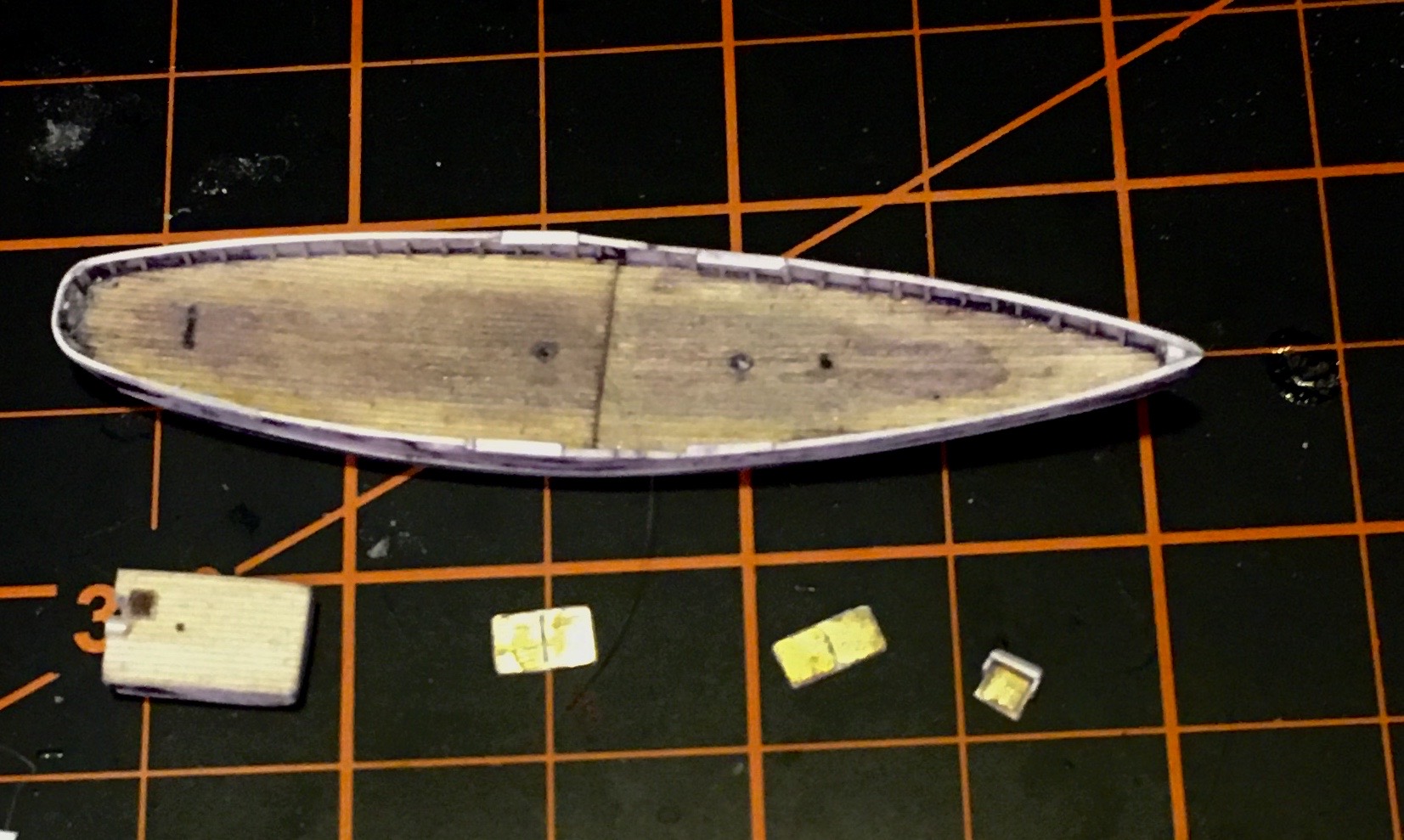

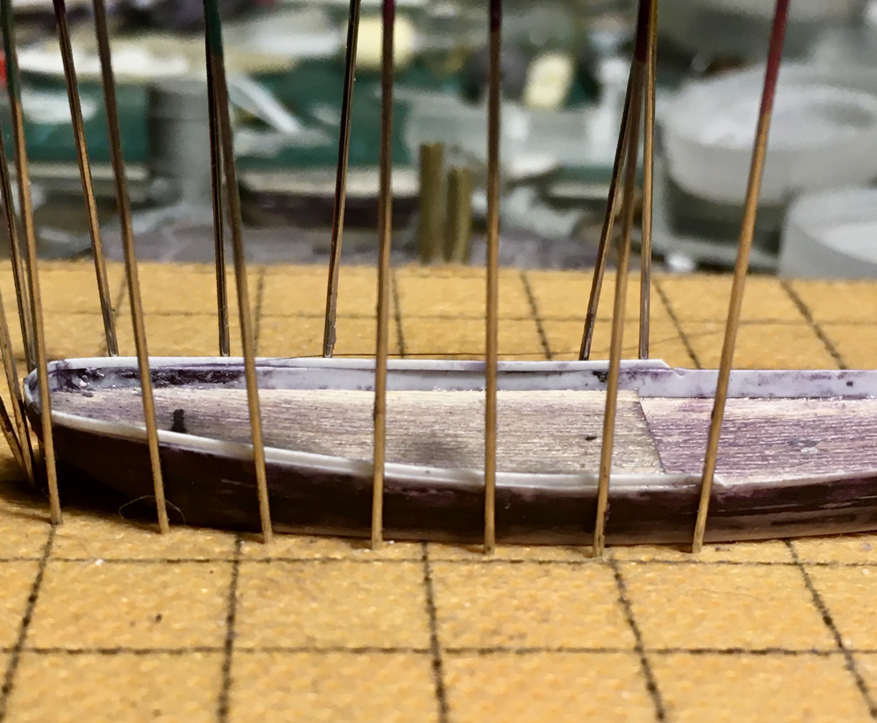

FINALLY! Bluenose rail supports and rail caps are done! I wanted to move on to deck hatches and deckhouse, but they proved to be too big. (Save these parts for the 1/350 Bluenose/Lucretia kit? NOT gonna happen!) Scale, less complex deck details are in the works. The smaller Frosty Snotbox hull I made may become the luxury 95-foot Ketch she always wanted to be. Pictures later!
Thanks for looking in! :oldguy::Drinks::drunksailor::salute:
It all started in Nova Scotia back in 1921...........
She had a prominent .010 X .020 plastic rub-rail I added to the hull that didn't feature in any pictures of Bluenose. It looked really cool (If you can see such a thing) but it wasn't period correct, so I gently sanded it off. A more subtle stretched sprue rub-rail was installed instead. I can't prove She had one, but she'll need it as the dory boats come and go with nets full of Grand Banks fishes. It should mold nicely. Bluenose/Lucretia should be fun to build and not overly complex. Until the rigging starts................:bang head:ph:

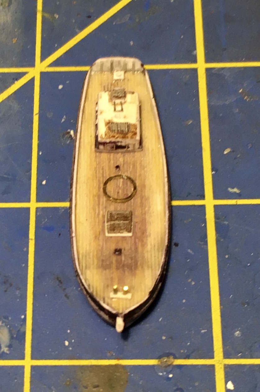

BETTER! Properly sized hatch covers and deckhouse. A small repair was required on Bluenose' starboard quarter rail cap. With the hull just the way I want it, the fun of making the main deck details can proceed.
