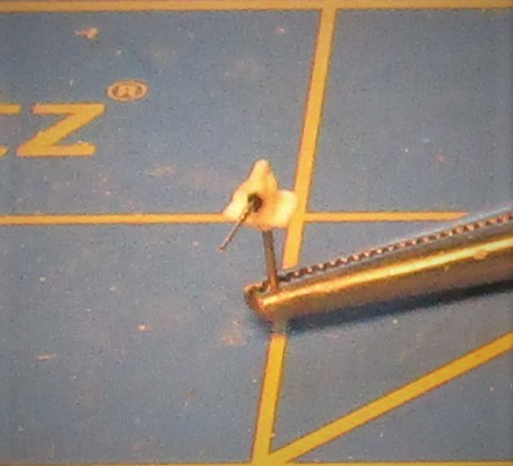

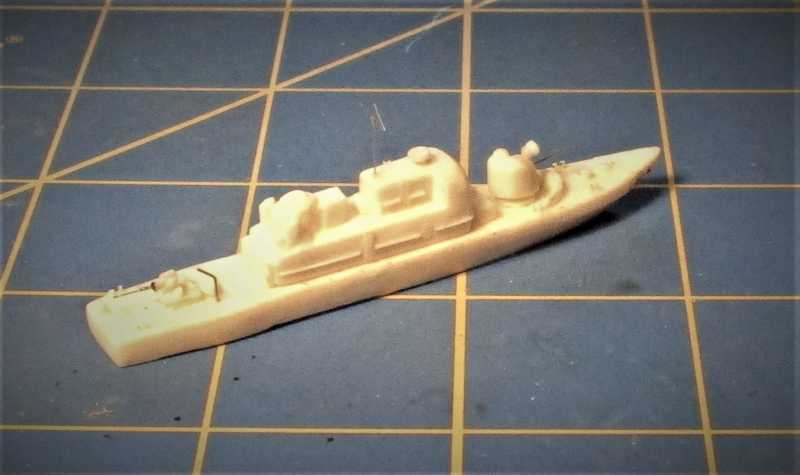

I drilled & installed my turned brass gun barrel, the attached the targeting radar dish. I think it would have been easier to attach the radar first, then drill the hole for the gun barrel, and install it. I like to drill a metal shaft in these parts for handle to hang on to while I work on each piece. Yes, the Turret rotates as well! :rotf

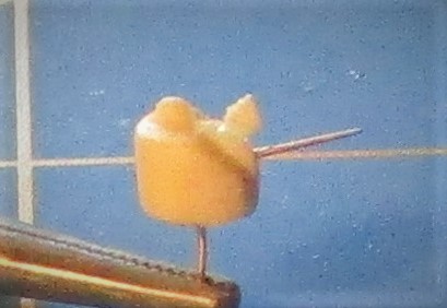

I molded and cast one of the scratch-built 40mm guns I'm using on a 1/700 PTF-3 "Fast & Nasty" boat. The base is a little too big for USS Defiance, but a bit of sanding helped it fit! Sand the reciever flush and drill a #78 hole, to accept the brass gun barrel.
Clean up the small boat, bend a wee tad of .015 copper wire for the hoist, attach a generic main mast and fix the forward searchlight platform, and Voila'!
The assembled parts of the 1/700 US Navy Asheville class PG waterline kit!! Paint comes next! I await word on the decal sheet!

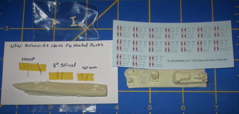

This is a picture of the 1/700 US Navy Asheville class PG waterline resin kit contents.

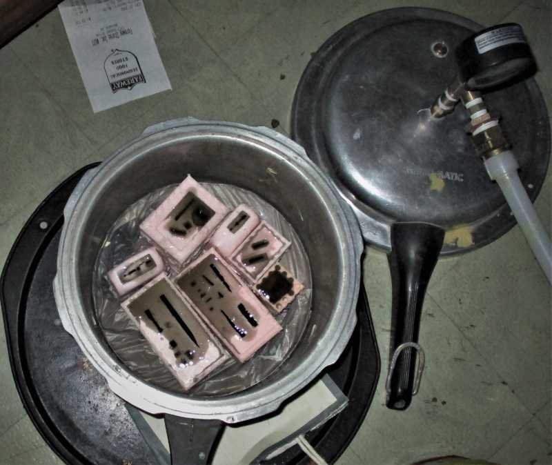

This is how many molds can be poured with 30ml. of resin.

Yep! She's been consistently standing up to 60 psi. It was a HUGE surprise to have it work this well.

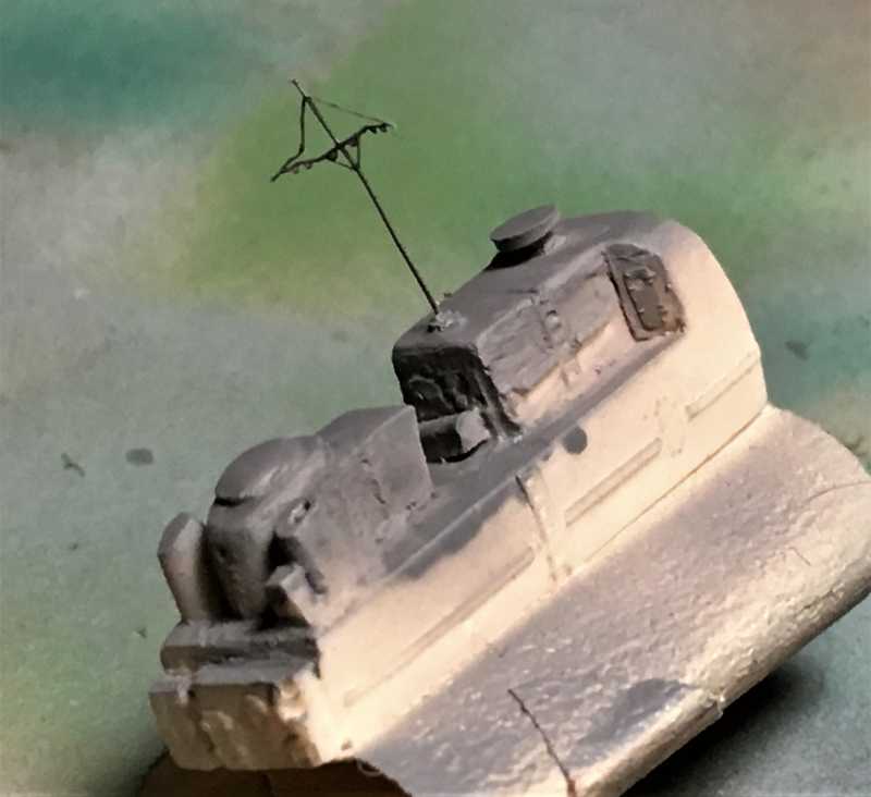

Painted, clear coated turret.
dark gray on horizontal surfaces. Lookie how the detail pops out! I'm well pleased with this mold!!
