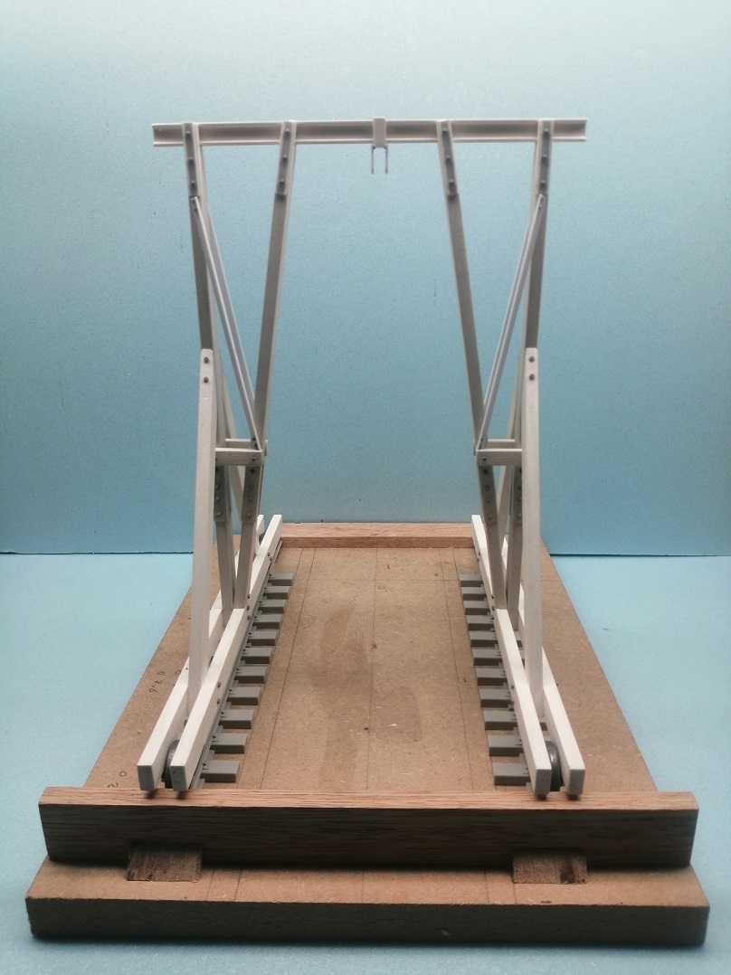

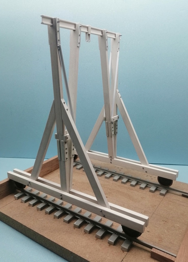

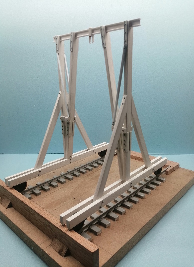

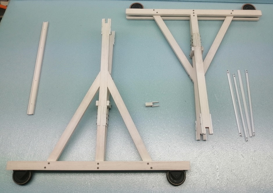

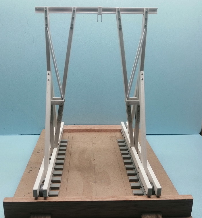

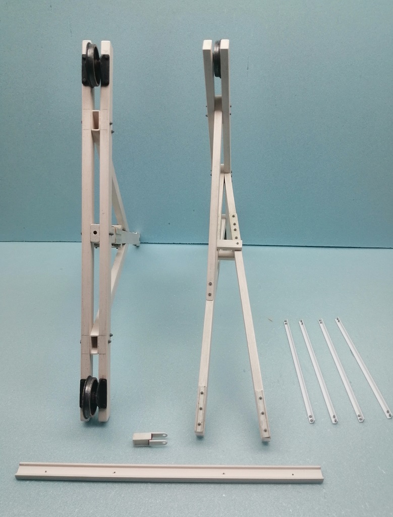

I only have found one picture of the Nagelkran , i went with the TAKOM V-1 launch Model dimensions and the one picture .
This is what i got .

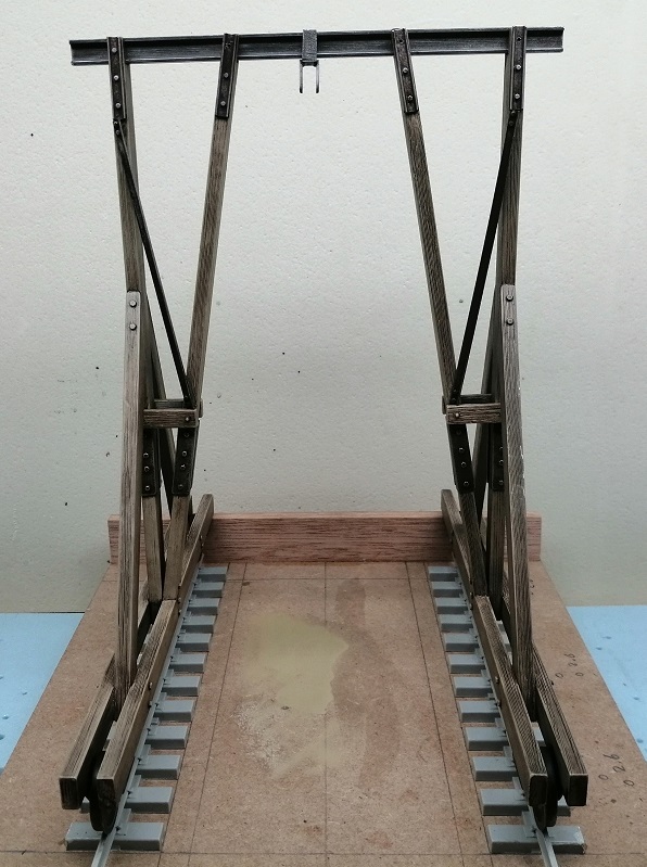

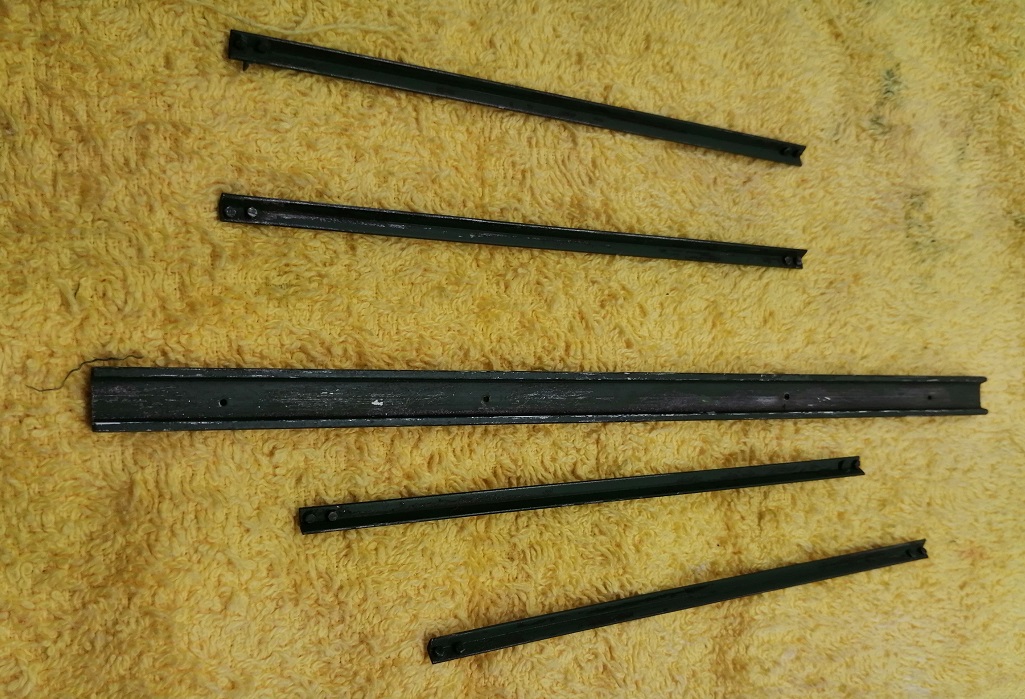

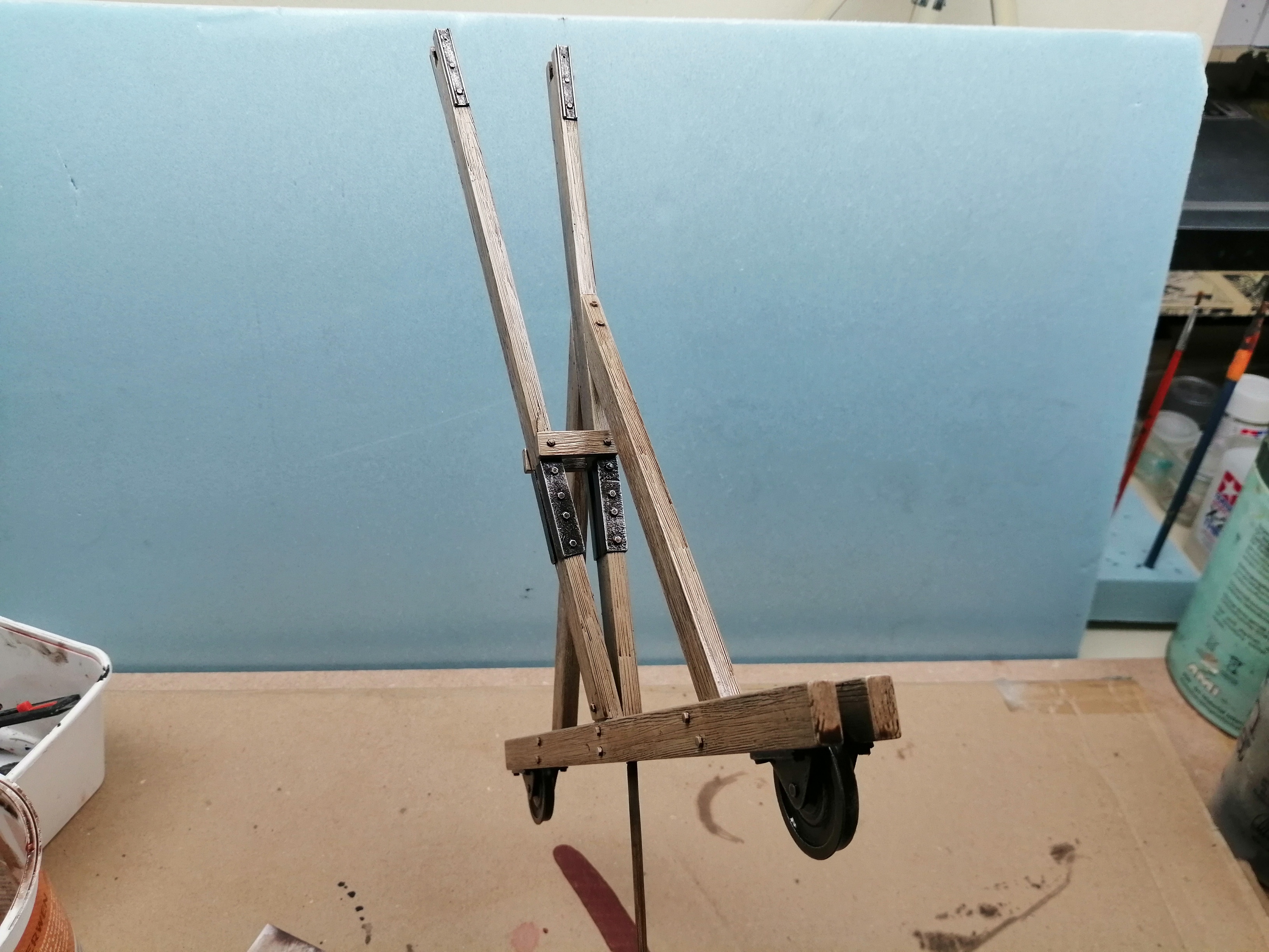

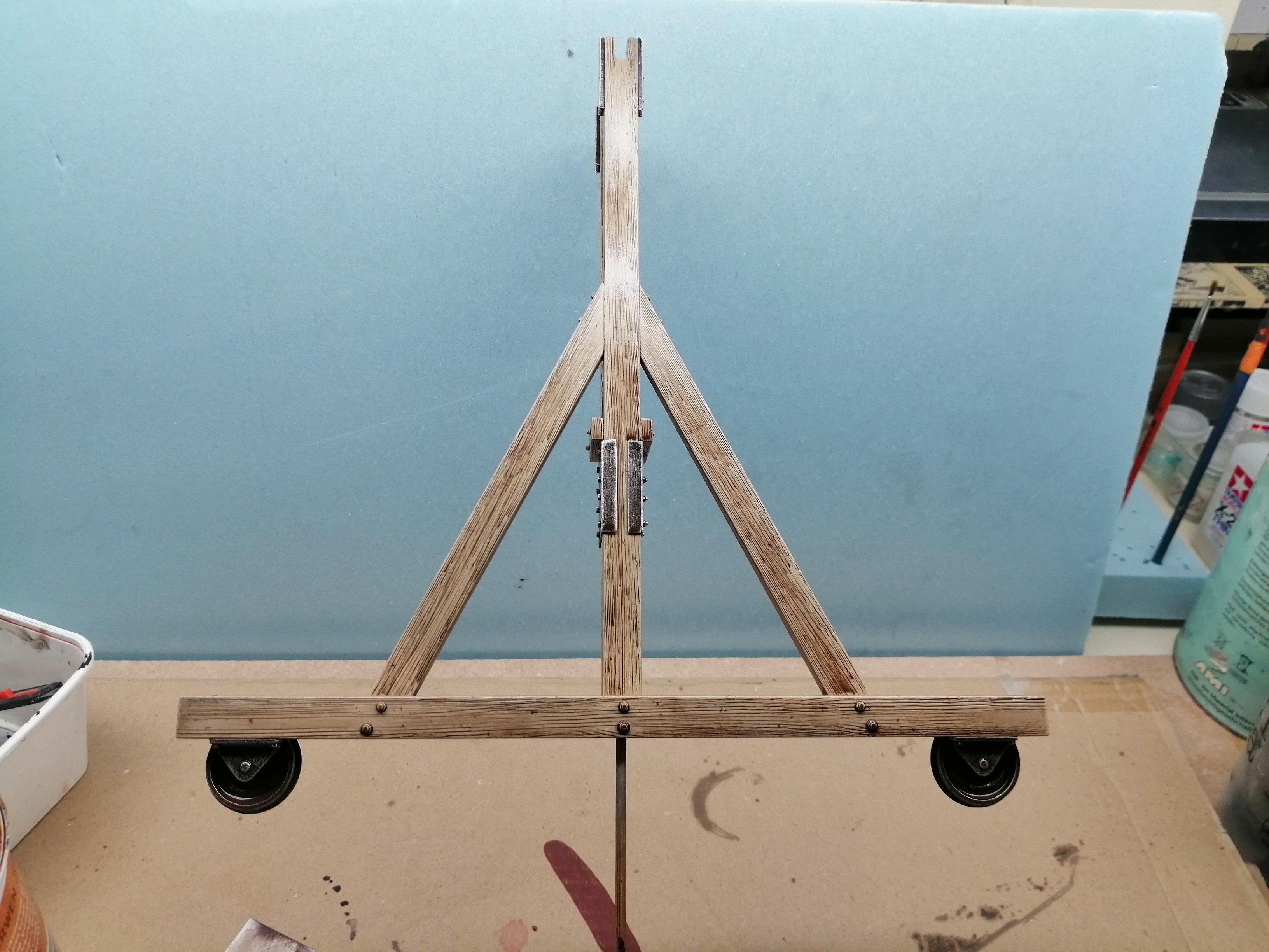

Entirely made from Plastic.

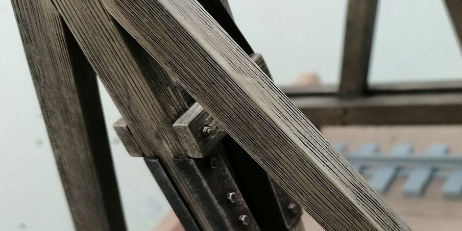

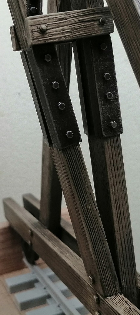

The woodgrain was created by scraping a Tamiya razorsaw over the length of the plastic ,I used nuts and bolds from MENG.
(I tryed wood but that is not my medium to work with )
The build is done,first a black primer wil be sprayed over it .

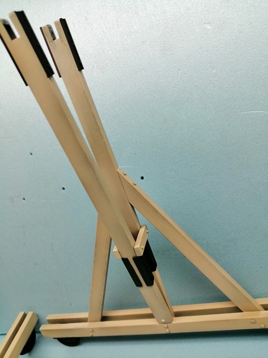

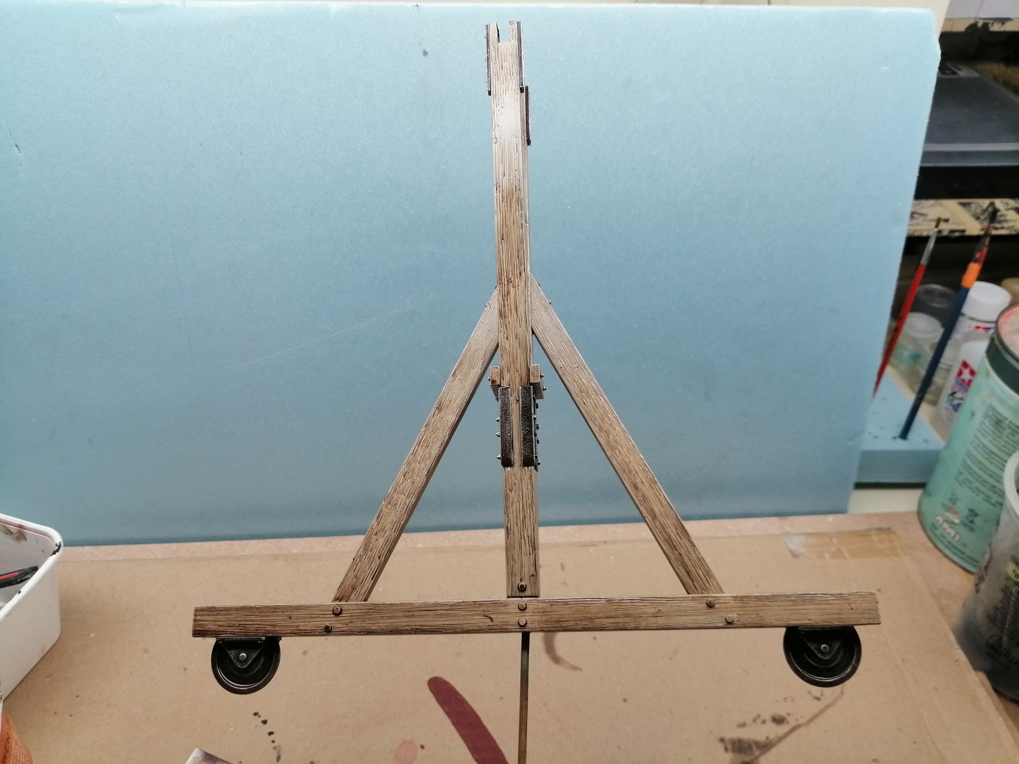

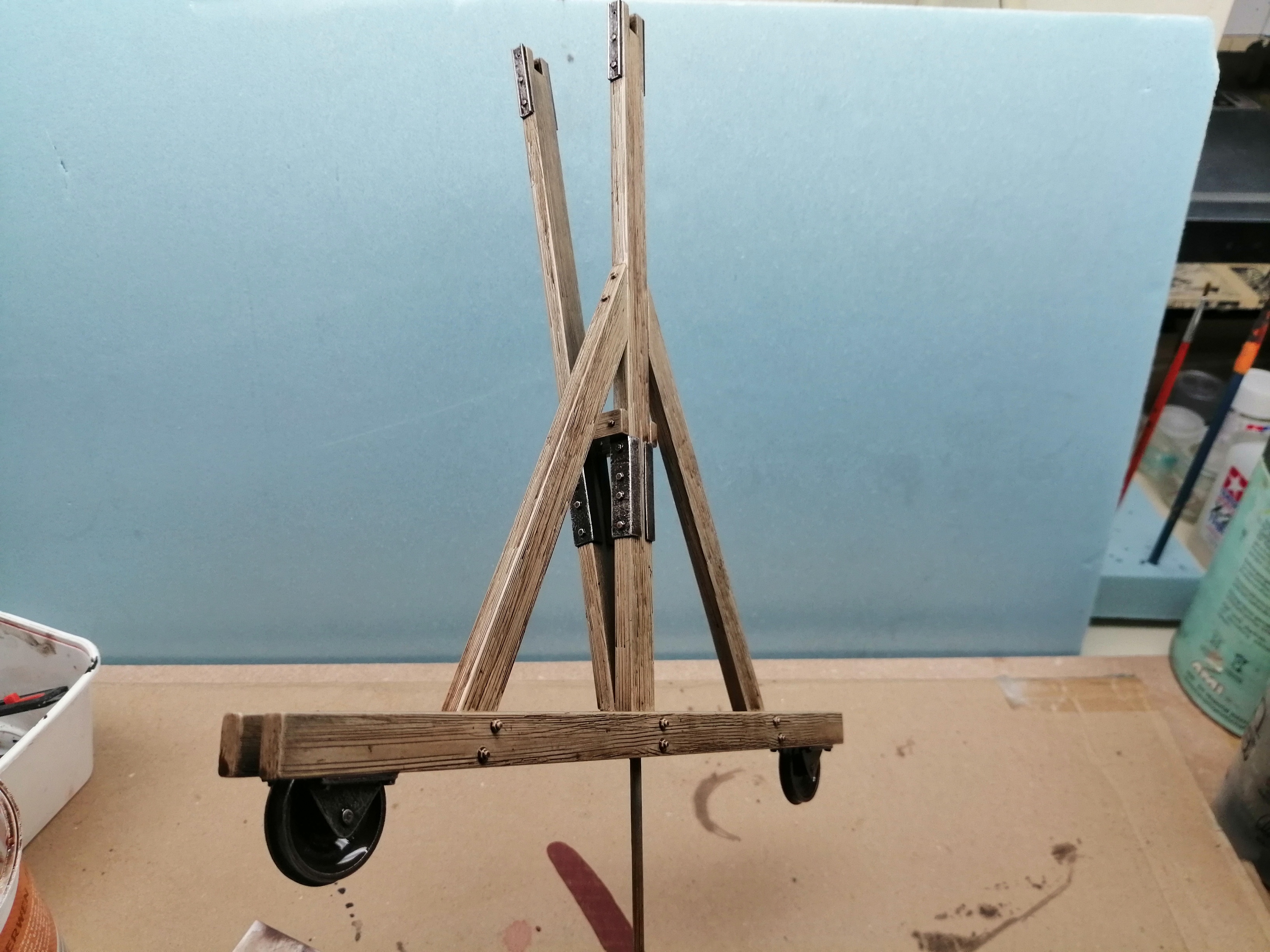

Made a sleepers and rail jig to work from .

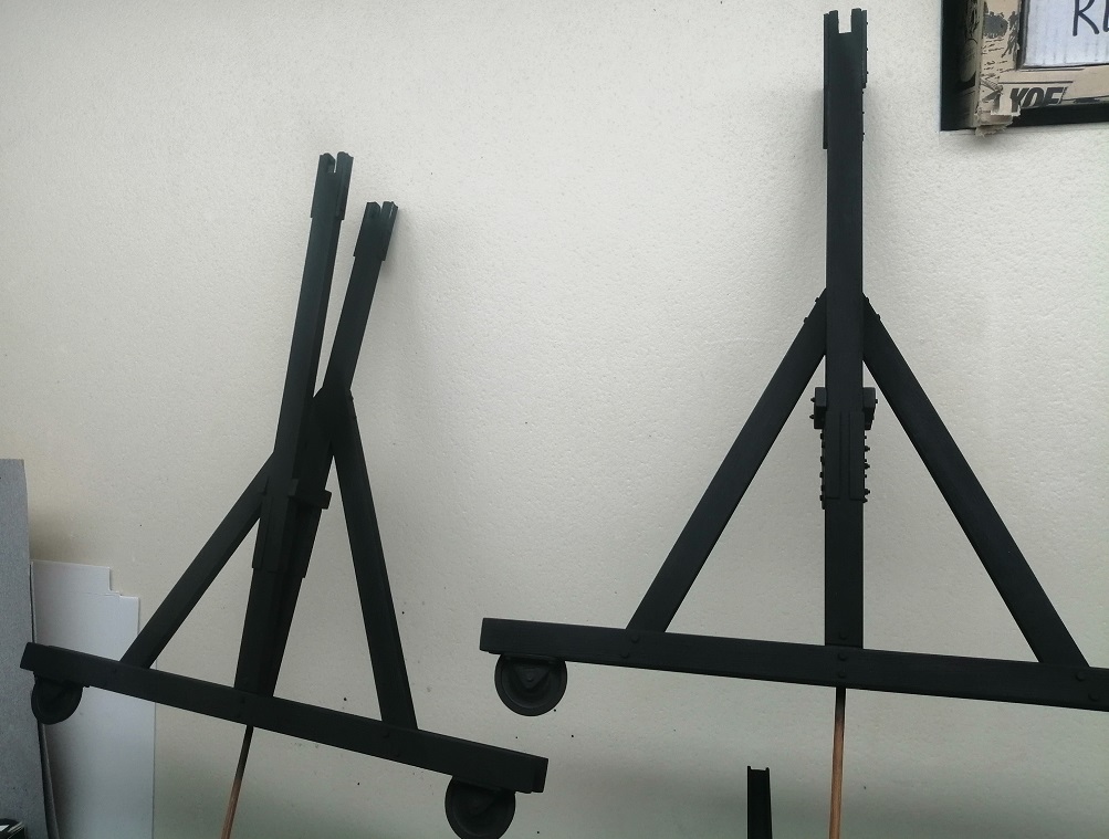

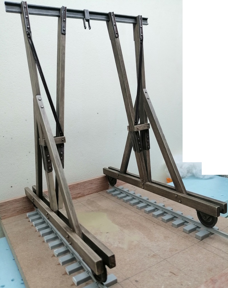

Black primer to create shadow for the hard to reach sand colour (wooden parts)

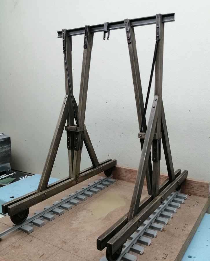

All Metal parts are sprayed dark brown .
And all sealed with Mr hobby Flat varnish ready for pin washes .
Dark brown odourless turpentine wood grain wash.
And a redish brown wash on the steel parts,when dry it
will be wiped off an the sealed with varnish.

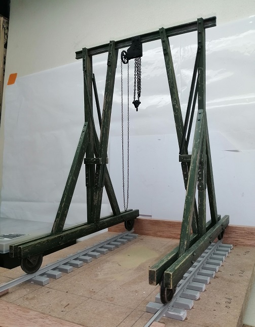

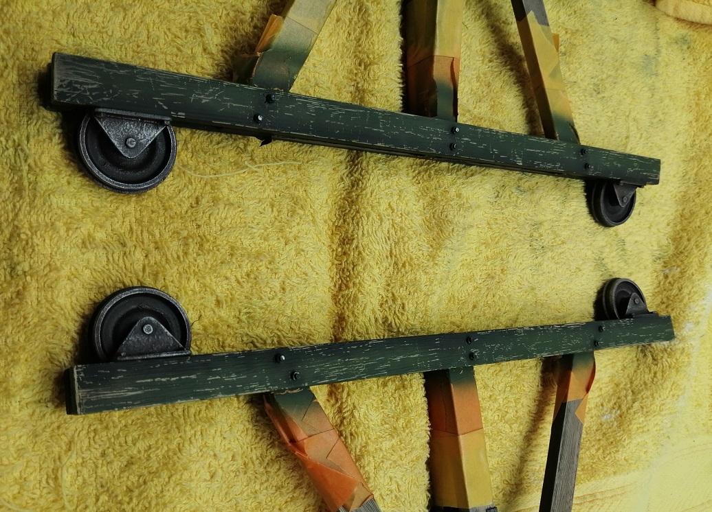

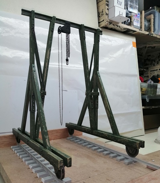

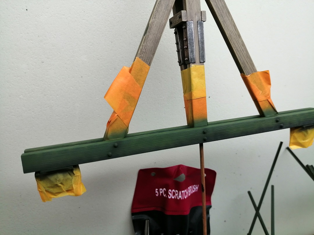

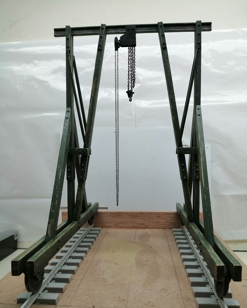

Thinking off spraying the Nagelkran green and maybe some other camo coulor , and start chipping / sctatching the beams.
(Because i think a light coloured tall thing would stand out next / in a wooded area)
