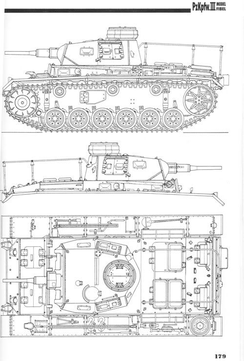

I began with this.
Found this online, (For discussion only. It was a stand alone graphic so I have no idea who to credit).

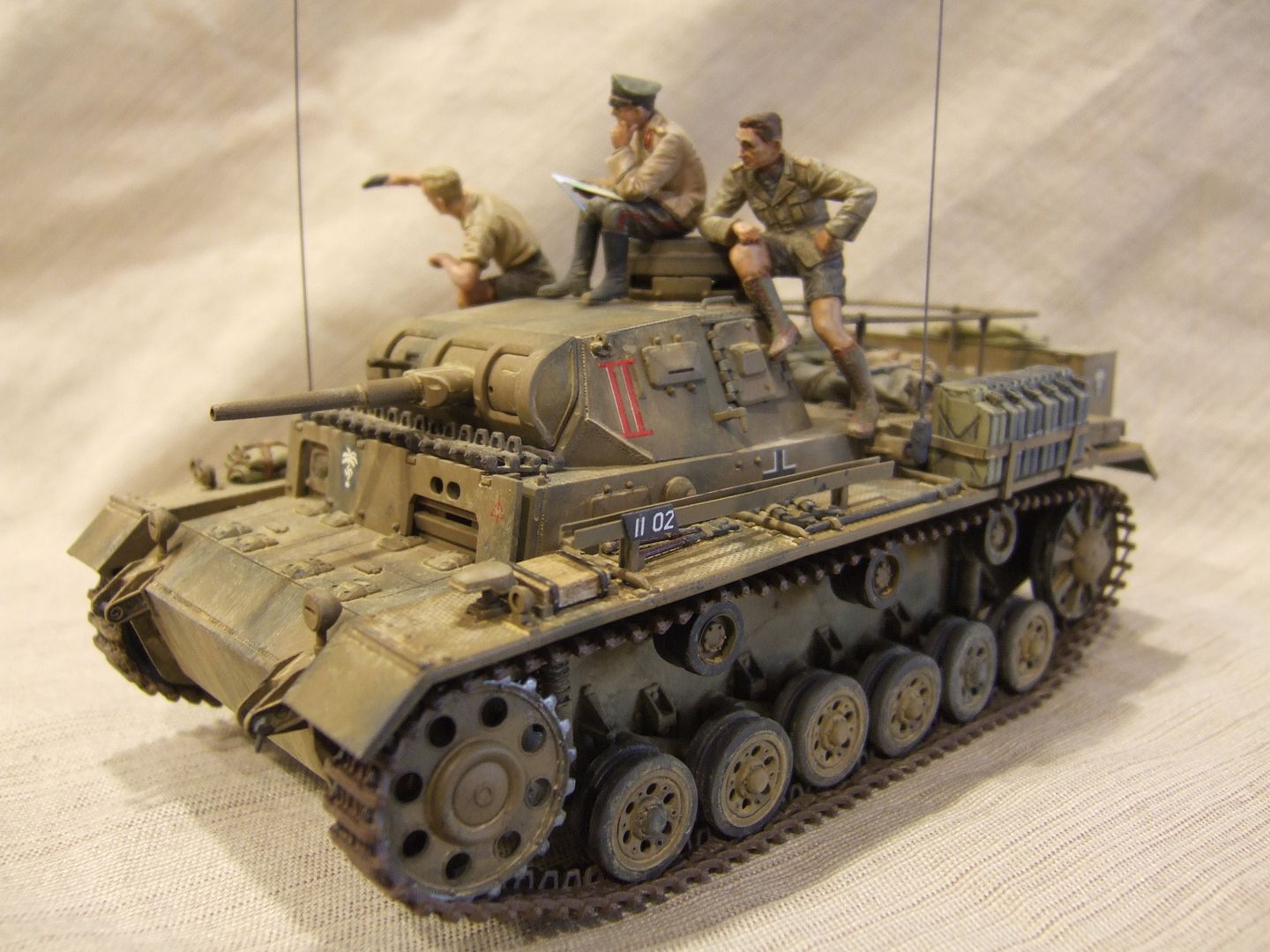

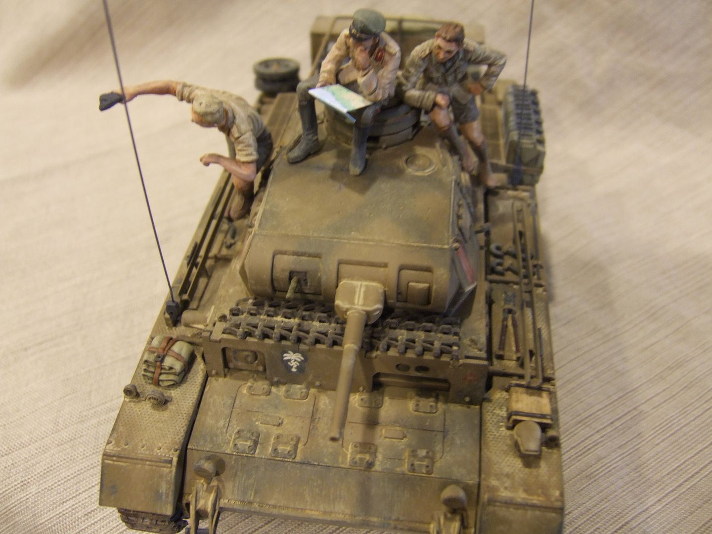

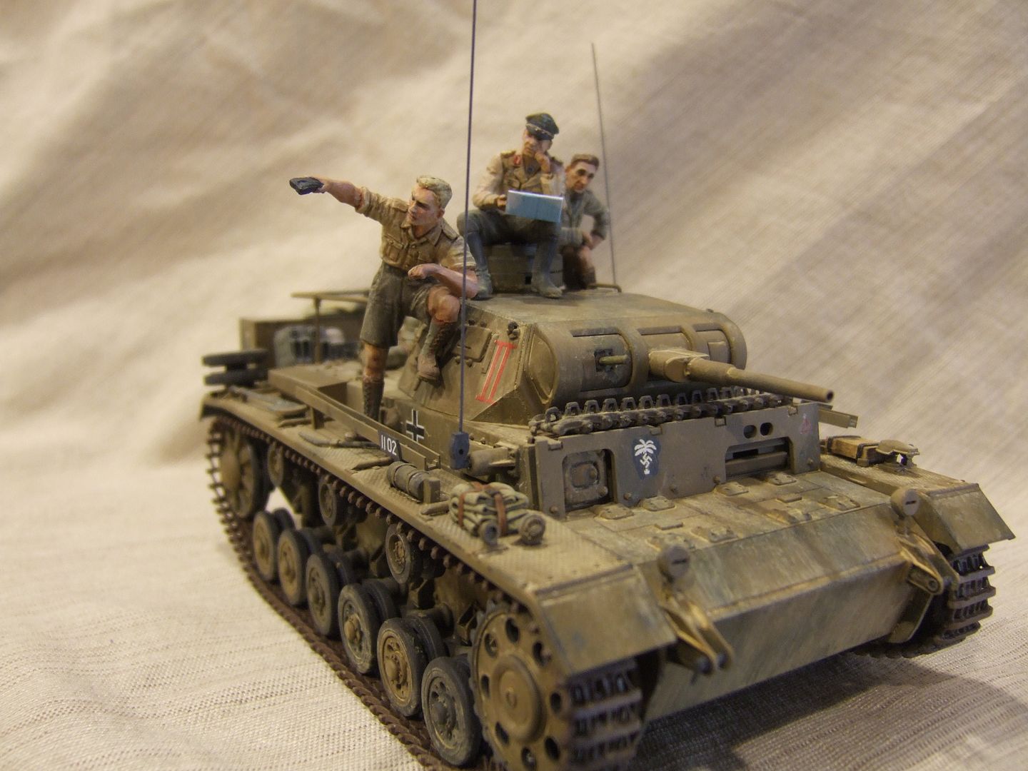

Here are some shots from the final mockup before paint.
The main gun was a dummy so the ball mounted machine gun was all they had. I scratchbuilt the mount from a spare engine cover sheet, rod and putty.

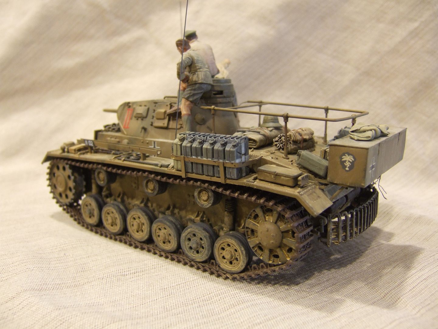

Yet another

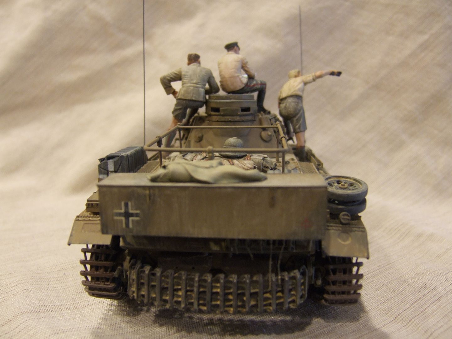

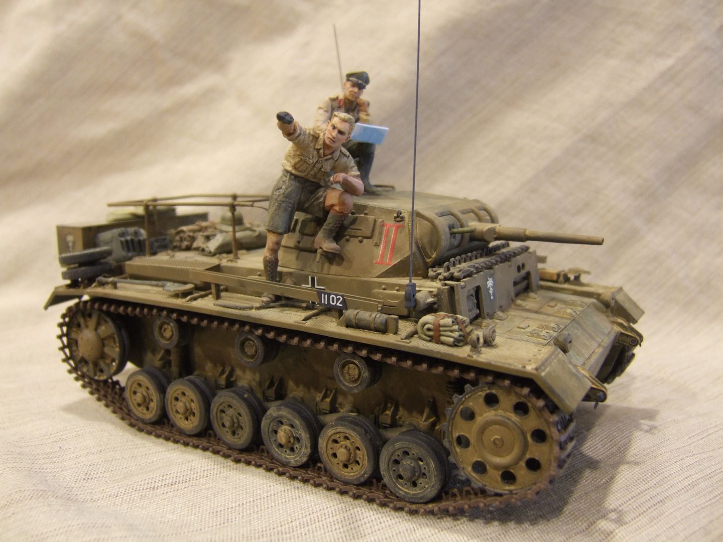

Thank you all!
I primed it with my favorite Panzer Gray enamel, Floquil's SP Lark Dark Gray. I stencilled the DAK palm with Tamiya Flat White.
After mixing several Tamiya colors I arrived at RAL 8000. A few additional mixes gave me RAL 7008.

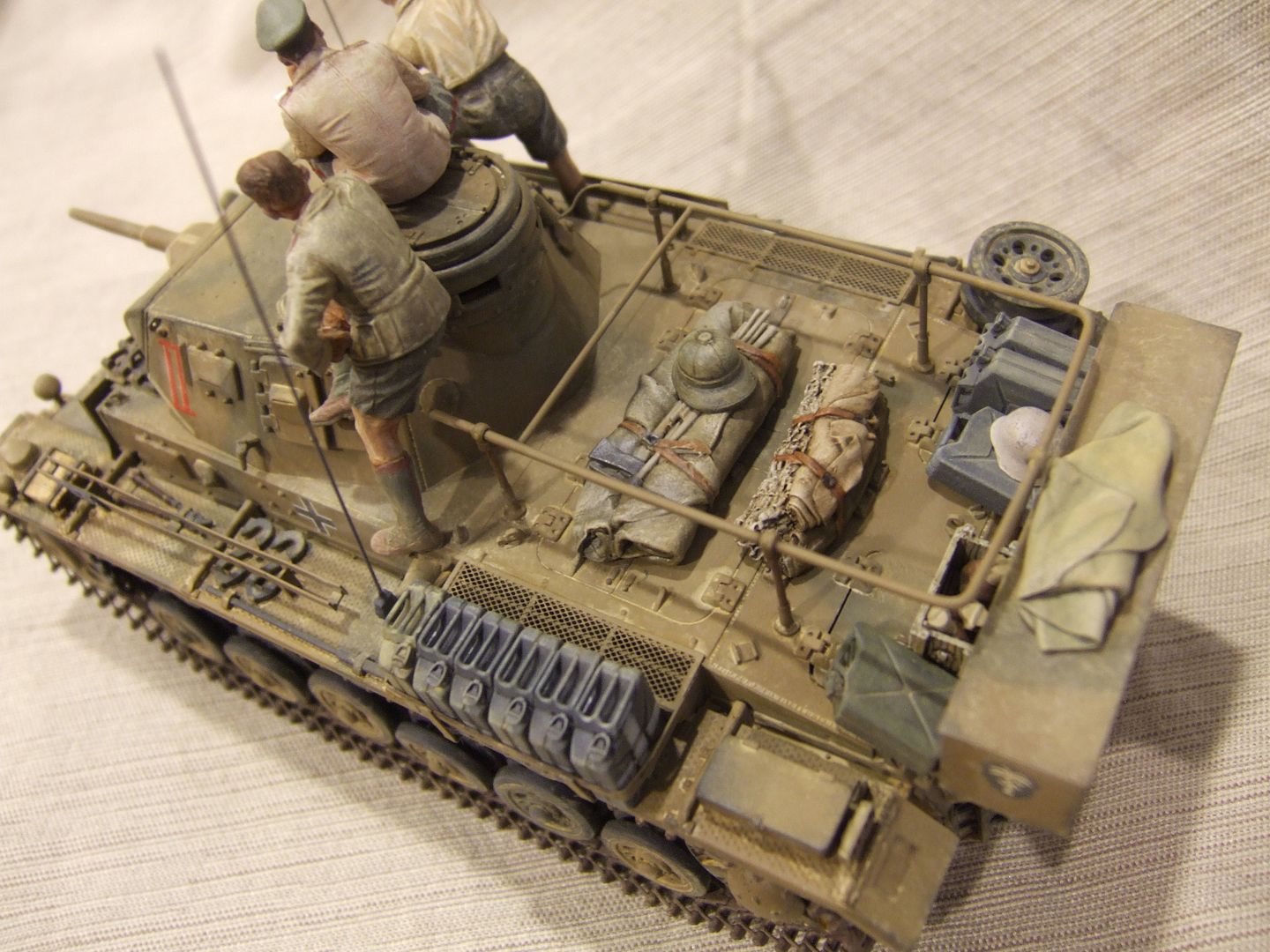

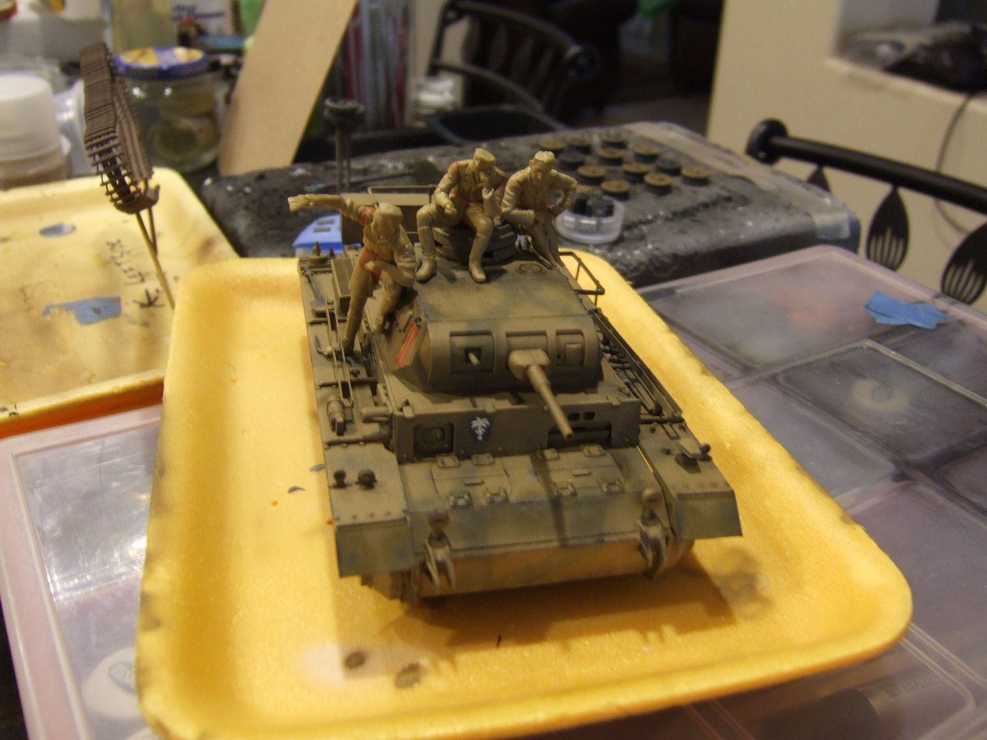

This will give you a hint as to where I will take this.
A bit of weathering.
The chipping and worn paint is just visible under the dust. Just like real life in North Africa.
