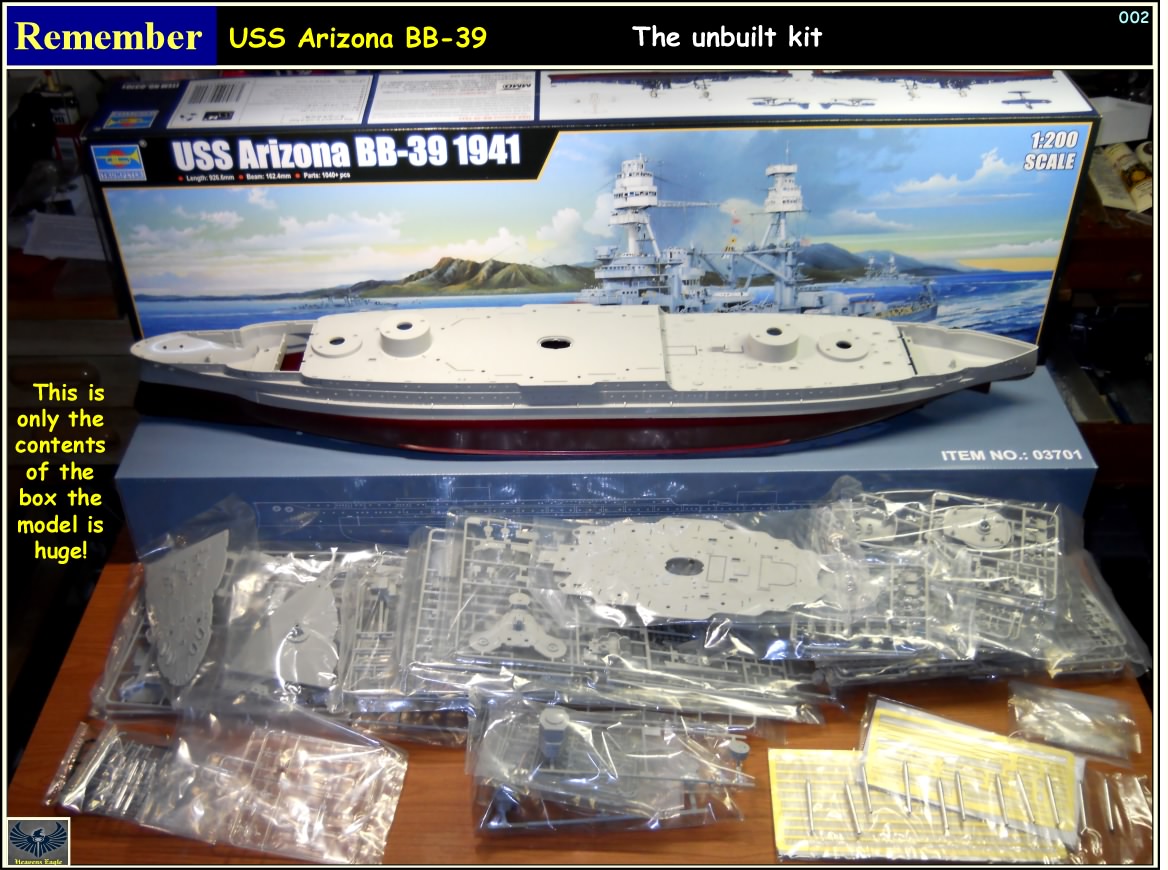

Trumpeter 1:200 Arizona

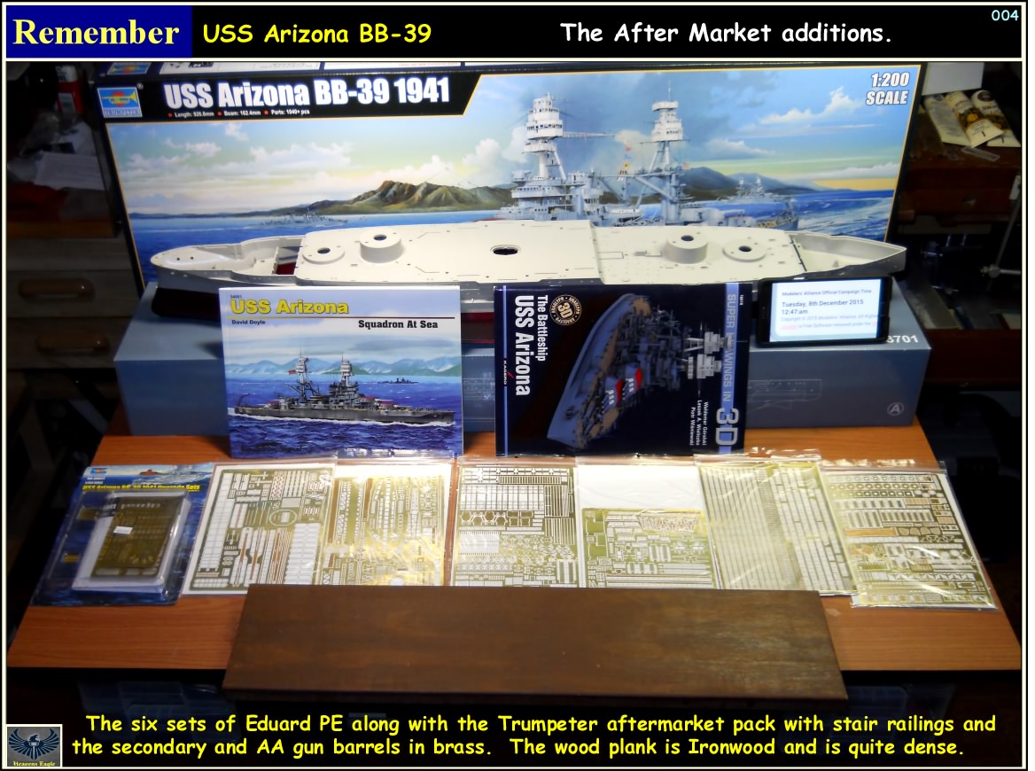

Greg, I have seen this kit built up basically out of the box and it "looks" like the Arizona. My attention to detail and level of detail I am willing to build to is taking it to a completely different level. As far a fitting together most Trumpeter kits seem to build up fairly well it seems. As for the KA set with the wood decks, that will have to be up to you. My opinion on the wood deck thing is that they are placing a thin piece of wood over what should be the deck level. If that wood sheet is 1/64th inch thick, it adds 3 scale inches to the deck and if you look closely you can see a lot of things that have to be changed. I don't really know much about the KA set, but I am sure that it will be done to enhance the basic out of box kit. I chose to paint the decks so as to get the exact look I want. As I posted I bought the Eduard Big Ed set and I believe it will work fairly well for me, at least what I end up choosing to use.

The Eduard Big Ed might not be available any longer, you will have to look. It might be available from say Sprue Brothers or another place like that and it won't be cheap either.
There are quite a few Eduard upgrade kits for the 1/200! Maybe those can be special request items 🤑

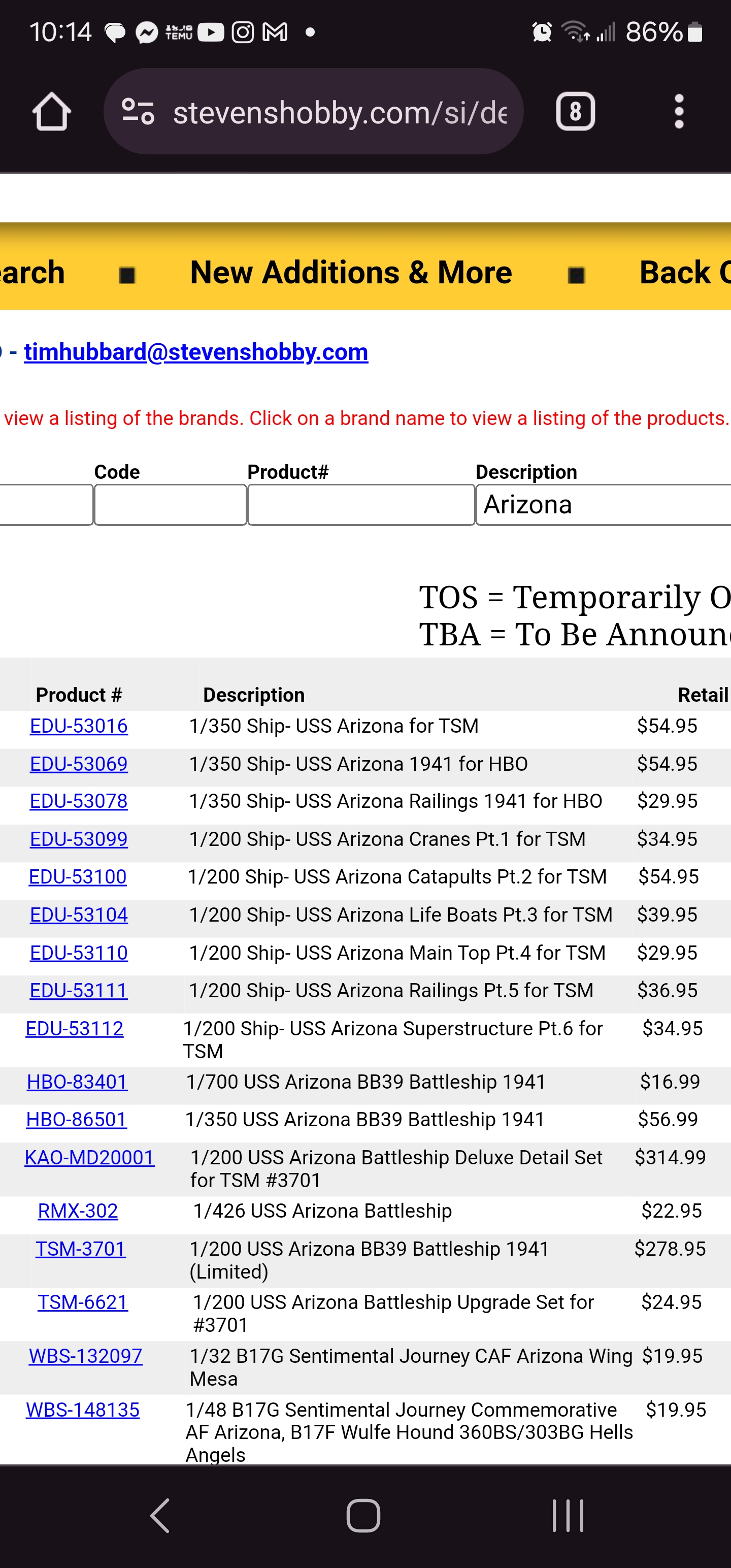

It looks like Eduard has split up the big set into little sets for each section.
The Sprue Brothers Big Ed set has eight PE packs for about $221 HOWEVER, idiot me linked to the Bismark!
:facepalm:
Eduard has two Big Ed sets for the 1/200th Scale Arizona:
Big Ed collection of 6 individual sets for 1/200 Trumpeter USS Arizona. One for the ship, the other for the crew...
USS ARIZONA - PART I. 1/200 Cat.No.: BIG5323 $160​
  • cranes
  • catapults
  • life boats
  • main top
  • railings
  • superstructure
USS ARIZONA - PART II. 1/200 Cat.No.: BIG5324 $115​
Big Ed collection of 5 individual color crew figure sets recommended for Trumpeter 1/200 USS Arizona.
  • USN sailors (2 sets)
  • USN deck screw (2 sets)
  • USN officers (1 set)
Yeah the Big Ed set has 6 packs or parts. I have them and am sure at this time that some of it won't be used or that some that IS used will be modified.

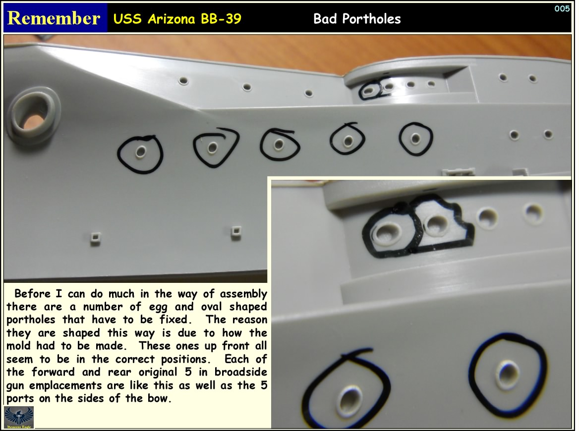

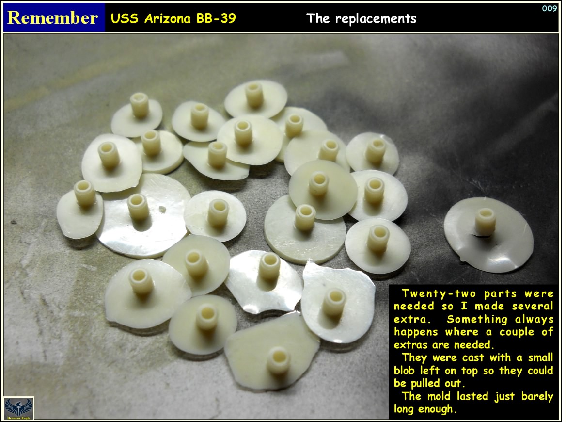

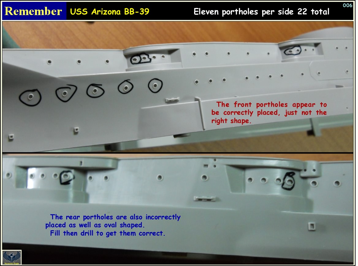

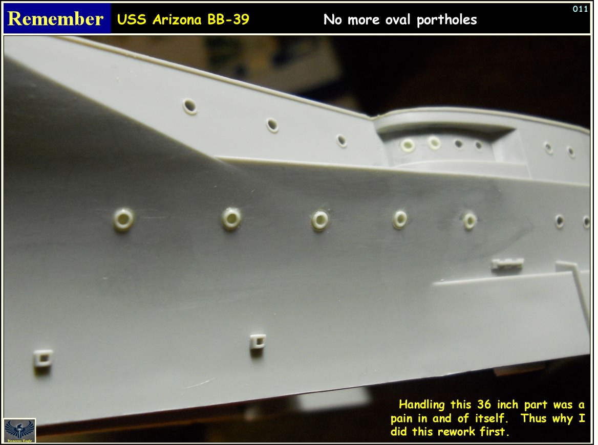

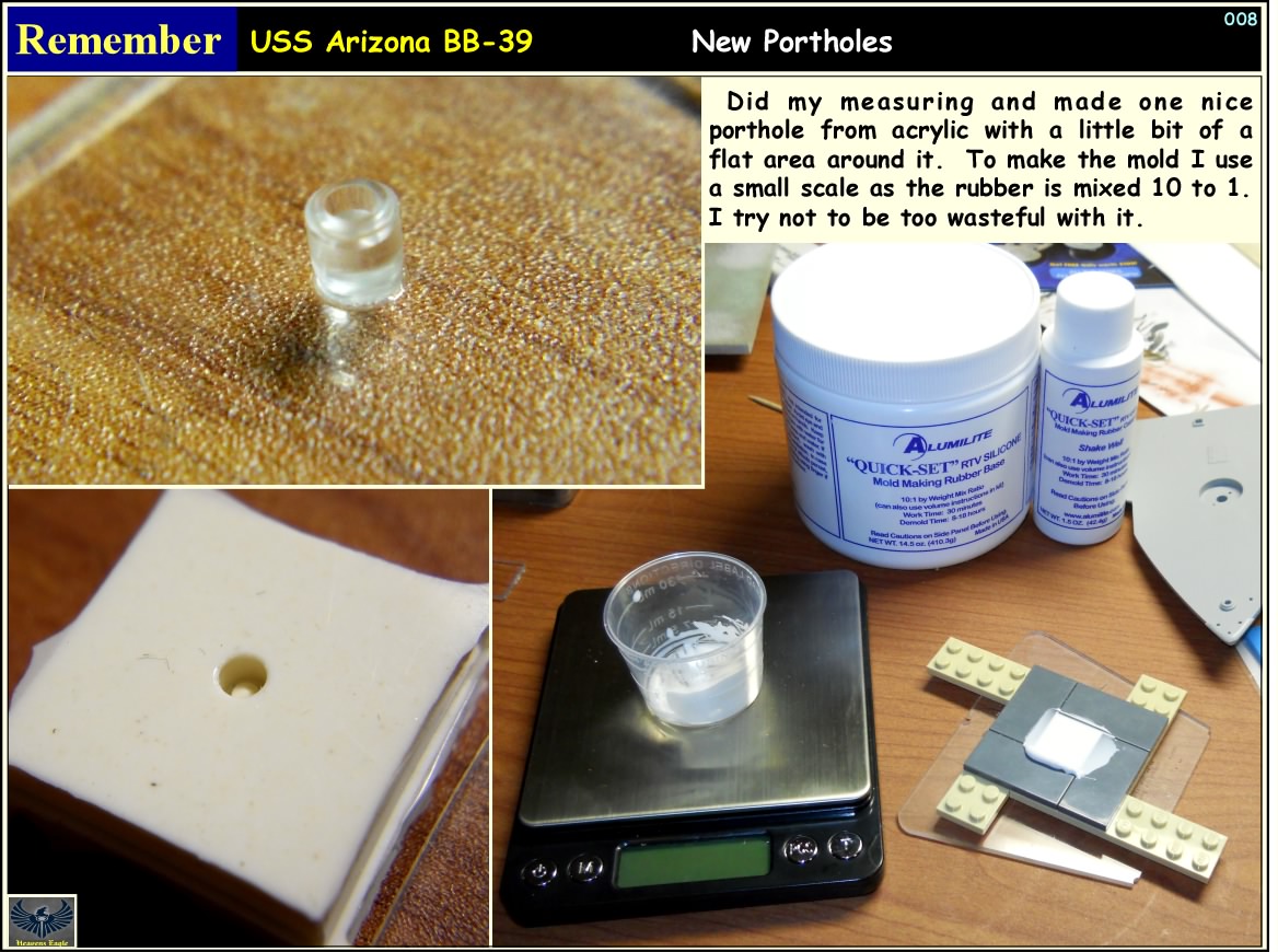

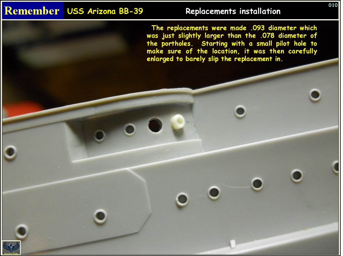

The cranes are a very good example. What I actually figured out from photos was no where near what the kit had or even what the Eduard PE has in it. The turned metal gun barrels I got seem to be very good and the ones I used have worked well. There is all the extra little stuff that I scratch built and cast to ultra detail the 5 inch guns. Let's not forget the oval portholes that I replaced. I have not yet touched on any of the hull shapes with the exception of the lower rear hull between the propeller shafts. I know the rear of the torpedo blisters taper too much at the aft and need to be built out and I suspect that the bow might be a little off shape as well. Time and work will solve that, and of course I will share all that I do which should make anyone following in my footsteps an easier path.
