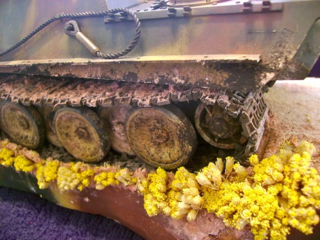

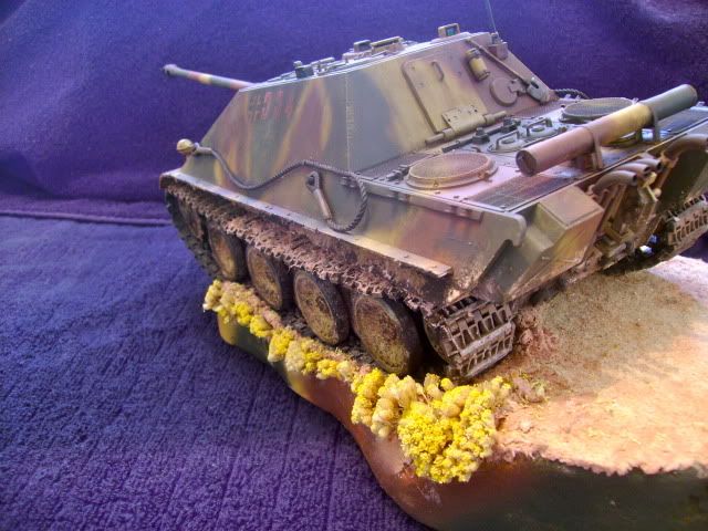

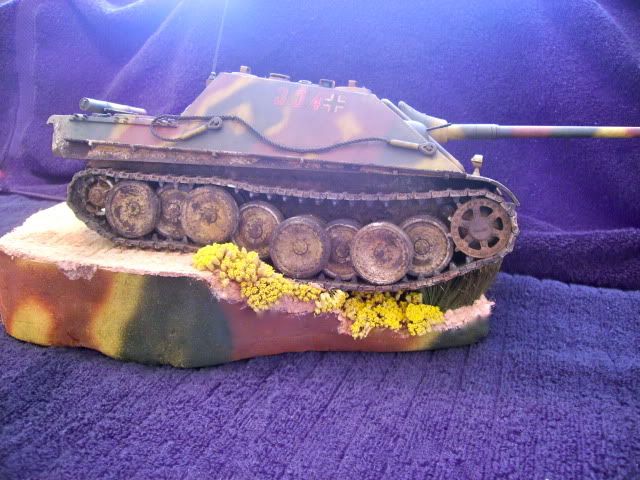

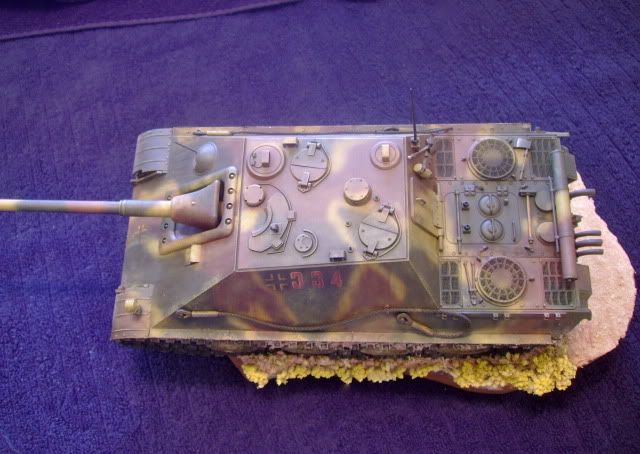

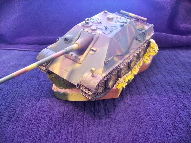

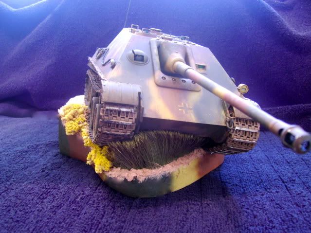

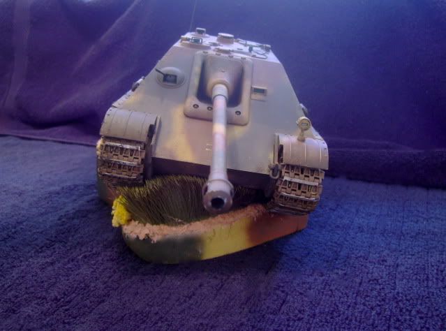

O.K. .... Here's an Up-date ... Weathered & Sittin' onna base. The Grass is from Hudson & Allen & the Flowers are from the Dried section of Michael's Craft Store . Moonie- sorry for th Photobucket pix .... I was jammed up on time & couldn't re-size .... :D
That's awesome Erik! it's coming clean off the base...really nice and simple base that adds a lot to something that's already a lot.
Thanx for th kind words Guys !! The base is made from the Pink 2" thick Insulation foam used in Building. It's designed to go between the Brick & Cinderblock of a Building. I just used a 32 tooth hack saw blade to carve out th land & make a Raised Roadway. I then used Sculpt-a-Mold for the ground work , colored with Tan/brown-ish craft paint from Wal-Mart mixed it with some Elmer's glue & water.
I applied the Tall Grass & dried flowers while it was still wet & added some Beach Sand( from the Outer Banks, N.C.) for the "dirt road". I Set th JP in the ground work while it was still wet & added the flowers around it. I was going for a look of Motion with th JP traversing the road to Field & accentuate the Workable suspension & to give it some Motion ??
