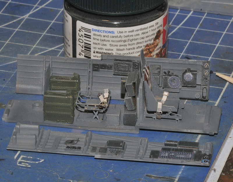

I also have the Eduard PE set which i was told is pretty much essential as it has the hinges for the flaps which are just moulded triangles in the kit, also with a large canopy its worth detailing the cockpit i think

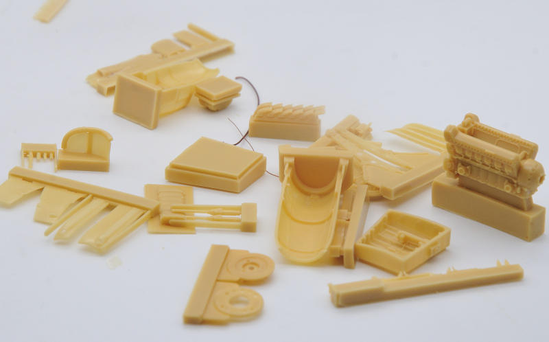

This is the resin set, its pretty basic and doesnt include cockpit or seats like most of these kits, it does include engine covers but they are for use instead of the engine as they will not fit over the top of it.
I think on reflection i will fit the engine. The set does include wing gun bays but maybe i will not include these as i always think gun bays are not really that interesting in 1/48 unless you have a magnifying glass :)

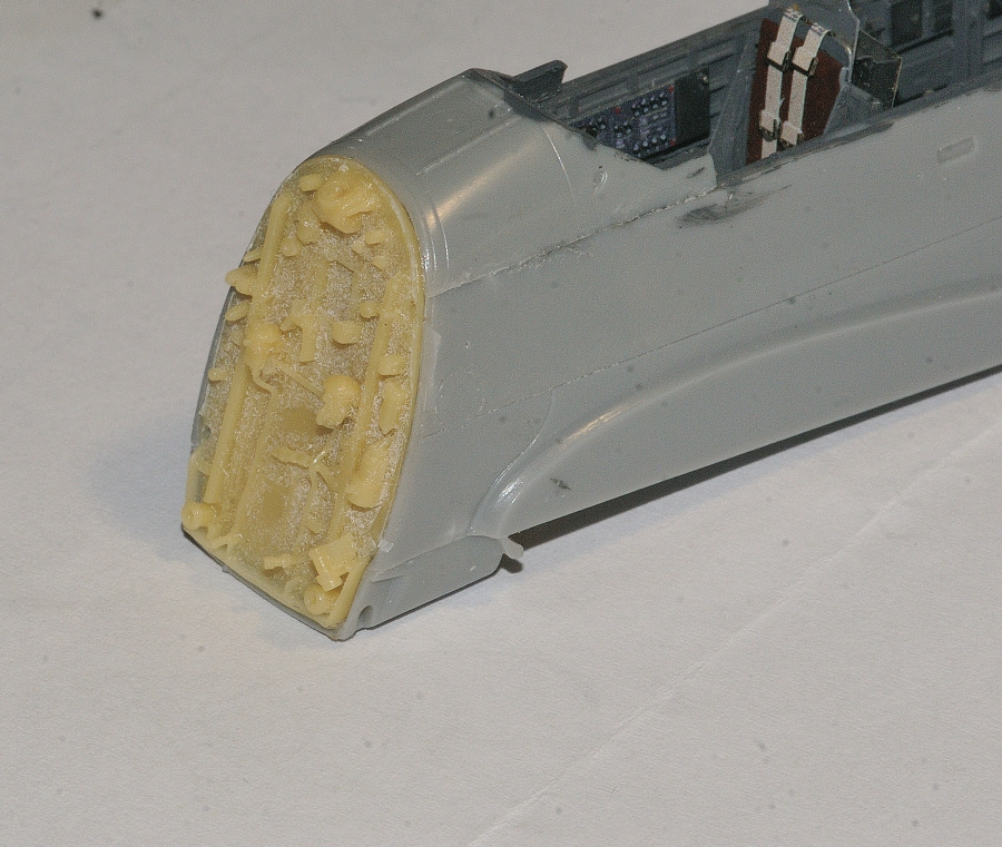

It might seem a daft thing to say but you can never actually start to do these aires builds till you have the engine bulkhead in because up to that point it could all be a waste of time /or go very horribly wrong :)
As usual there is a fair amount of cutting to do and you pretty much have to work that out for yourself. it needs to be spot on because everything is mounted off the bulkhead so it might look ok now but if its a few degrees out, hang an engine on it and it will look very "bent"

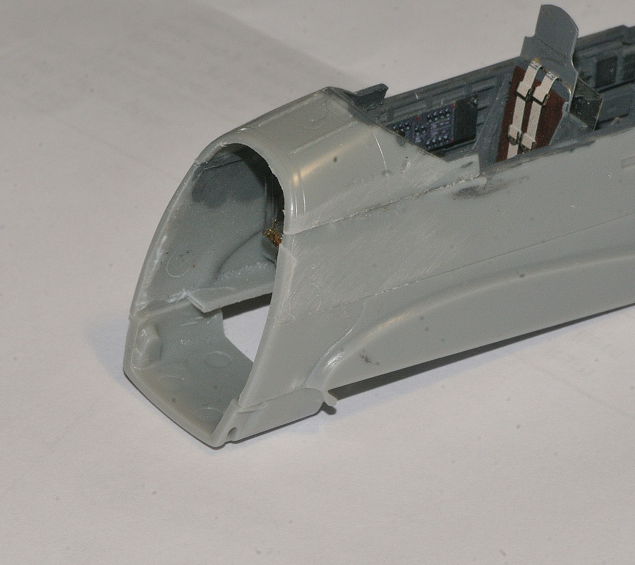

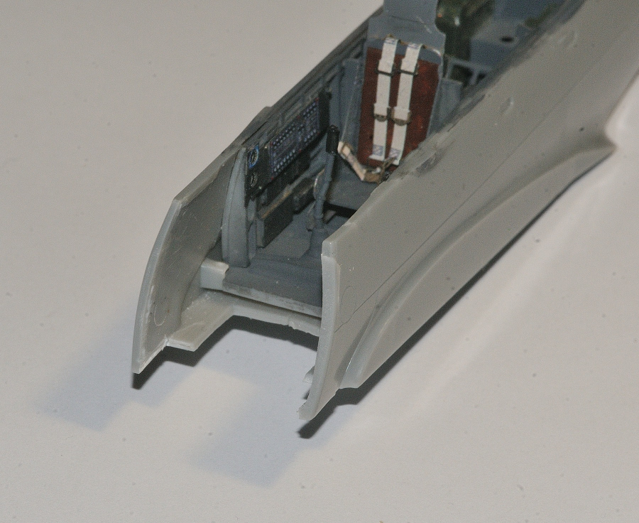

I forgot to take a "before" picture so pic one is after front/ top /bottom has been cut away
This bulk head does not want to fit and will fight you all the way. the old saying measure twice cut once is out the window here , its test fit 50 times, adjust 51 times then decide thats probably about as good as it will ever be.
Good news is its all down hill now :)

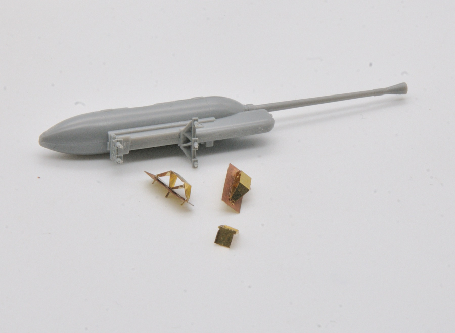

I really don’t seem to get on with Eduard PE

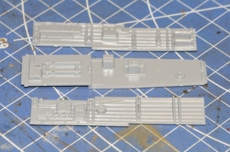

After several hours building the wing mounts for the cannons in PE and several more hours looking for parts on the carpet, I just couldn’t get them to line up with the mounts on the cannon. The mounts on the wing seemed a couple of mm further apart and these are very delicate parts that don’t take much handling. In the end I cut them off the wings again and went for the kit parts. On fitting the kit parts I realised they were round the other way and checking back the instructions from Eduard are printed back to front …doh !
Too late now so its kits parts which TBH look just as good.

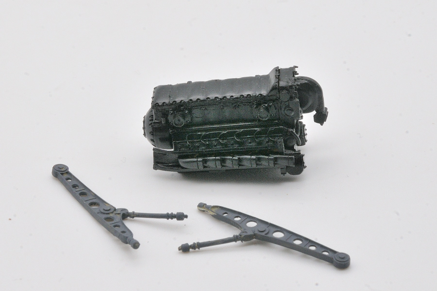

Work on the engine and mounts has stopped as I know from experience that I need to finish the model bar the engine as once it fitted it will be so fragile you wouldn’t want to handle the model more than you have too and certainly not try and mask it off for painting

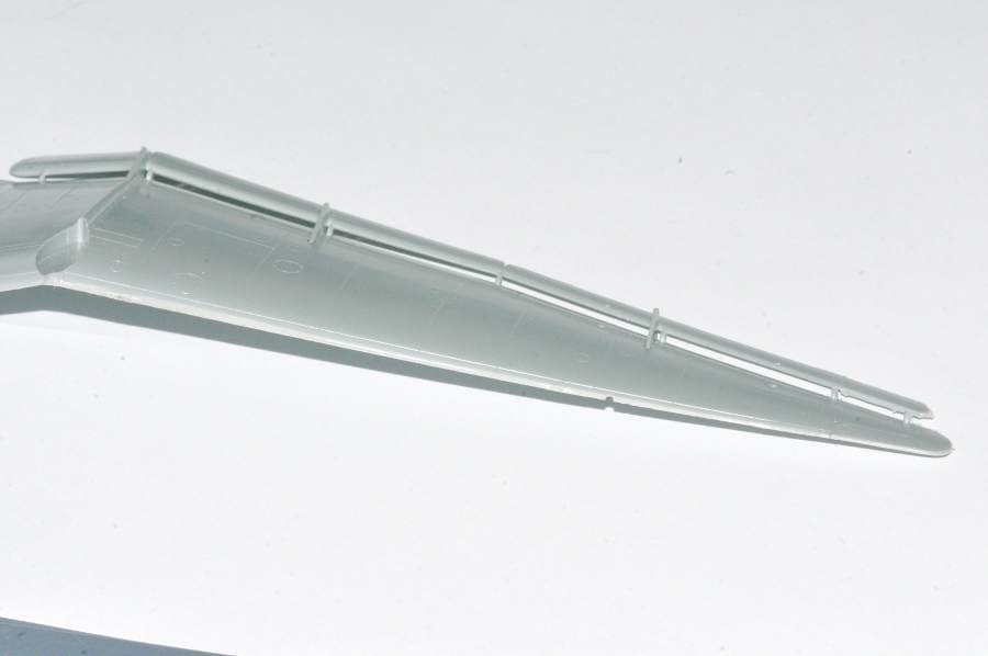

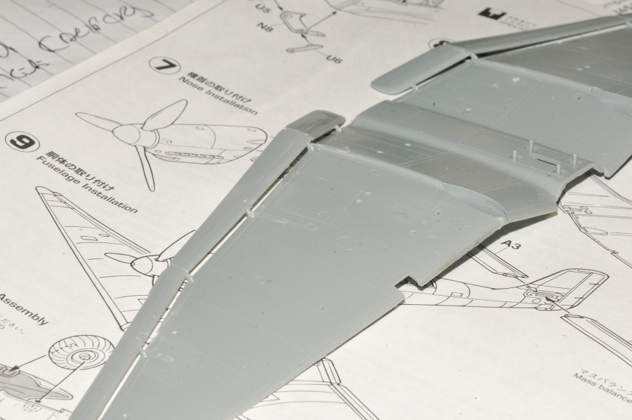

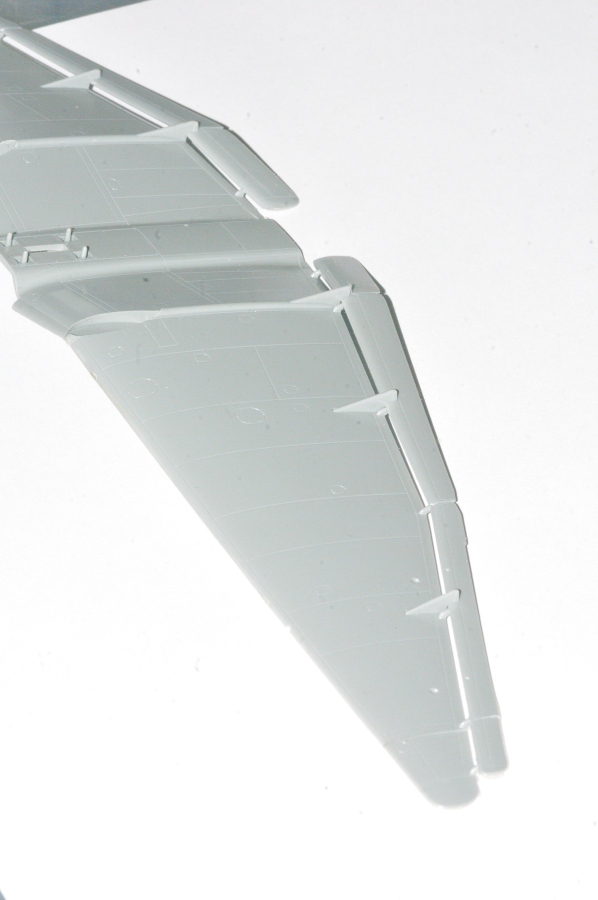

I also cut the flap actuator’s off the kit wings to be replaced by micro thin PE. That might be a mistake as well given no one will notice and they have no strength/integrity what so ever 😊

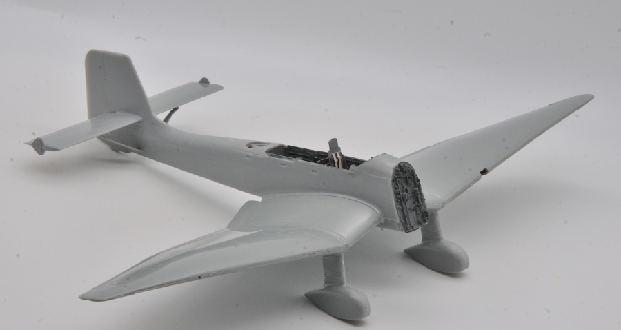

I have to say i am just going through the motions with this. What is it that makes some builds exciting where you really look forward to finding some time to do the next step...and others that seem to be something that you need to finish to get it out of the way :)
I suppose in some respects its the subject ? I like the challenge of after market but i dont really like German stuff in General which i suppose, given they tried to blow us off the face of the earth is not that surprising :) .
