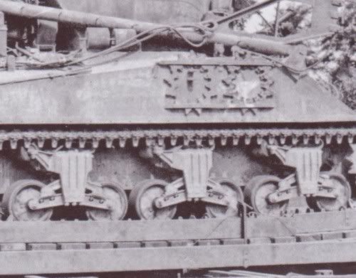

Hi Aleksandr
This photo should clarify the support arm in question on this TRV.
The centre bogey assembly is the same as what you have on your kit at present, whereas the left and right assemblies are of the newer redesigned style where you can see the arm has a definite bend in it's appearance to sit it the roller wheel higher than the previous to increase tension on the track.
I would say that there was damage to the arm or bogey assembly complete on this TRV and the maintenace depot was low on replacements same for same.
But know that all M4A3 with wet stowage (as is yours) were built with the upswept style, and a situation like the above pic could occur but maybe to only one or two of the assemblies?
Brad
Brad thanks you for an explanation.Most likely I have made a mistake without having understood correctness.I will try to approach in more details in the future to this question.But as they say, business is already made,to correct I cannot any more, I can break much.
