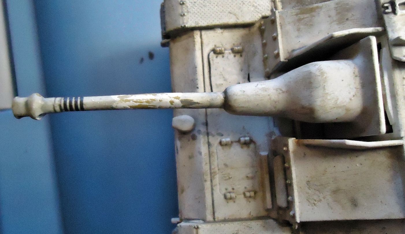

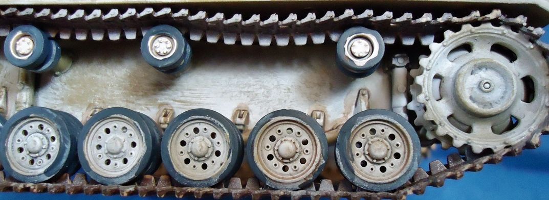

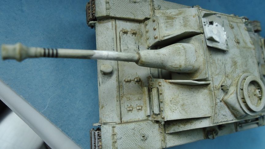

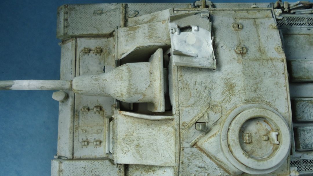

Okay then........... I applied a MIG cold grey wash all over this girl. Should I use a light or darker brown wash over some areas? I have MIG brown wash,and I think I have MIG neutral wash.

Think spots, streaks and layers. Be subtle, you can always add more.![]()
Looking good Zod. Good to see you gave the winter cammo a go. A hard finish but I think you have really got the right feel.
I would go with a dark brown pin wash with a very fine brush. Oil paint mix 5% black, 70 %Burnt Umber, 20% Burnt sienna.
Be very subtle and don't do any more overall washes as you will destroy the winter cammo effect.
You just want to add some dark brown for subtle definition around some detail - but not all. go for random areas on the rear decvk , roof , front hatches and checker plate on the track guards.
I would finish with a subtle brown dry brush on some edges and on the surface of the track guards where there is the dot effect. This dry brush's well and will give a worn cammo look where the soldiers and gear rub it off - just be subtle and take nearly all the paint away from the brush before starting.

Yeah that's a lot better than what I had! Ain't you glad you waited Chad?
So I know the white area on the barrel,and the MG shield stand out. I had to fill in the ejector pin mark on the MG shield. I will add the MIG cold grey wash on those areas.
