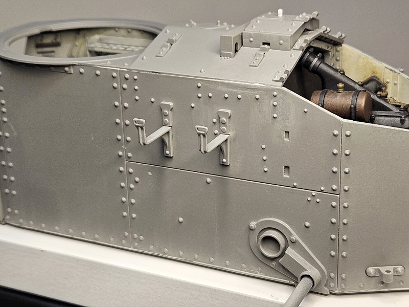

Renault Ft, 1/16 scale.

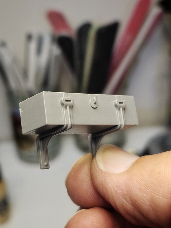

What is going on here?

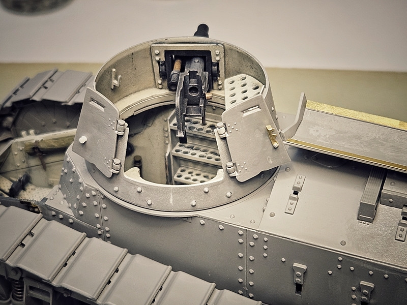

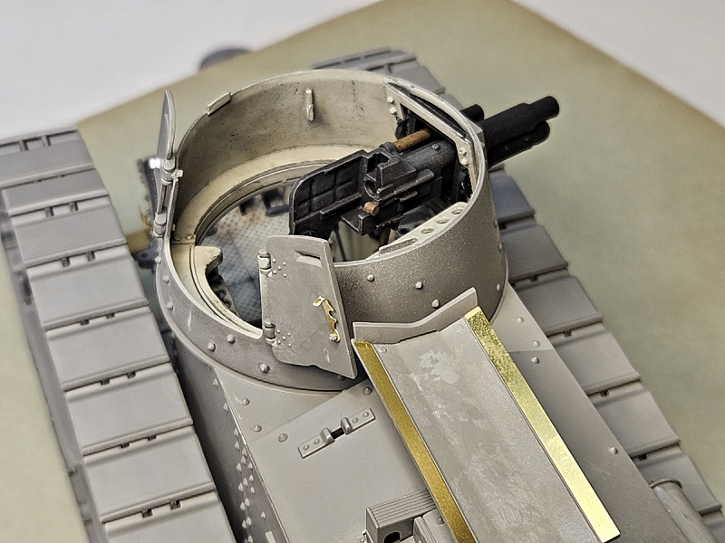

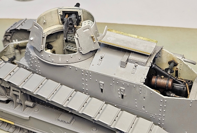

The 37mm gun is in. The turret hatch doors needed some details, like the latch lock. I've seen a couple of different styles used. I did the one for the cast Girod turret. The leather strap handles will be added after the paint is on. The cupola hatch is done and textured. The turret, being cast, will get a heavier texture once the top is on permanently. I'm leaving it off right now because I have a surprise coming. James has
printed some shells for me!!

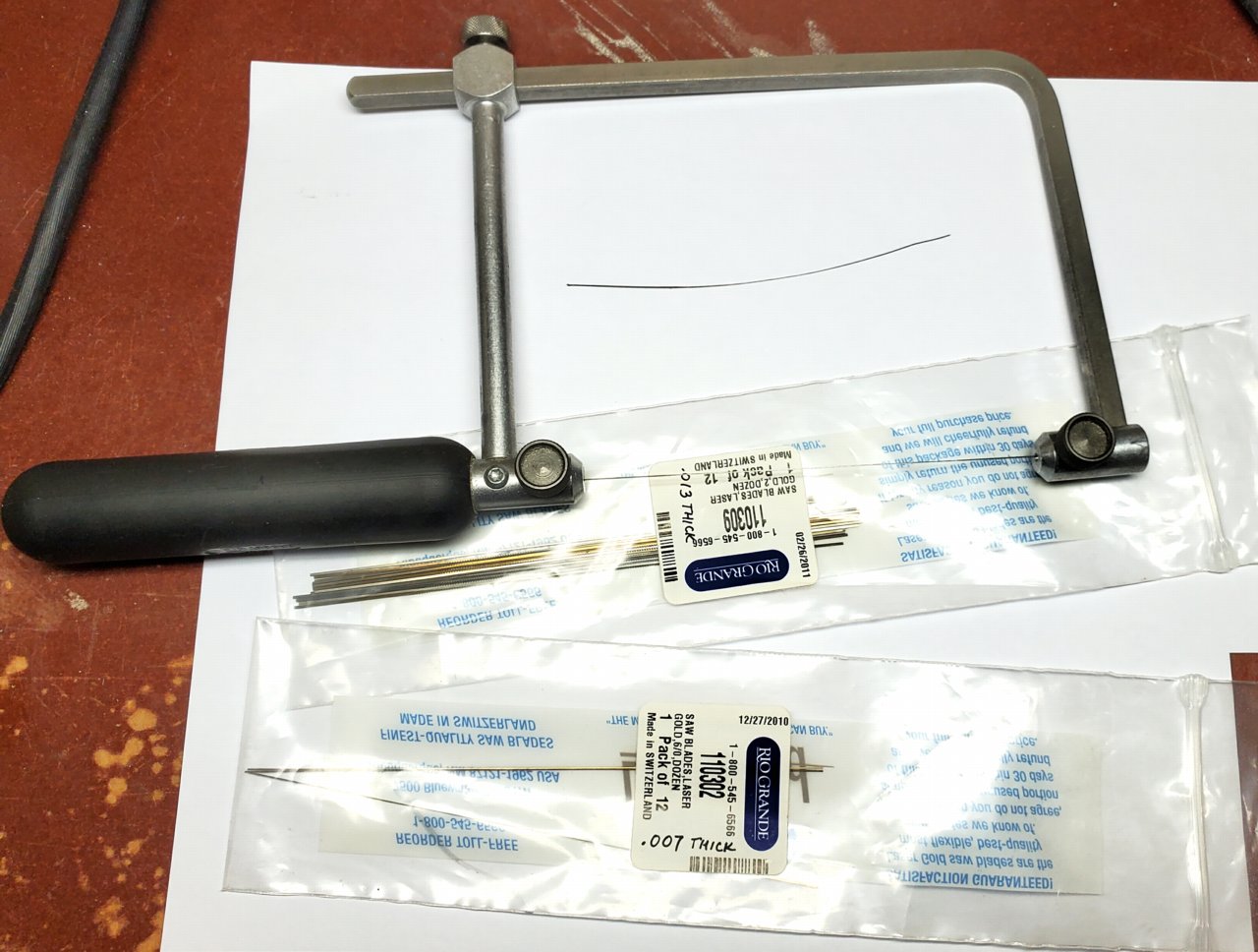

I have several Jewelers saws, but I found one a while back (I think at Rio Grande jewelry supply) that works so much better than the others. This one has through holes that are tapped and is designed so that the knobs can be switched from one side to the other. I found that being right handed and having the knobs on the right side keeps them out of the way. Much better than the cheap frames, but it wasn't all that much more expensive and was well worth it.

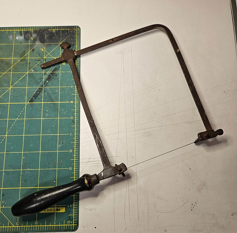

I'm a lefty. I haven't had an issue with the blade lock screws. Unlike other tools that are naturally designed for the right handers ...skill saws, chopsaws etc...

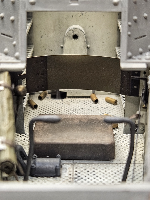

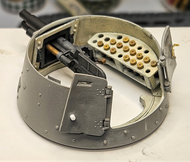

James (jknaus) surprised me with some 37mm shells and some spent casings he printed. THANK YOU JAMES !!!
He also printed the racks for the hull, but I am to far into the build and can't get the kit racks
out now. However, I'll be loading up the turret rack with them 😎
As James suggested I scattered some of the painted up casings on the floor of the turret compartment. I think they look great.

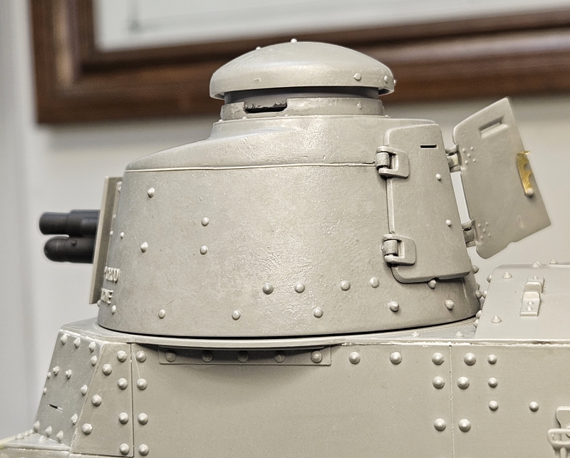

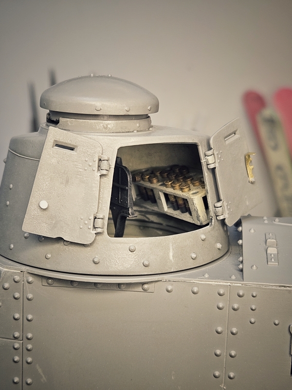

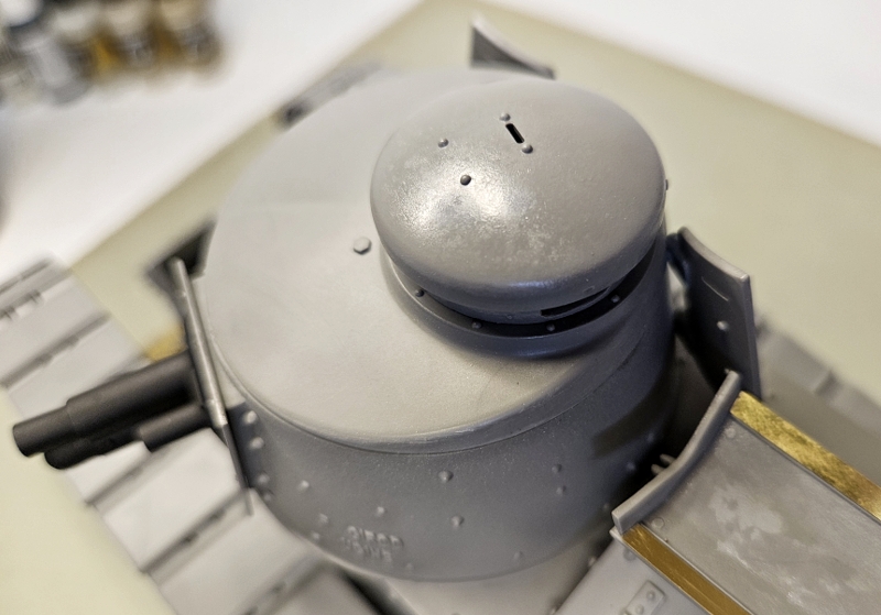

With the shells added to the turret rack, I glued the turret top on. The Girod style turret was cast in two pieces, with the top piece being welded to bottom
. Since the turrets were cast a felt the need to add some texture to it.
