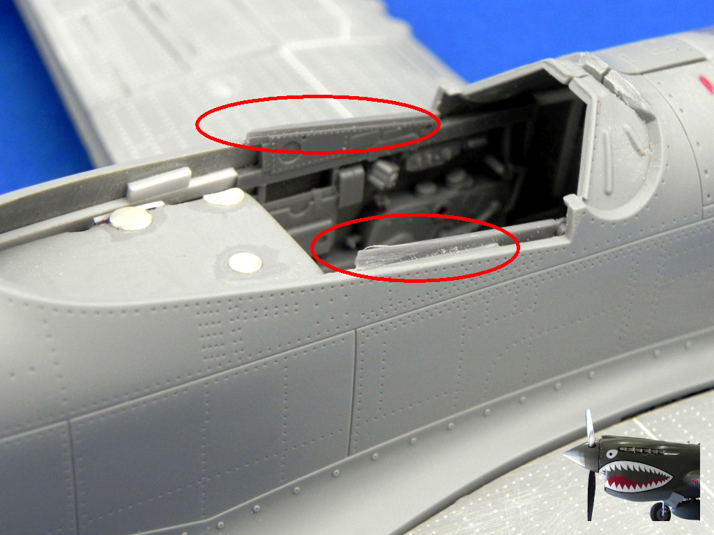

Decided to look at the canopy and find out what is visible before getting too carried away.

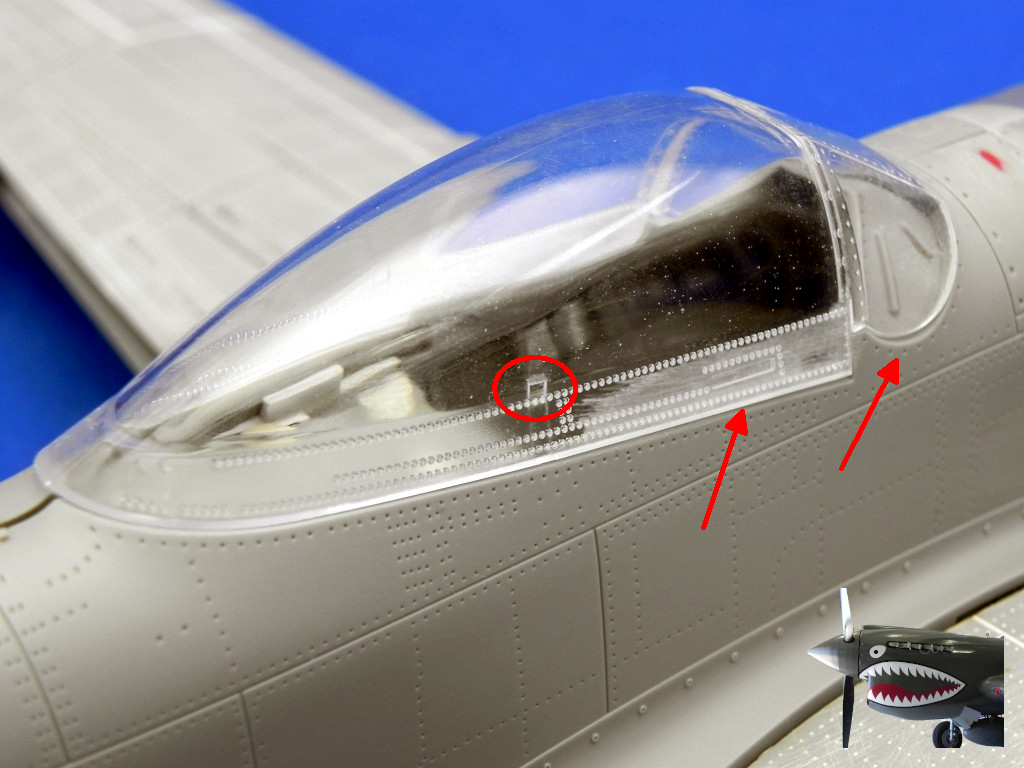

The canopy didn't fit at all thanks to two tabs which needed removing. Windscreen still doesn't fit but I expected that. There is also a seam along the top of the canopy to be removed as Dragon correctly made it bulged so used a two part mold.
The worst of the canopy fit was due to my using the Tamiya cockpit sides whose rails interfered by making it too wide for the canopy to slide over. Easily fixed by sanding down and it is invisible as it is hidden by the canopy frame:
