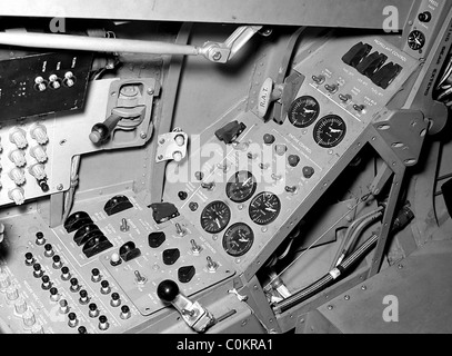

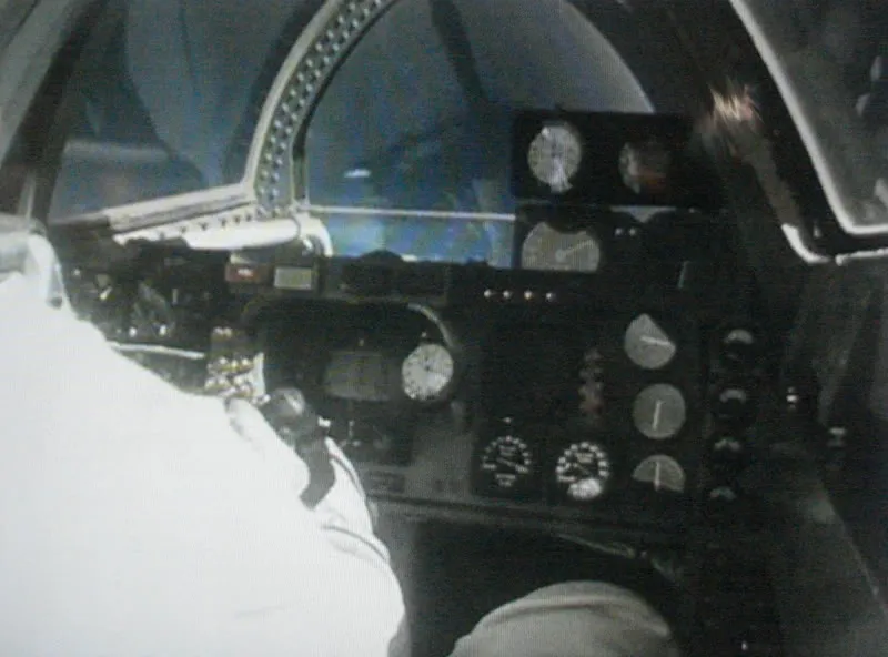

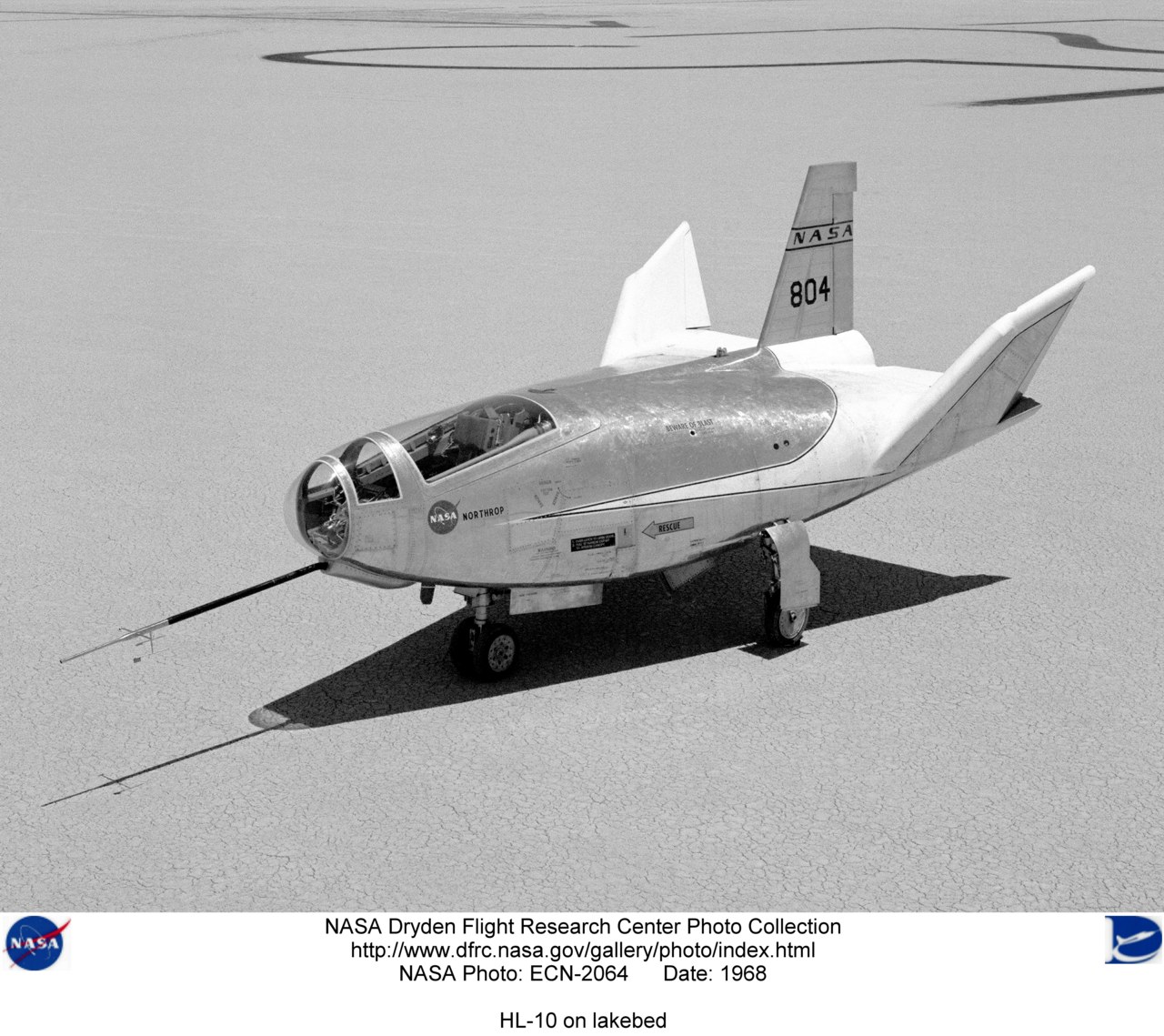

I have a small box of rather interesting vac kits. One is of the HL-10 lifting body and is about 60-70% done. Hard part was coming up with landing gear and trying to find cockpit photos for it. (Another 80's build that stalled from lack of info) I also have the other lifting body X-planes in 1/72 but never started them. The kits were super sharp and crisp with reasonably thick/thin plastic At this point I could probably finish it in a reasonable time frame If I could come up with cockpit info. (Saul?)

You just need to find a donor T-38 for the landing gear and then throw a tarp over the canopy to protect the cockpit from snoops :)

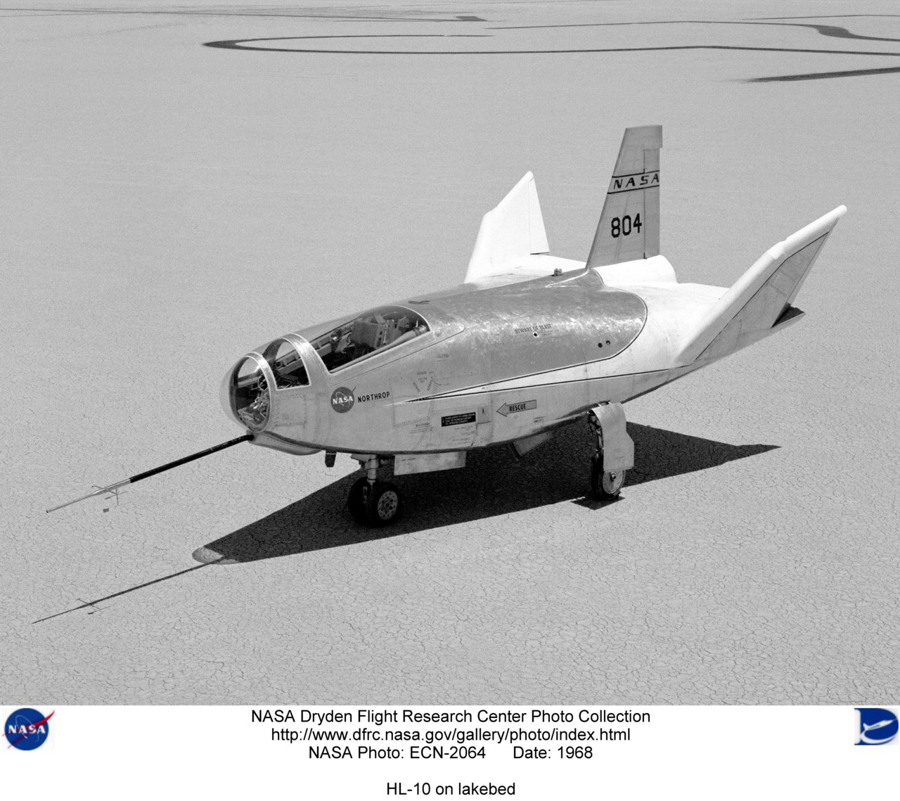

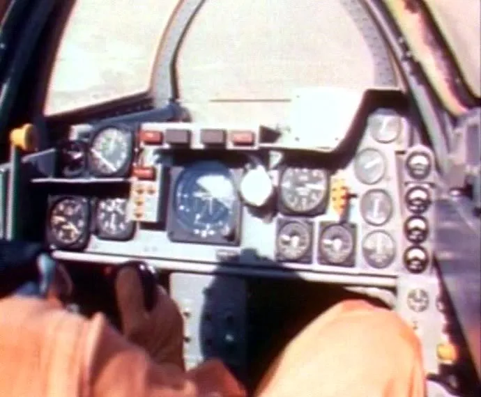

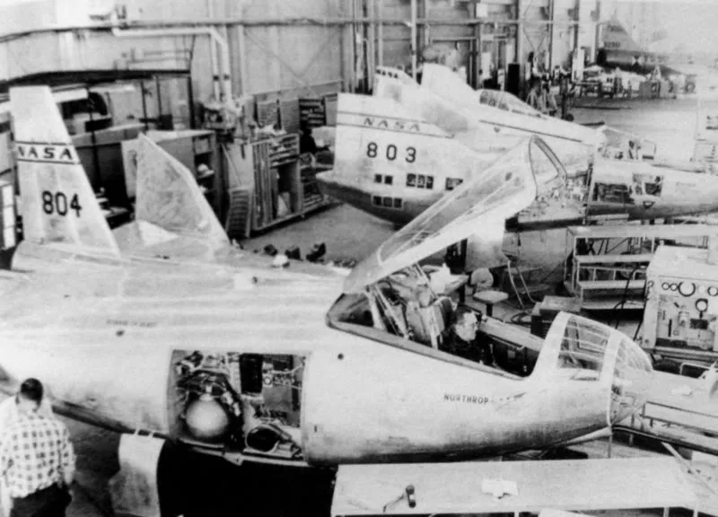

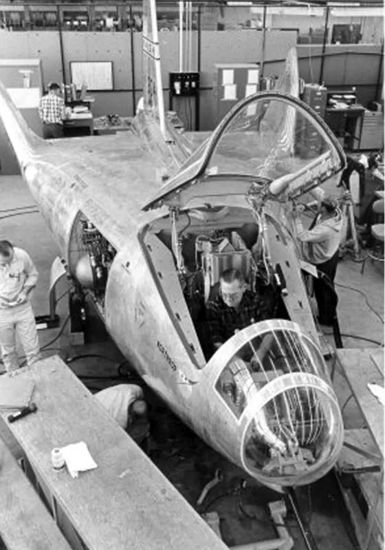

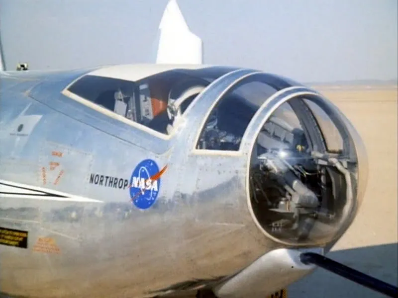

  • Landing Gear: Main gear was a modified T-38 system that retracted manually and lowered by nitrogen pressure. Nose gear was a modified T-39 nose gear that retracted manually and lowered with nitrogen pressure.
  • Pilot Ejection System: Modified F-106 system.

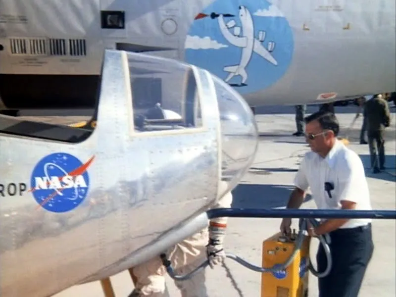

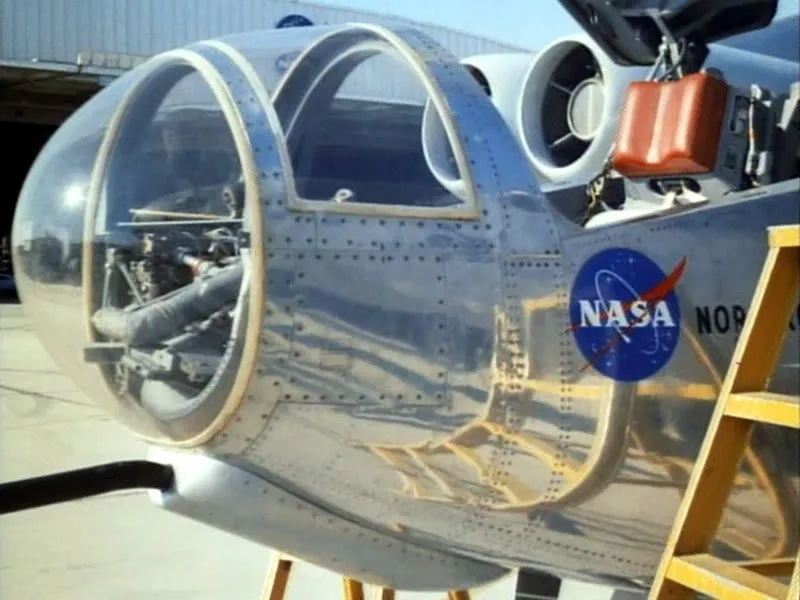

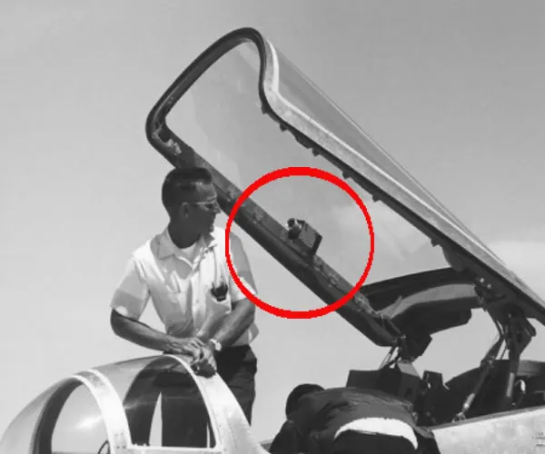

Note camera added to canopy for filming:

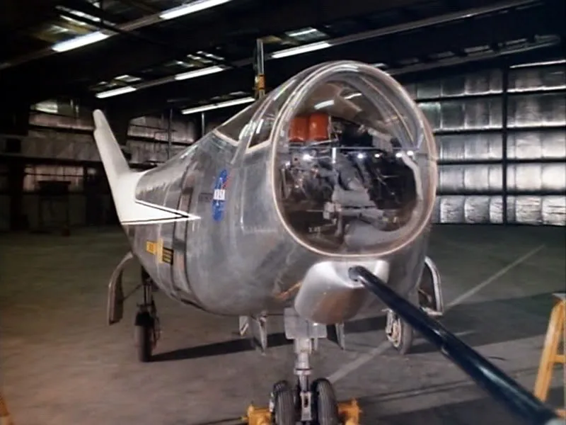

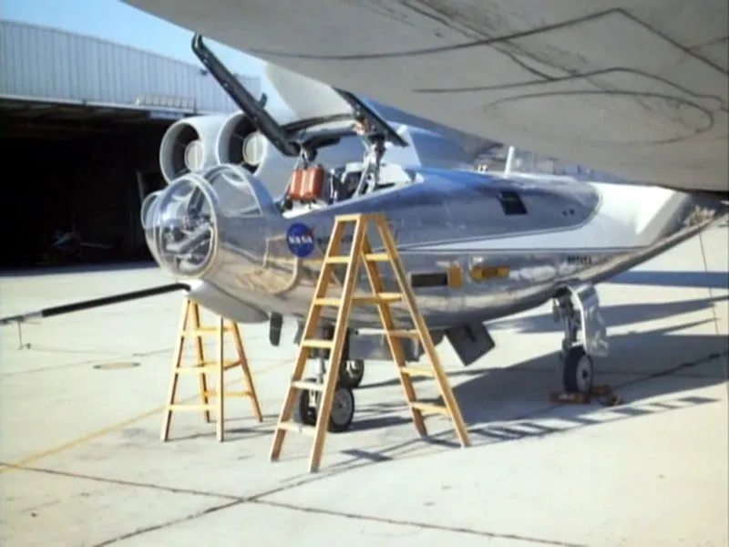

The real deal NASA's HL-10 was pulled out for storage for this:
Real Deal used by NASA

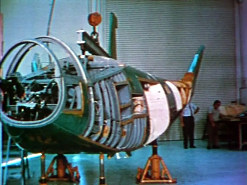

Under construction
