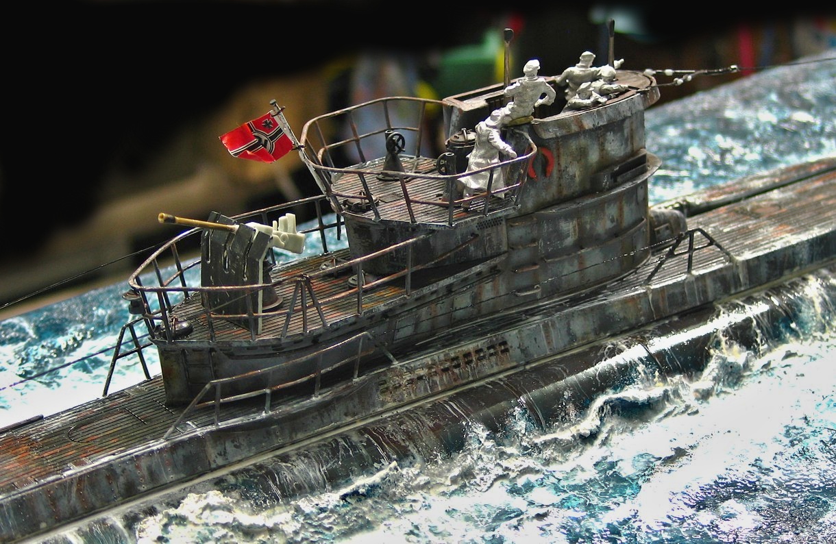

Hello again,
i have been working further on the water effects for my UBOAT hoping that I can finish before the Australian Model Expo in June but i think I have missed that boat. :(
I have added the rigging in wire, and cotton for the lower side rails, to help them look saggy on one side as I have seen this effect in a number of u-boat photos (I think due to wear and damage).
The water was further improved with layers of Tamiya clear acrylic mixed with MIG white pigment - in between this I used white oils. I finished with Tamiya white gloss acrylic and touch ups with white oil paint.
I used various mixes of blue and white with clear to achieve soft and hard white water with depth.
I also added all the water streaking and crazing on the wooden deck, around the rails and pouring down the sides. I then added the water spilling from the deck overflow outlet along the top length of the ballast tanks and hand streaked all of the crazy water patterns as the last of the water empties out after a large wave has crashed over the wooden deck.

My final detail effects were the 'wind blown' froth on the forward nose decking, simulating small amounts of white water that is being blown by the wind as the U boat travels forward through another wave. As well as this I have tried to simulate the spidery froth paterns that are left at the edges of the churned -up white water. I have painted these over the cloudy white clear ares but as I stated earlier the photos really don't capture my work properly so I am disappointed that I can't get them to photograph properly.
The water was extremely difficult to photograph and kept reflecting the light so that my overall photos just show the white water as brilliant white and hide the subtle water effects. Please refer to the detail photos for water effects but even these do not capture it correctly.
Where the water is so white that you can't see any detail the light has blown out that part of the shot.
The water looks 50 % better when you can see it in person. I will have to correct this for my finished photos.
I hope you can see the difference since my last post, as I have spent another 3 weeks adding this stage of paint with a detailed brush.

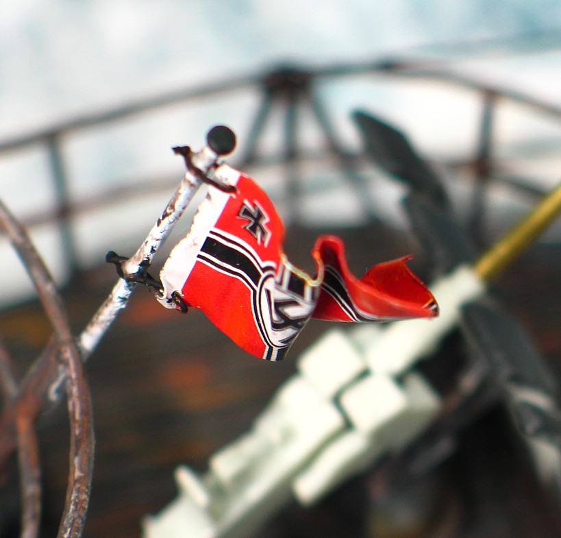

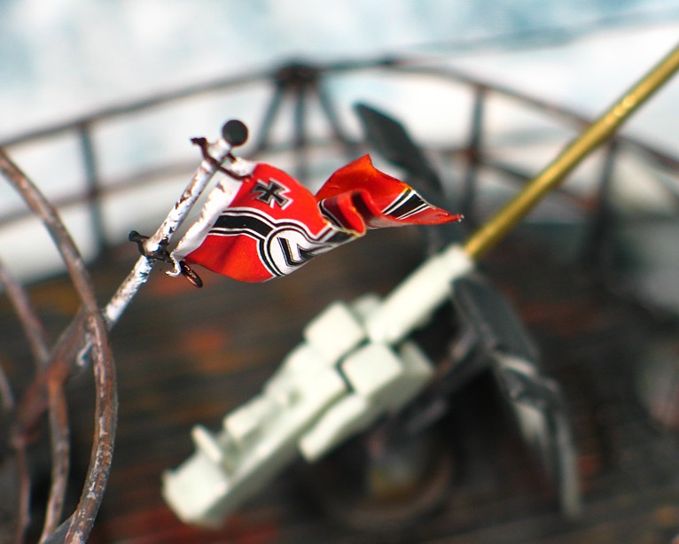

I completed the Archer flag, made the attaching wire, weathered it a bit and folded it like it was blowing in the sea breeze - this is why Archer make the best flag decals.

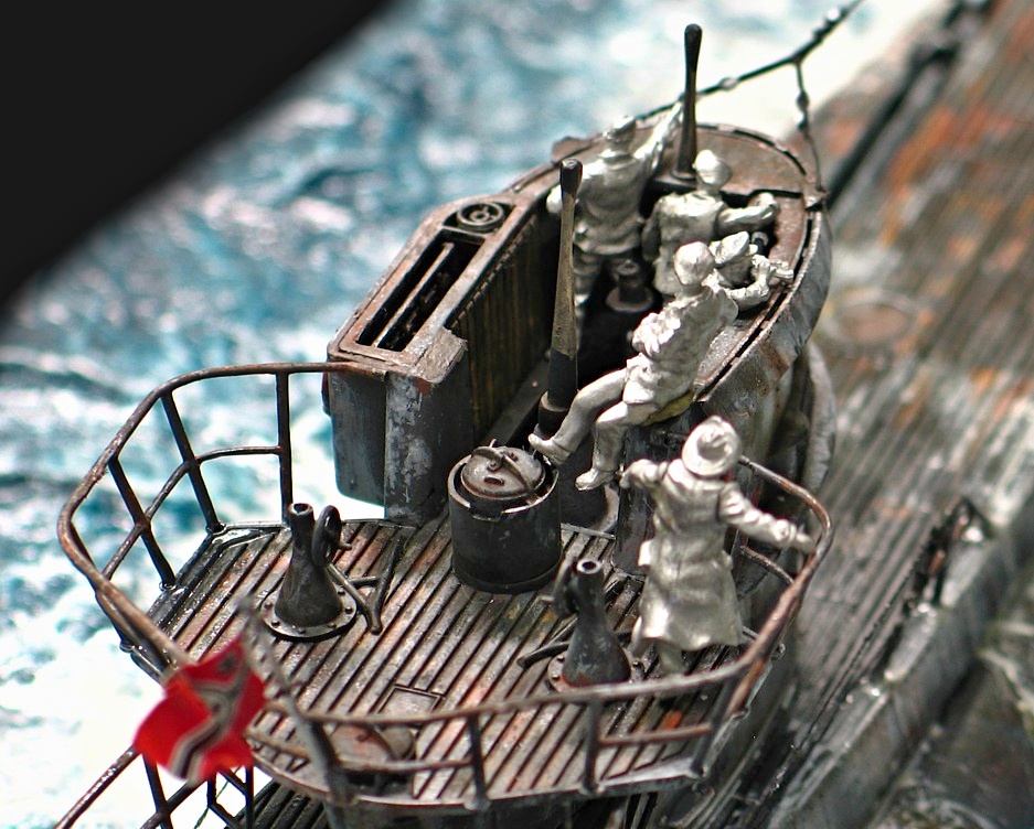

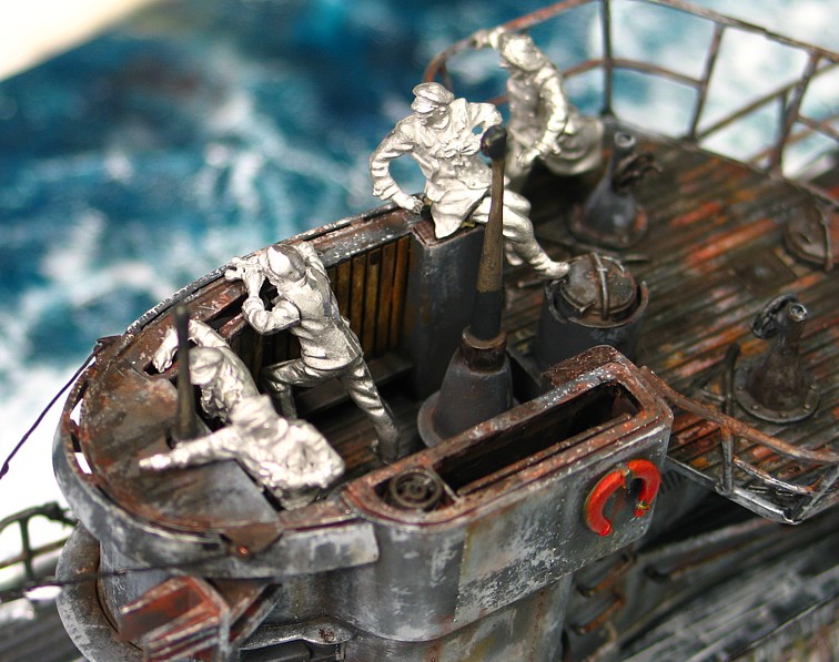

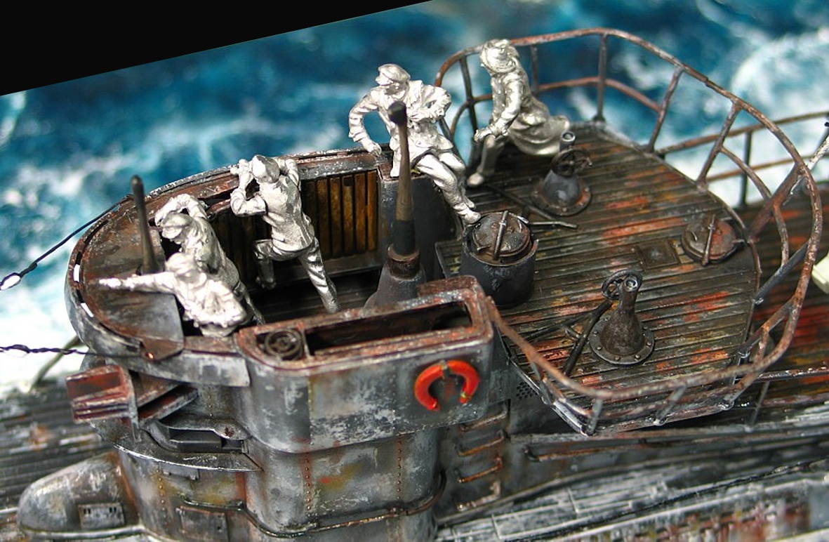

Figures (even in silver) really bring a model to life.
I got my figures assembled but not 'puttied-up' or painted as yet. One draw back to these great poses is that do not seem to fit the Beau fighter flying over idea as I originally intended, so I might need to drop that - well see :(

Hey, cool! Chrome crewmen!! :rotf :drinks :drinks
The flag looks great, so does the flagpole!
:laugh:
I was expecting a 'Silver surfer' comment but I like 'Chrome crewman' nearly as much :rotf .
Thanks Mike (y)
Ian.
