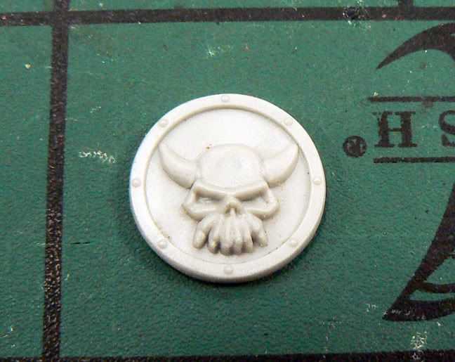

I will be using this fantasy warrior’s shield to demonstrate the technique.

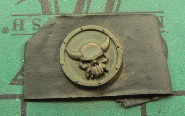

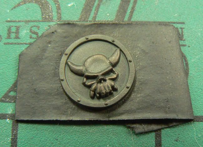

I applied a coat of Flat Black primer.
Next I applied drybrushing using Tinny Tin. Make sure you cover a lot of the raised surfaces with this first drybrush.
Once dry I applied a wash using Bronze Green. This will represent the characteristic green patina that forms on bronze when it oxidizes.
Once the wash is dry a second drybrush is applied, this one with Brassy Brass. This coat is lighter than the first drybrush.
Next is a second wash. This time using German Fieldgrey.
Once dry the final drybrush was made using Bright Bronze and making sure you pick all the raised areas.
Finally I applied a thin coat of Turquoise glaze over the piece.
There you have it, oxidize bronze.
