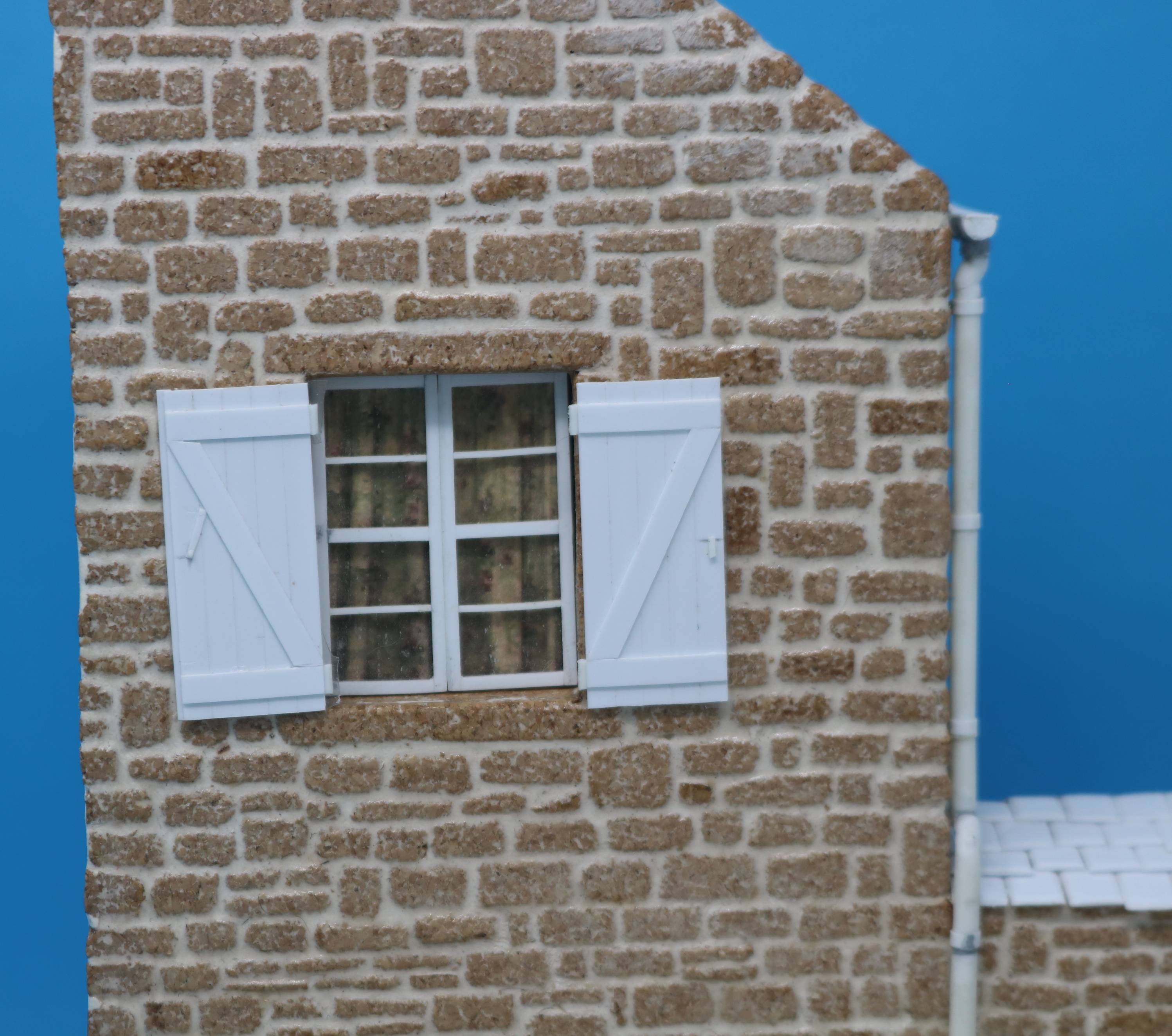

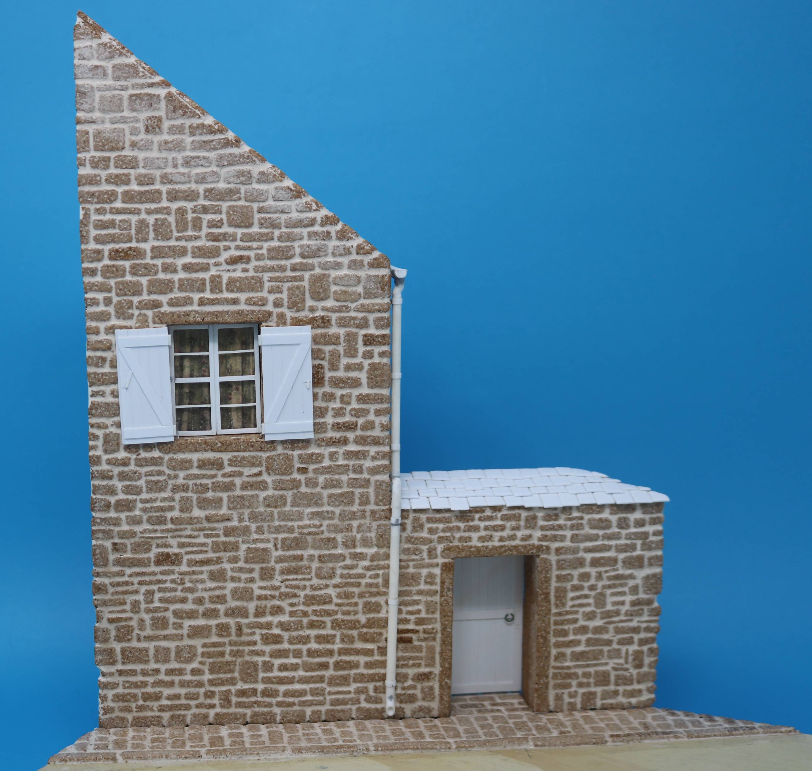

Armed with features and details from photos and blogs of DYI'ers renovating French stone houses, I drew up my plans on my CAD package. The walls were printed full size and used as templates to cut foam core board for the skeleton. The stone veneer is 2mm cork sheet individually cut and sanded to various shapes and glued to the foam board with wood glue. (I almost sanded my left thumb and index finger down to the bone shaping the stones.) After that set up, I applied spackle compound with a platistic pallette knife (found in the craft section of a dollar store) to fill the mortar joints. Using a piece of damp sponge, I wiped the excess spackle off (like you do with ceramic tile) and that leaves a slightly recessed mortar joint.
True to a real period stone house, once the cork was applied the door and window were no longer square. The shutters, windows and door were made, with some fettling, from styrene stock using photos as a guide. After scratching my head for awhile trying to figure out how to make curtains, I found and printed a suitable picture from a blogger decorating their bedroom in a 1930's-1940's style. The picture had them hanging in the window so they had highlights and shadows from the pleats. Once scaled and printed, I shaped the curtains to accent the pleating and glued them to the back of the window frame.

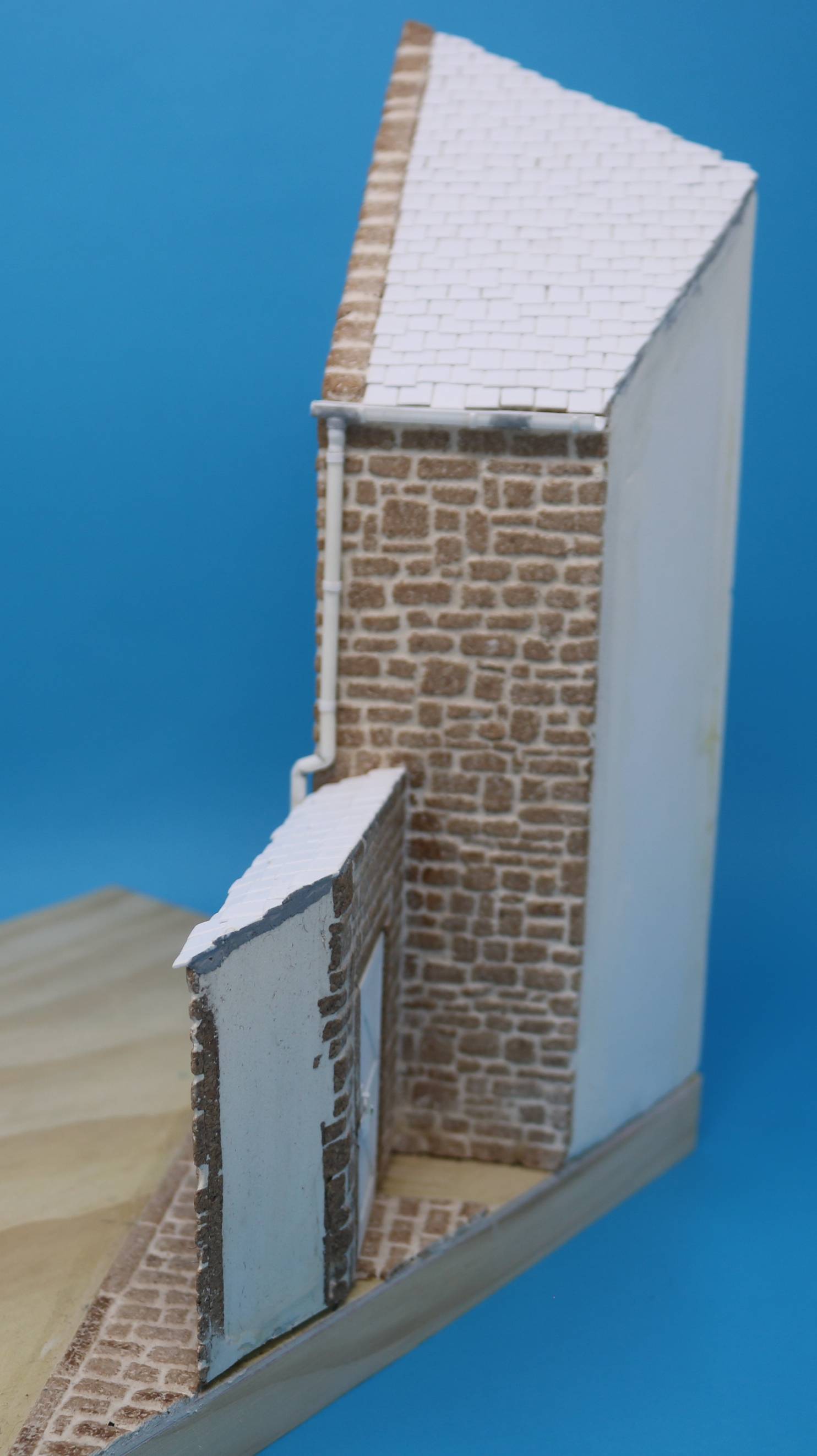

The gutter was made from styrene tube sliced in half. The down spout is solid rod with creative cutting, bending and shaping to follow the wall. Only the top connection to the gutter and bottom spout were drilled out. The roof tiles were cut in various lengths and widths with the edges sanded and shaped from 0.5mm stock secured to the building with CA. The walkway and curb is also cork sheet and spackle mortar.
I applied a coat of artist acrylic clear coat so the cork and spackle don't soak up to much paint. There are a few odds and sods to sort out, but it is getting close to painting all those stones.
