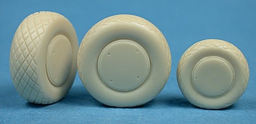

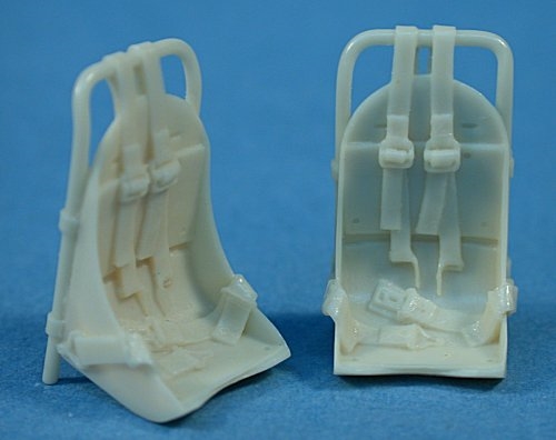

wheels and seat from Ultracast
and Master Model brass gun barrels with flash hiders
we were nearing the start line.

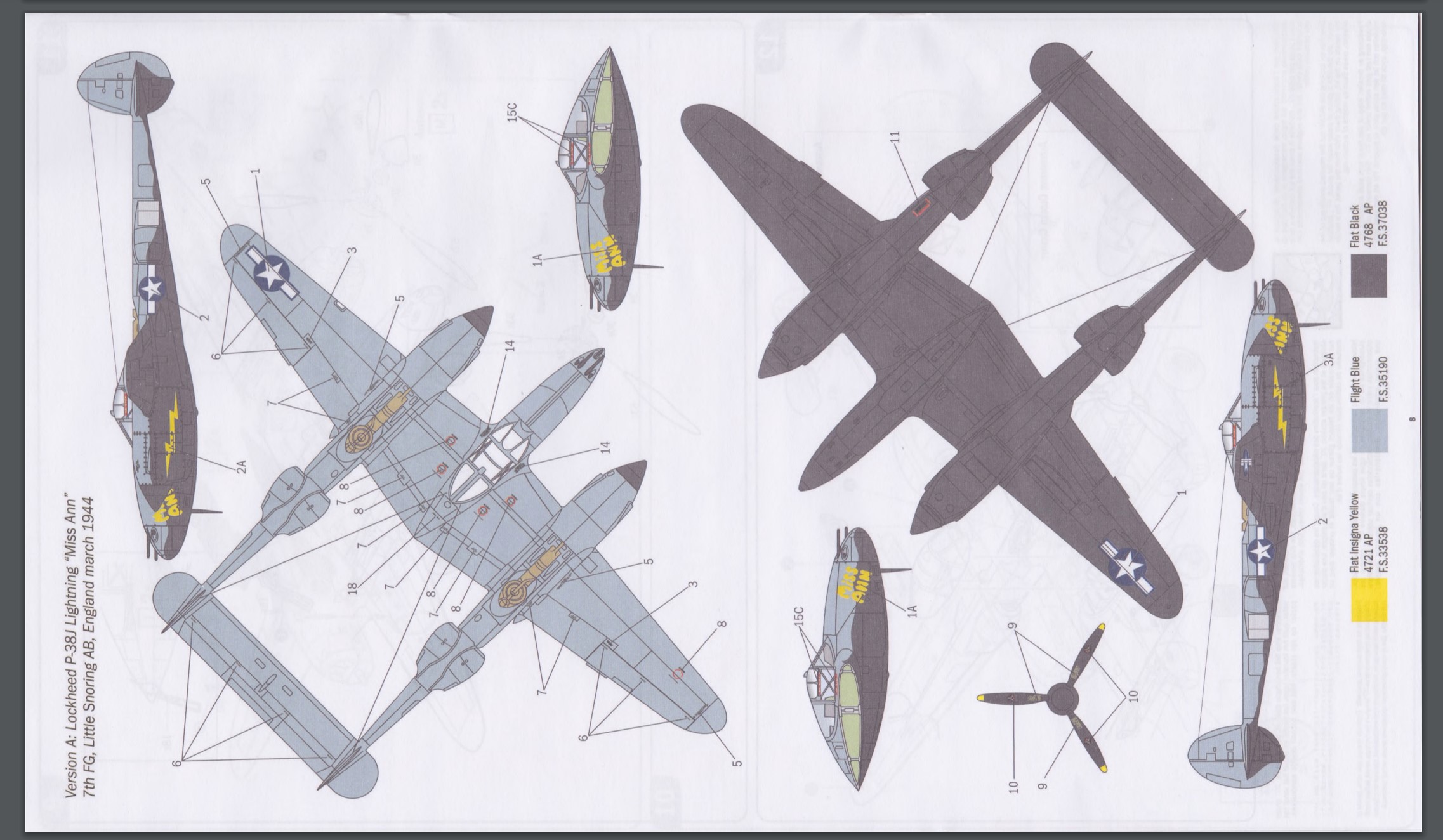

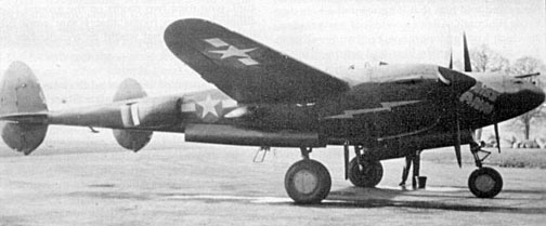

There have been spirited discussions of the actual colours of this aircraft on modeling forums thru the years. From the early insistence of Olive Drab over Black, thru Haze Blue, PRU Blue, Natural Metal or Medium Sea Grey over Black. There are a few pictures of Miss Ann, with all the pitfalls of interpreting B&W pictures.
The upper surface appears much to light for Olive Drab when compared to the Olive Drab/Neutral Gray aircraft in the background in the top picture. Haze paint was more of system than a colour. The early oil based version was difficult and time consuming to apply and maintain and could lead to paint crews being hospitalized due to the fumes and its use largely discontinued by the end of 1942. There was Synthetic Haze paint introduced in 1943 that was much easier to apply. It in turn was being replaced by PRU Blue in 1944. PRU Blue would seem unlikely as 100 Group had no aircraft types that used that colour in their camouflage schemes. PRU Blue also appears quite dark compared to Medium Sea Grey when the two colours were used together on late war Spitfire HF VII's, HF VIII's and PR variants. With no anti-glare panel on the cockpit nacelle, Natural Metal would also seem unlikely. That leaves Medium Sea Grey as the most likely, looking very much like that in period photos of Mosquitos in the Medium Sea Grey/Dark Green scheme.

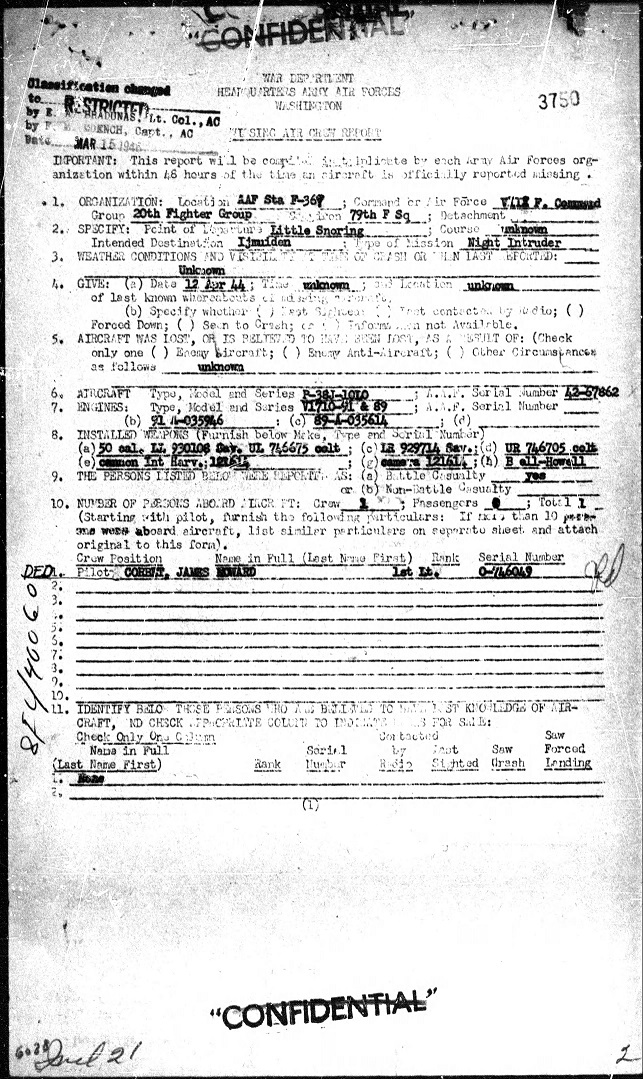

This has led to a belief that the Intruder Trials were led by the 7th PG (R) but this doesn't seem to be the case. Although the detachment recorded no successes during their two month trial, there was a P-38J-10LO lost to unkown cause on 12 Apr 44 and for that there is a MACR. The information provided is limited due to it being a nightime, single ship mission. However, it does provide some useful tidbits, the pilot's name and unit, mission, the aircraft serial number and departure and destination locations. The departure base, mission and date of loss confirm it as a trials aircraft. It also gives the only serial number known for any of the detachment aircraft, but if like Miss Ann, the serial numbers were over painted. (Later forms had an additional line added for "AIRCRAFT NICKNAME" which could have identified which P-38 this was.) Interestingly the parent unit is shown as 20th Fighter Group, 79th Fighter Squadron based at AFF Station F-367 (RAF King's Cliffe). From other AAF records, there was a Thomas L. Gates assigned to the 357th Fighter Group (Yoxford Boys), 362nd Fighter Squadron during this time frame flying the P-51B/C, they could one and the same. The pilots and ground crew seem to have come from VIII Fighter Command squadrons, breaking the link to the 7th PG (R).

So what does all this mean? No plan for a quick build survives first contact of knife to plastic, its your kit and you can build it to make yourself happy and hopefully I will end up with a Medium Sea Grey over Black P-38J named Miss Ann.

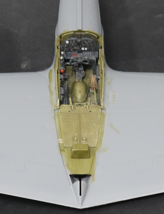

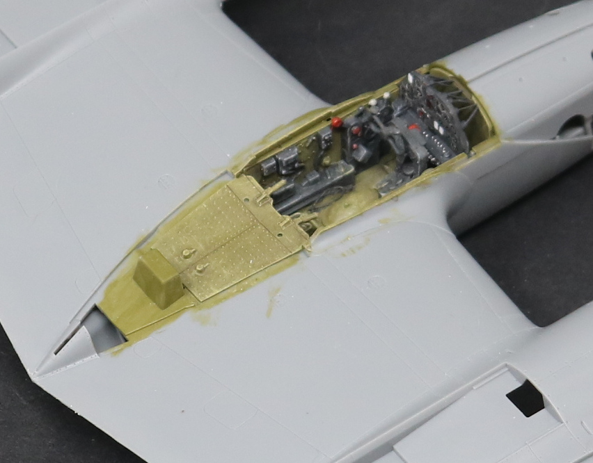

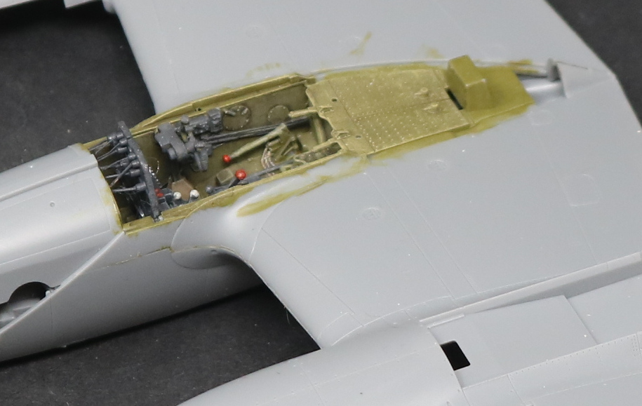

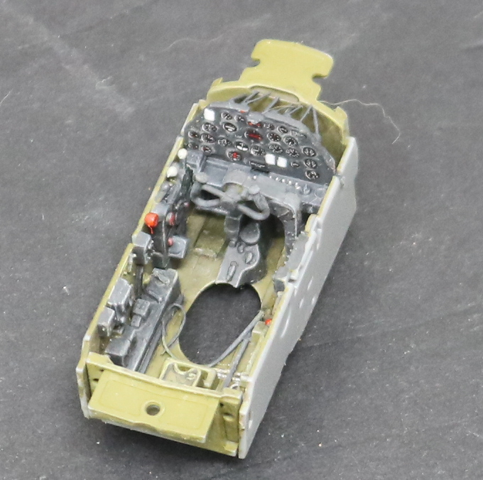

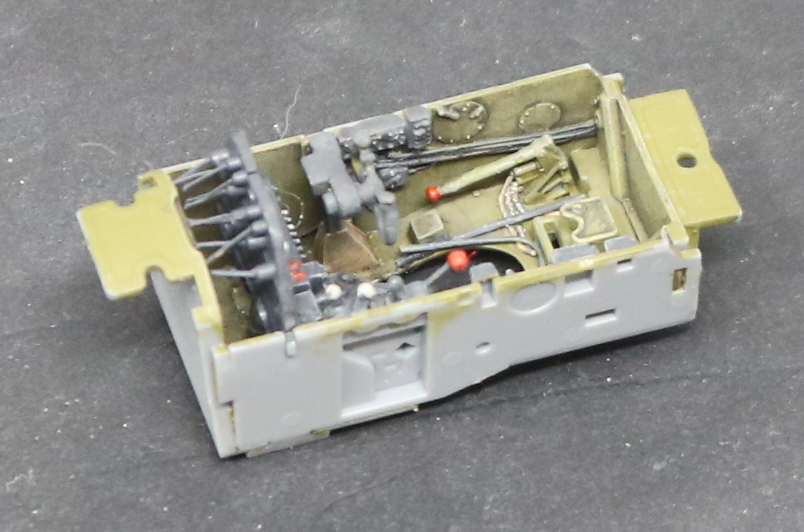

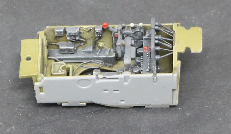

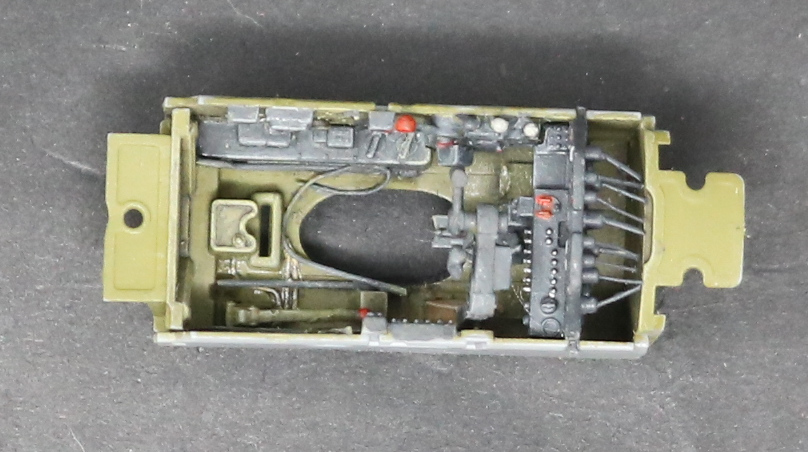

Cutting and gluing began with the kit cockpit. I did add some wiring to the left and right sidewalls and the floor. Painted and assembled it is quite acceptable. The instrument faces are a kit decal. From reading other builds soaking the decal in hot water softens it and allows it to settle down nicely with Micro Sol and Set. A little Future was applied to each face to simulate the glass.The Ultracast seat will need a mod to secure it in the cockpit, but it and the armoured bulkhead don't have to go in now. (Which it turns out is a good thing.) The cockpit tub sits on top of the nose wheel well and the hole in the floor will be filled by the bulge for the nose wheel when it is retracted..
The cockpit tub is then built into wing and cockpit nacelle assembly. And yes, I did remember to place the first of three ballast steel balls in what would be the gun bay.

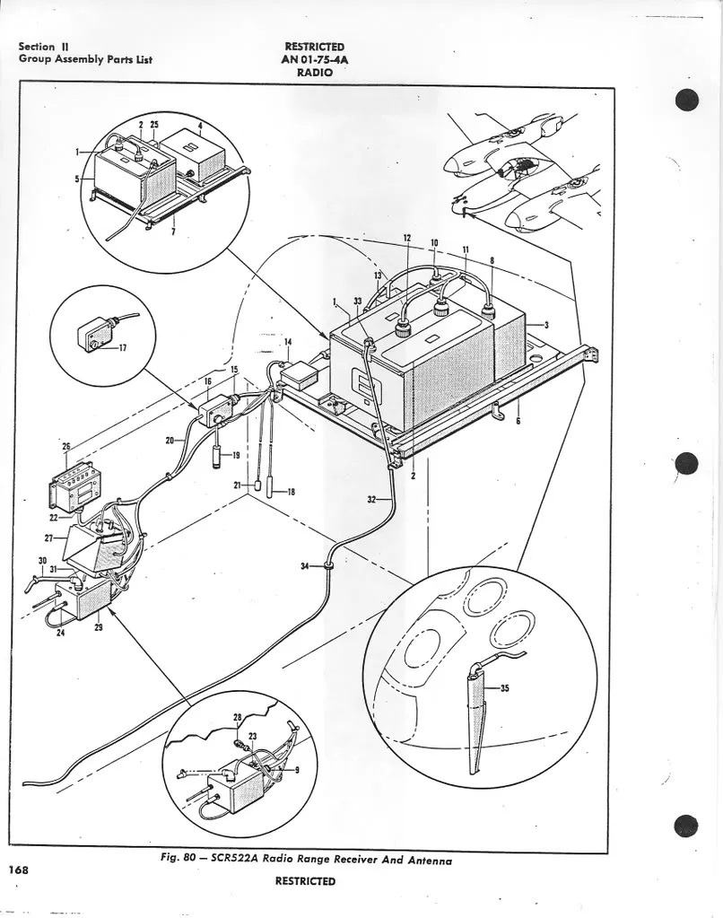

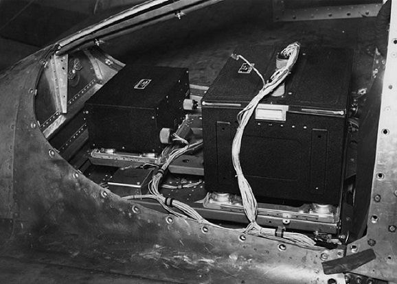

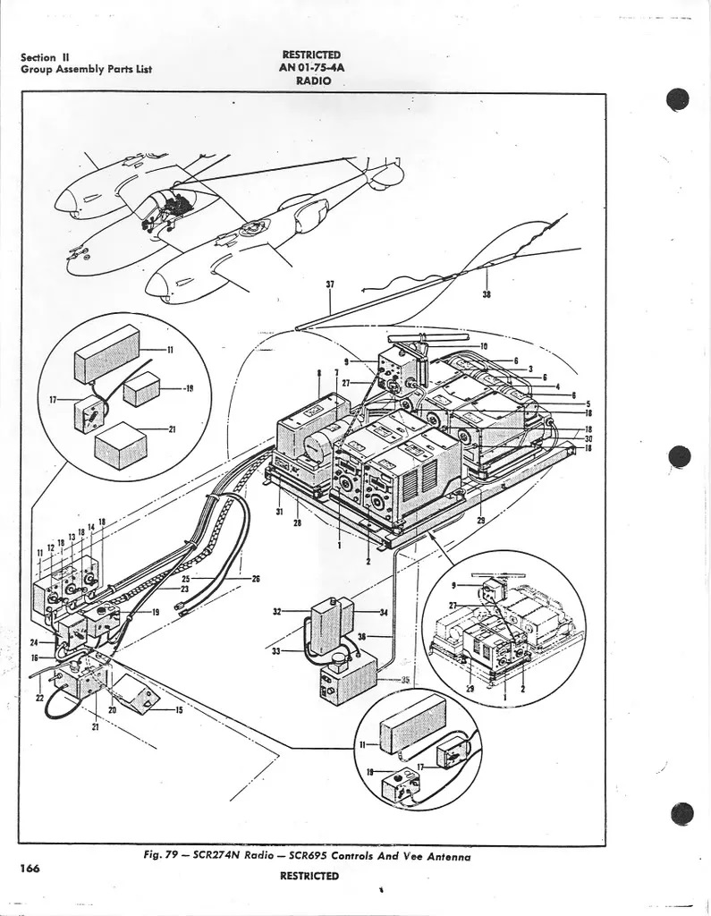

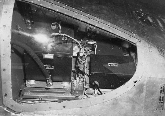

It was while looking a the next steps that I noticed the post antenna was installed and then cut off flush with the fuselage. I seemed to recall that Miss Ann had the post antenna. It turned most of the reference pictures for UK based P-38's had the post antenna. So it was back to the reference books to find out was happening. It turns out that aircraft with the SCR-274 transceiver (as supplied in the kit) did not use the post antenna. It also turns out that only aircraft operating in North American, Australian, South West Pacific and Asian airspace were fitted the the SCR-274. Aircraft operating in the ETO or MTO were equipped with the SCR-522 transceiver (US verion of the British 1134) and used the post antenna. The bad news, the SCR-522 is not included in the kit. The SCR-522 installation also requires a revised right hand side wall with some additional boxes and wiring. This explains why there are no ETO or MTO markings included in the current P-38 F/G, H and J releases. The inclusion of the post antenna could foreshadow future ETO and MTO releases with the modified cockpit parts.
After cursing Mr Tamiya and his relatives past, present and future, I felt much better and sorted out how to fix this situation. The Eduard cockpit set includes the SCR-522 installation and modified side wall and an order was placed. Of course, I diligently glued the wing seams together so I am not going to get them apart without serious damage Once the cockpit arrives it looks like I will have to do some surgery to remove the boxes and added wiring on the right side wall aft of the control yoke in situ. I should be able to sand the thickness of the side wall off the Eduard part to remove the required boxes and wiring and then wigge them into place. A lick of paint and no one should know the difference. Time will tell.

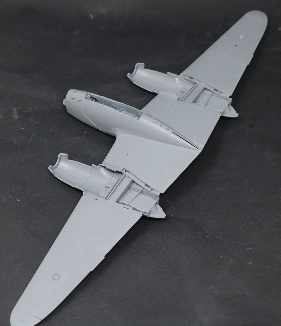

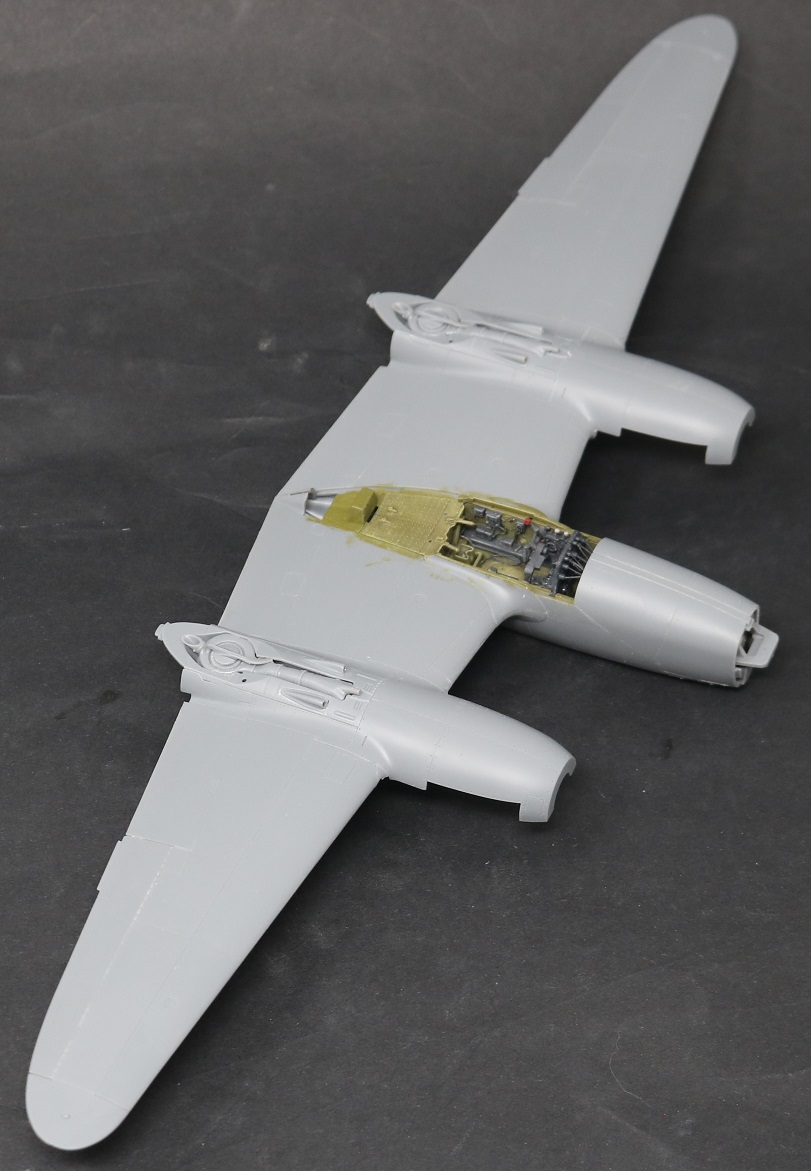

In the meantime, I finished the assembly of the wings and cockpit nacelle. The inboard lower wing panels required the appropriate holes drilled out to fit the pylons. The next steps are assembling the right and left booms in turn. That should keep me busy until my order arrives.

I've read somewhere that the wire antenna was not used on ETO fighters, this seems to confirm that correct?
