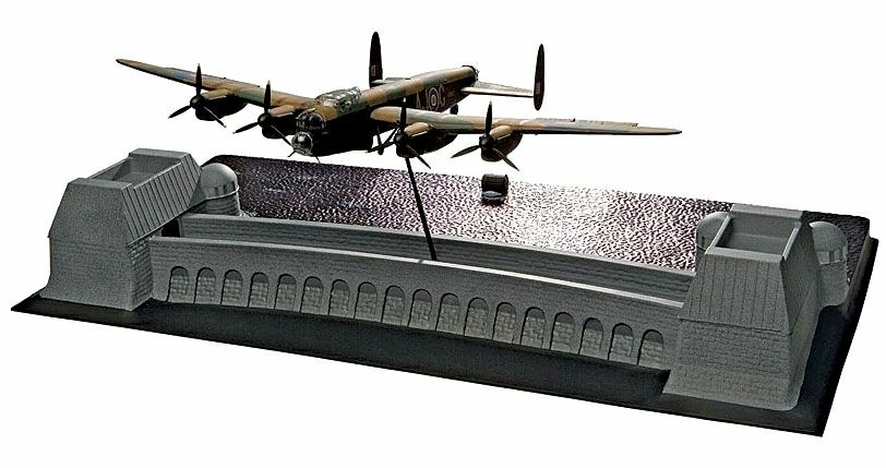

They give you a vac formed dam, there are two towers that go on each side, the dam is a bit flimsy so it will be going into this board which will protect the dam and give a sturdy base for the aircraft stand as i skims over the dam wall.

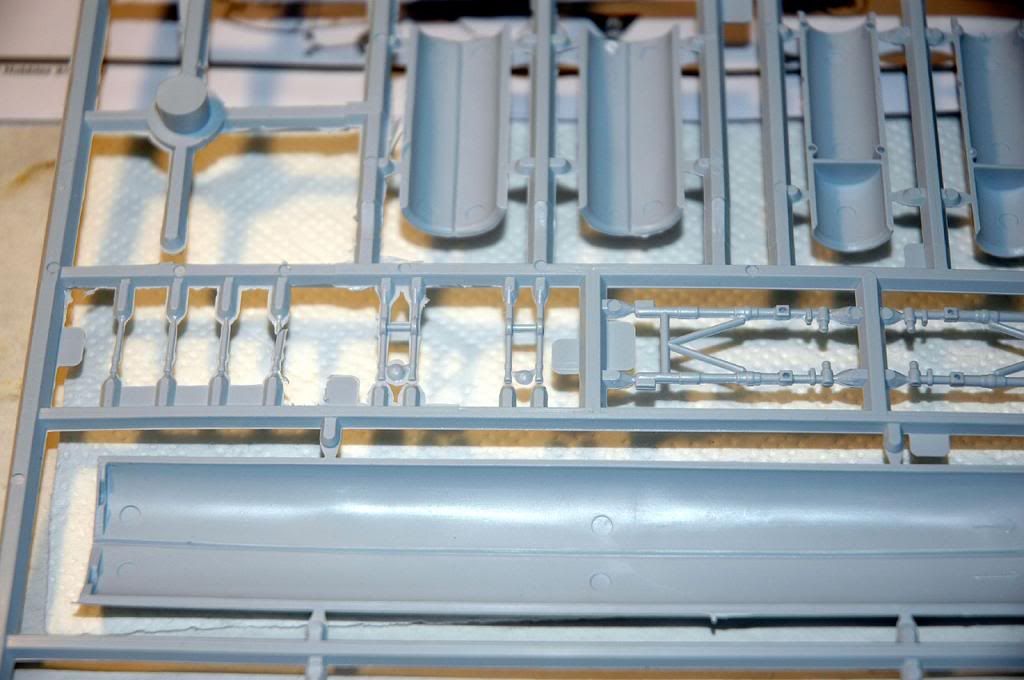

This is an old mold kit, there is so much clean up work to do, you can see from this pic on the MG's

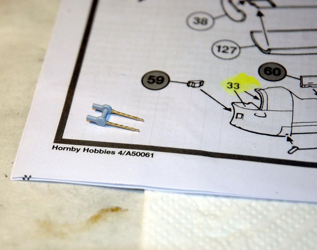

Master Model brass barrels test fitted -

The Hasegawa version Pe set fits perfect in the kit, the Pe looked a bit ''flat'' so I stuck the Pe onto plastic card to give it a 3D type of look, which looks much better in my opinion

Thanks MP - it's kicking my butt though!! will get it tamed though!! not much else to show atm just MASS clean up of every part :gogo I don't know what Airfix did to these molds but they sure needed cleaning or replacing!!

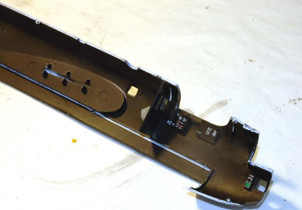

It's plain Jane inside,
i just added a bit of plastic card stock for a bit of a bulkhead look, same with the rear gunner position,
otherwise you see one continuous ''nothing in there''.

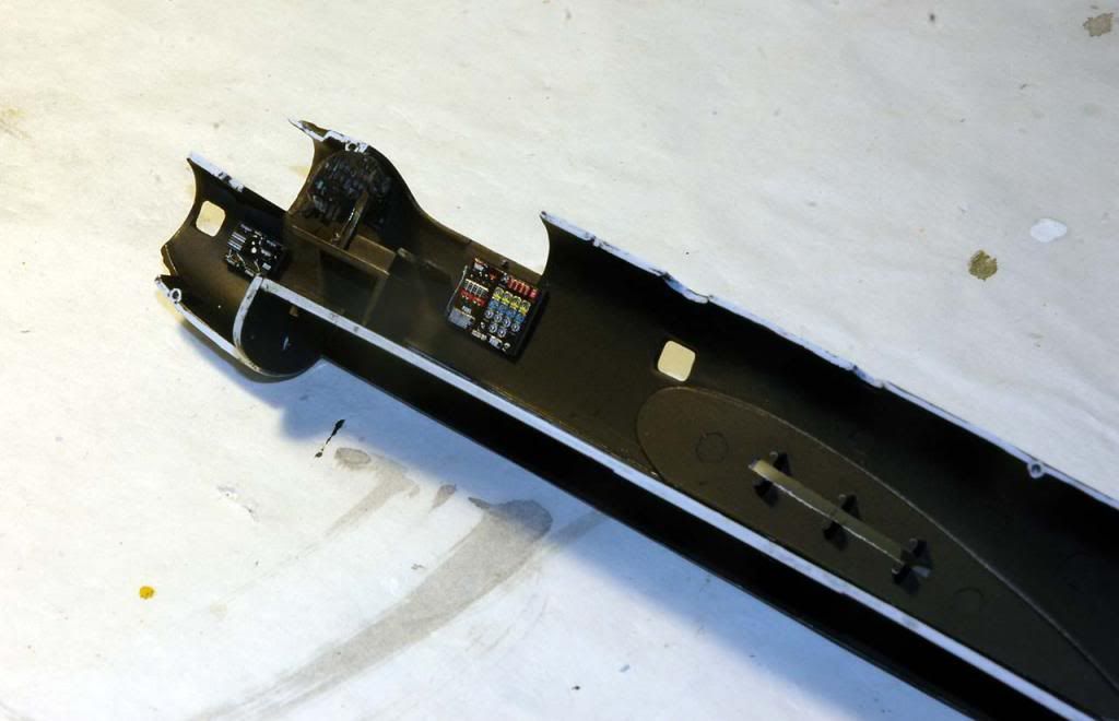

Pe fitted now on plastic card pieces instead if just a dead flat look on the fuse sides.

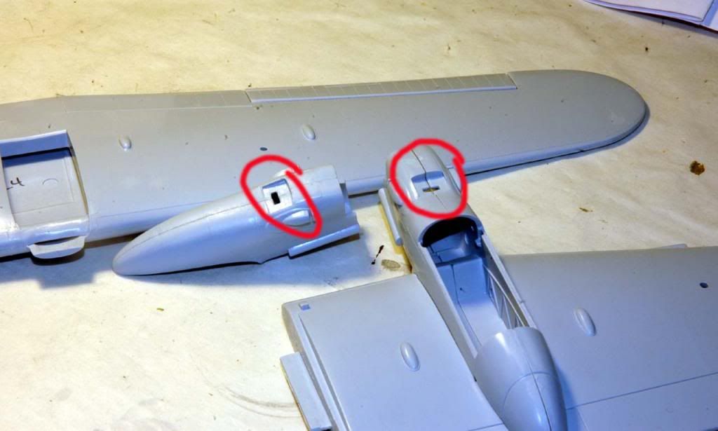

Another bit of a worry is this here
DSC_0474I.jpg~original
There are no parts that fit in there in the kit
notice the Tamiya 48th instruction sheet view of the same area.
http://www.1999.co.jp/eng/image/10176186z4/70/4
I just filled those square holes in with some evergreen card stock - Rad shutters closed - in flight, not worrying about the slots in them

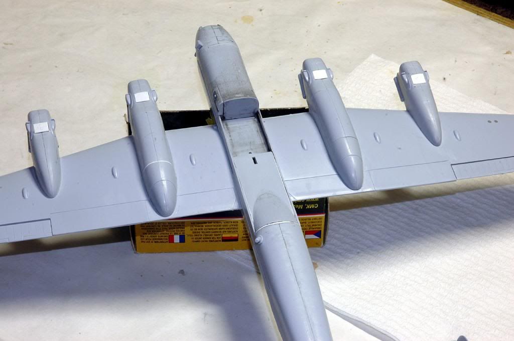

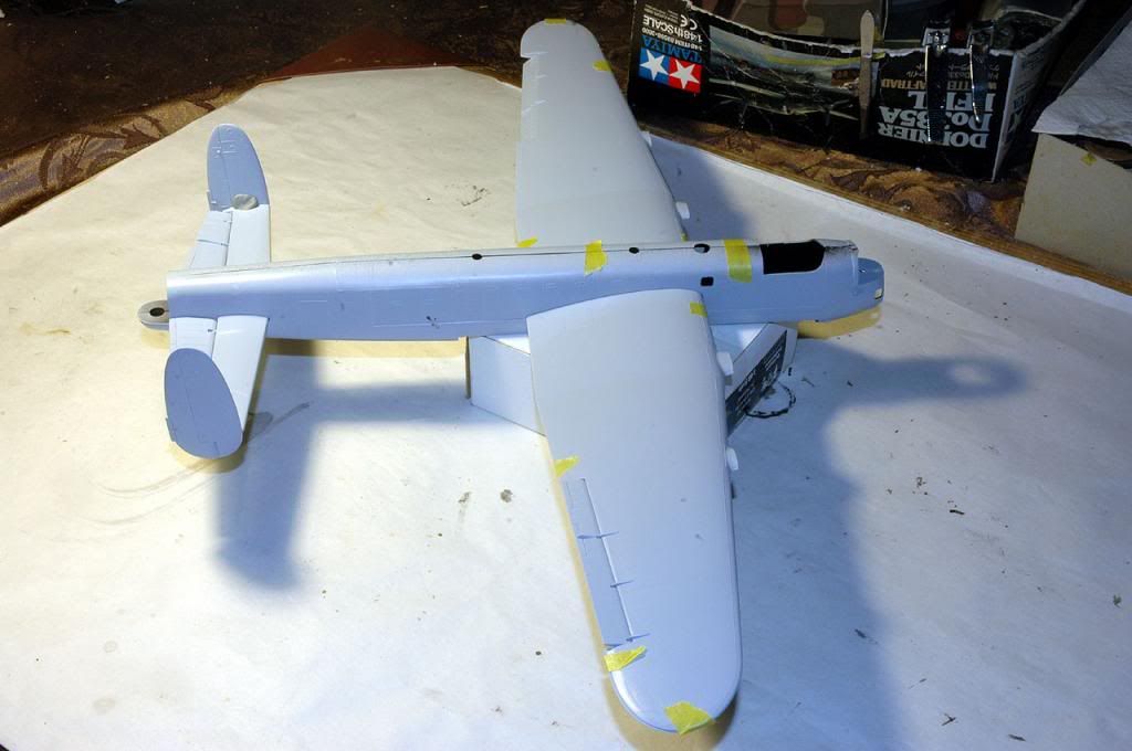

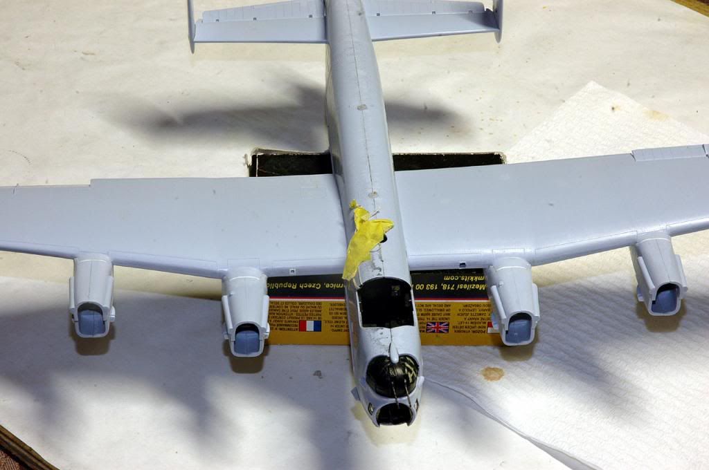

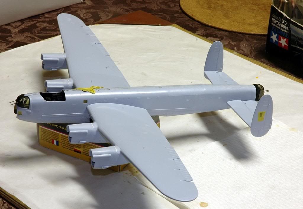

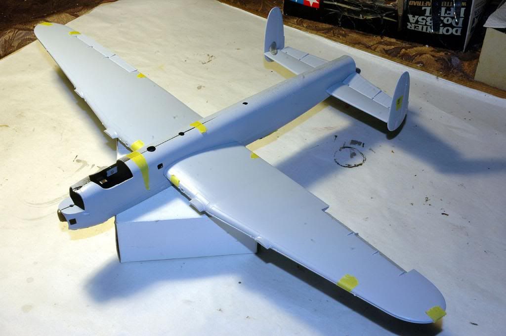

New Year resumed the Lanc, wings tail etc on, ready to close up and get the base silver on, lots of evergreen strips used to close up horrid gaps - just look for the white!!!
At least the wing root joins are very nice.
DSC_1027c.jpg~original
DSC_1028c.jpg~original
I just made basic rear facing scoops in the closed position to cover those awful square holes, I doubt anyone will notice when all black and on the stand
