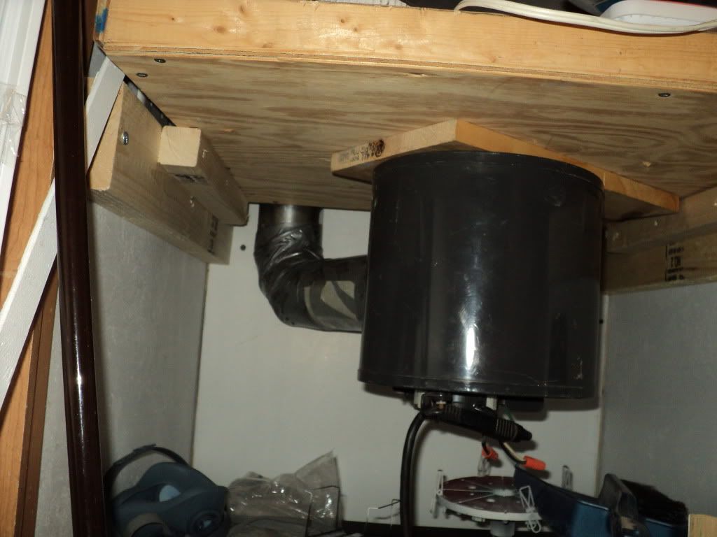

For a blower, I'm using a squirrel fan that moves ~495cfm. Its a downdraft booth, which I've found seems to work about the best. The other good option would be a cross draft booth w/ the blower mounted on the back. I ran it as an updraft booth for awhile, when I first built it, but I had issues w/ the paint residue on the air filter falling off onto the models sitting in the booth.

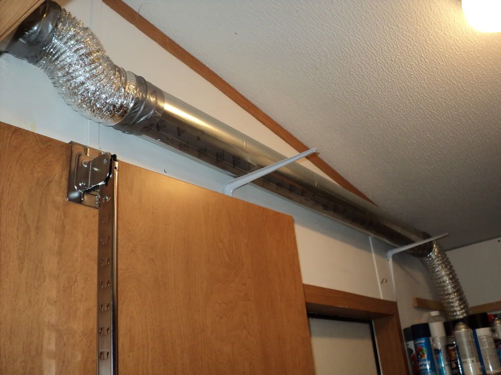

Just recently the booth was installed into the opening its in now, and a permanent exterior vent was installed. I'm using 4" dry ducting to vent the booth.
