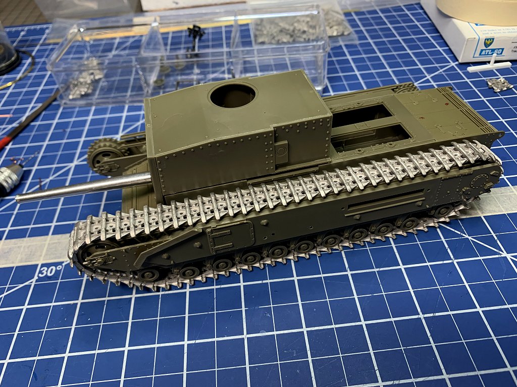

Getting ready to start working this track set. I understand the basics but I'm interested in hearing what you all do with them.
Like do you blacken them or just paint them, assemble them first then blacken/paint or leave them seperate, use the wire in the kit or use something better??
I'd like to hear ya'lls advice and suggestions.
:victory:
I chase all the holes with the appropriate drill bit, assemble, then blacken. I like to use .020" brass wire instead of the supplied wire, I think it's easier to use and will blacken along with the tracks. If you use CA on the ends of the pins, you'll have to touch up the shiny spots. Good luck!

I generally get the .5 rod instead of that wire, assemble then blacken it. I probably do it wrong anyway.

I generally make a cutting jig for the supplied wire using a plastic tube and a plastic block glued to one end. The tube is usually slightly shorter then the length pin I need for the tracks because my wire cutters are not flush cut. It takes a few tries to get the tube length correct. Once the jig is sorted, I slide the end of the wire in and snip off the length, repeating for the couple hundred pieces I need. Once all the pins are cut, I start assembling the tracks in groups of ten links. The smaller 10 link runs are a little easier to manipulate then the 90+ link full run. After that I assemble the groups. I usually use a set of small needle nose pliers to insert the pins. This comes from having with way to many tiny holes in my finger tip! This jig would work with brass rod as well.

Thanks Mike!! That jig is great so I made one up and it works beautifully. Had a slight FUBAR with my first run of 10 links. I’ll post more on that later.
