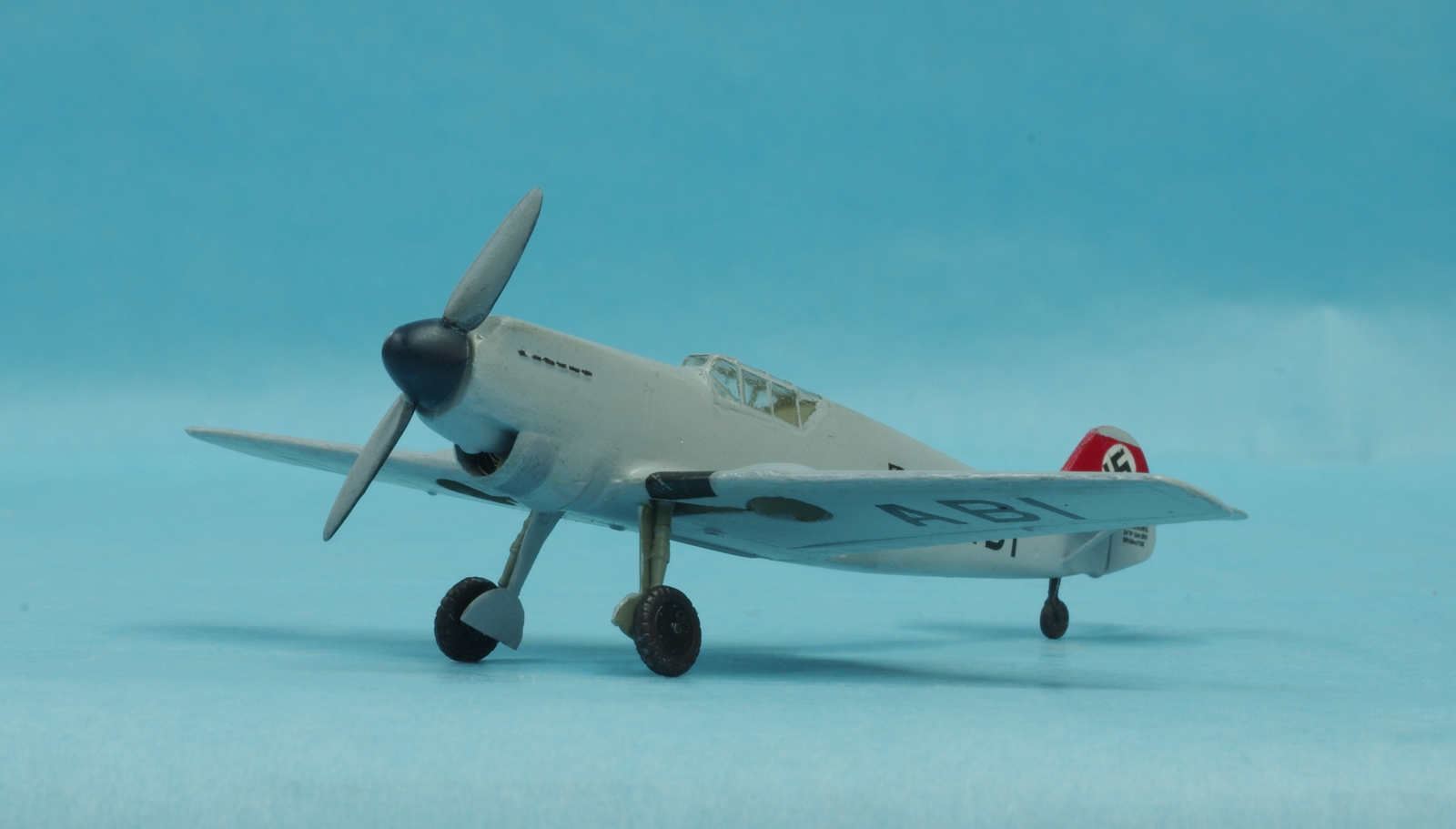

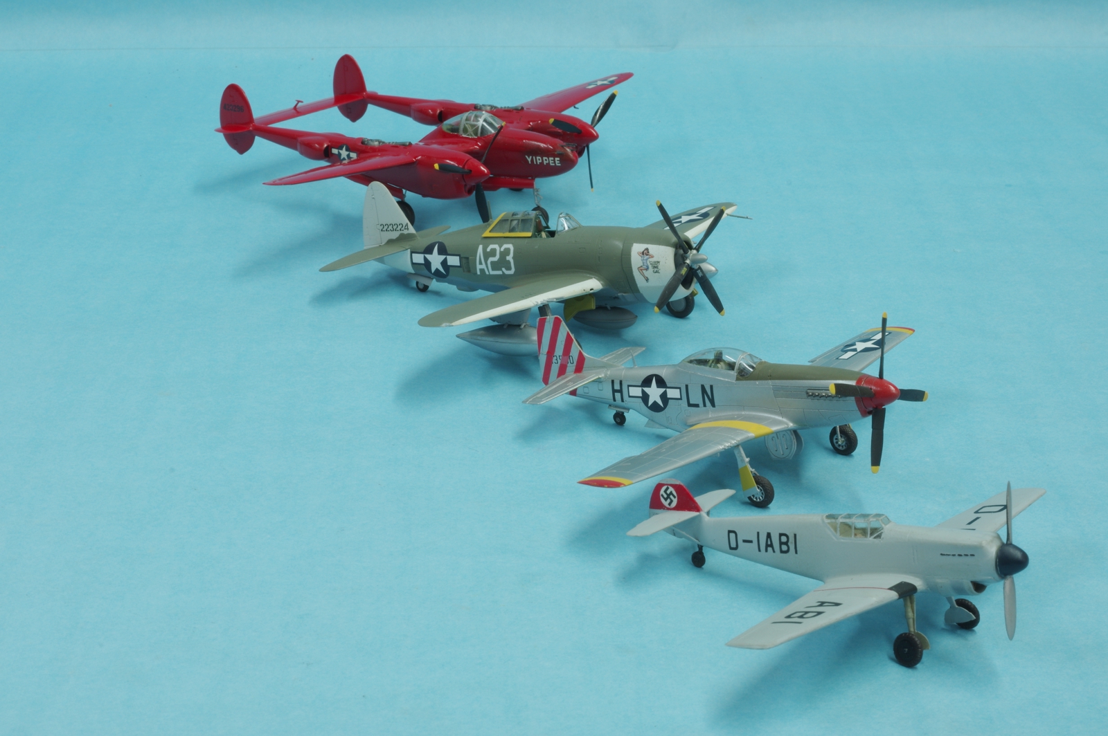

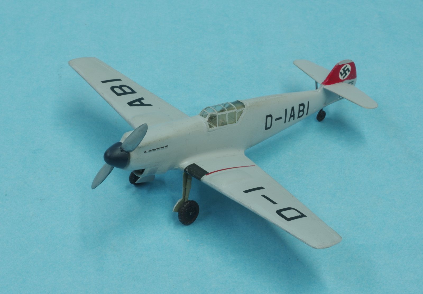

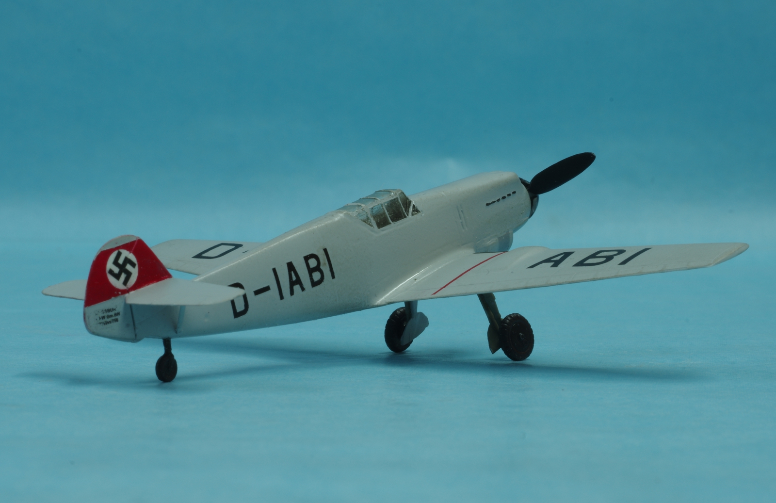

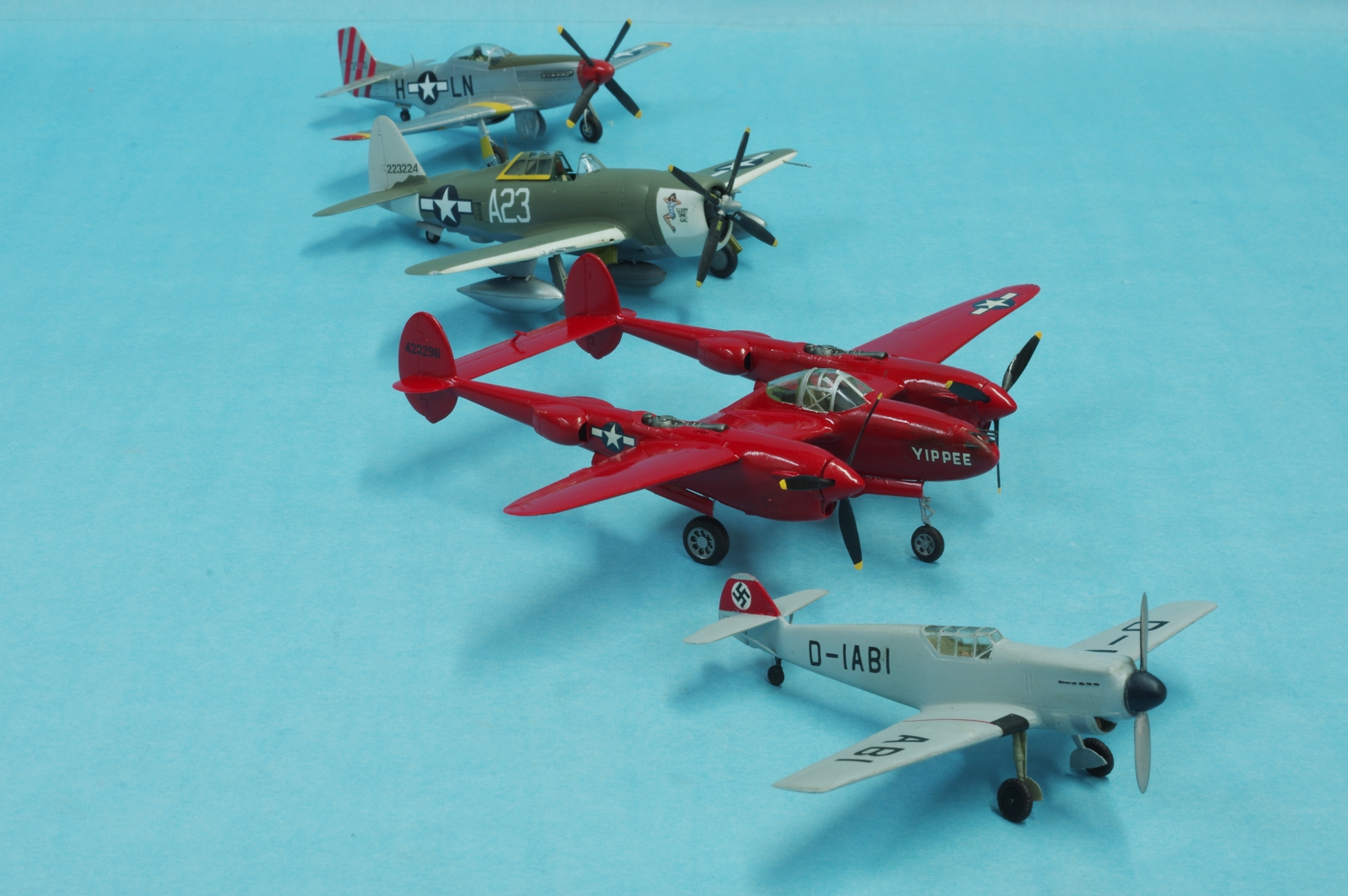

Here's one that just got to the shelf, and some pictures of it with a few of its adversaries. It wasn't too hard to get together, though I left off a few of the tiny PE parts like the aileron counterweights and the gear scissors, too small and fragile for me. Aizu .7 mm tape painted buff for the seat belts. There are build pictures on my website: http://goldeneramodel.com/mymodels/me109/4me109/4me109.html
Model Master RLM 63 overall, with Tamiya acrylics for the other colors. Decals were laser printed for the a/c info on the rudder, the swastika, and the black areas at the wing roots, I have no idea what they might be. Other markings are masked and painted. While the kit supplied decals, they were by Propagteam and I've never had much luck with that brand. I found with the fuselage markings that spraying a black field, applying the masks, and then overcoating with RLM 63 worked better than trying to do it the other way. Masks were made for the canopy, which I think is hindered by overly pronounced framing. In this scale no framing might be better, just paint. The pictures I've found of very early 109's have very thin framing members. Hard for me to do with paint in 1/72, decal stripes might be best.
That looks neat. Nice build and love the collection. Shows the size differences perfectly.

Thanks, Mo and Warren. Yes, small can be good. So far as 350, mph, though, if it's a guy like Eric Hartmann on your tail relative speed is not a factor!
