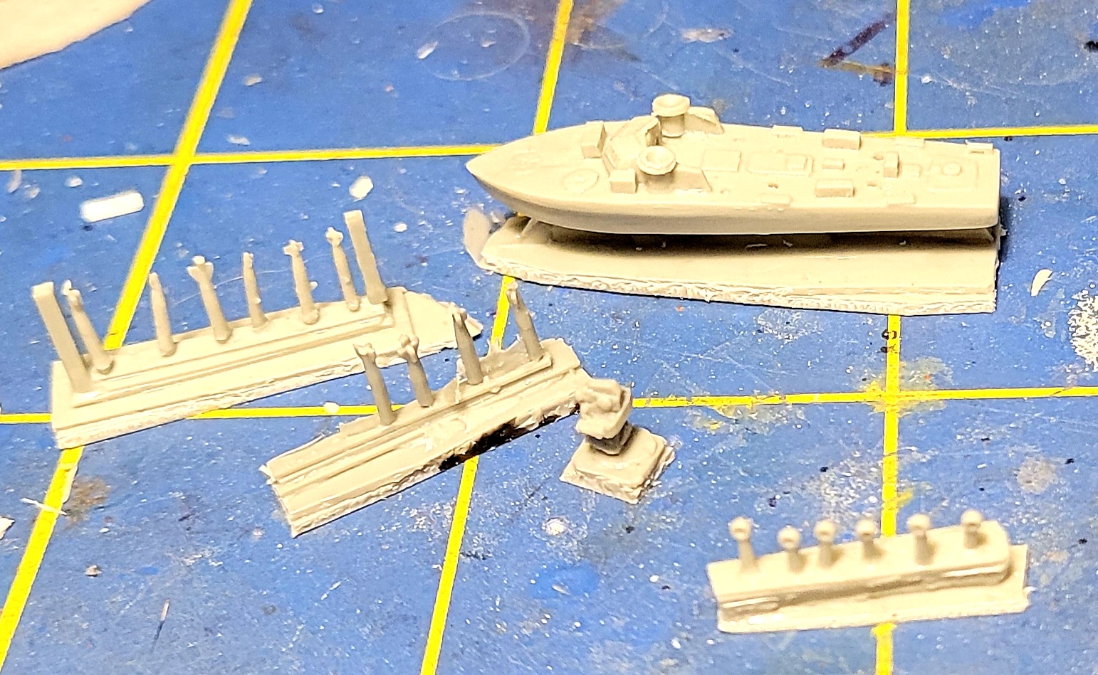

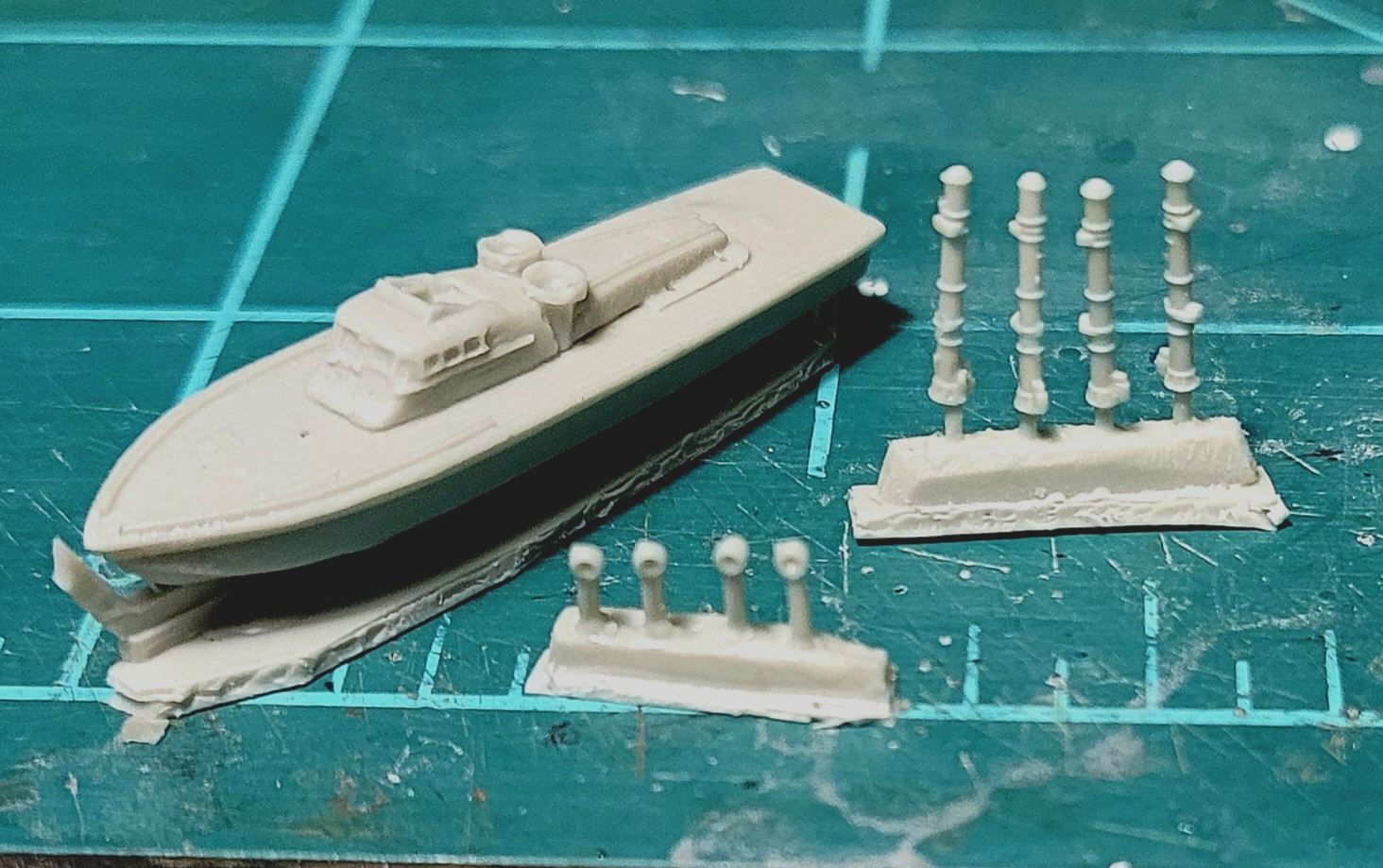

I decided to build a 77-footer. Drilling the deck ventilators requires a #70 bit so the resin parts will fit. They aren't easy to hang on to, but patience will yield satisfying results.

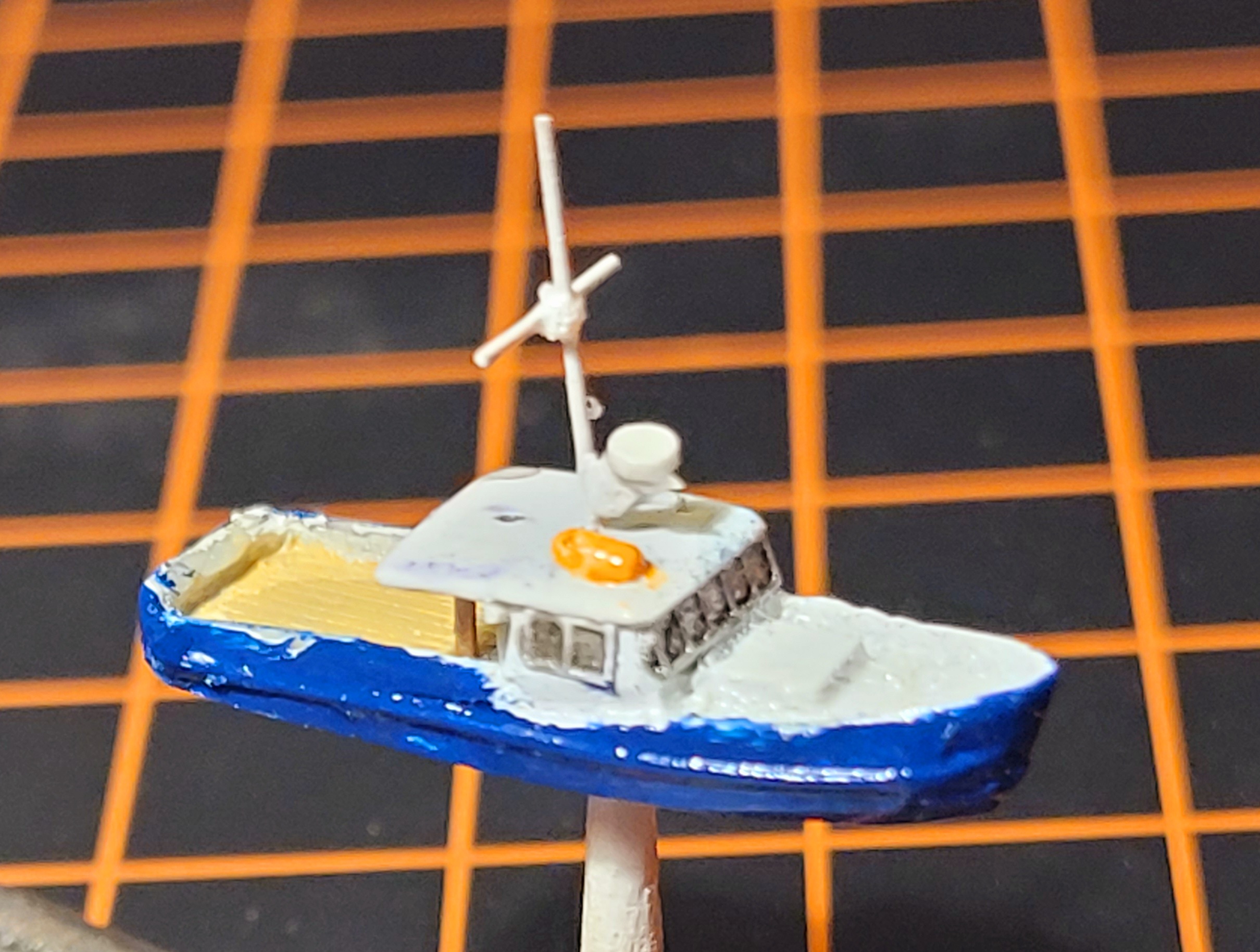

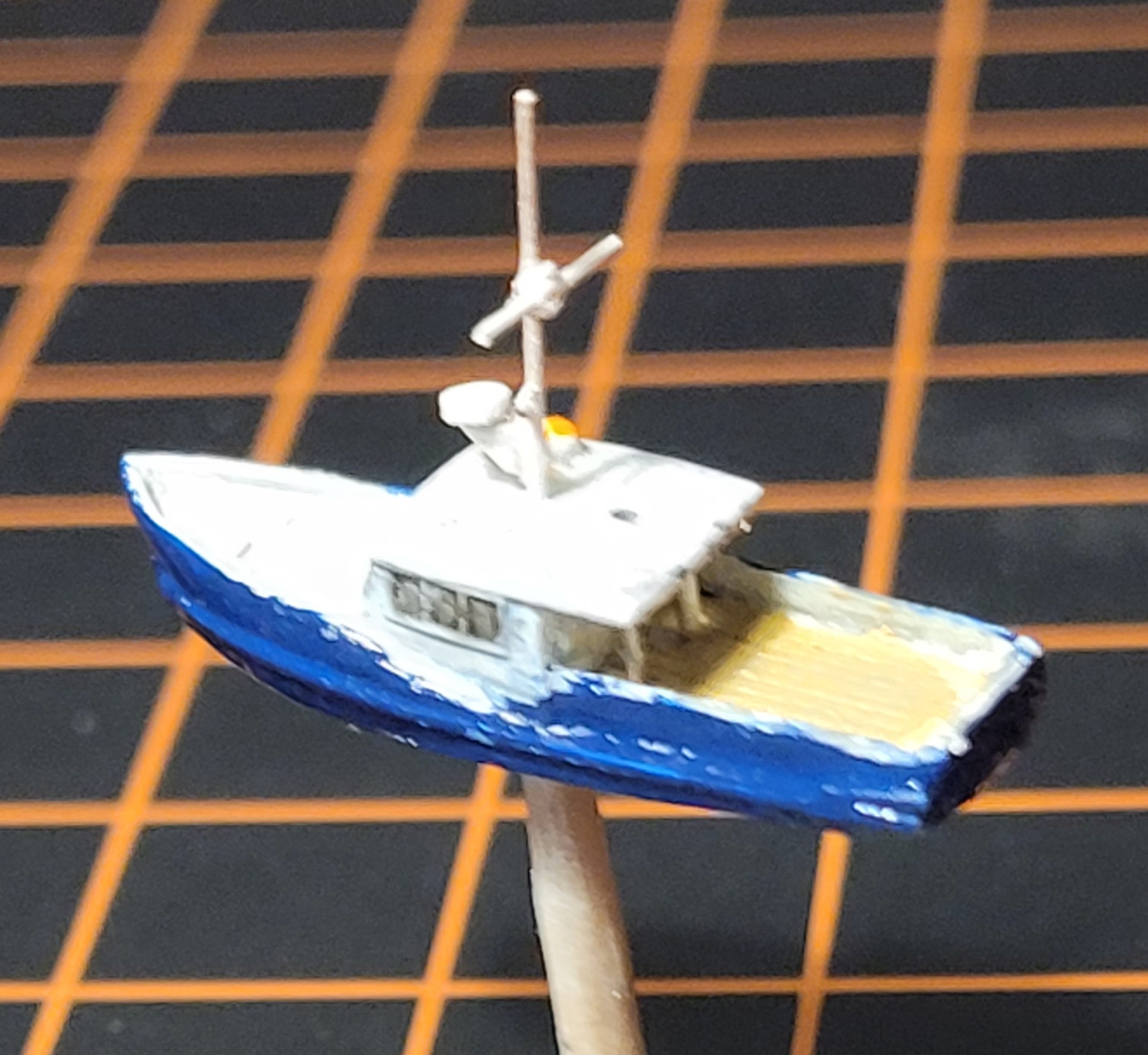

The Gloucester Lobster boat called to me as well. This nav. radar dish is too big. :bm:

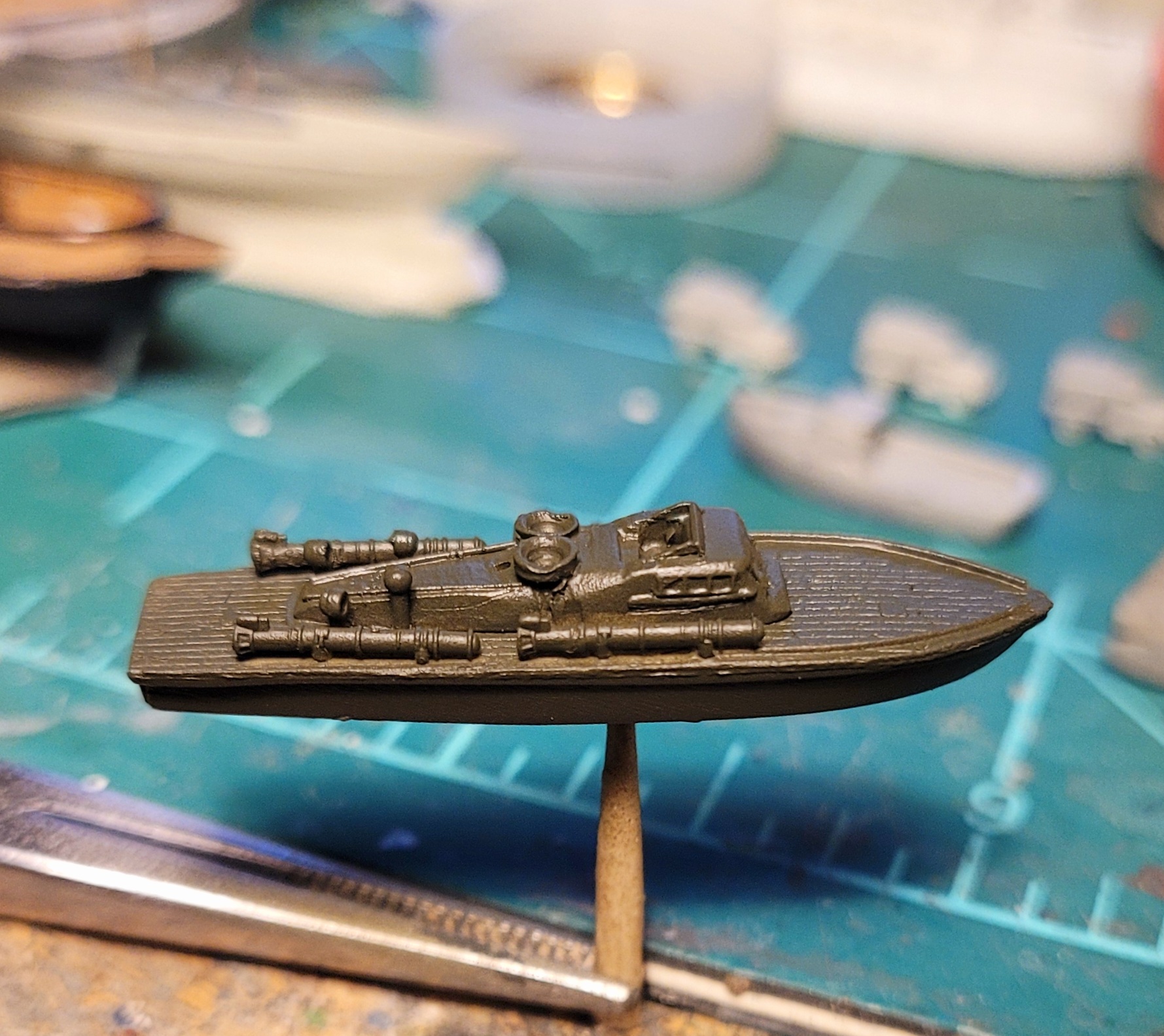

Resin parts of the 77-footer in place. I hope a white topcoat will lighten the 1941 combat OD on the horizontal surfaces.
TIP: 1/700 Ventilators are a might fiddley to install. Use Paul's tweezer tune-up before you attempt. These took flight without provocation and make no sound when they land. One of the torpedo tubes did the same thing, but most of the vents were found during the unsuccessful hunt for the errant torpedo tube. :bang head
Such is Life in a dinky scale PT world.

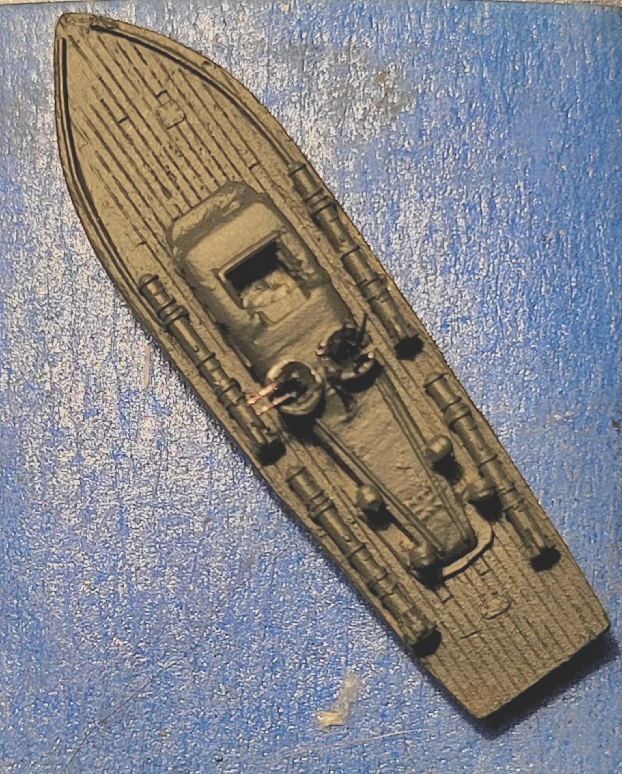

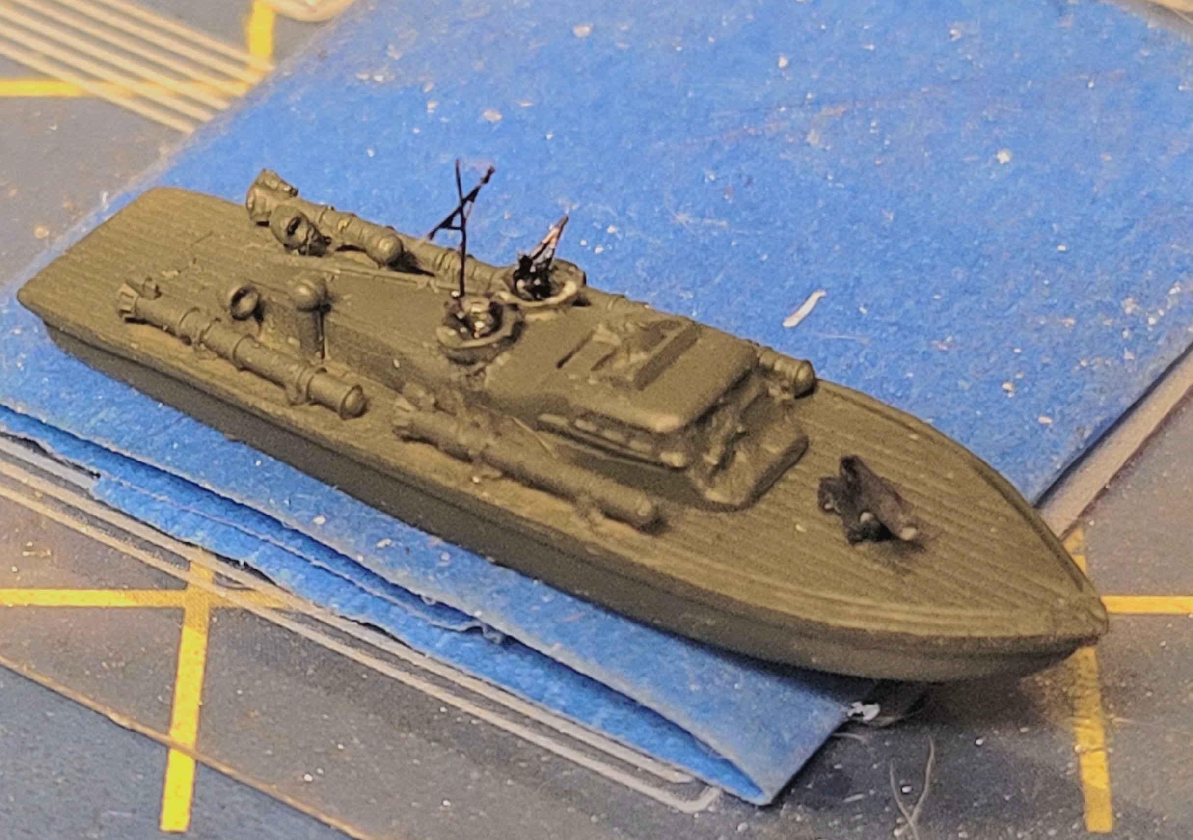

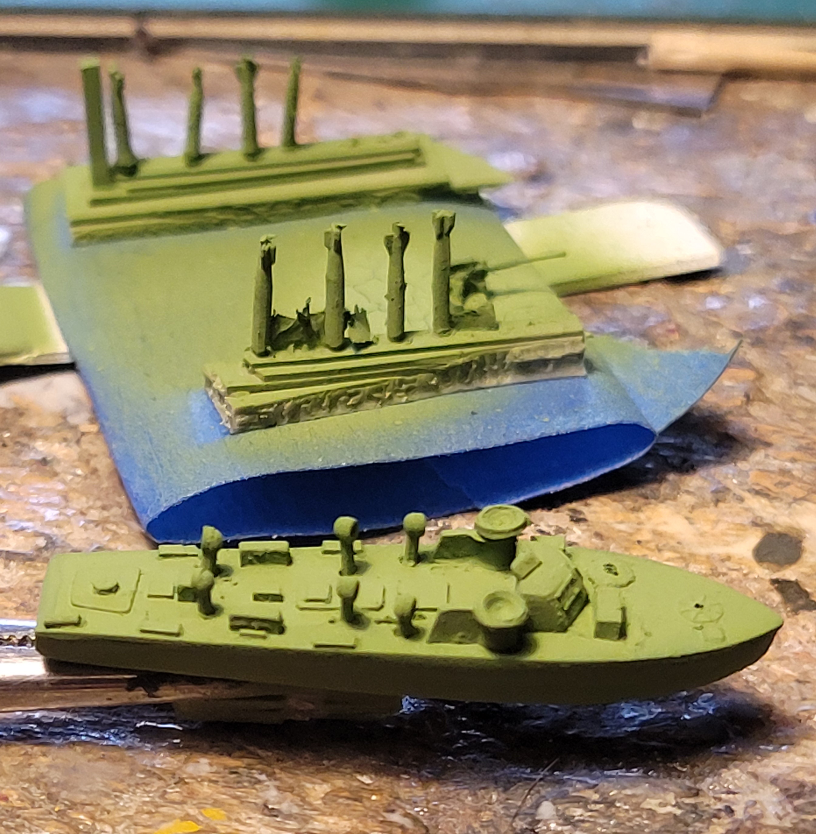

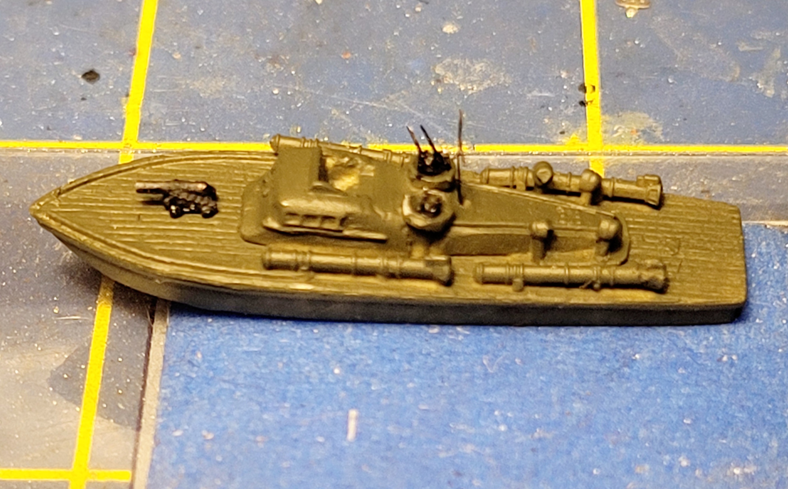

The first paint is truly the "Proof in the Pudding" for mold, master and casting. I am well pleased with how this process turned out. A little (?!?) dry-brushing a lighter green on the horizontal surfaces should finish the finish. :silly:
PEE twin .50's and mast. Clear flat after that. No, really! Watch and see!

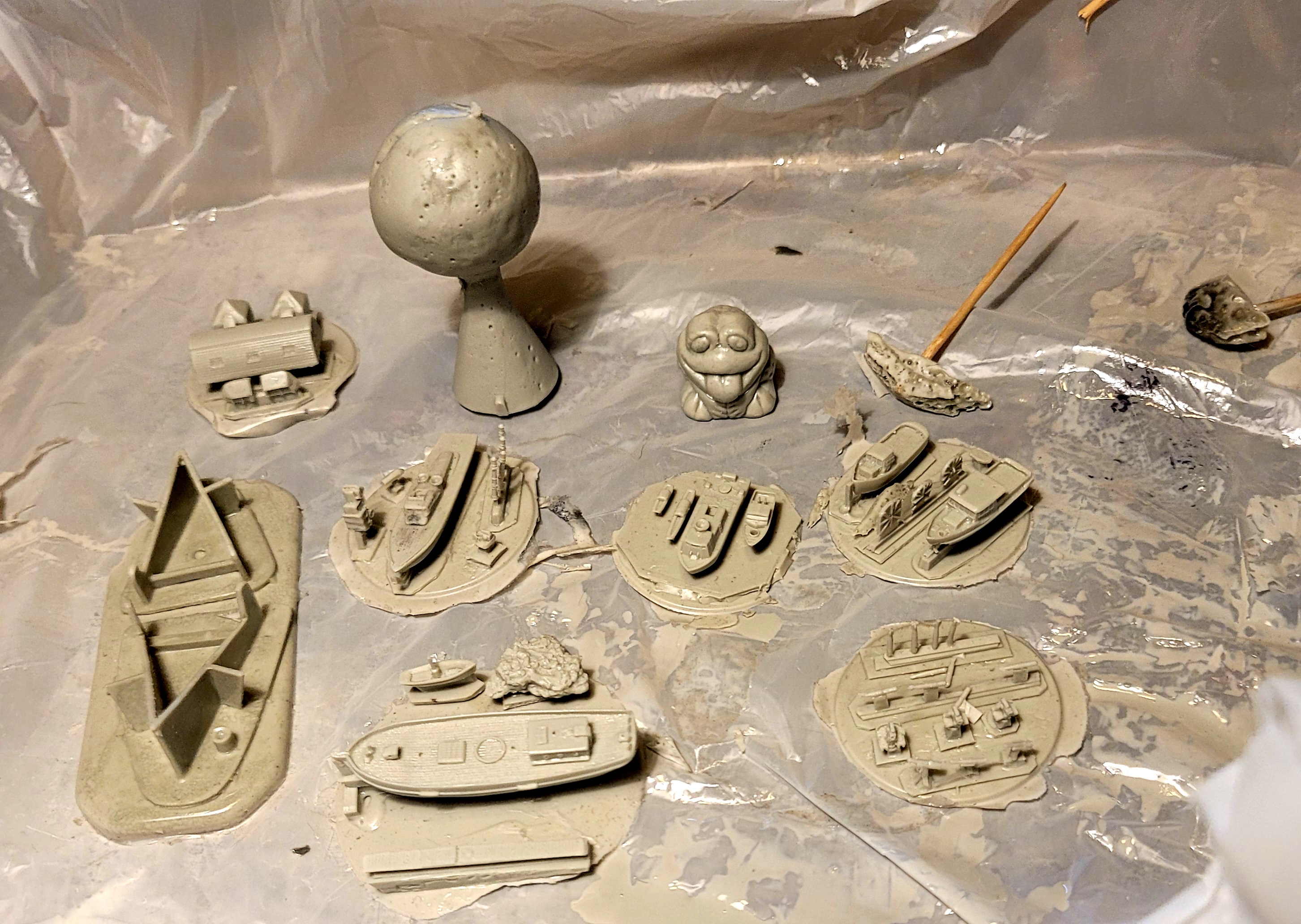

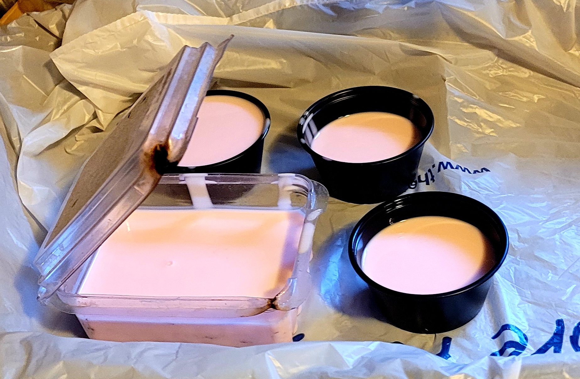

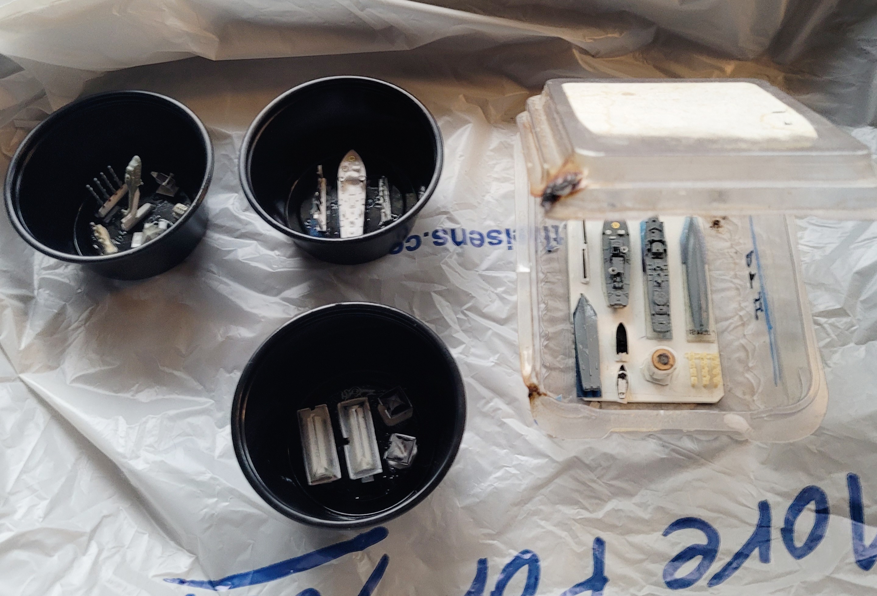

Molds poured for PT weps, generator trailer, SA-332, improved Loose Cannon Higgin's 78" PT, The rest of the boats in the PT Set and tents for the Pacific PT base. These are under pressure until tomorrow morning at this writing.
I have a well worn copy of the book by "The Wildman of the Pacific". I like turning pages. Books work when the power is out.

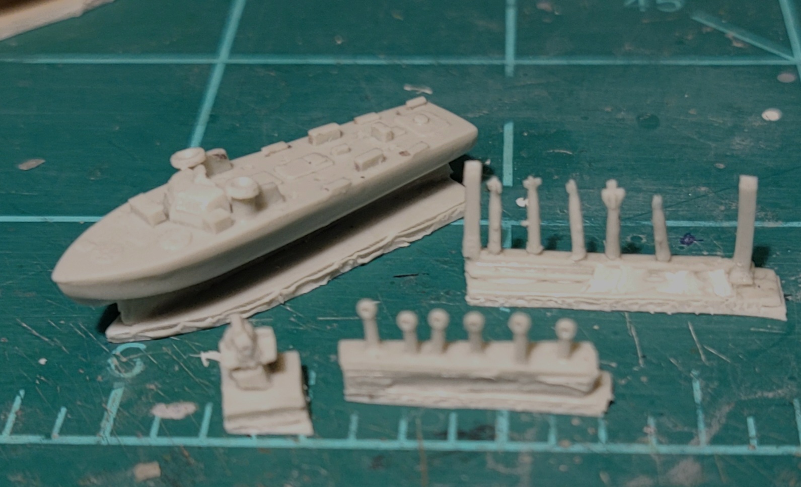

I cast the new molds tonight. In truth 40ml of resin cast 10 of my teensy molds. 1:20 to demold.
The complex PT mold does it's job nicely. Meticulous "tooling" is required to make sure all the tiny air bubbles get relieved from every cavity.

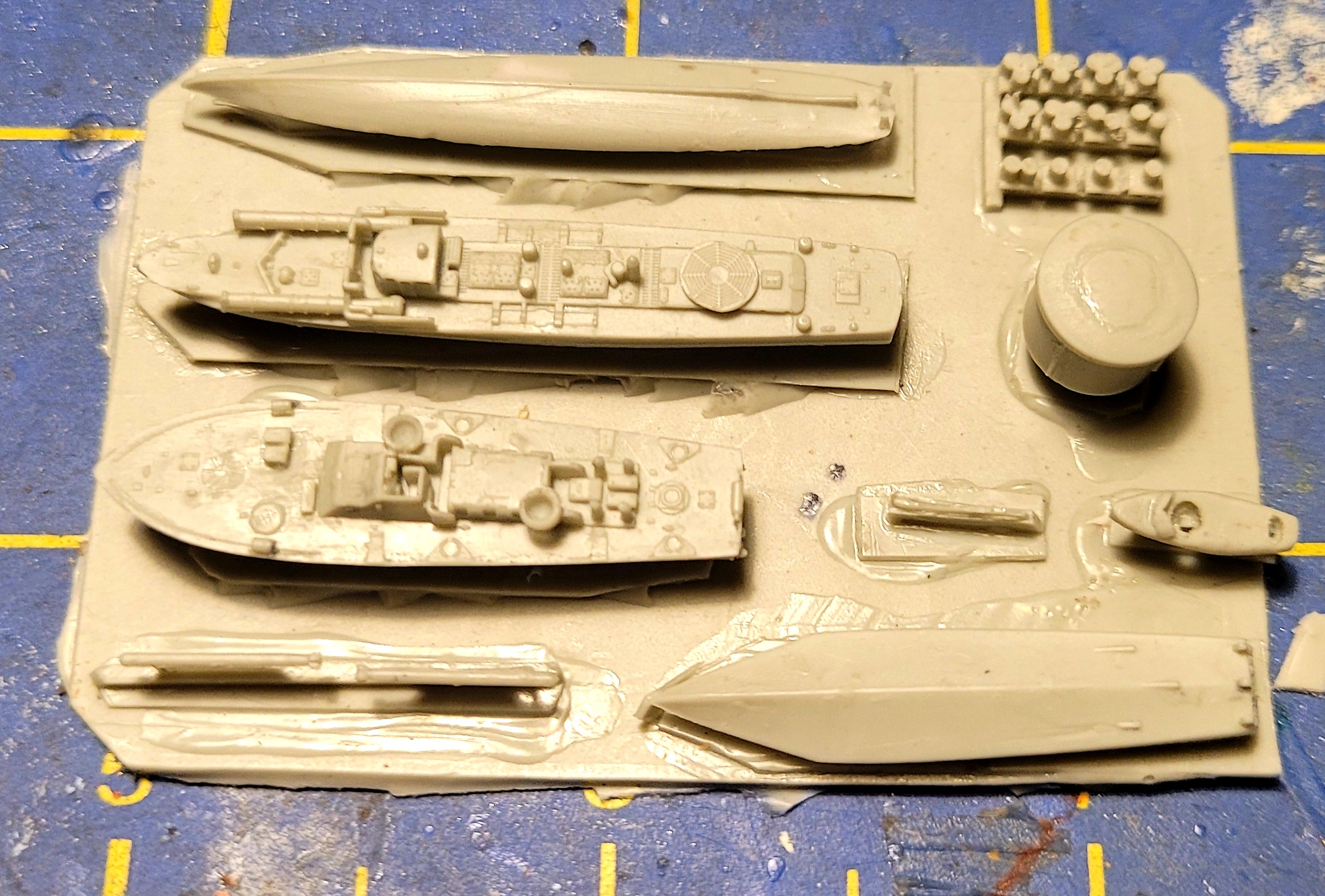

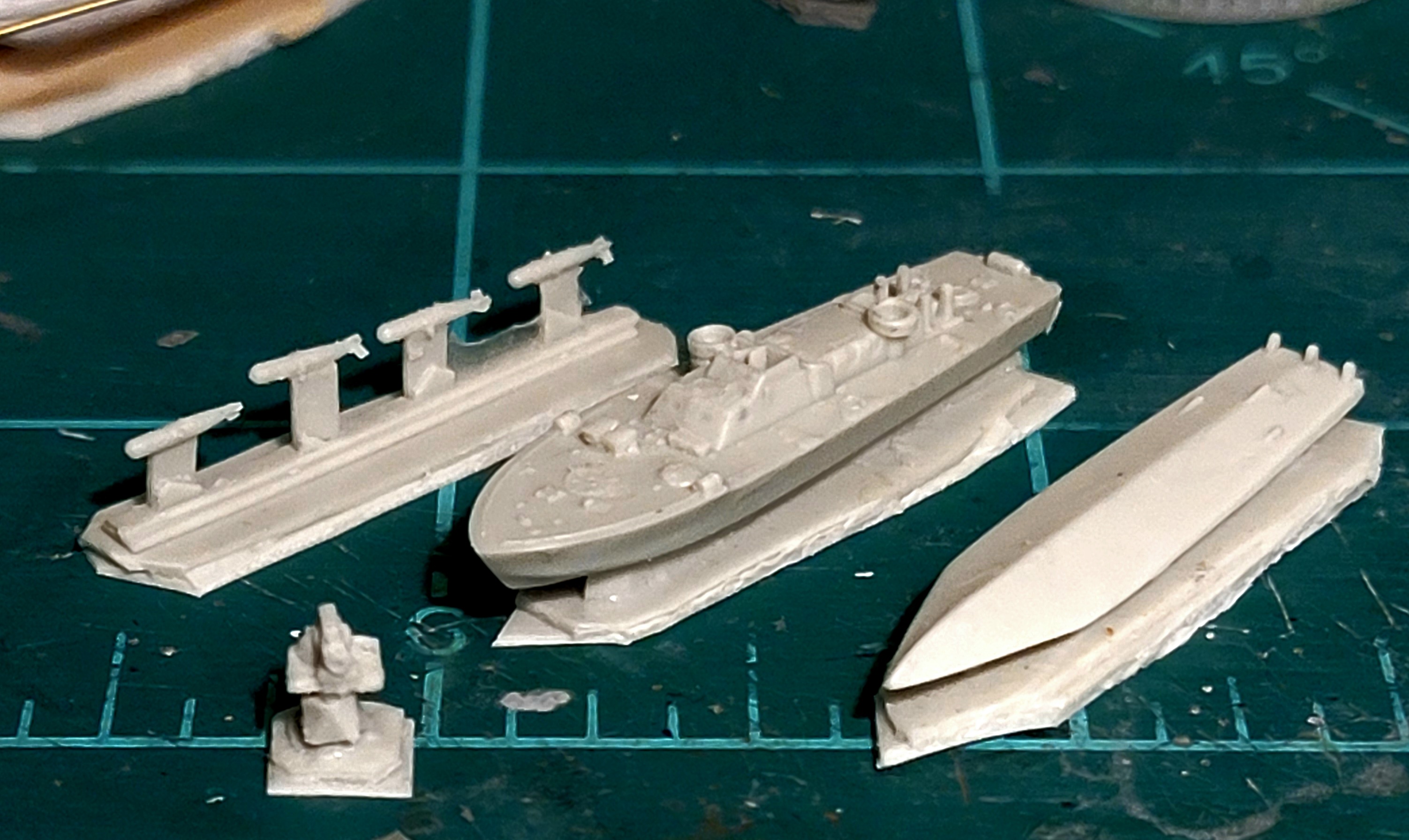

1941 Elco 77" PT Higgins late war 78-foot PT Late war Elco 80 foot boat
1/700 PT Boat set resin parts are complete.
For Waterline model builders that wish to make John F. Kennedy's PT-59 or PT-61 "Barge Buster" gun boats, extra 40mm cannon are available.
Unpictured masts, 20 & 37mm cannons and twin .50 guns are PEE bits. 40mm cannon barrels are turned brass.

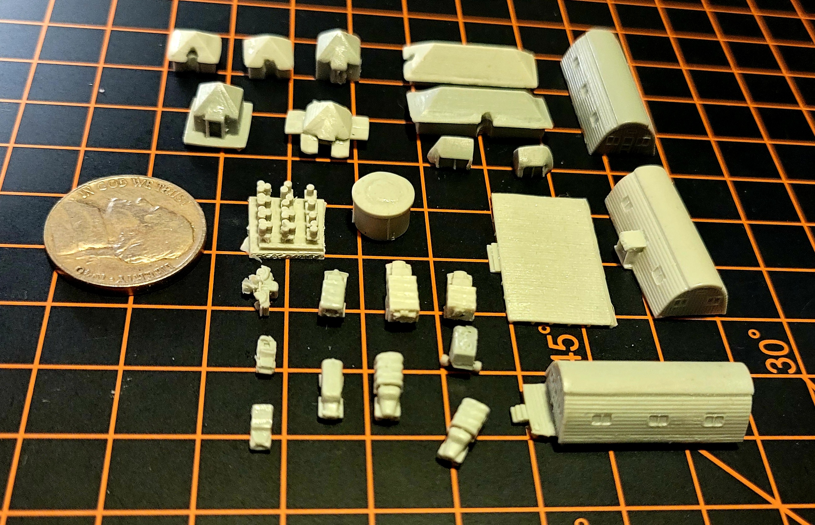

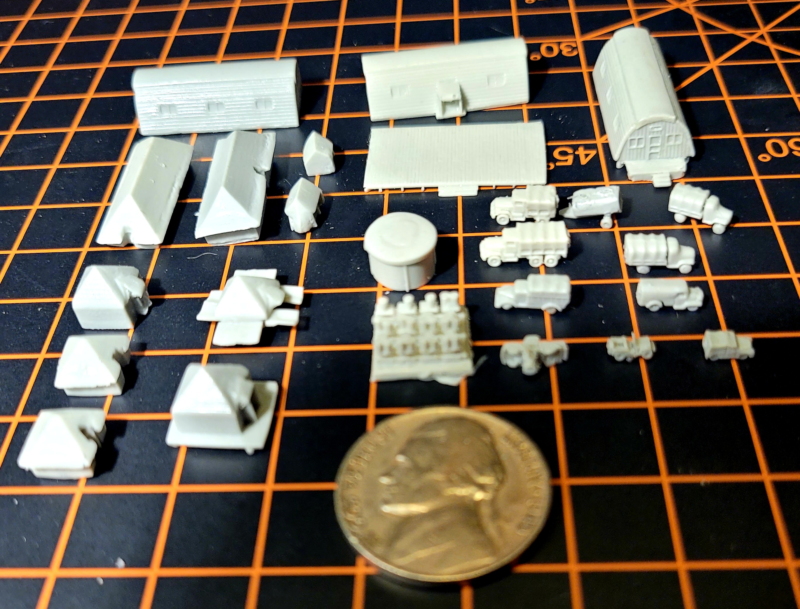

Completed PT Boat base accessories. Unless I dream up something else to add, because that NEVER happens. :smack:
Plenty of tents, modified Skywave Quonset huts, water/fuel tank, palletized 55 gallon drums, trucks, generator and only 1 Jeep? :hmm:
A very observant man might notice an Opel ambulance and a '47 Land Rover LWB. Never underestimate how resourceful Naval personnel can be!

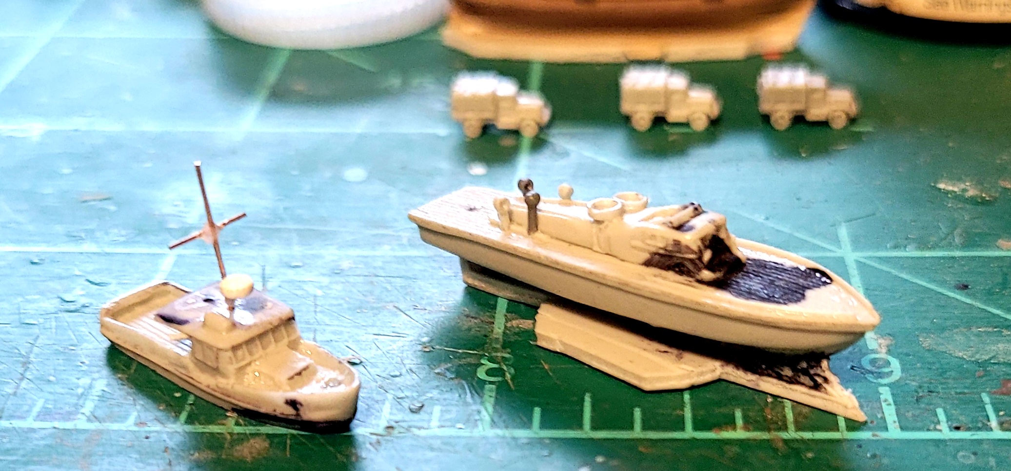

Gloucester Lobster boat in color. The UHF whip antenna will be fashioned from a cat's whisker. A little more fine tuning to do with Her finish, but you can see where I was going with Her. :bash:

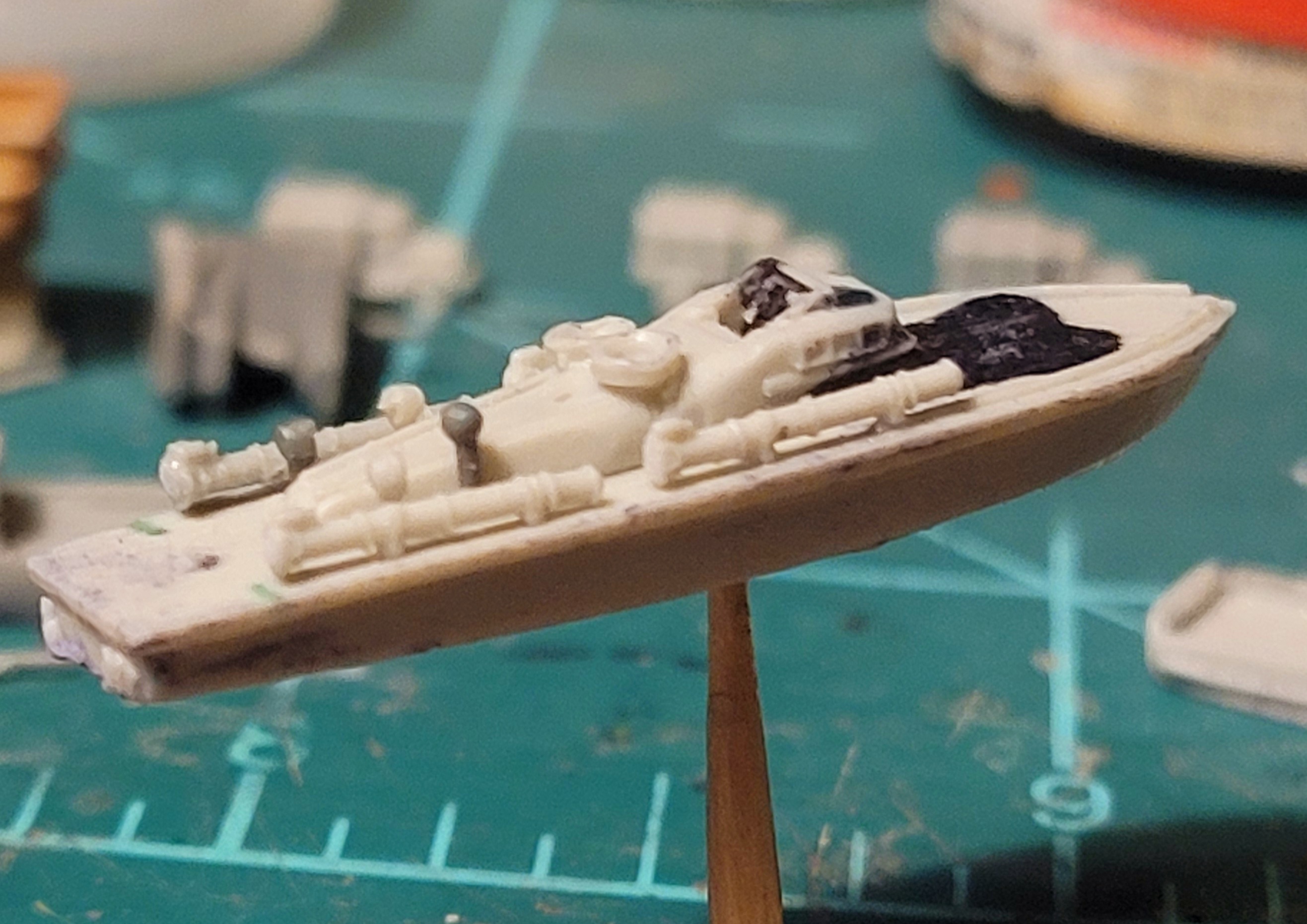

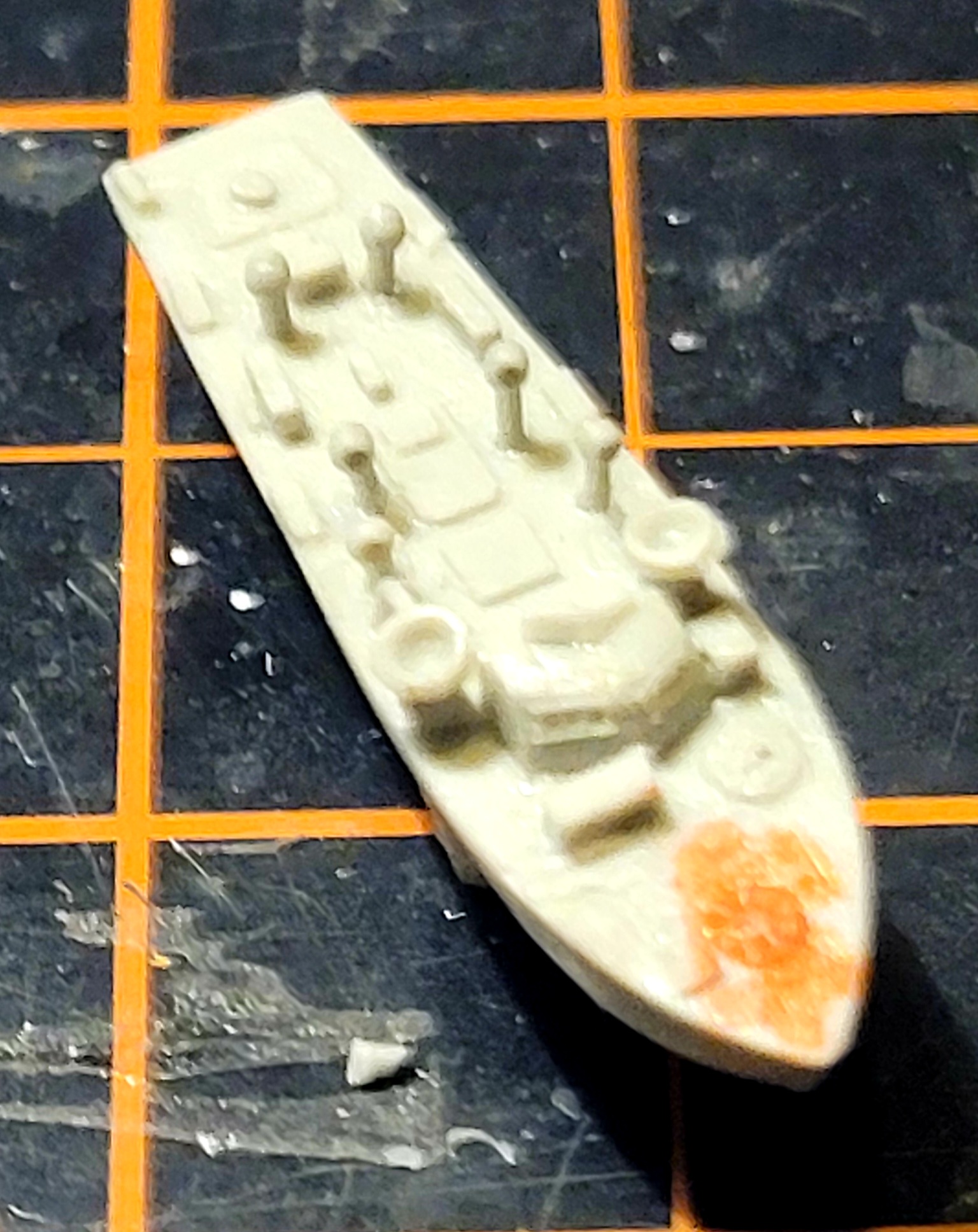

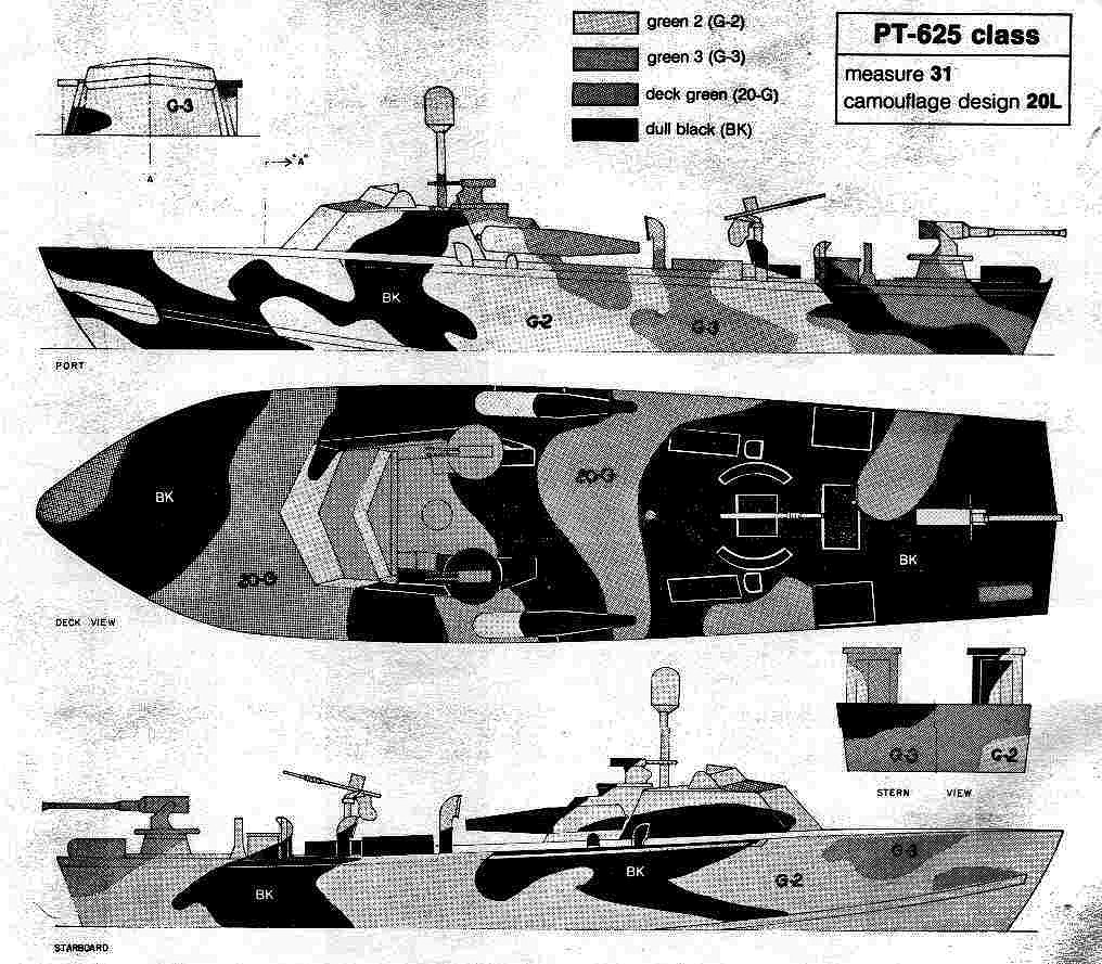

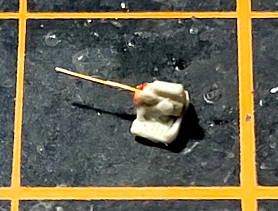

The Higgins 78' got her start tonight. The deck ventilators are very bit as enrgetic on the Higgins PT as the were on the 77' Elco boat. It took 11 vents to attach 6 to the boat. Orange sharpie helped pick out the center of the 37mm cannon base for drilling. Putting the brass barrel in the 40mm was a breeze! I hope to get as close to the US Navy 20H camouflage as I can in this scale.

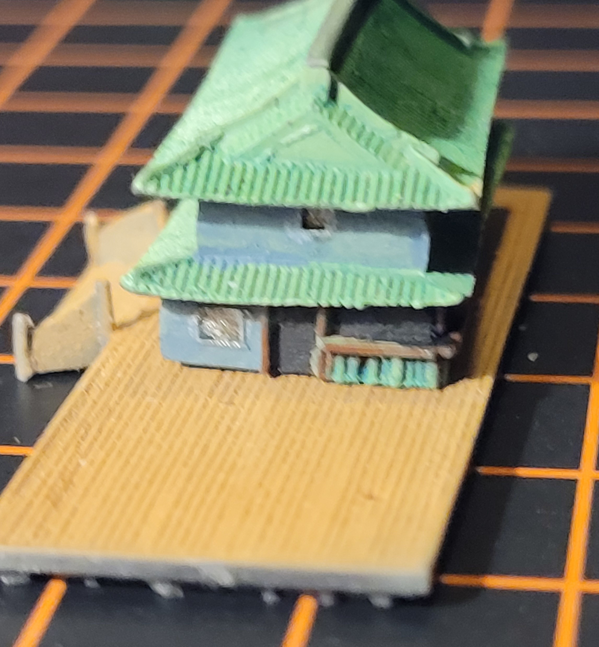

After I thought I had all the base facility bits I wanted, I found a picture of Mios Woendi in 1944. An 80-foot PT was having hull maintenance done in a pontoon drydock at Camp Taylor (far right). References for the 132-ton floating pontoon drydock are scarce.
SEE!?!
Now I have to make the pontoon drydock too!!
See what The Bad Man makes me do!!
It just never stops!!
