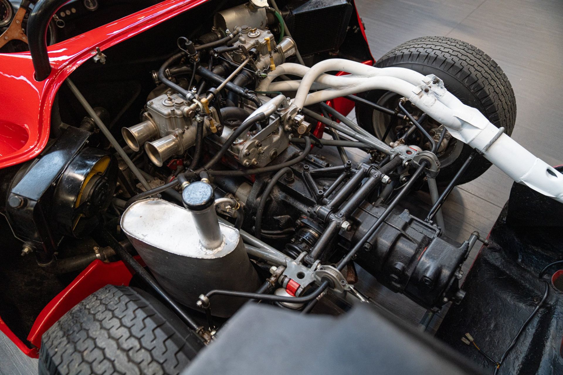

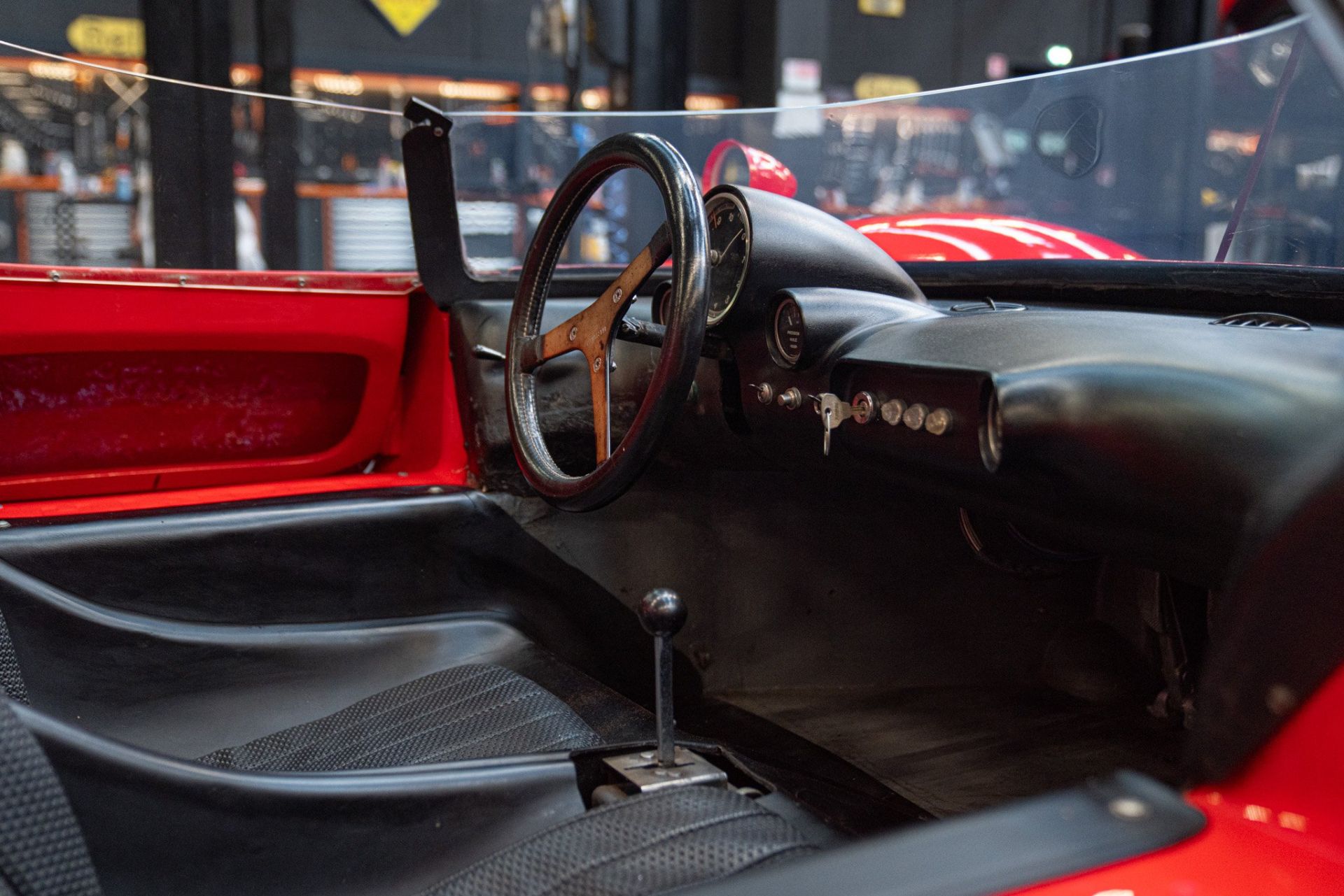

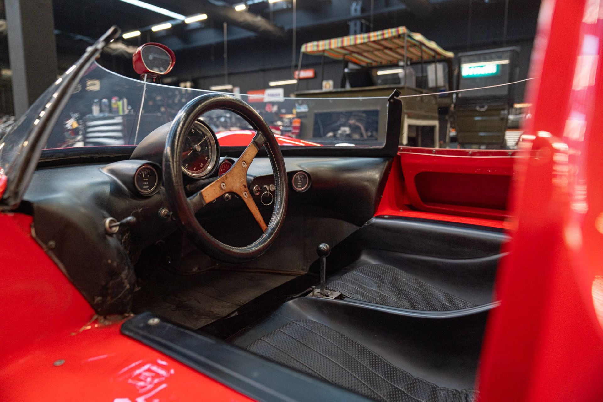

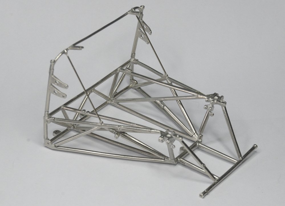

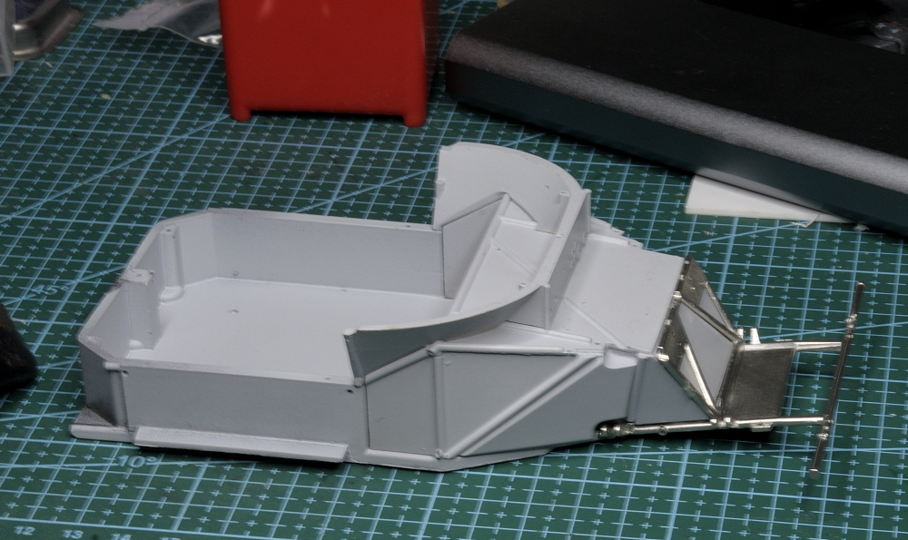

The car seems to have a space frame with fibreglass's infills. Its hard to know if the frame is moulded into the body which would make sense for strength but a nightmare to repair damage. Half the frame is mounded into the resin panels and half is white metal, if the frame is separate then it would probably be all the same colour, the instructions say everything is light grey however the only pictures i can find show everything black.
it does look odd like this with part of the frame grey but, none of the grey frame will be seen. At this point i realised that i couldn't fit the peddle box and the original seems to have crude carpet/covering in the foot wells. note the seats and floor are separate unit in the form of a fibreglass tray

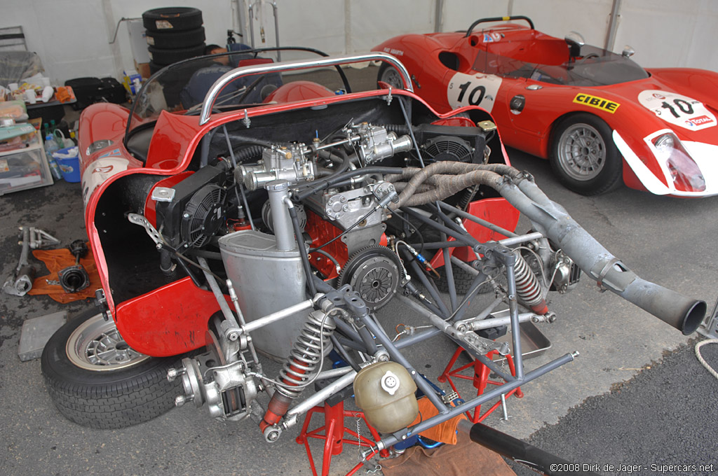

what i haven't been able to find is a picture with the front hood open to see what colour the tub and frame rails are, also front suspension.

the rear seems to be light and dark grey so i will prob replicate this for the front

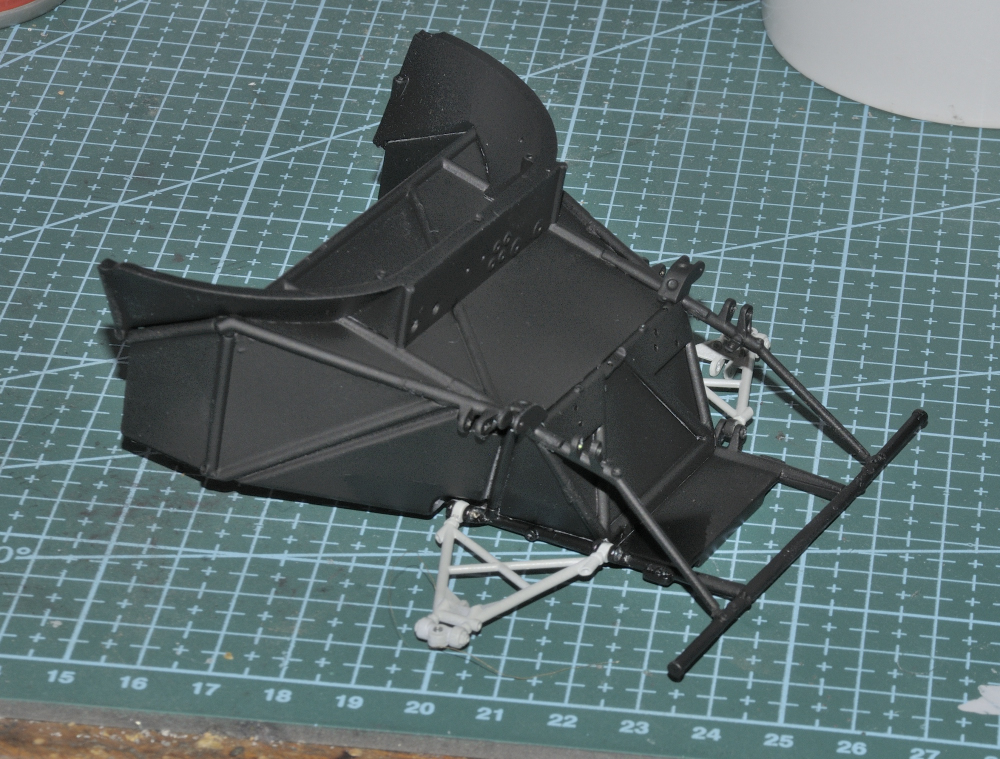

CA glue doesnt work i have been able to separate some of the front again which will help with fitting the pedal box, i just dont know what the outside of the body tub should be but I am leaning toward matt black like the inside of the rear hood seen here on the left
I started playing with the body shell.............oh wow. its doesnt really have a shell its made up of a dozen pieces, all with an different outside and inside colour and it looks like the only way to paint it will be to finish paint all the parts then try and fix it all together without and glue showing or damaging the surface while assembling. .I am trying not to think about that :)

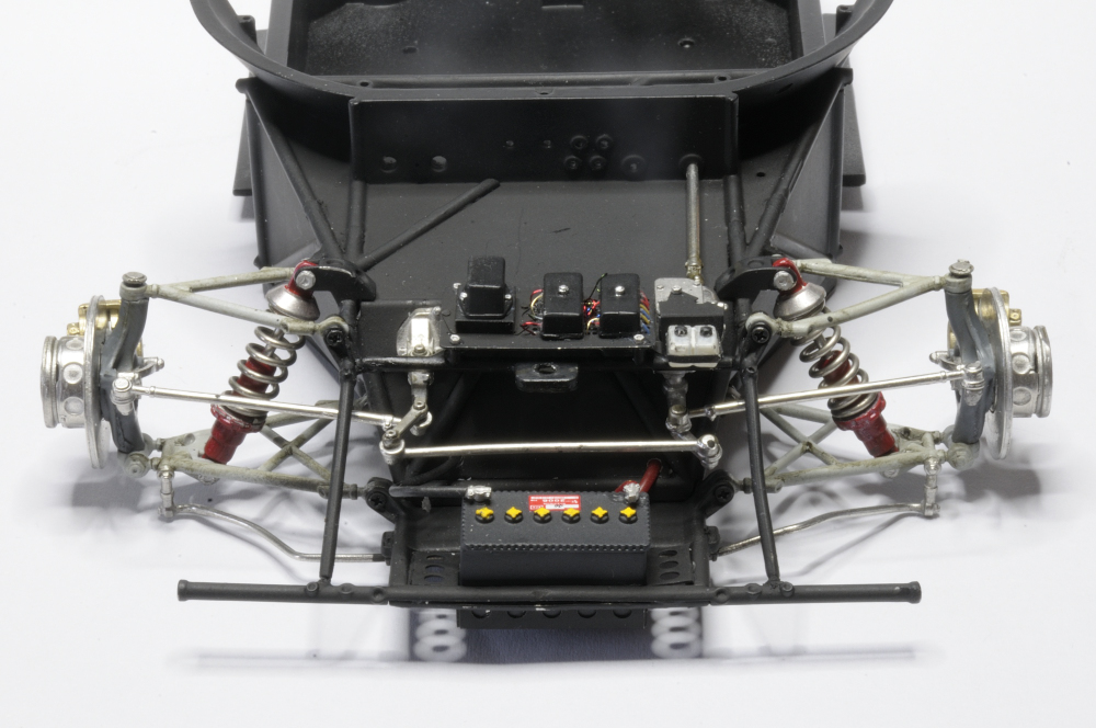

Black is the way forward i think for the tub and the space frame. I will then contrast it with silver , natural, and other greys on the suspension and anti roll bar, steering etc. I may try shading the panels a bit lighter to bring the frame out..

:lol: The first time you showed the Abarth reference photos, I thought they were your model! I almost fell out of my chair! :lol:
It is often truly not easy to differentiate the two. I got better.

The problem is Paul this white metal is basically solder so imagine 1.5mm solder on a real and you see that even putting the model down on an unever surface will bend things like the sway bar. It will be a case of going round everything when its finished and adjusting things.

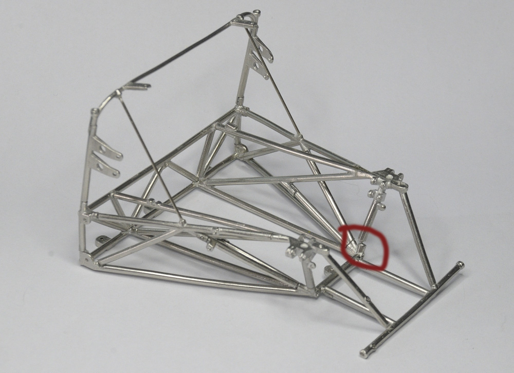

The rear space frame, engine and suspension mounts is tricky. They cast in the location pins but not the corresponding holes. There are basically no right angles so all the holes have to be drilled at an angle which dictates the the shape of what you end up with :)
Is this correct ? i guess we will find out as we go on 🤣 It sits flat and it looks symmetrical. The instruction include a separate sheet with end/side/plan view in 1:1 scale which helps;
You can see here how everything needs to just sit where it wants to be because if you put a joint under stress it will pop out 24 hours later. CA really doesnt work on this metal
