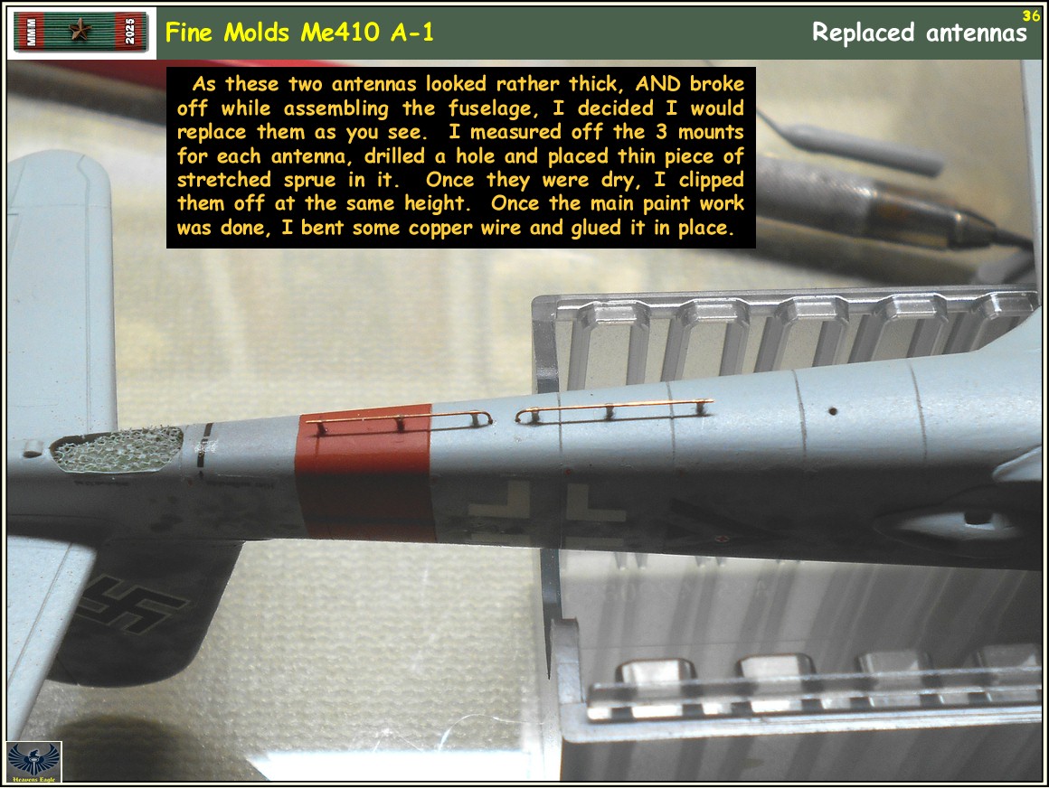

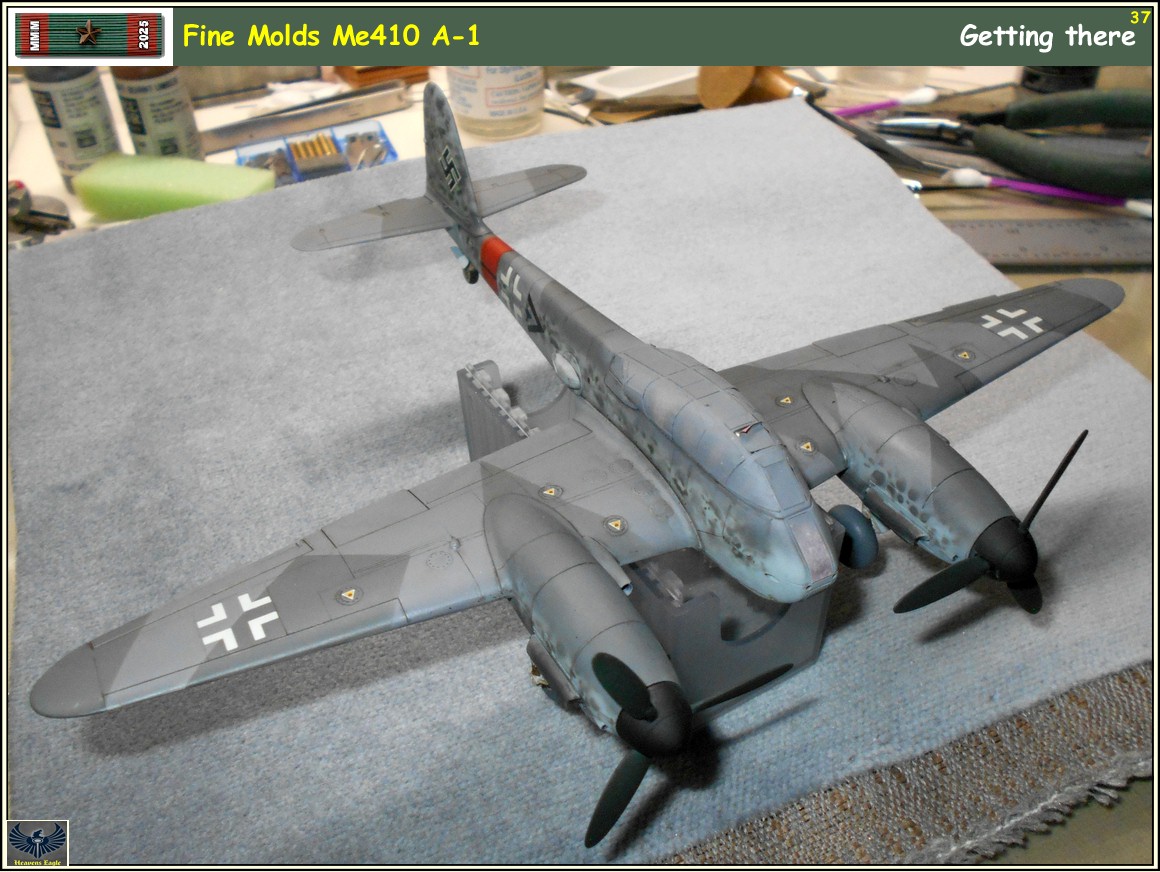

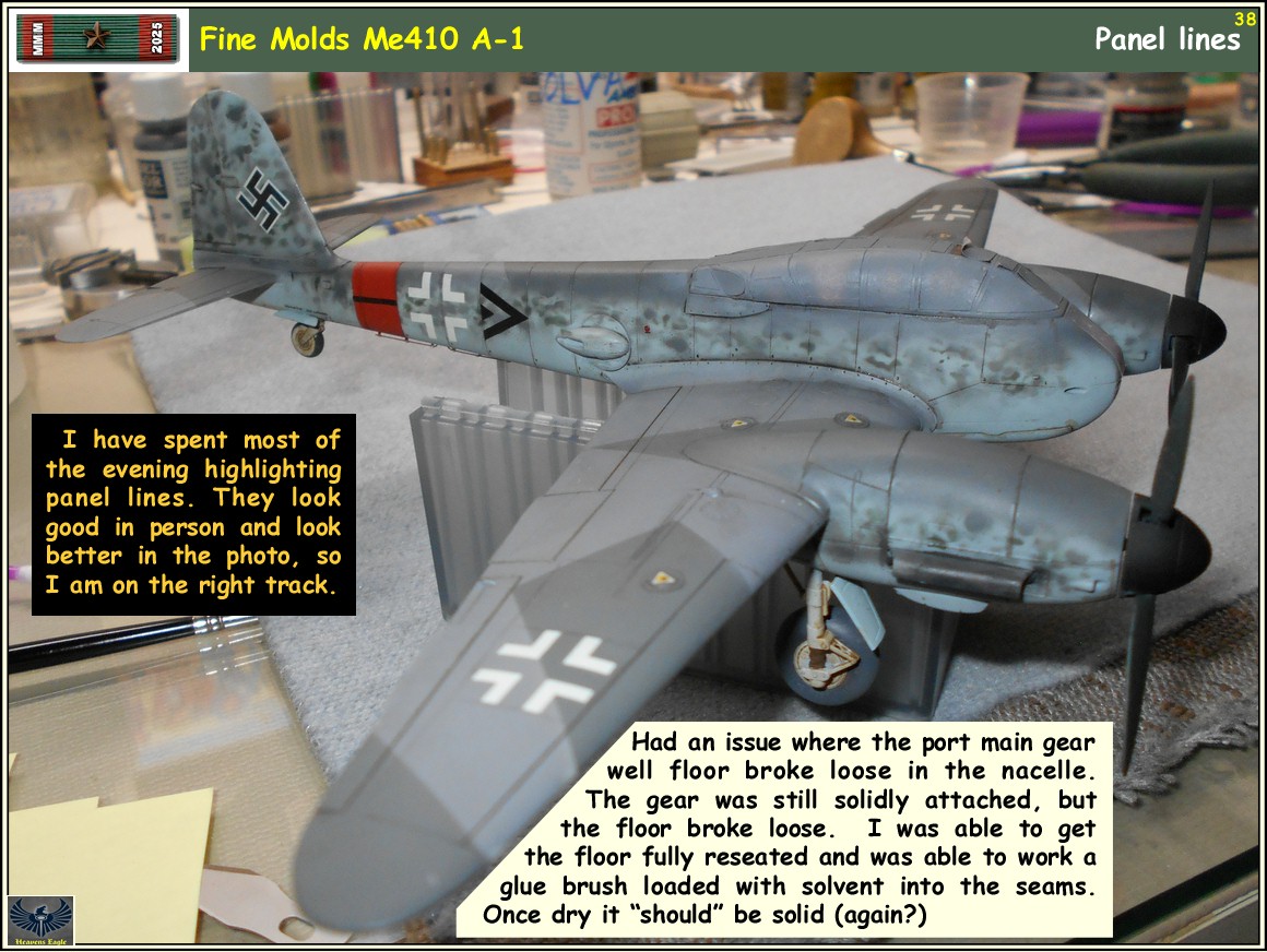

Just a quick post to let everyone know that this build has made big progress, and is getting really close to the finish line. Paint, decals, landing gear are in place, and weathering and fine detailing are almost done as well. Nothing really to show as those processes are same-o, same-o. I have been making a mess trying to make progress. Just taking time and it is looking pretty good. The flat coat blends so much of the odd blemishes into a smooth finish (some of my old Testor's dull coat that does an amazing job).
This Fine Molds kit has been anything BUT fine, though I have managed to make a decent finish on it. It should be done sometime this week as it is that close.
I have a couple of photos of some things I have been working on. Here they are.

It's getting there. It needs some heavy weathering yet, antennas added, machine guns (which I will need to make from brass) and some minor paint touch ups.
