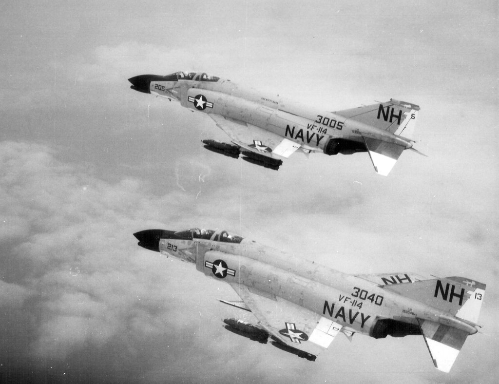

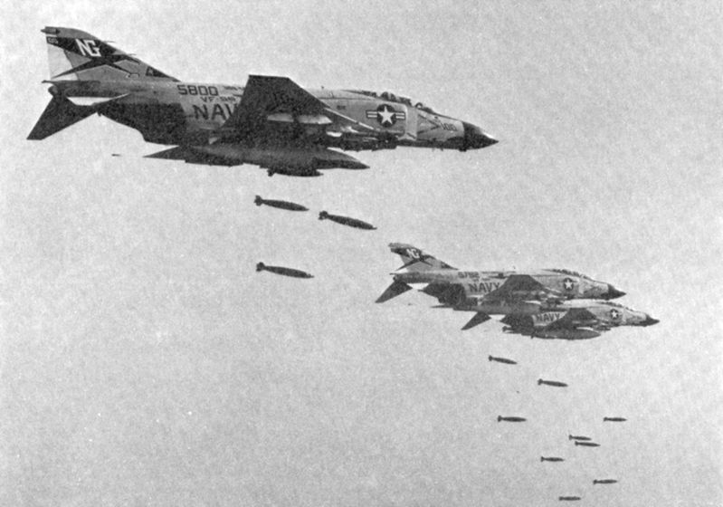

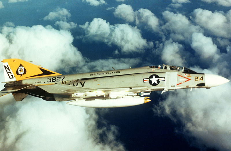

Here are two F4J's and one F-4B photo involving weapons from the Viet Nam era. Not too many pictures got taken of loaded airplanes on carriers, I suspect. Couldn't find any Marine birds with loads, maybe the Marines hadn't learned to use cameras and bombs at the same time...
F4B's
F4J's
F4J
