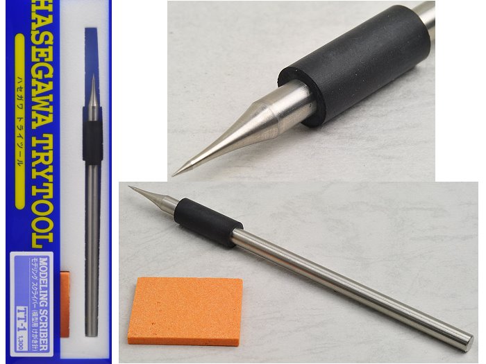

I use the Trumpeter scriber quite a bit. I also have one that is a very sharp pointy one that is a Hasegawa scriber. It is awesome for quite a few things.
Trumpeter http://www.amazon.com/Trumpeter-Panel-Line-Engraver-Tool/dp/B001JJT9DU/ref=sr_1_fkmr0_1?ie=UTF8&qid=1428068192&sr=8-1-fkmr0&keywords=Trumpeter+Pro+Tool+Line+Engraver
Hasegawa http://www.amazon.com/Modeling-scriber-TT1-yJapanese-plastic/dp/B001AJ0M6W/ref=sr_1_1?ie=UTF8&qid=1428068258&sr=8-1&keywords=Hasegawa+Scriber
