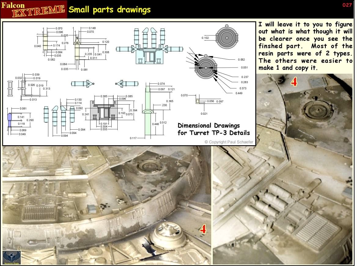

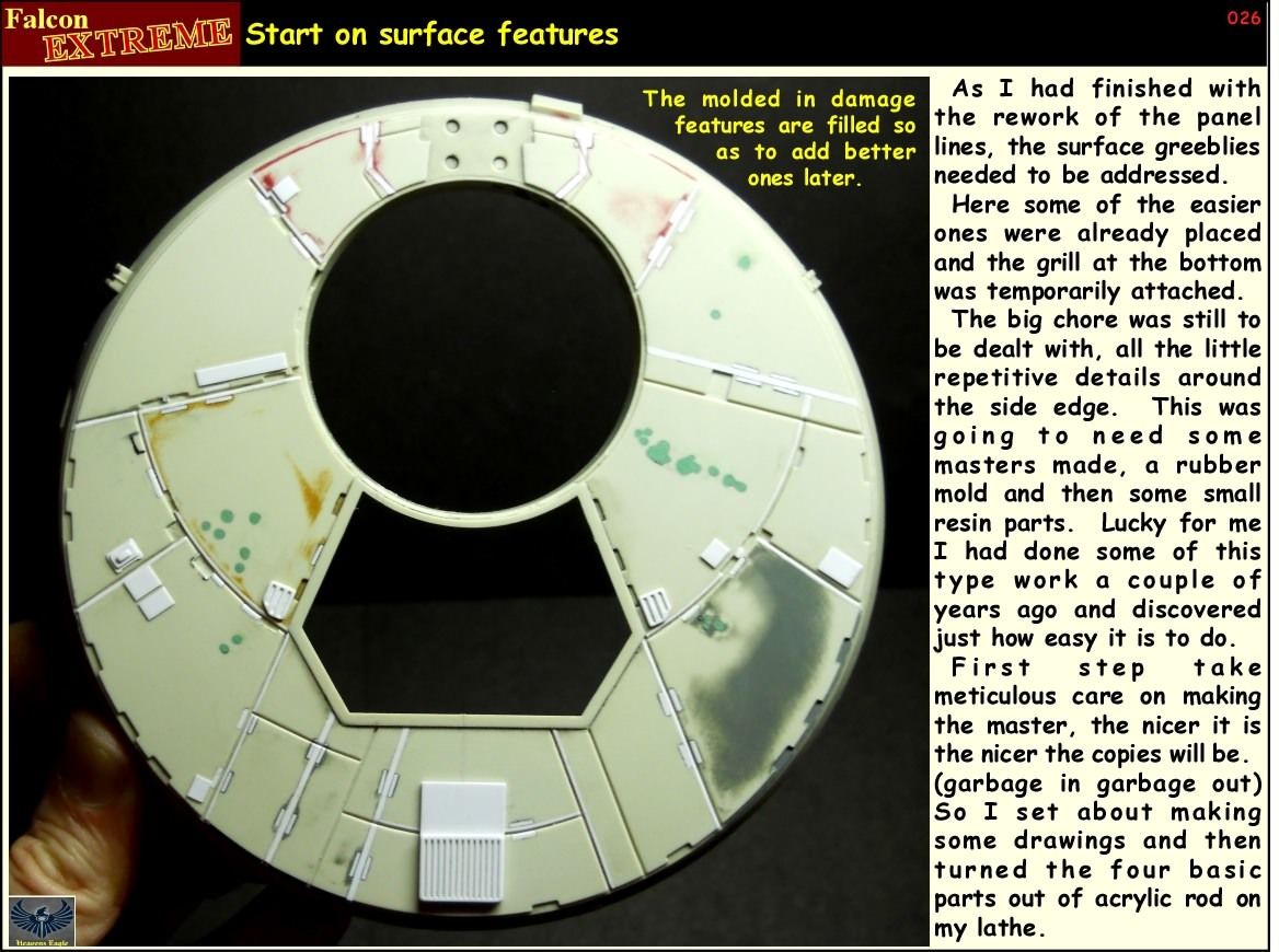

As for little resin parts applied so far the count is 31. Those are all around the edge. There are 2 basic shapes and they are about .060 wide by .310 long. Starting to do the top surface now, and that isn't counting all the little evergreen squares and whatnot added. :blink
I will post some before/after pics when all is applied.

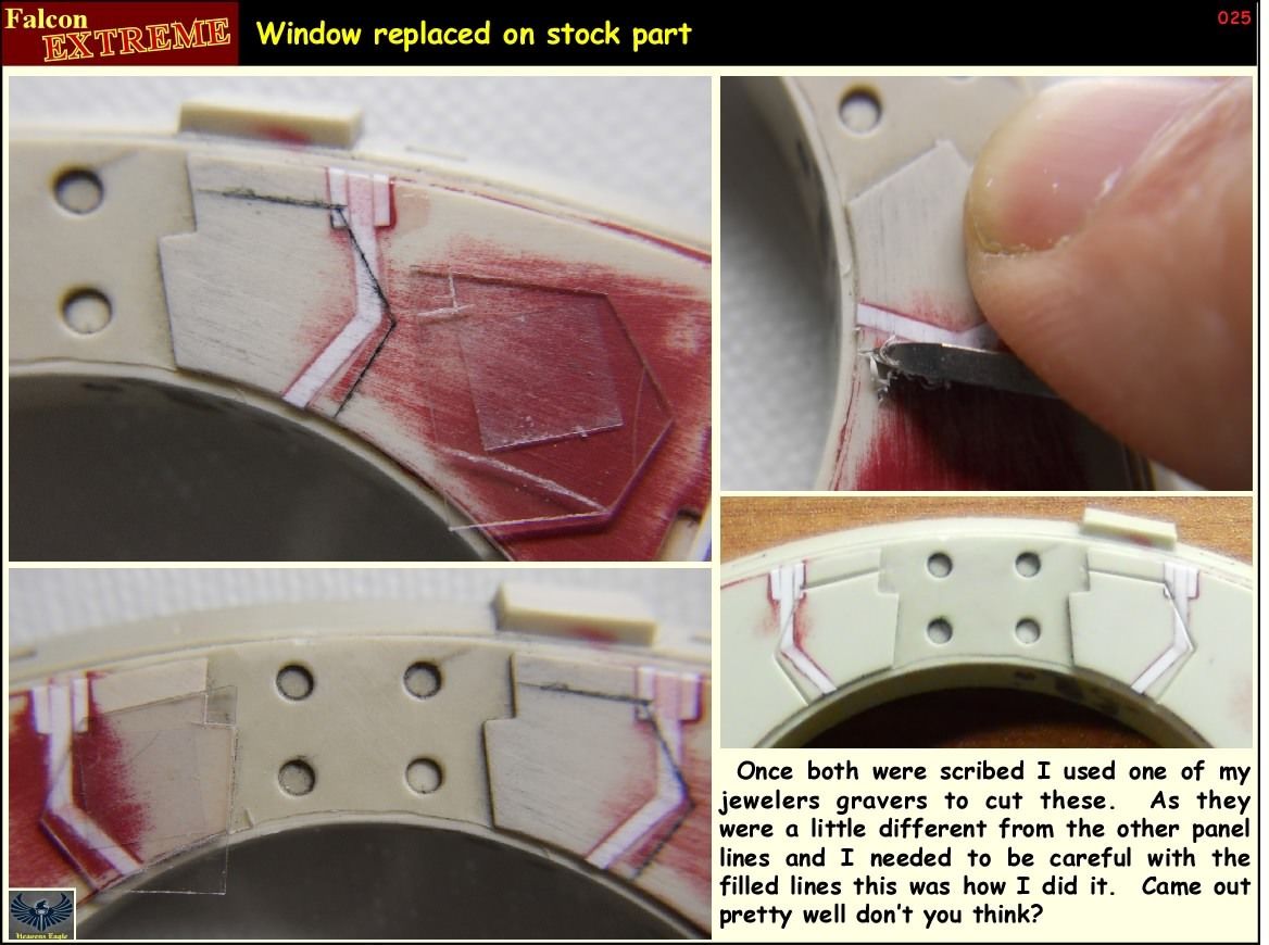

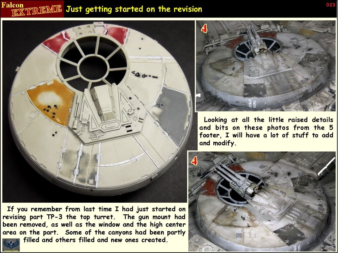

Have been steadily working on the upper turret. (part TP-3) Finally got almost all the details added to the main plate. Have fully modified the window frame to make it look more like the one on the 5 footer, and it looks awesome. Will be posting some more pics this coming weekend.
The last couple days I have been detailing the gun mount which now looks quite a bit different. Can hardly wait to post the before/after photos.

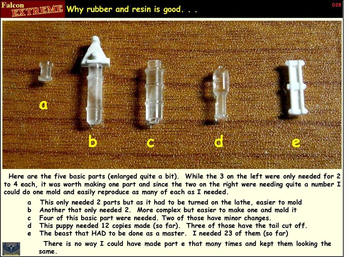

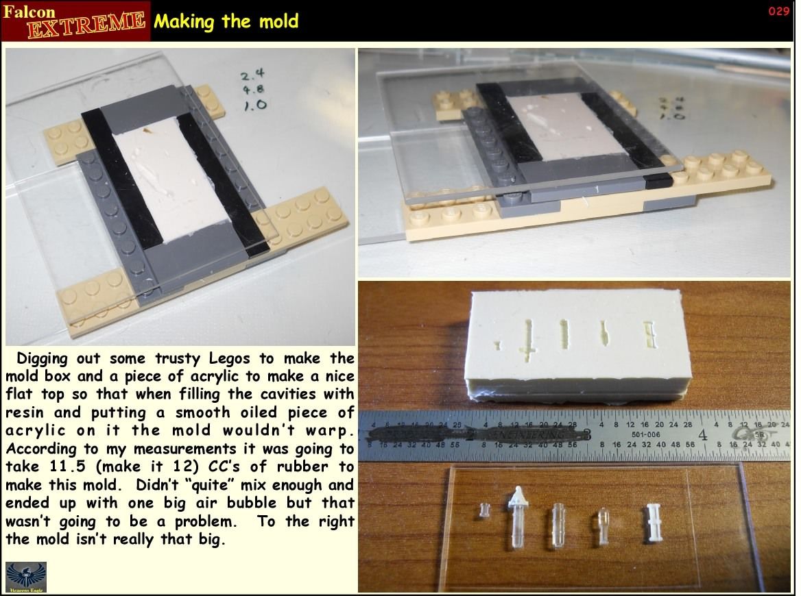

I have a ton of things to post so I am breaking it up a little bit. There will be more in a day or two and then more after that. Enjoy!

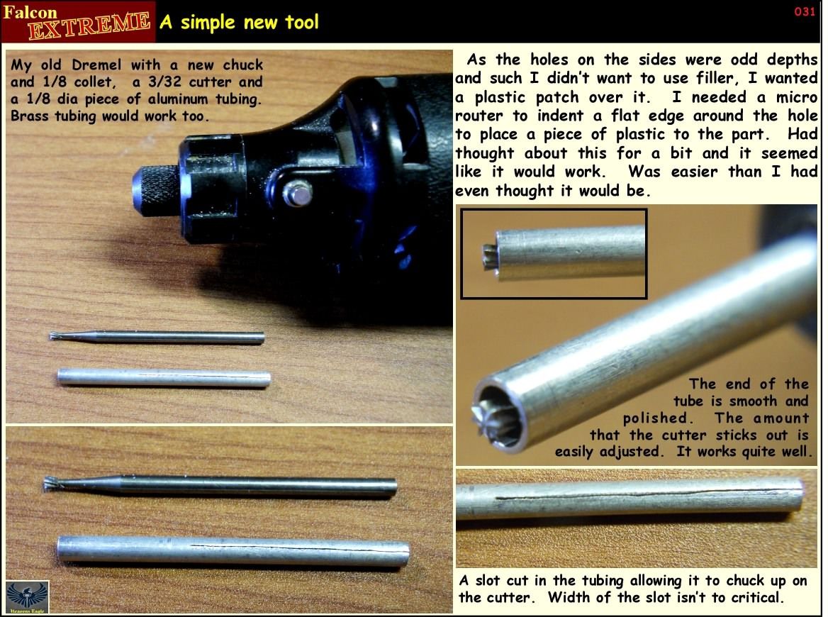

I even have a neat little tool tip that everyone might find helpful. ;)
So here we go. . .

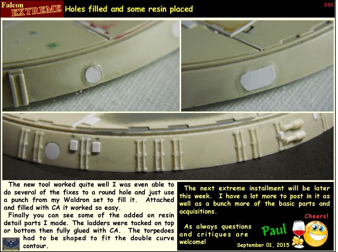

Falcon-FX-023.jpg~original
Falcon-FX-024.jpg~original
Falcon-FX-025.jpg~original
Falcon-FX-026.jpg~original
Falcon-FX-027.jpg~original
Falcon-FX-028.jpg~original
Falcon-FX-029.jpg~original
Falcon-FX-030.jpg~original
Falcon-FX-031.jpg~original
Falcon-FX-032.jpg~original
