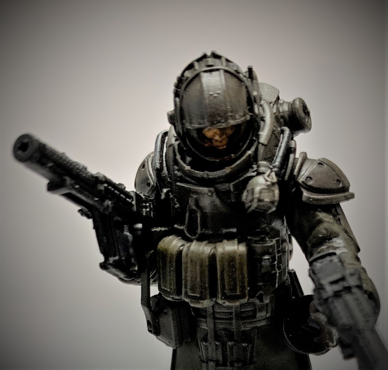

Looks like he's about to start moving. But, Dark Side and all, shouldn't there be a more ominous background? A few squeezed heads laying around?

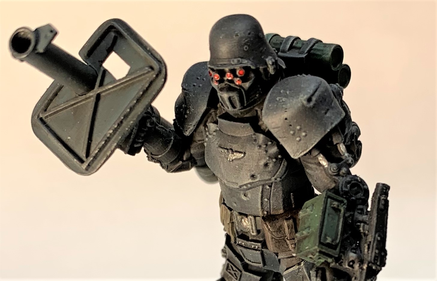

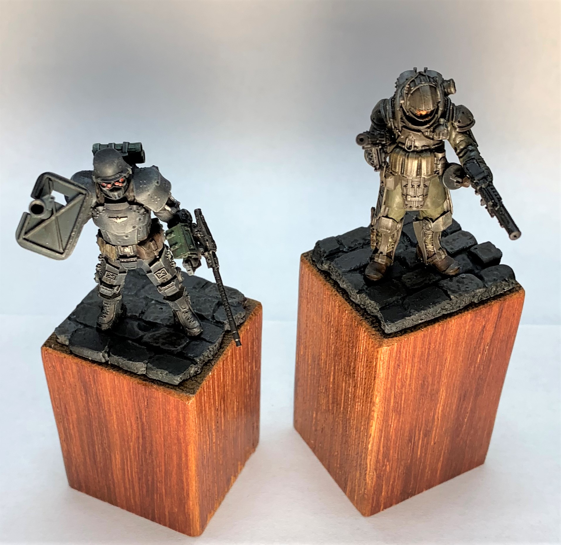

Looks good Bob, especially all the different black tones.
Can you give us some insight in what paint and how you got the blacks to look like flat material of all shades please.![]()
Thanks Bob, I really appreciate your taking time out to give us the 'good oil'. You are always extremely helpful. I love the overcoat effect. I use a similar technique on my tanks, just with pigments and a thin layer instead. I need to get more patient with my figure painting after looking at yours and the great variety you have achieved!Thanks Ian,
To begin, there are always a hundred ways to do things. This is how I like them to look but, to others, maybe not. I am always looking for new ways to improve my dioramas. At 79 years old, I am still experimenting and I change techniques continuously. I've yet to achieve perfection but I keep trying!
It is a thing I have developed over the last 20 years or so. It is not only effective with black, but with all colors. I use this on military and civilian figures as well as military armor and vehicles. This is the technique I used to paint Darth Vader. First, I get all the paint tones and colors together I can find that will be complimentary combined, plus the pastel powders and the flats, semi-glosses and the high glosses. Then, using actual photographs, I determine what shades, tones and which parts to be flat, glossy or semi-glossy. For clothing, I match the color paint I will use and a pastel stick. Then I grind the stick into powder. I spray the cloth parts with the enamel and then, before drying, I use an old, worn out brush, about a size 8 or 10, with the bristles worn down. I stick the brush into the powders and then stipple it onto the still slightly damp paint. That creates a texture similar to cloth. It drys flatter than dead flatI With Vader, I only used one shade pf pastels. However several shades can be used to achieve various blends of shadows and highlights. Then in both black as well as in most military gear, the various parts are different shades, textures and tones.

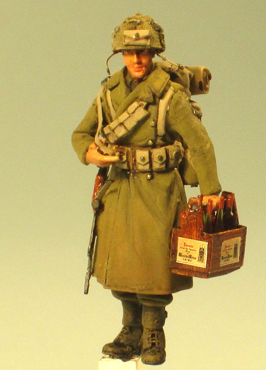

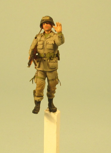

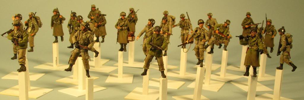

Here are photos of American G.I.s I have painted using this system. These will be tank riders. You can see what I mean by using a dozen or more paints with varying shades, tones, textures, even some that are so close you may bot notice them individually, but, the overall effect could not be created without them. Using this technique for a single figure would increase the time expended, but, I use the Henry Ford technique and paint many of the same uniforms at the same time. These are all 1/35th scale figures.
Here you can see the pastel/enamel texture in an overcoat.This best simulates a heavy wool or other such material.

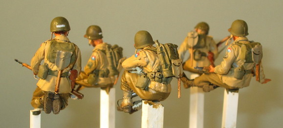

The various shades create a unique "look" as opposed to a bunch of figures that came in a set.
Maybe this photo will demonstrate what I mean. None look alike, each has their own personality.

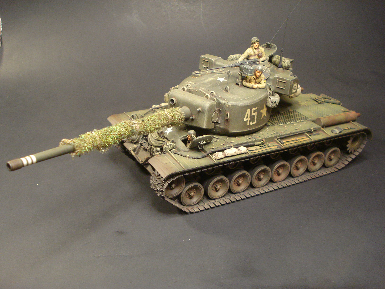

As I said before, this same technique can be used on vehicles, even buildings, especially interiors
