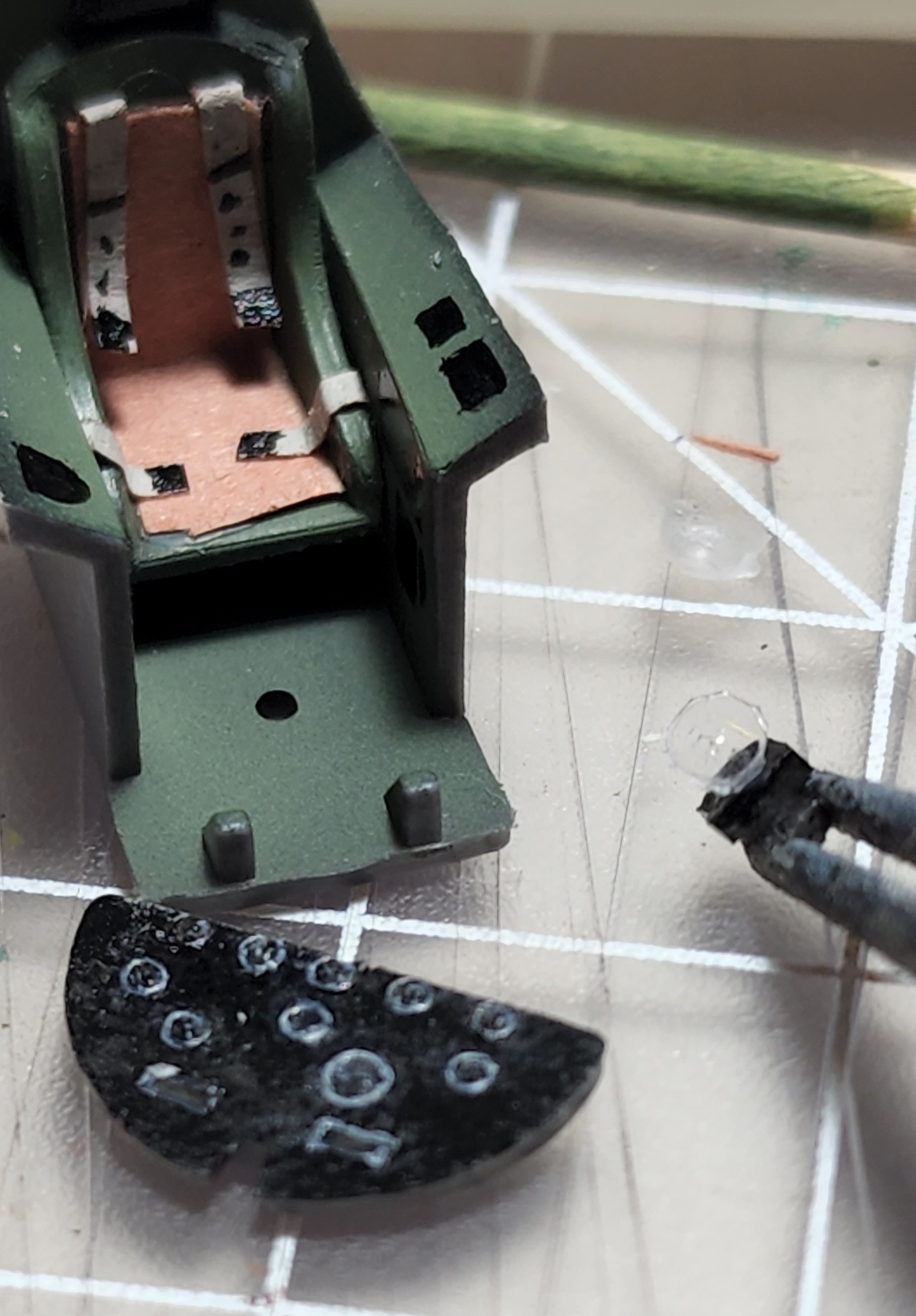

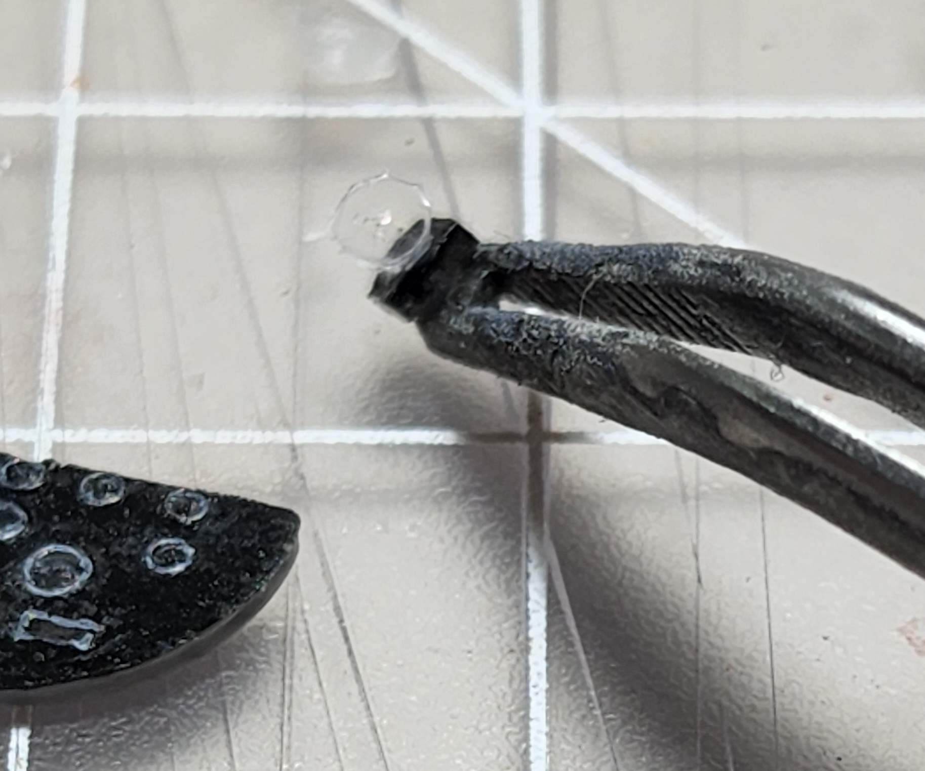

Hi folks. How does everone cut perfect circles when making custom part. You can see in these photos I have tried to cut a round clear part to replace the poor plastic piece for the instrument panel if a 1/72 Grumman Hellcat model. The white squares on the mat are 1/2" squares so the piece I am making is teeny! I used a circle template and scored with a needle tool to cut part way through the plastic then finished with an Xacto knife. Is there a better way?

No, not the instrument panel faces. It looks like a clear gun site that sits on top of the panel. The model had the piece molded in opaque square plastic but the part on the plane is round and clear.
To fill in IP dials I have been using UV resin made for tying fishing flies. It is activated by a UV flashlight and dried hard in 10 secinds.
Little round pieces, you will need a punch set. I have both of the original Waldron punch sets and use them often. When I was at the Chattanooga Nationals there was someone there that was selling Waldron tools and if I remember correctly, had the 2 punch sets brand new. Don't remember now who they were, but if you search you should be able to find some small punch sets. I would check Micro Mark as one possible source.
