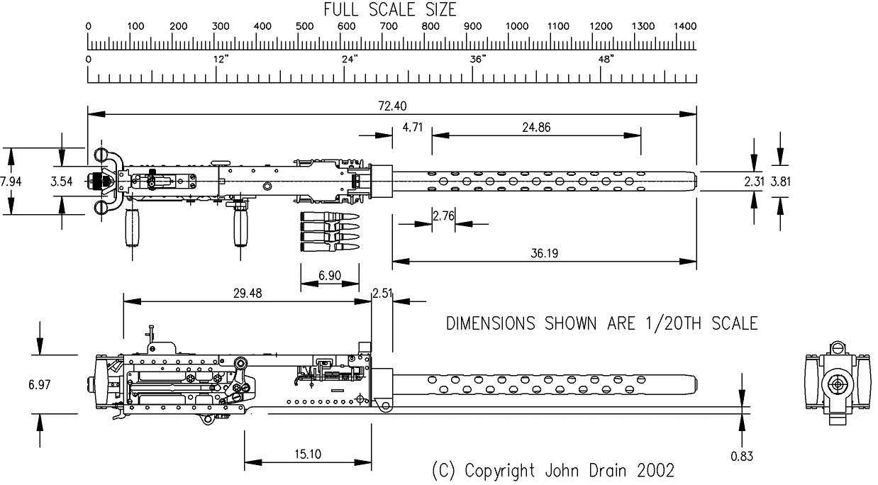

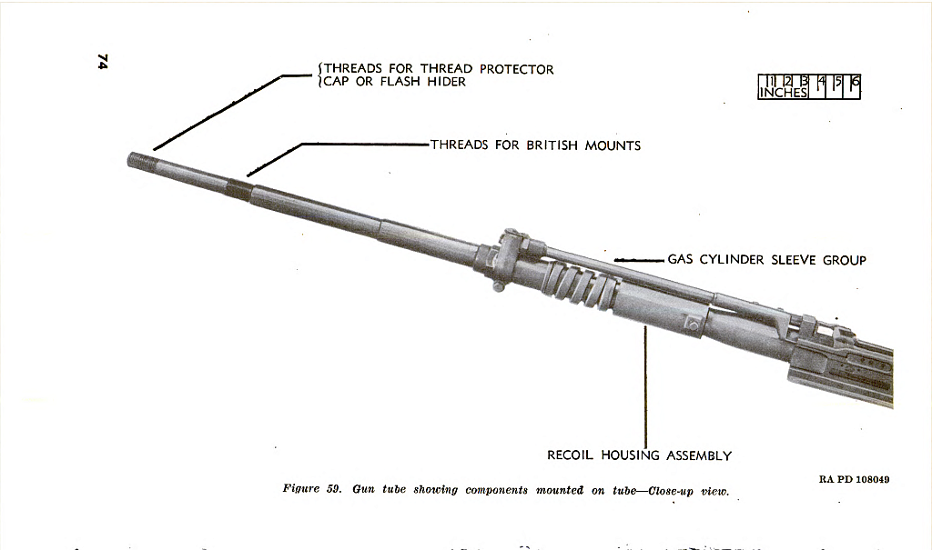

The dimensions shown here are for 1/20th scale so multiply by 79% for full size or 11% for 72nd scale in inches. The perforated barrel sheath would be .025 inch ( 0.6mm) in 72nd scale.
Click image for a nice reference site:
You simply have to ask...
Ah sir, but that is the M2 in .50 cal. The F9F had the M2 20mm. I know, there's so many wildly different pieces of equipment designated M1, M2, M3, etc. in the US military it's a little absurd

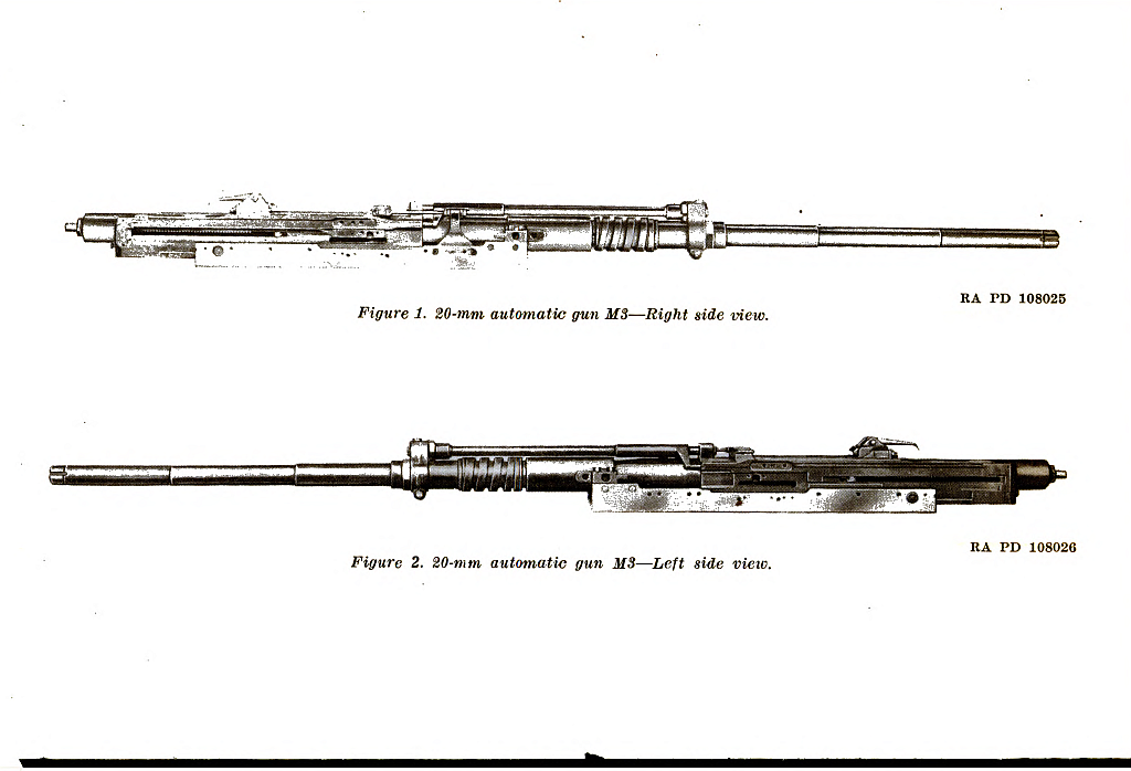

Sir, You illustration is that of an M2 .50 cal. Do you have this diagram for the Mk.3 20mm?

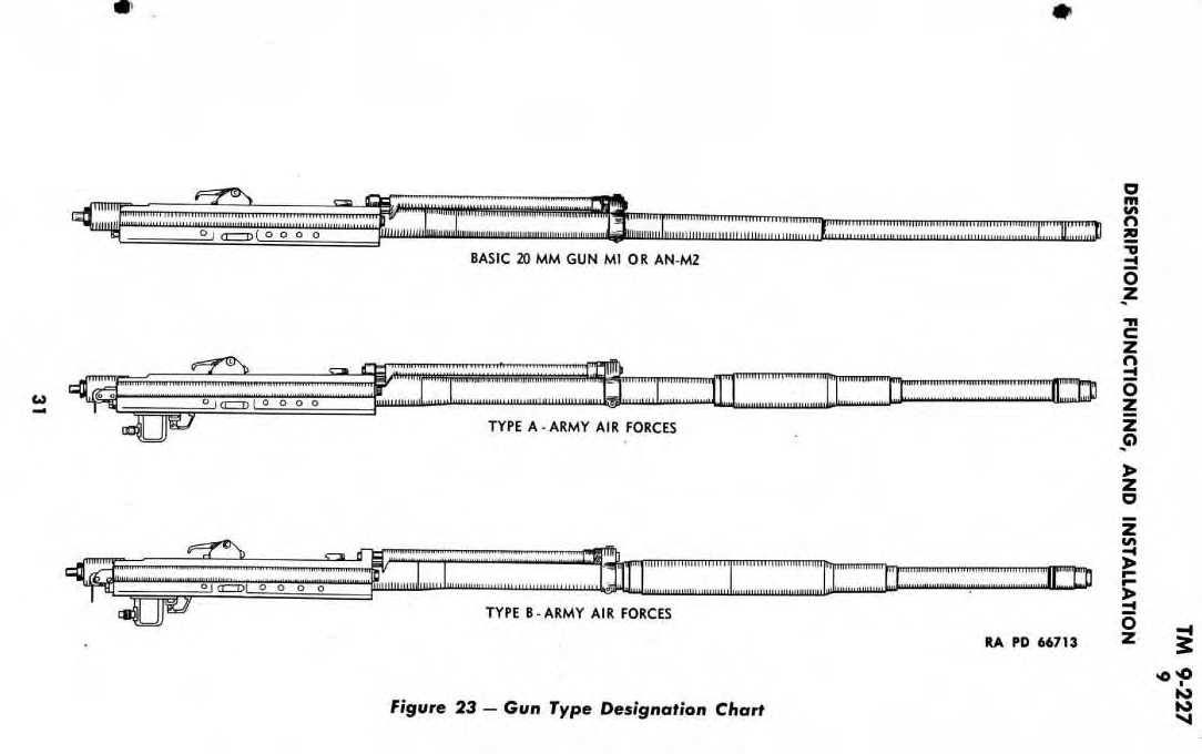

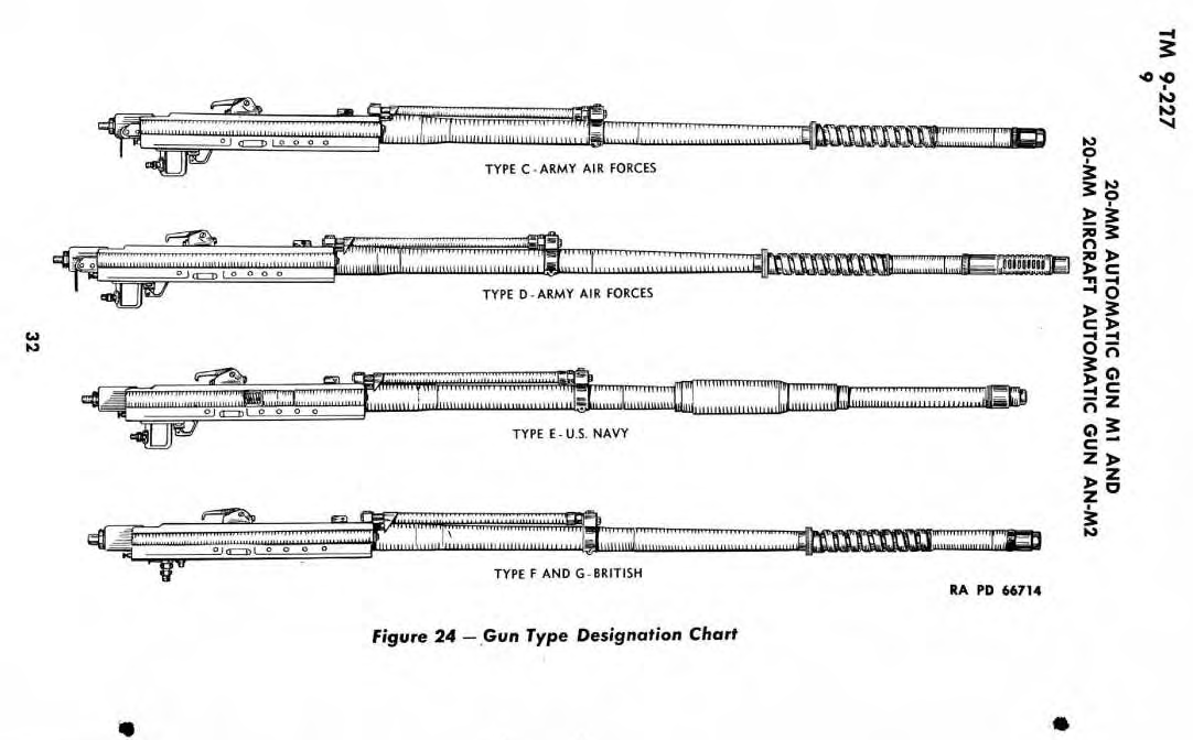

Oh boy! Not again! I need to pay closer attention and yes, I do have that information as I needed it for my A-20G-1-DO. The Hispano 20mm HS.404 cannon was licensed as the M2. So, now I need to see what barrel type is used on the Panther. I will grab this book to look it up. Be right back, need to prepare a breakfast for the woman of the house as my son is still sleeping and forgets his duty on Mother's Day!

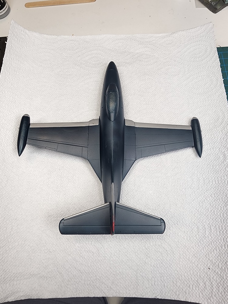

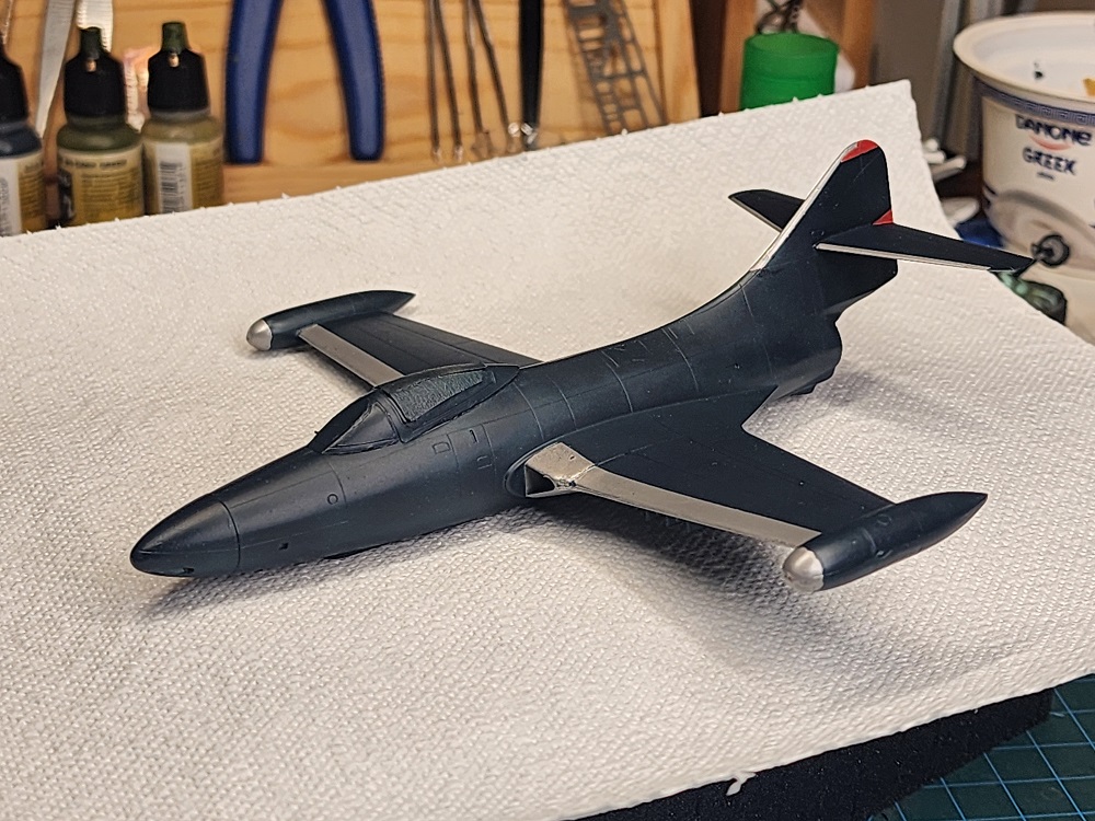

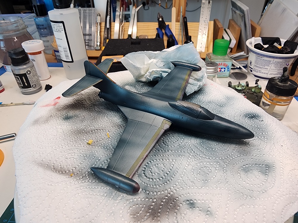

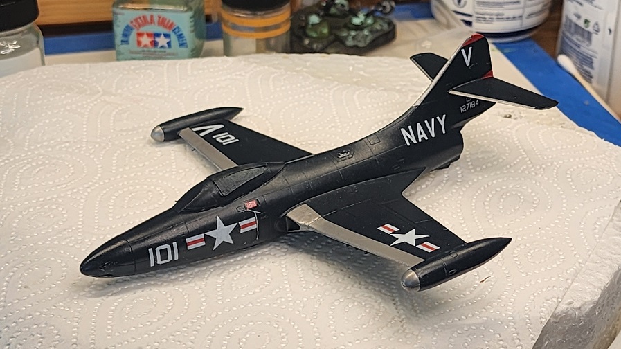

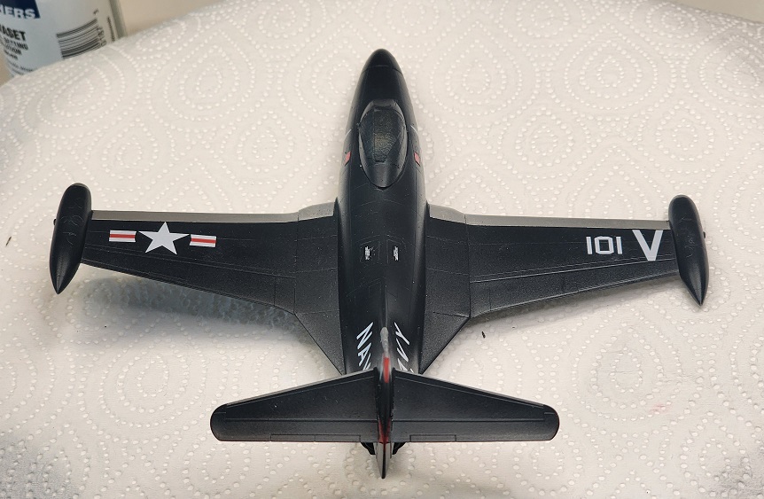

Paint's on! I started with black primer and then a coat of dull aluminum because I was afraid leaving it black would make the dark blue just too dark. It may have also had the benefit that I got no peeling at all from the masking, which I almost always got before with Vallejo.
Now for some touch-up, gloss coat, and decals.

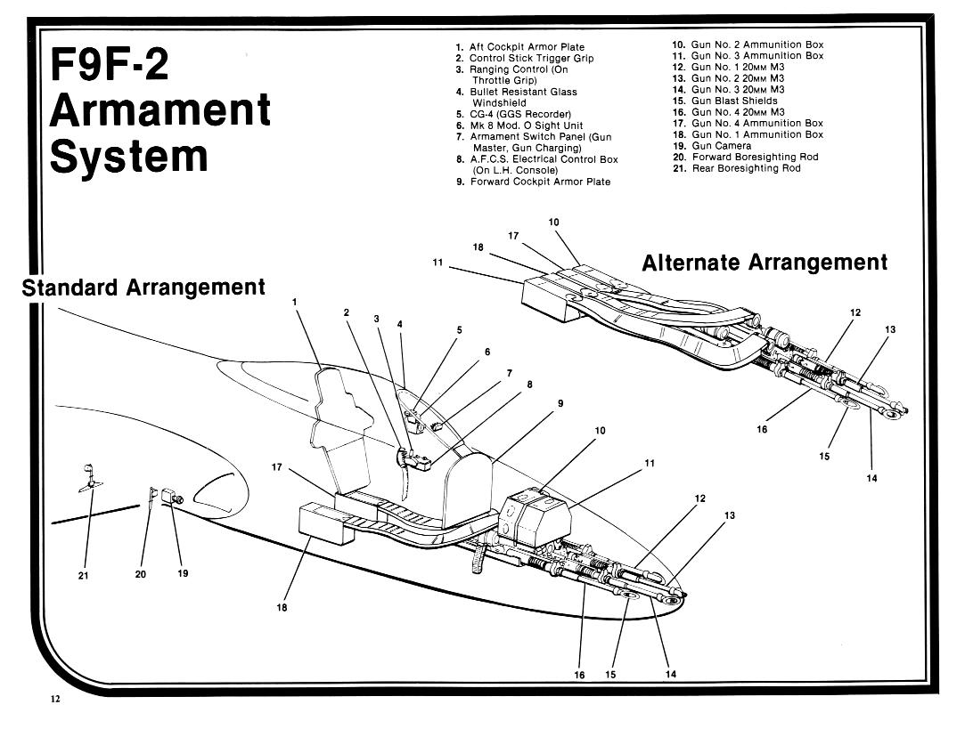

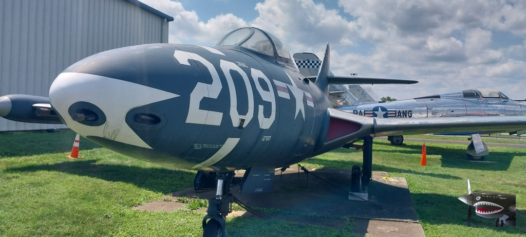

It is Mother's Day so please be patient. In the meantime, this might be of interest...
Click to see walkaround...

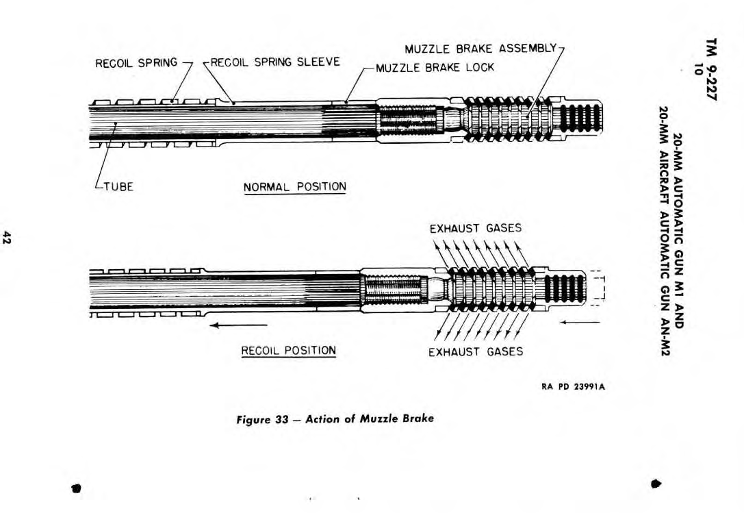

Using this as a guide, in 1/72nd scale, the muzzle break assembly is 0.44mm at the thinner part and 0.57mm at the thicker part:
I gave all most all my Vallejo away because of this and I haven't looked back. Except for some of the model colors that I had to resupply.
Like the idea of some metal coat under the base. Really neat idea.
Like I said on Sauls photos, there's a bridge quivering in fear somewhere in Korea! :plane
She looks quite Panther-ish in Blue. Bravo Charles!
You have redeemed your reputation, Sr. Garcia. I have a TM9-229 around here somewhere, I just didn't think of it.

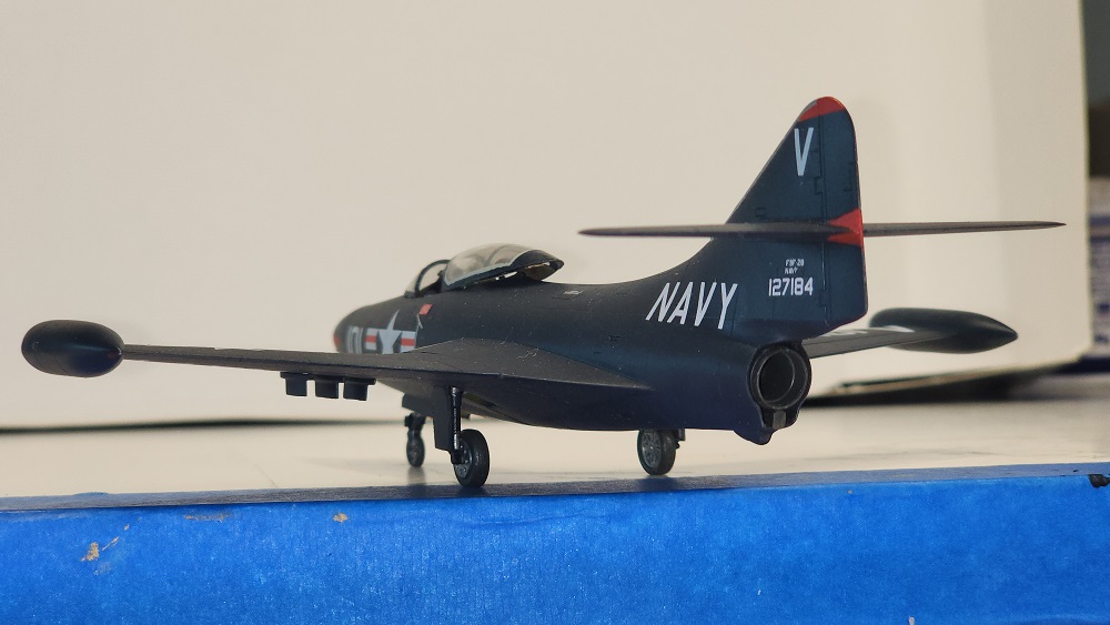

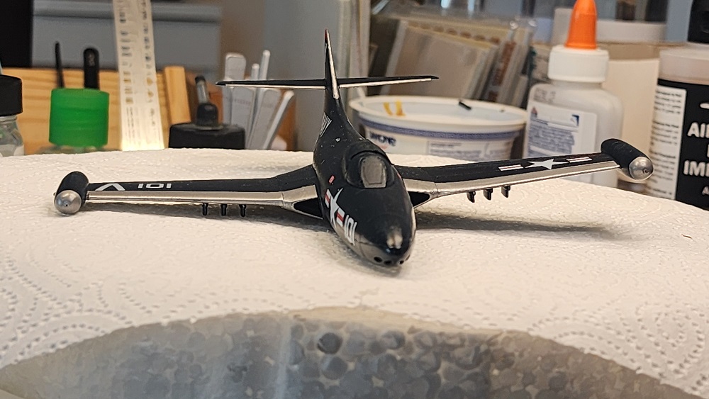

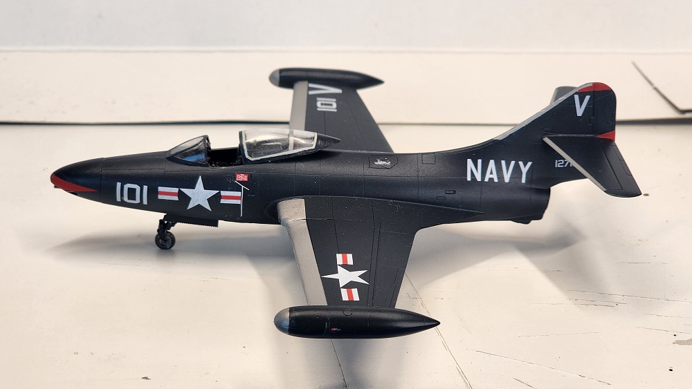

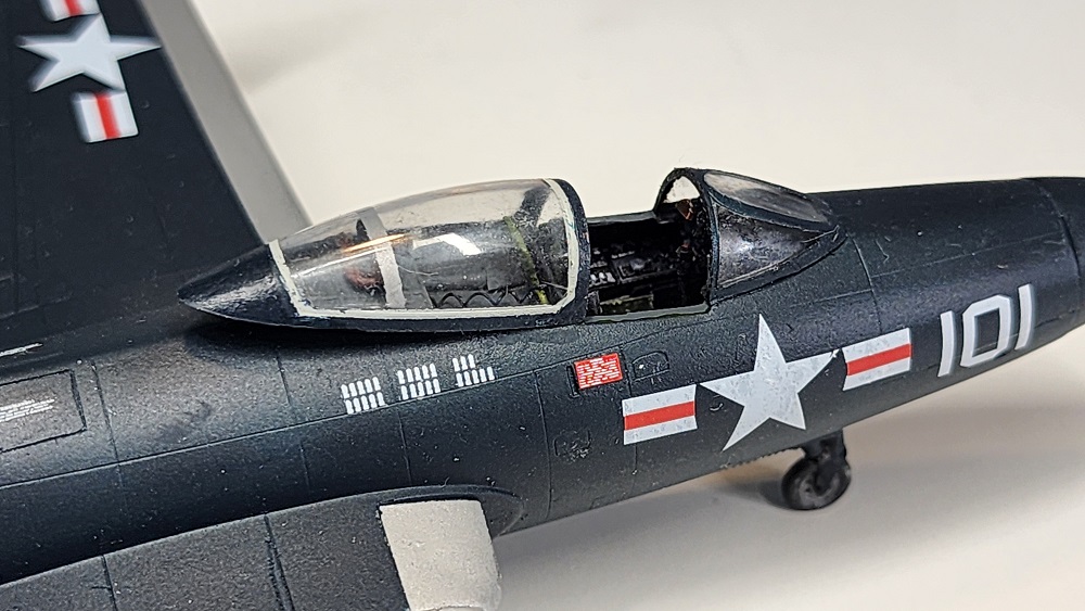

Decals are on, but there's a bit of touchy work still to do. The decals for the red nose flash fit terribly and did not look right at all. I'm going to have paint it. I have frisket paper, which should be pretty good for this sort of thing. The top line of the red runs along a panel line, which will help. So with a sharp blade and a bit of luck I think I can pull it off.
The next delicate step will be the thin off-white border around the canopy. I think I'll just seal what I've got so far with a satin coat and leave the rest to the weekend.
Though come to think of it, some bomb mission markings on the right side might be nice...

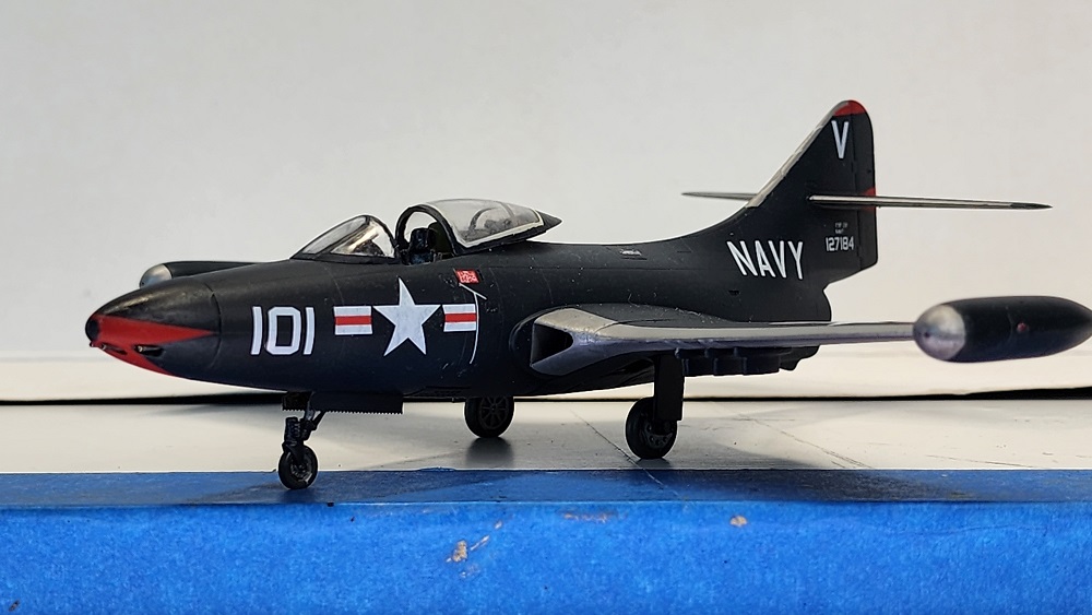

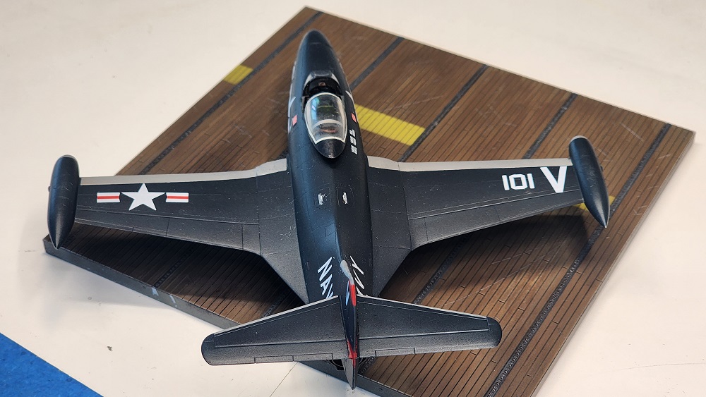

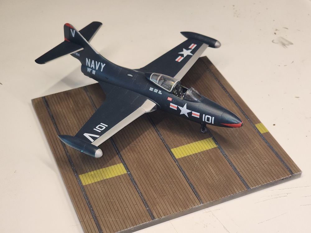

Finished! I was supposed to clean the house, cook, and go to the gym, but this is what happened instead.
I'm pretty happy with how painting the nose flash came out, less so with the canopy. The frisket paper left a lot of adhesive residue and I couldn't get it all off.
Next up will be a couple of aircraft carriers. CV-3 USS Saratoga, which will basically be a warm-up for CV-6 USS Enterprise.
