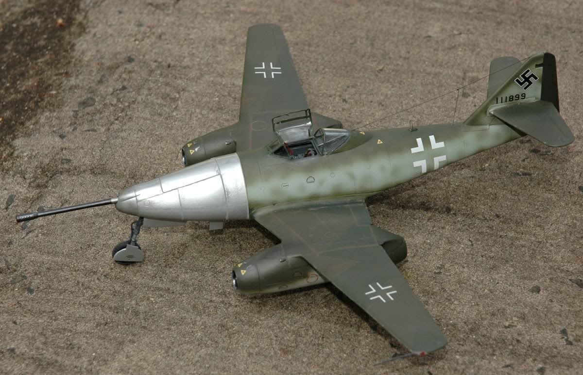

Dragon 1/48 Me262A-1a/U4

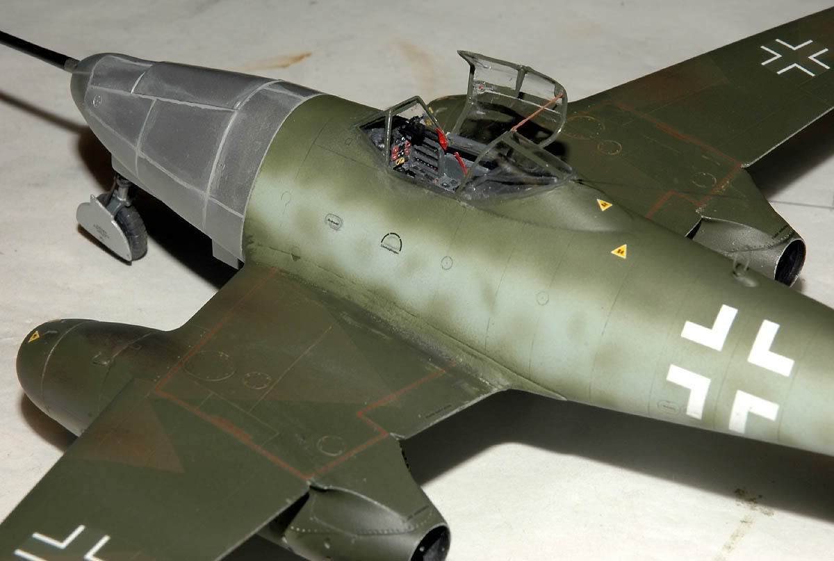

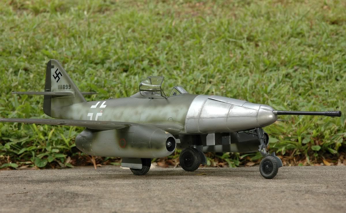

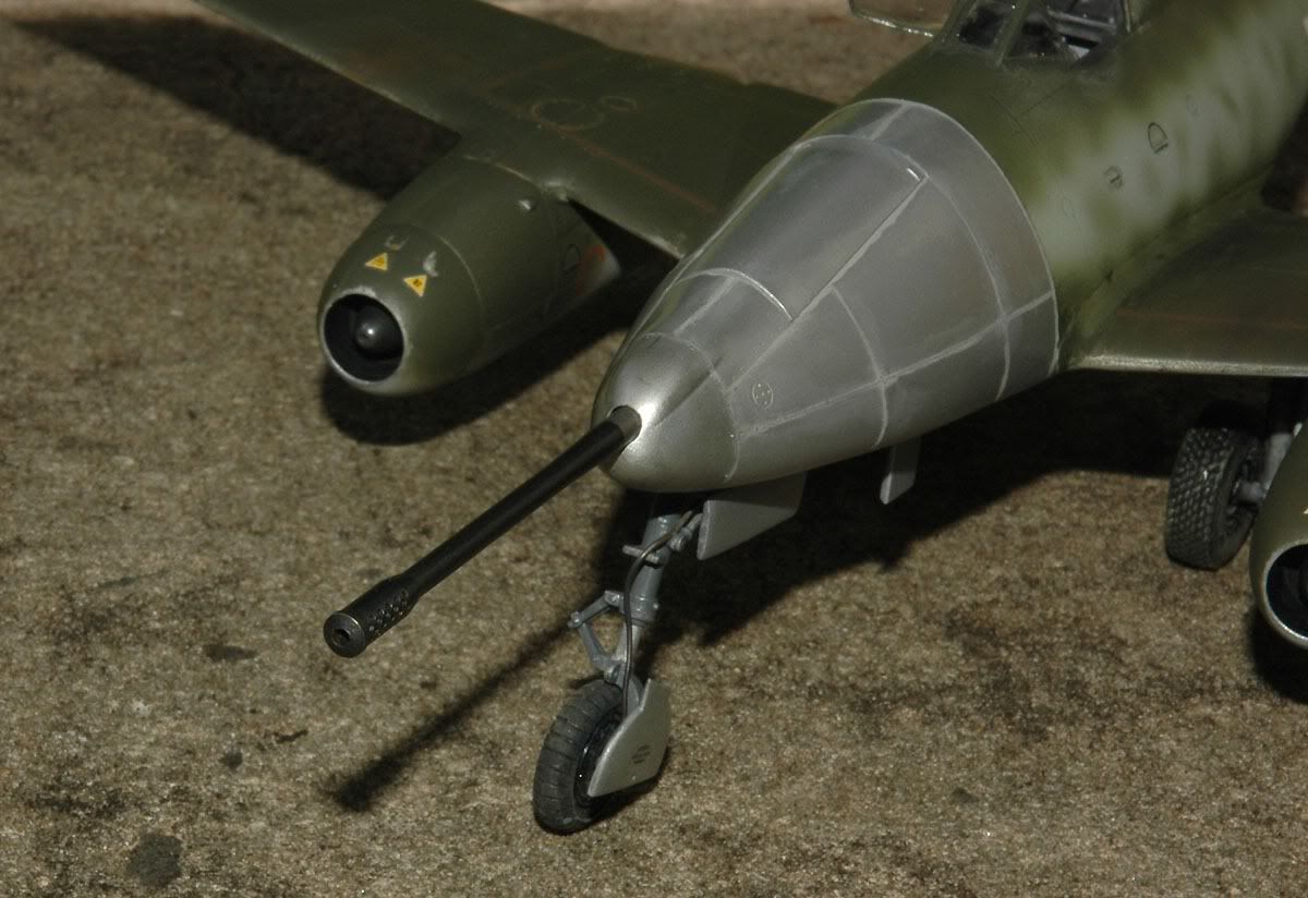

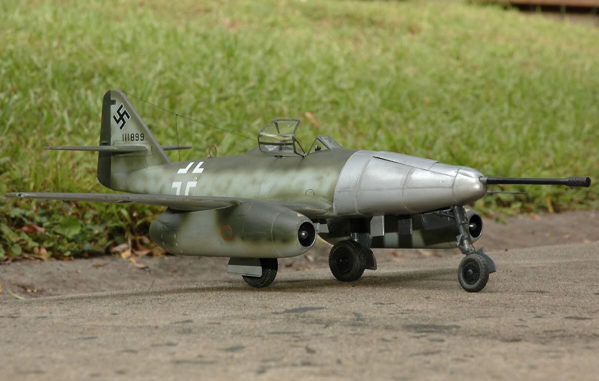

Thanks MP, the big question now is to leave it as is or flatcoat the NMF when I do the rest of the paint.
:unsure:
I'd leave it, I think having an opposing finish between the colors really enhance them. The NMF nose would not have been dulled would it?
Possibly the one and only pic that actually states this is Wrk 111899
(osprey aircraft of the aces 17 german jet Aces of WW2)
nosecone will be shaded darker as well.
In reply to the nose finish , I think that sanding all that filler smooth would have scratched the bare metal and caused it to turn dull very quickly ( my opinion only ). :fencing
Cheers, Christian B)
The unpainted metal would not stay shiney for too long, none of the unpainted Me 262s captured at the end of the war had much shine to them and looked like they had more of a dull finish than a shiney one.
Matrixone
Hey Bob, just my opinion again but I'm thinking that there was little metal that escaped the sanding ( if any ) . The aerodynamic sealer probably had to be planed so as to avoid wrinkles.
The paint itself ( so I read ) no longer met RLM standards late in the war since they were running out of pigments and other materials that are used in the mix. I have seen colored pictures of captured 262 that just looked completely washed out.. I don't think this airframe had the poor quality paint applied to it on the rear section. It had probably been around for some time.

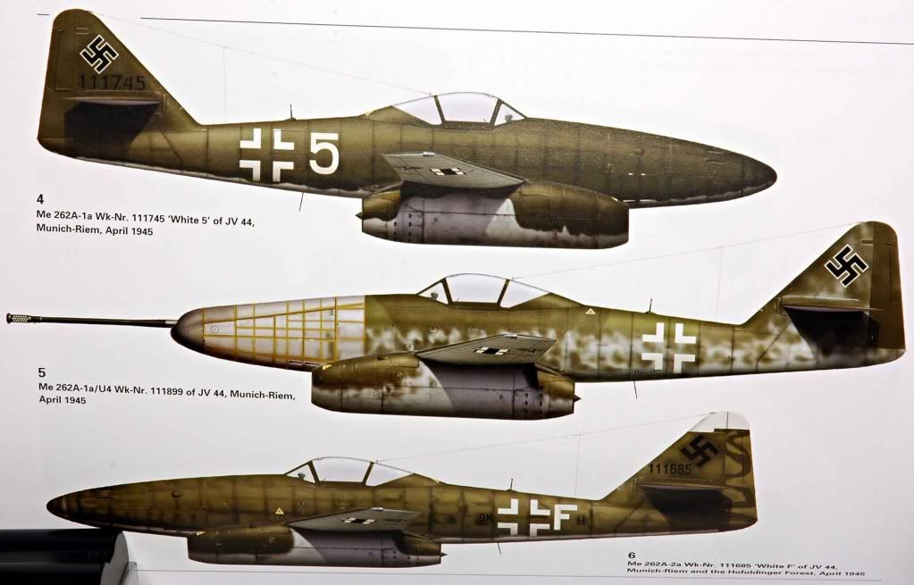

The pic is from Osprey aviation elite units Jagdverband 44 Squadron of experten.

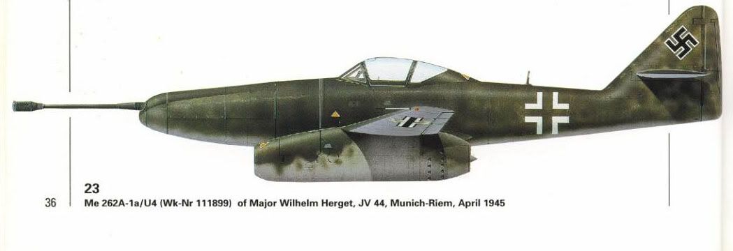

I was going by this plate as how is was painted when at JV 44
* * the book plate states, * *
111899 painted in a std late war splinter pattern and mottle combo over the main airframe, it appears a replacement rudder is fitted poss in 80 or 83. (Note: the kit gives two rudders)
The specially fitted bare metal nose section housing the mechanism for the Mk214 was patched with filler paste, and the actual panels housing the barrel appear to be of a different metal to the rest of the nose cone. * *
Unfortunately there are no more photos of 111899 to show what actual scheme it was painted in either full or the ''new unpainted '' nose section when with JV 44, only other reference I have is this one but I think it is a guess? or what it may have looked like

then there is this color plate

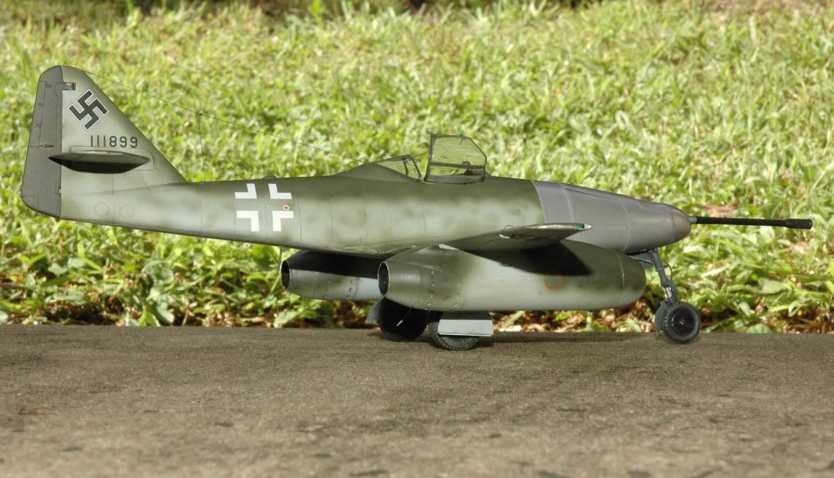

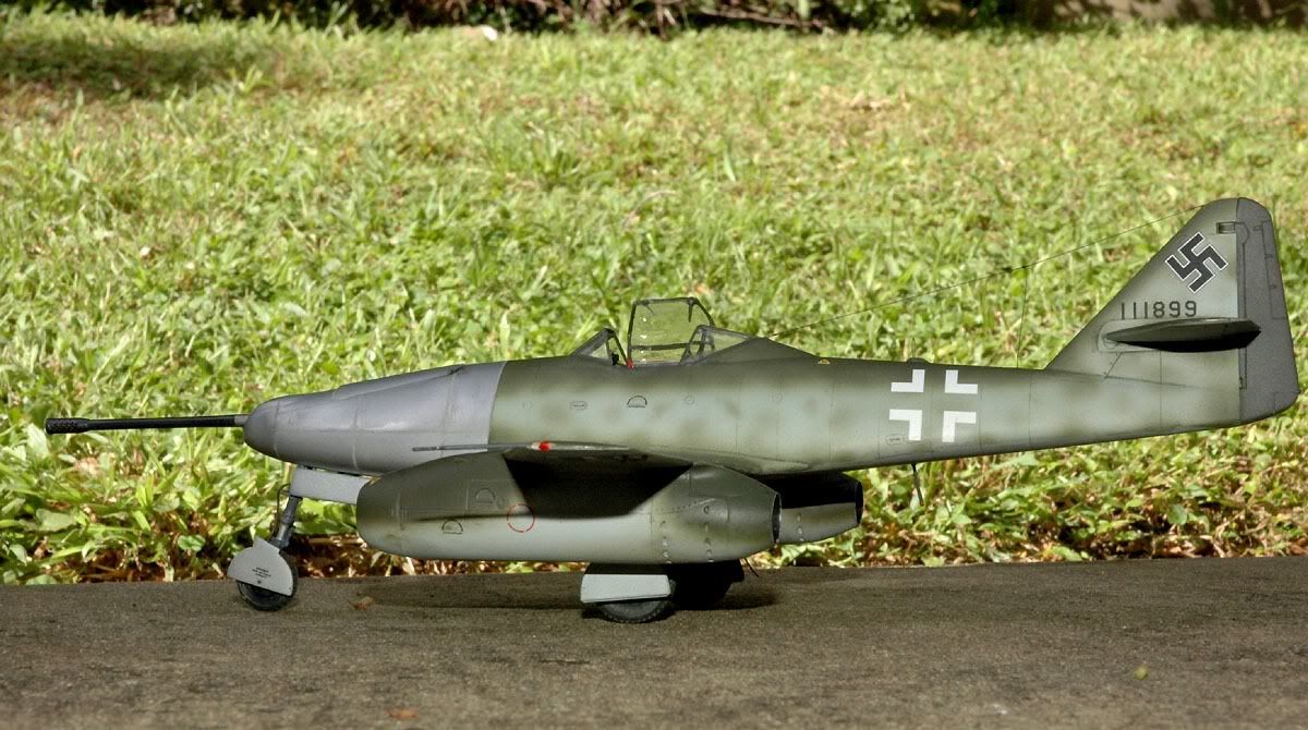

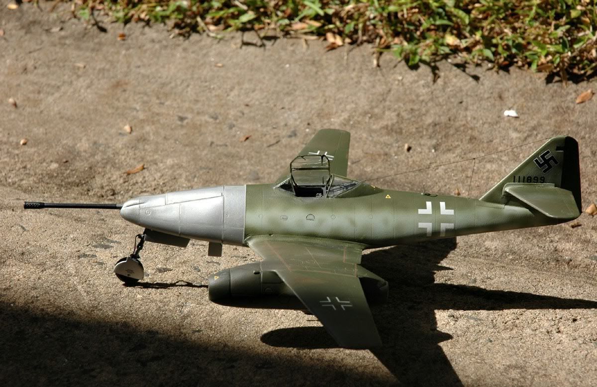

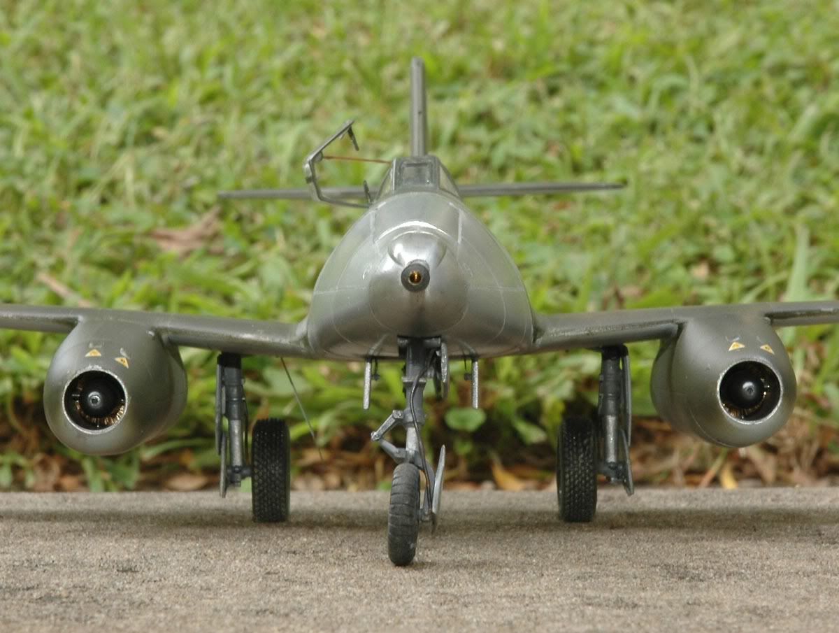

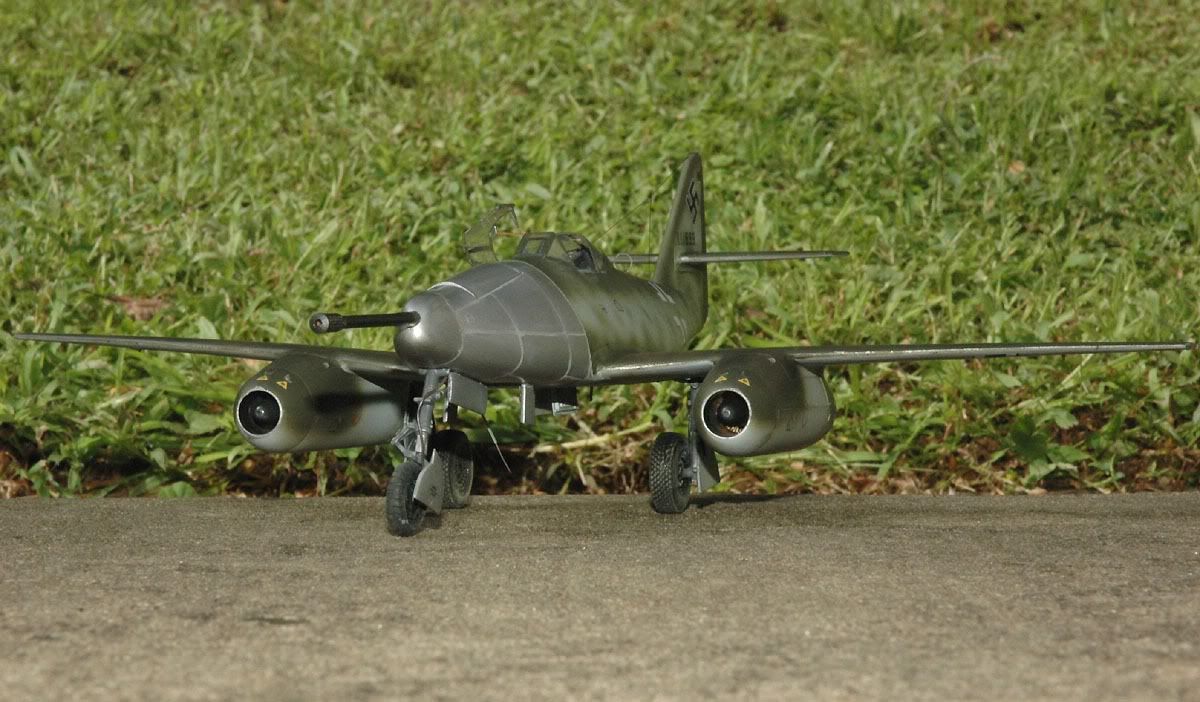

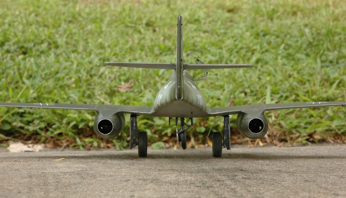

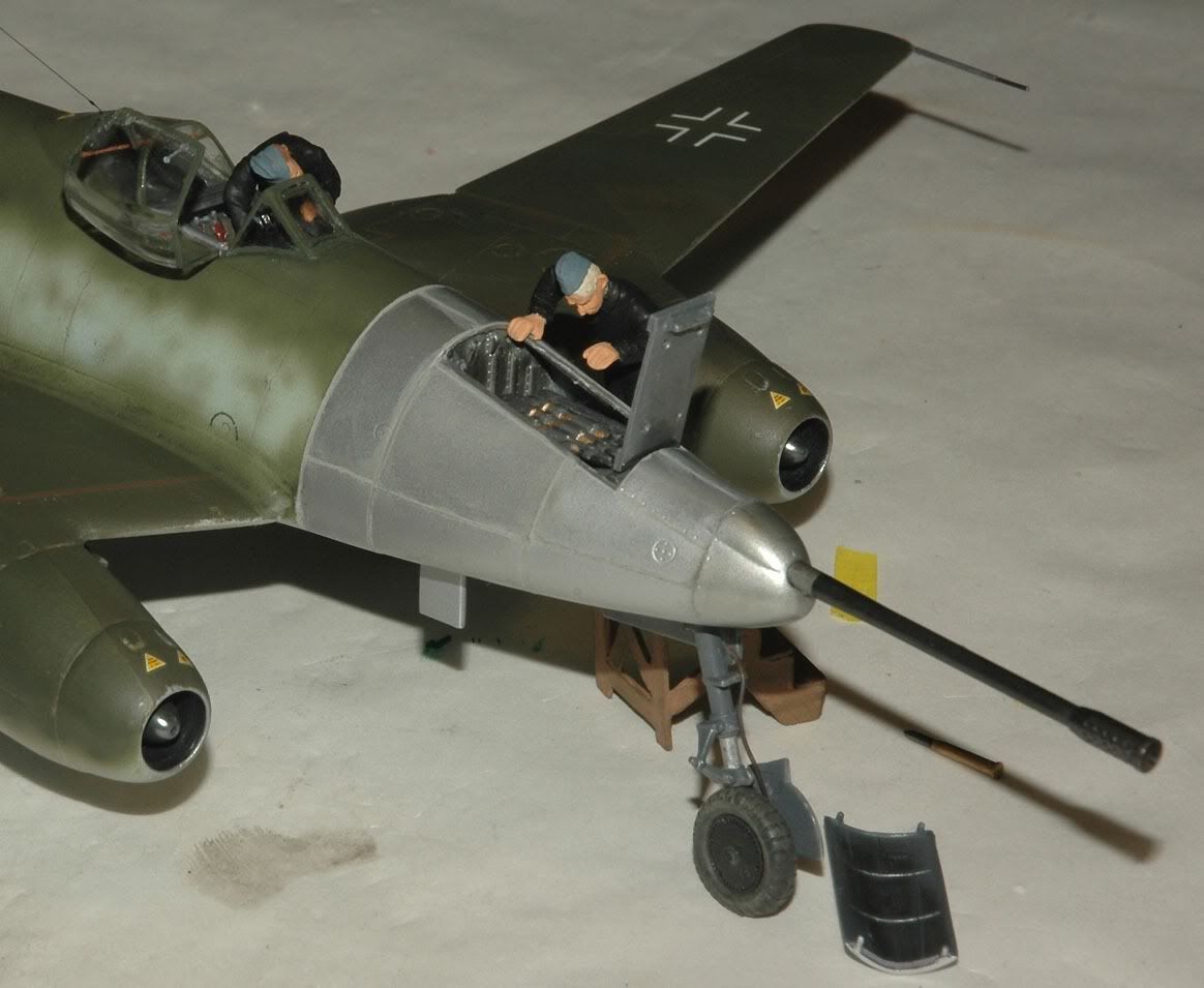

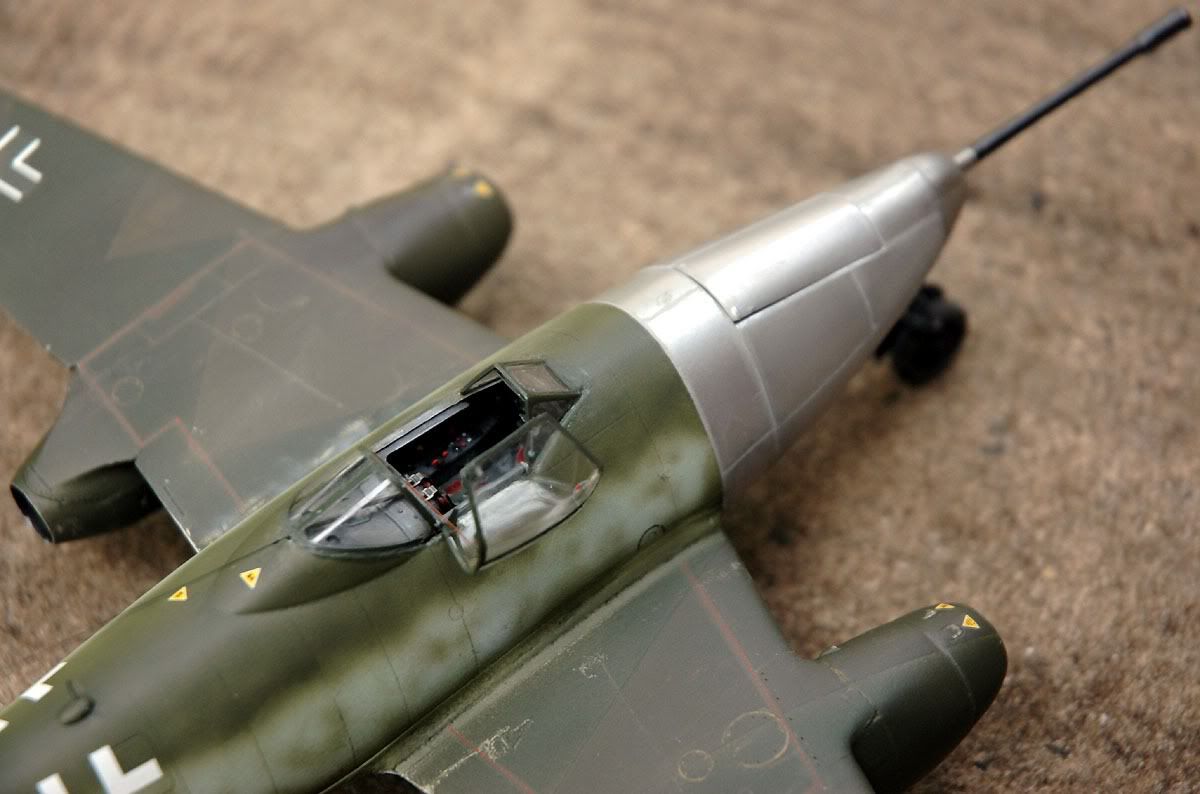

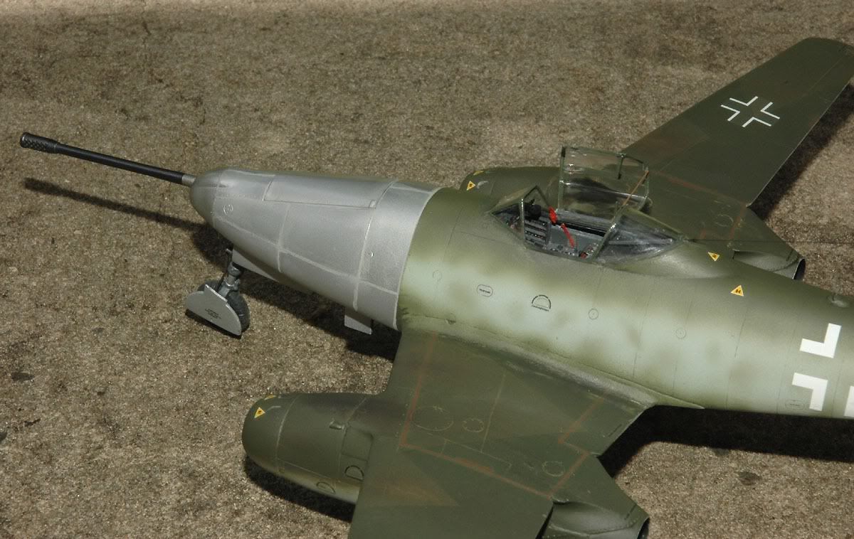

well I was at the end of the build, the sweet realisation of completion, time to fit the canopy to make this bird look like it should - so what do we get, place the front canopy section, place the rear canopy section, now place the centre opening section - and we have a 1/16th gap between the front and the rear of the centre piece to the corresponding canopy sections - Very Nice - NOT!
While I enjoyed this kit from Dragon, can't fault the inbox details, love the opening cannon cover, the fit was tricky to say the least, there are four major faults with it counting the canopy, but I'm not pointing them out so your eyes won't go to them, but you do now know about the canopy, oh there is another fault with it being a touch narrow..........
camouflage

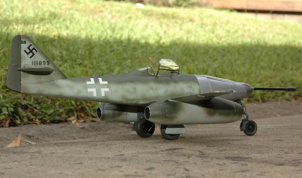

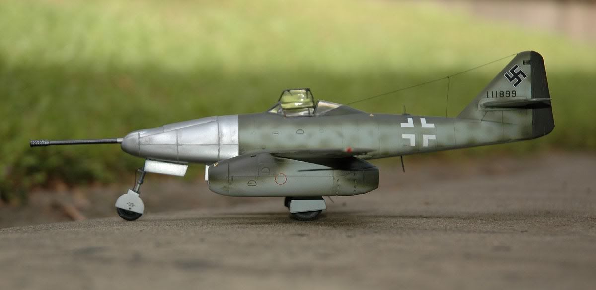

Hope you liked these pics - Aperture F25, Shutter 1/3 White Bal Cloudy, Flash - slow
I made the decision not to flat coat the nose section because I did not want to take the chance of a possible disaster :)
Home base!!
Well inspite of any troubles you may have had this is still a slick looking bird. Well Done!!
B)
The bird came out quite nicely. Probably a good decision to skip that step and avoid possible problems.\
