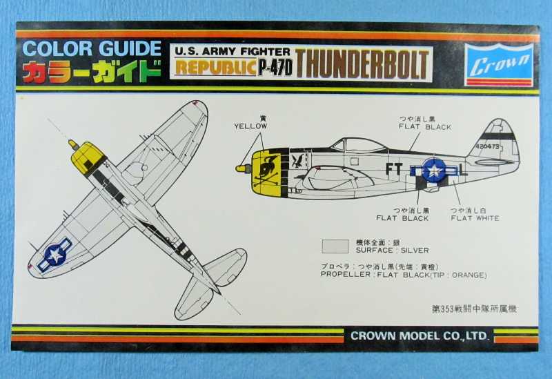

The Crown P-47 Thunderbolt kit.

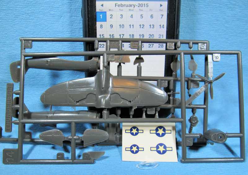

A time stamp:

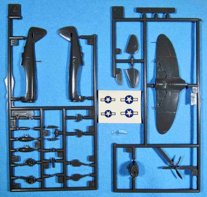

Kit parts:
Color scheme = NMF
Instructions are in the box - literally:

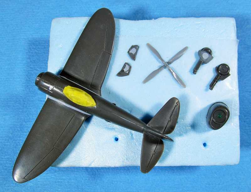

I figure I can delay some other builds slightly and rip through this pretty quick. Then again, this is my first Crown kit. :D
A 3 BLADED PROP!? :blink I guess it is the "running" version then? :D
Back in the day, I'm sure Crown standardized a 3-blade prop for all their kits. There was likely a few modellers who felt suckered by the box art and included scheme profile, compared to what was in the box.
Luckily, I was gifted some proper Platz decals and repairable 4-blade from their P-47 kit.

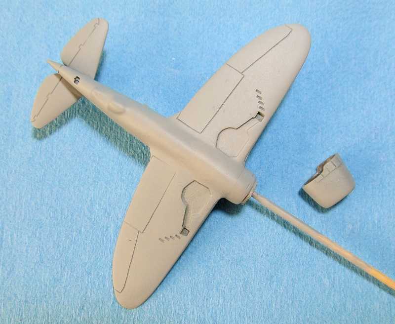

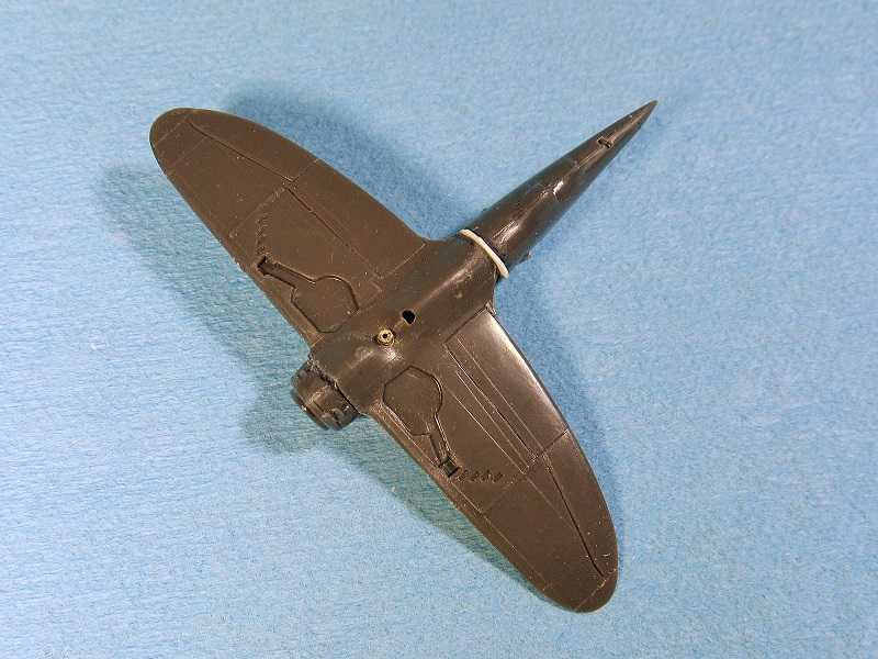

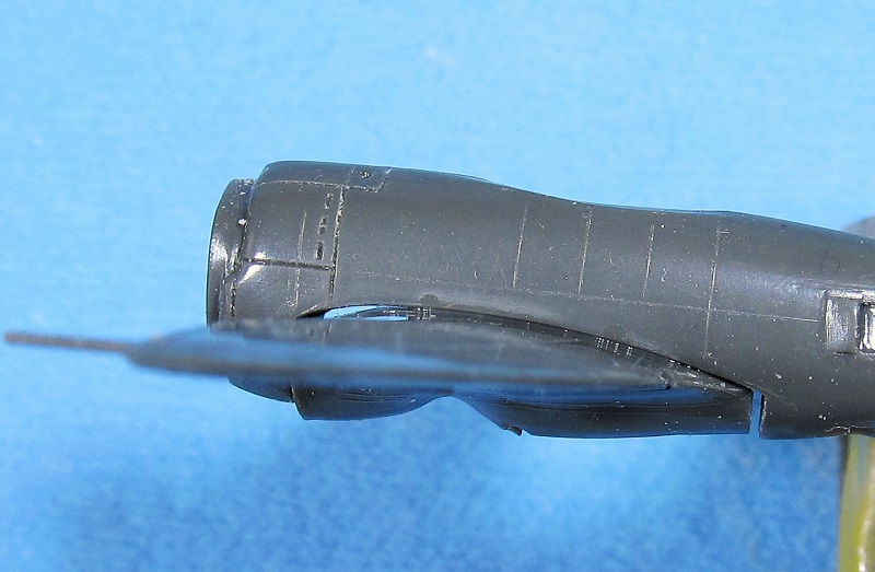

Some parts were glued together, and it looked ok from above:

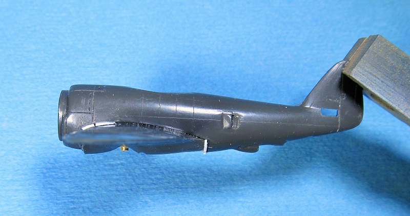

There were huge gaps, though, and it came with that odd depression on the lower fuselage:
So I started filling with styrene and blister-pack cuttings, and put in a brass deadman into the depression to anchor some milliput.

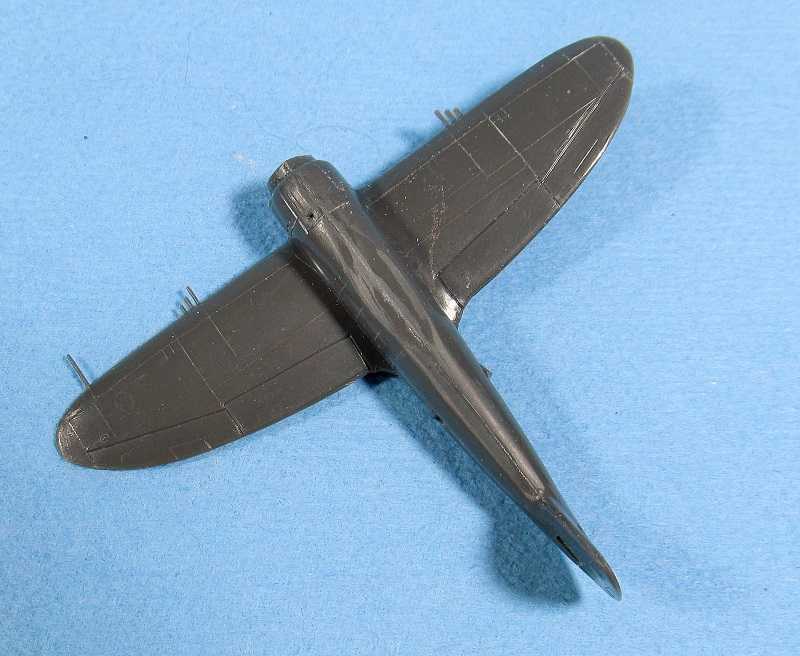

An Underneath view:
A blob of milliput was pressed into the depression:
And thus ended my session. Waiting 24hrs for the milliput to cure before I sand to shape. Then it's filling the rest of her with putty and Mr Surfacer. :D

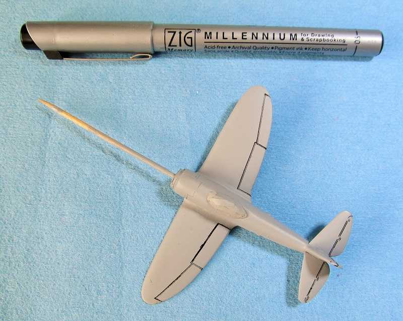

Remember that big, ugly dip damage that was so obvious on the bottom of this tiny model.
I fixed it up, somewhat acceptably:
Primed:

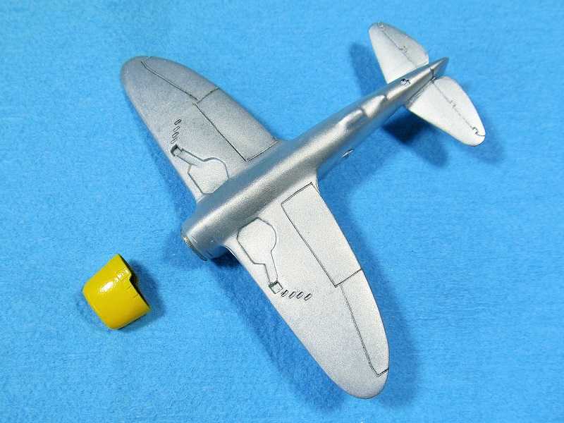

Thought I'd try the pen trick shown to me by another modeller. It's mostly an experiment:

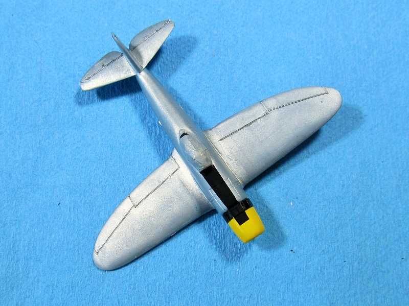

A little bit of yellow; a little bit of Alclad airframe aluminum:
:D
Thanks fellas.

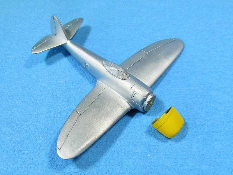

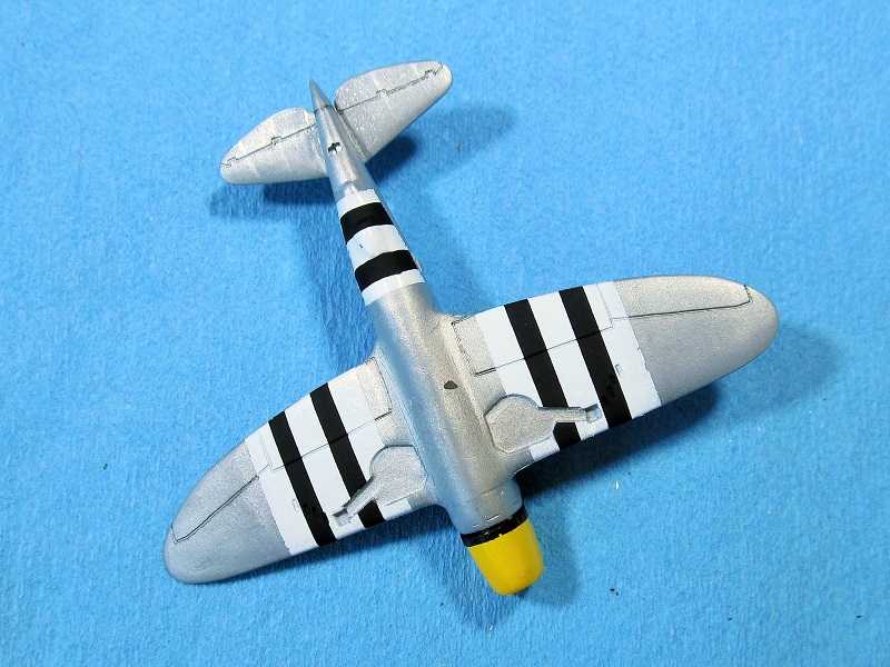

I actually thought I'd get more paint peeling and problems when I removed the mask than I did. Frankly, I'm quite happy with the way the invasion stripes turned out:
Going to wait a day, then wipe her down and touch it up. :D
