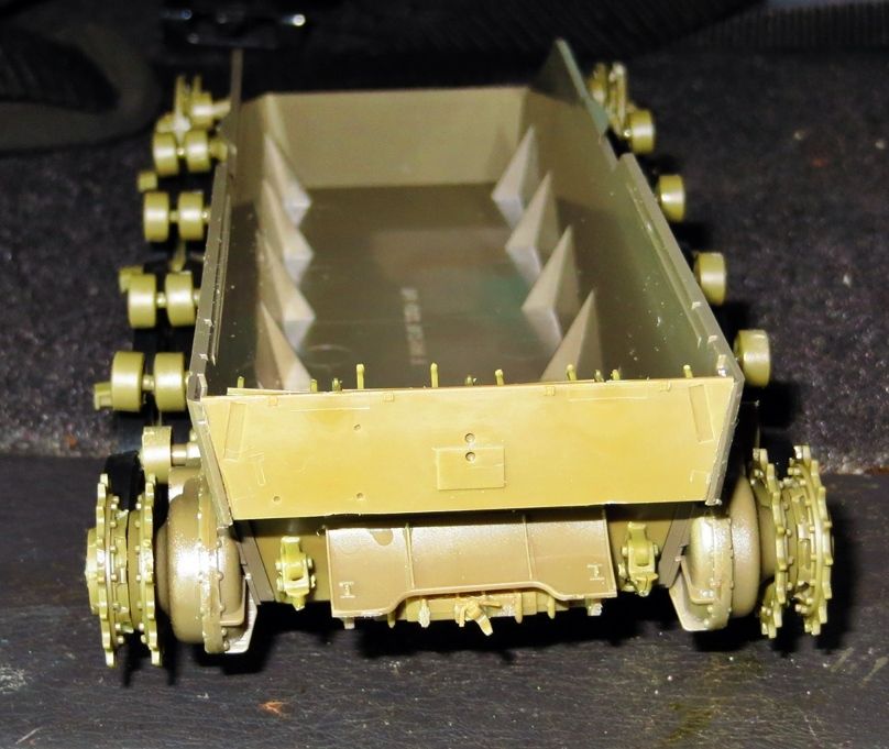

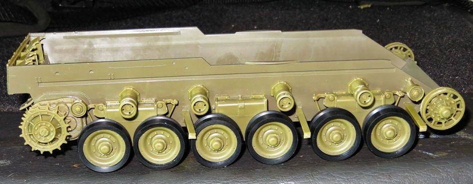

Thanks Bob.I like the road wheels,etc to rotate,as it is easier to paint them. These poly caps fit real snug over the nubs and inner road wheels. But they are too wide to fit into the holes on the insides of the outer road wheels and outer idler wheels. Never will understand why AFV Club never bothered to fix that. :idonno
They are hidden Peter. But they k make them too wide for some reason. I took each poly cap,put it on a 3/32 inch drill bit,then trimmed the outside of the poly cap so it would fit inside the hole. Once that was done,then the outer road wheel was glued on.I never understand why polycaps are used on a static model.
Looking good Chad![]()
AFV Club could use hidden poly caps that go BETWEEN tthe road wheels. The cap would fit inside the inner roadwheel and be held there by scementing theouter roadwheel to the inner one. That'd make things much neater looking and remode any possibility of a gap between the poly cap and the wheel hub.

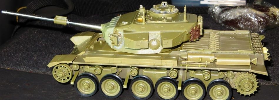

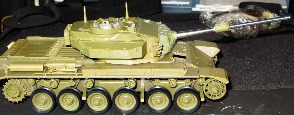

She is getting there.

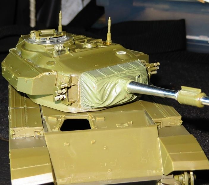

Now for the part that stumps me. As you can see,the number 3 is on some sort of cloth. However,the decals are not set up on a cloth. I am not sure what to use for the cloth.
Thanks for the tips everyone. :drinks
Inquiring minds wan to know; was that cloth thing an identification panel?
Cheers from Peter

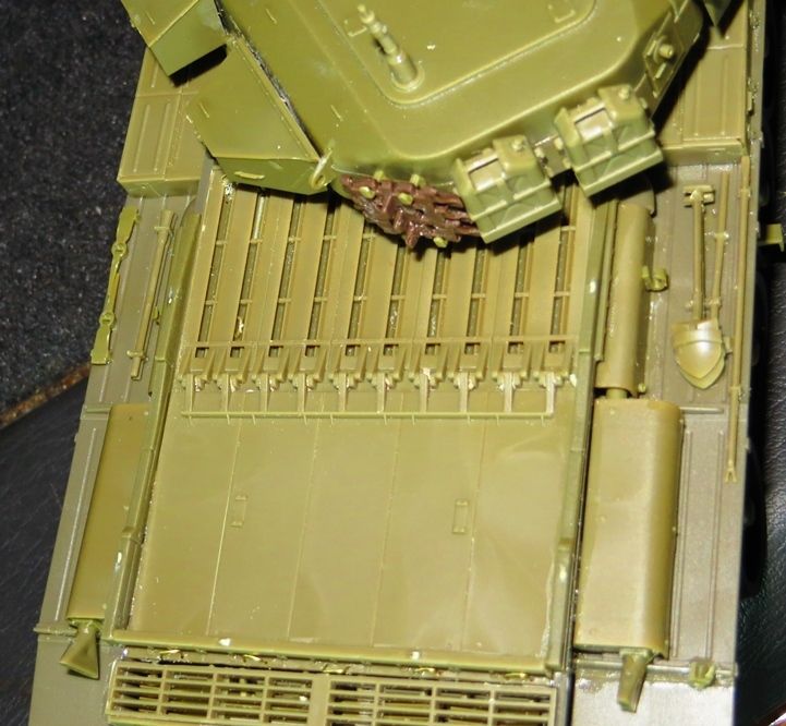

Thanks. Sadly,I had to shelve this,as the front fenders are out of whack.![]()
