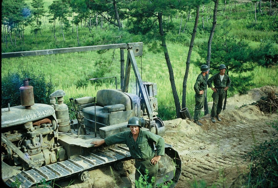

Good catch John, I don't think the one I'm working on has electric starter on it either. Presuming you're looking at the cylinder thing above the pony motor?
The oft cited Korean dozer my Father was so interested in. That's him standing next to it.
So how did they start the pony motor without electric start?
You used a hand crank, Bob. That shaft sticking up through the hood on the left is where the handle fit. Those suckers had a real kick, you soon learned never to wrap your thumb around the handle. On some tractors the shaft went straight forward and through a hole in the lower radiator tank. The early D-8's were the same. Yes, no electric starter on that one. You can't see the starter crank shaft in your photo, but it is there on the model picture, braced to the radiator.
