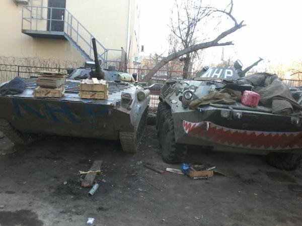

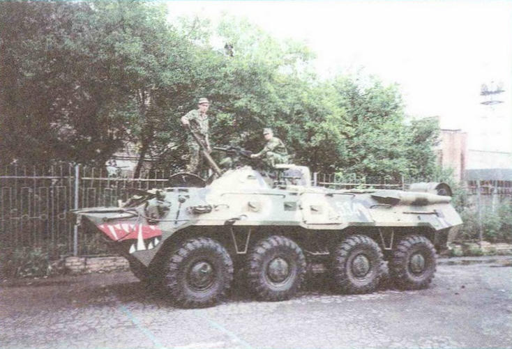

Think I will do this one. Nice and simple.
From the Echelon sheet D356208 Ukrainian AFVs Part 5.

Oooh Sauls going to be all over this one

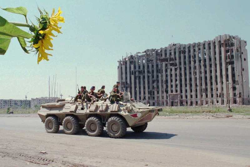

Thanks for the pics Saul. Do you need the decals? I am probably not going to do more than this one and I think I have all the decals. Let me know and I can send this week.
