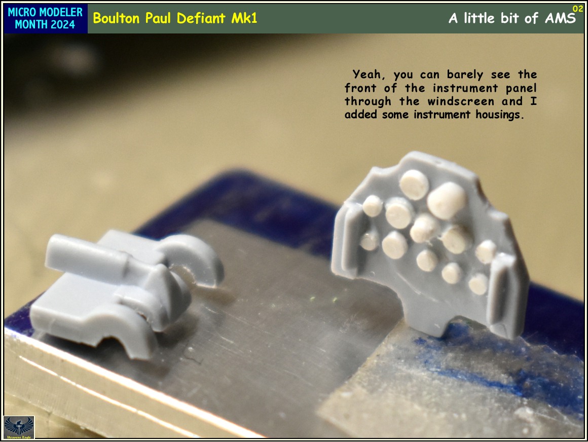

You just KNEW that I HAD to modify SOMETHING right?

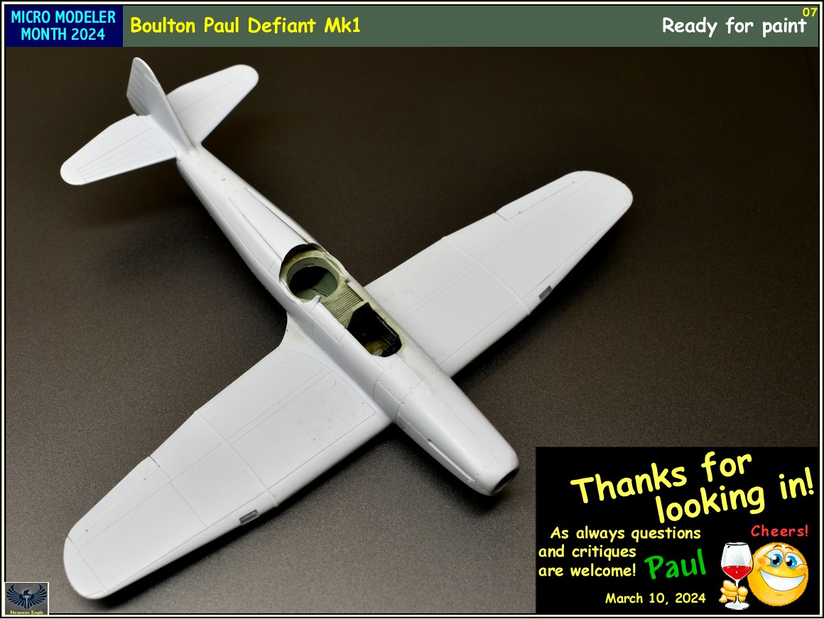

Probably could have gotten the paint on it today, but just could not get motivated. Sometime this week the paint will go on the outside. Plus I have some more AMS coming in so be advised.

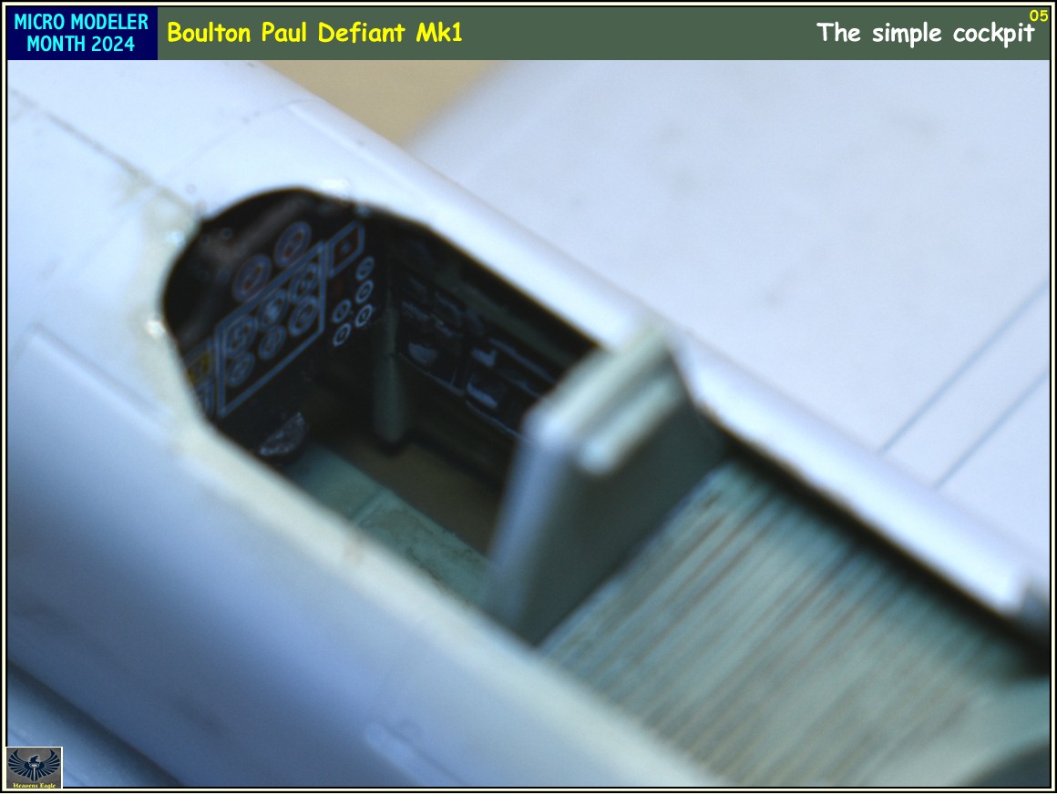

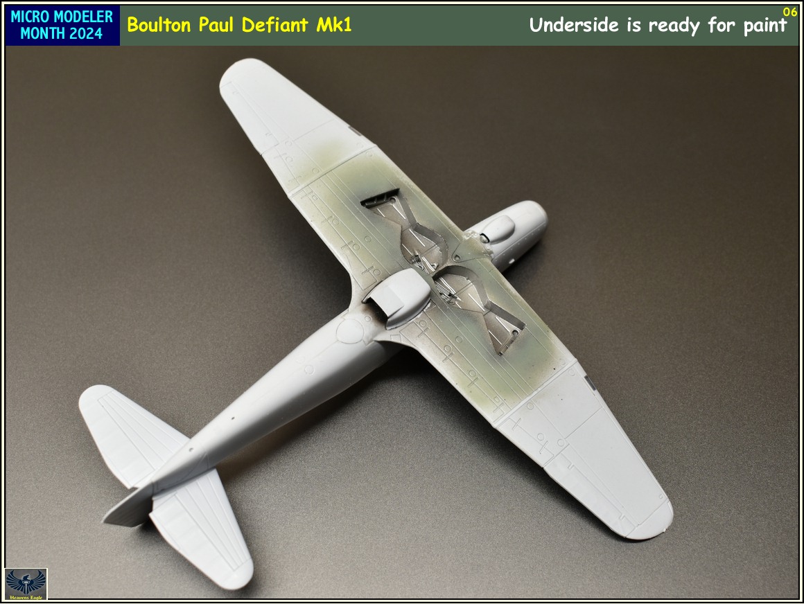

Otherwise the fit of the parts has not been too bad. I did clip off all the locating pins as they were forcing some misalignment. Have just used a little CA on the seams to get things right and then away it went. All I needed to do was some prep work to get things to line up.
I am keeping plugging away on this one. It does seem to help my build speed a little bit to do these quick builds that are time sensitive.

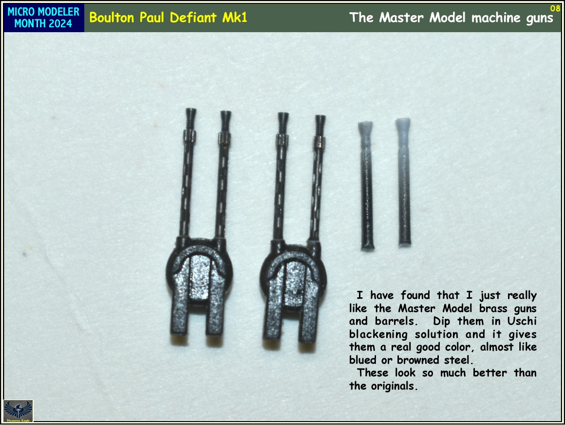

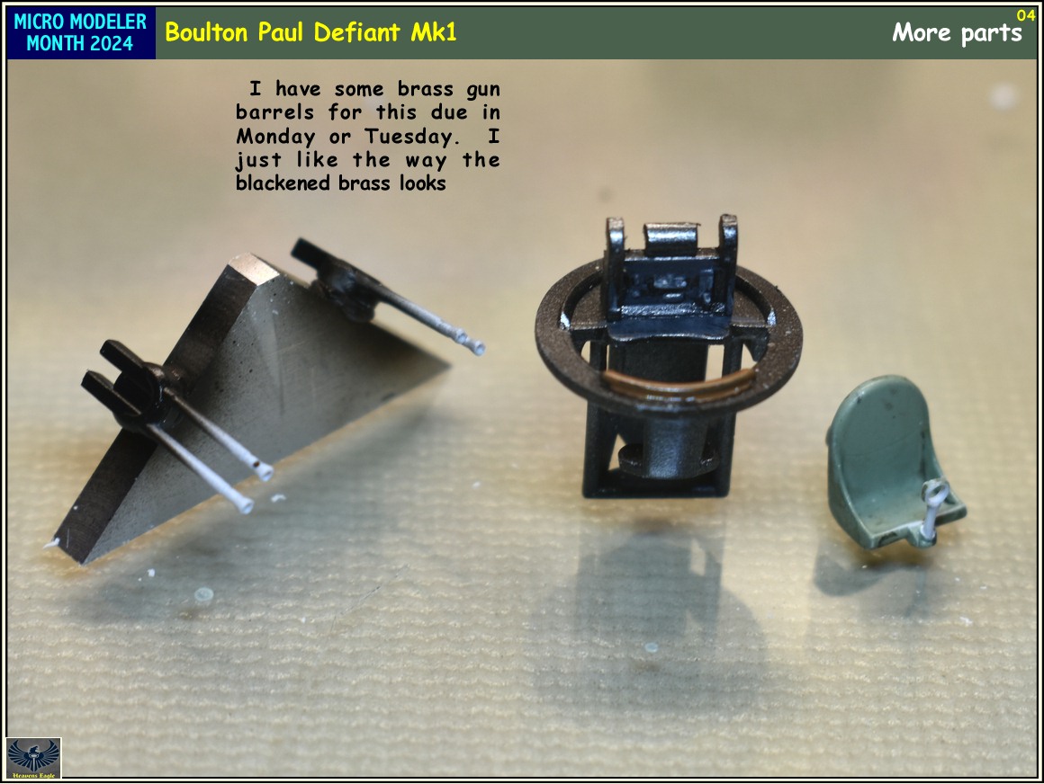

I had to drill some .023 dia holes for these barrels and they are only .3 inches or 7.6mm long. It was a trick getting them aligned and the holes centered.
The fit on this kit is fairly good. I think I only used a couple of tiny spots of Green putty and could not tell you where those were now.

Thanks for looking in Alex! There used to be some specific PE but it is discontinued and I just did not feel like doing a deep search for any. I ran across the machine guns while looking around on Free Time Hobbies, but also didn't want to spend more on the aftermarket than I did on the double kit.

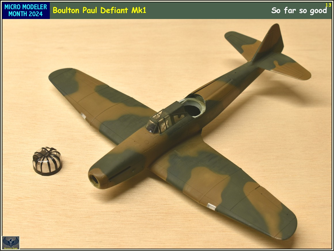

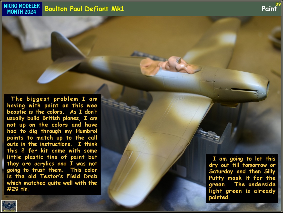

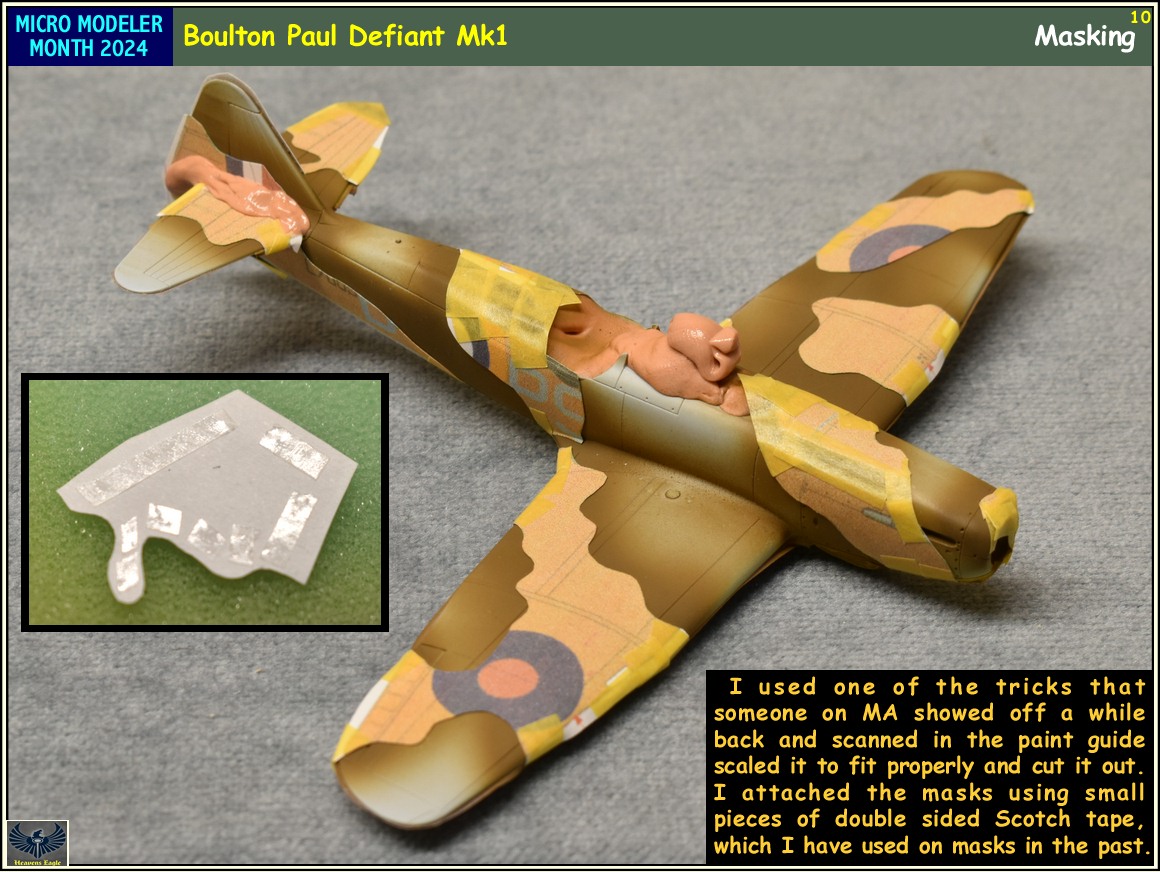

Still plugging away. This one has become an experimental. Experimenting with colors for British. Experimenting with weird masking on the tiny turret and canopy. Experimenting with masking, and experimented with making some seat belts that I printed out.
It's all going so-so, but it isn't looking bad.
Here is an update.

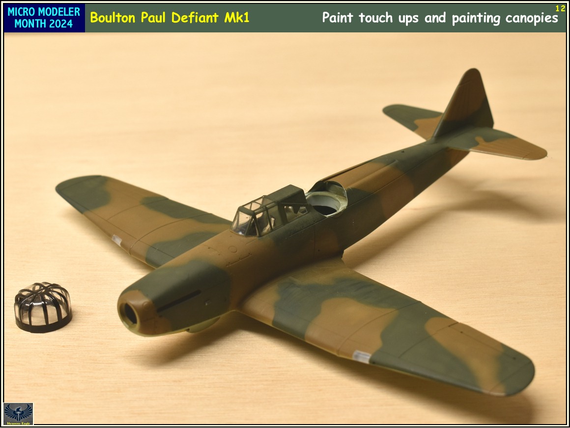

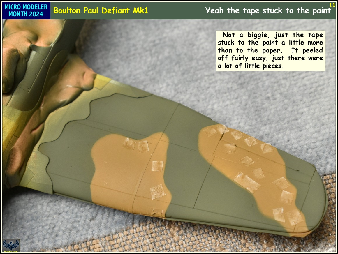

Had a lot of problems with the paint getting it to spray and didn't get the brown coverage over where it was supposed to be in some spots. Thus I needed to do some more masking and touch up. Ended up giving the paint that patchy look which will probably disappear when I flat coat it.
I was not impressed with the canopies. The detailing was quite soft and thus it was a royal pain in the can to mask.
