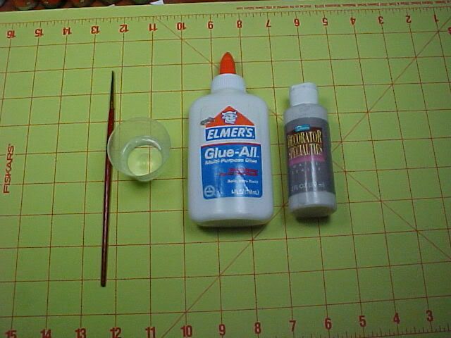

Here is the list:
1) Water
2) PVA Glue
3) Acrylic Matte Varnish
4) A Pointed Brush (I use a #1 round)
5) Mixing cup

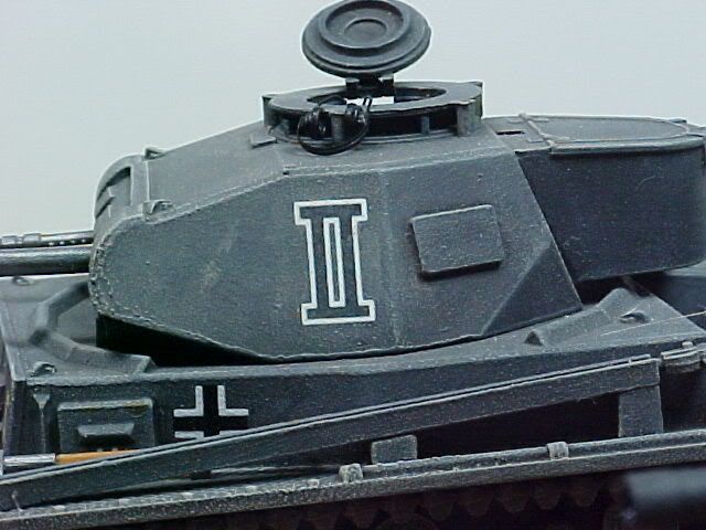

As you can see the decals are totally flat and there is no evidence of silvering whatsoever. :thumb:

Here is the list:
1) Water
2) PVA Glue
5) Mixing cup
