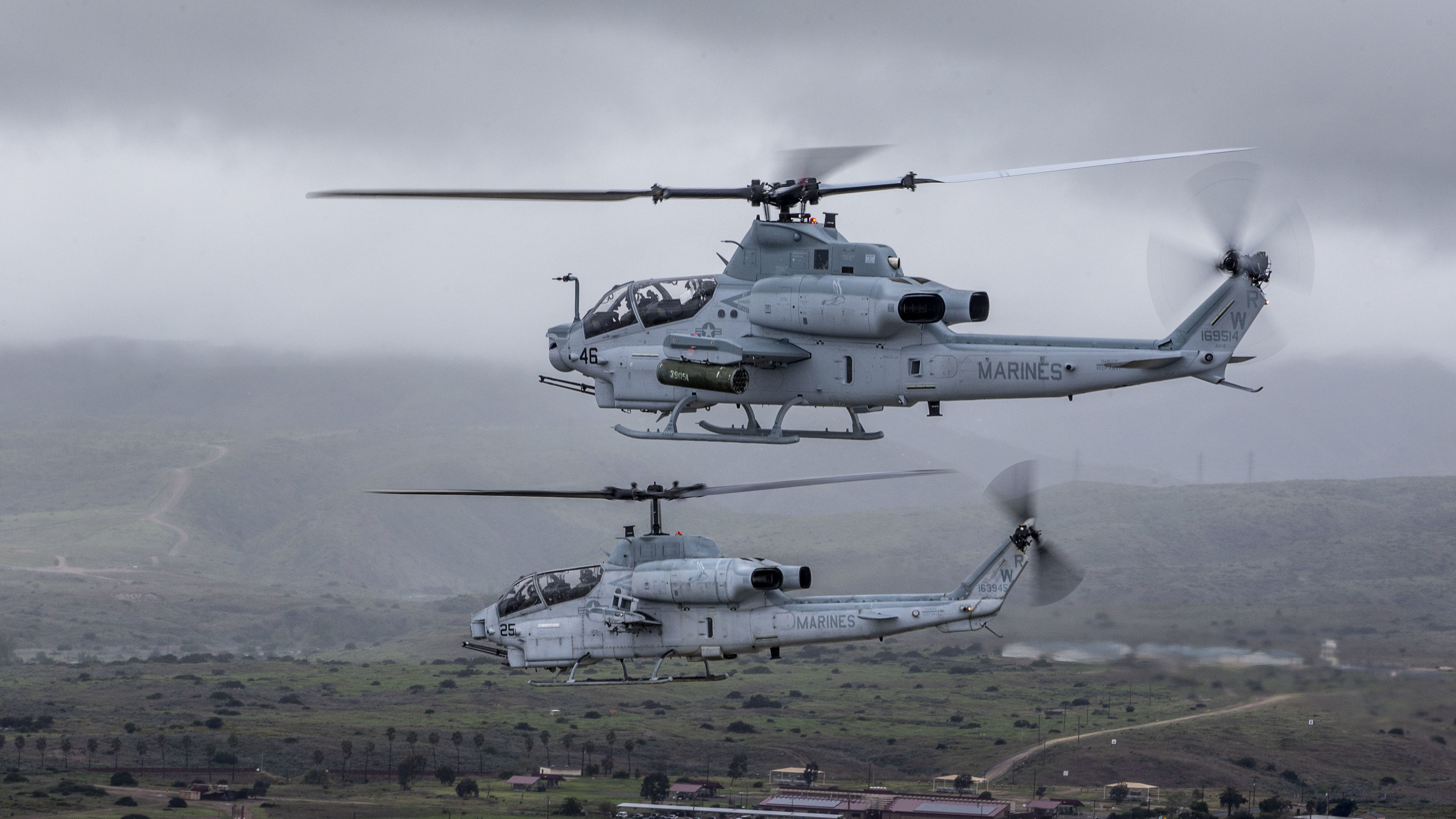

Copied this text from a web page, the photo if I remember right has one of each.
AH-1W Super Cobra-
Dual Blade Main Rotor and Tail Rotor
Max takeoff weight: 14,750 lbs
Range- 317 nmi
Engines: 2x GE T700–401 Turboshaft: 1,690 shp each
Max Speed: 190 knots
Number of Hellfires carried: 8
AH-1Z Viper-
Quad Blade Main and Tail Rotor
Max Takeoff weight: 18,500 lbs.
Range- 370 nmi
Engines: 2x GE T700–401C: 1,800 shp each
Never Exceed speed: 222 knots, in a dive.
Number of Hellfires carried: 16

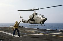

AH-1T
AH-1J SeaCobraOriginal twin engine version.AH-1J InternationalExport version of the AH-1J SeaCobra.AH-1T Improved SeaCobraImproved version with extended tailboom and fuselage and an upgraded transmission and engines.AH-1W SuperCobra("Whiskey Cobra"), day/night version with more powerful engines and advanced weapons capability.AH-1(4B)W Viper"Four-Bladed Whiskey" test version with a four-bladed bearingless composite main rotor based on Bell 680 rotor. A prototype was converted from AH-1T 161022. This was taken fronmWikipedia. Hope it helps. Gary S. XLV MMXX

AH-1T
Thanks, Gary. I contacted Werner's Wings about the two Academy kits, the T and the W. According to Floyd Jr. the kit is essentially the same and was marketed as a T+ as well. What I was concerned about was if I could use W decals and scheme to complete the kit. I guess I coould do anything that I wanted but I thought it best to seek some info.
