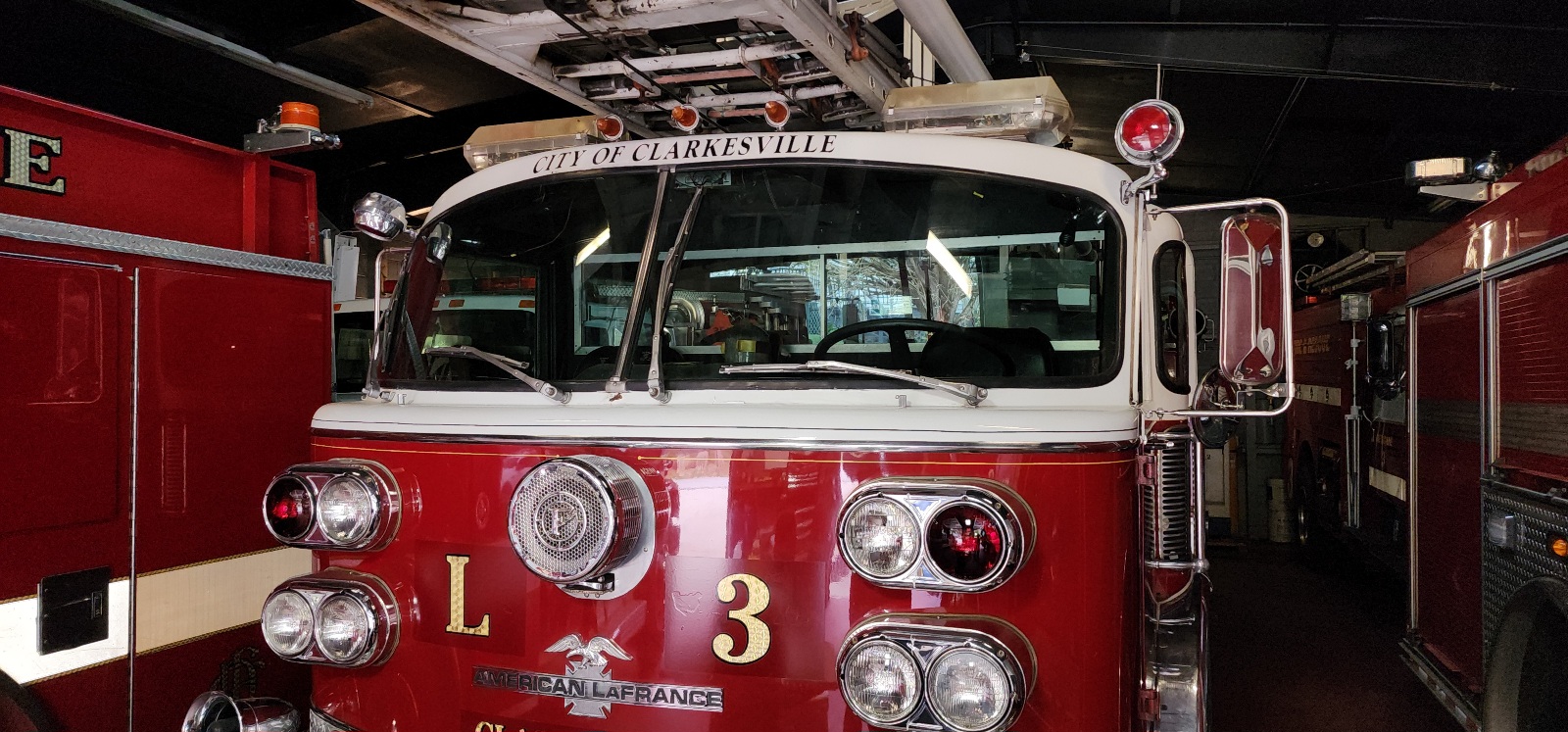

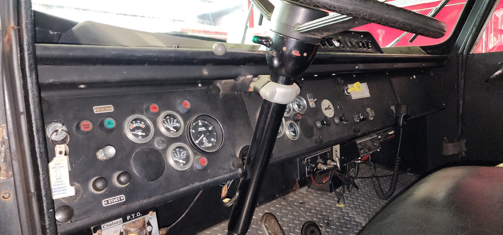

OK, I took photos of the Clarkesville ladder truck. COMPLETELY different in EVERY way from my model other than they both have tires. Still, I will try to add some features to "Clarkesville" it up a little. Here is the front of it...

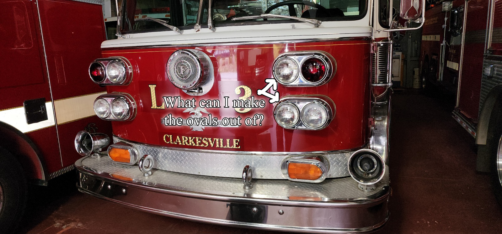

Here is the front of the model...

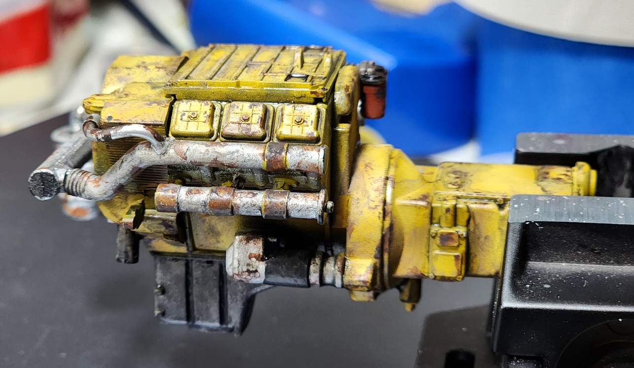

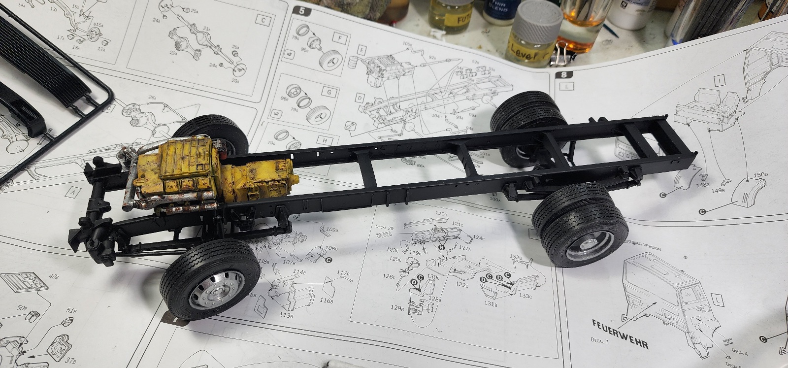

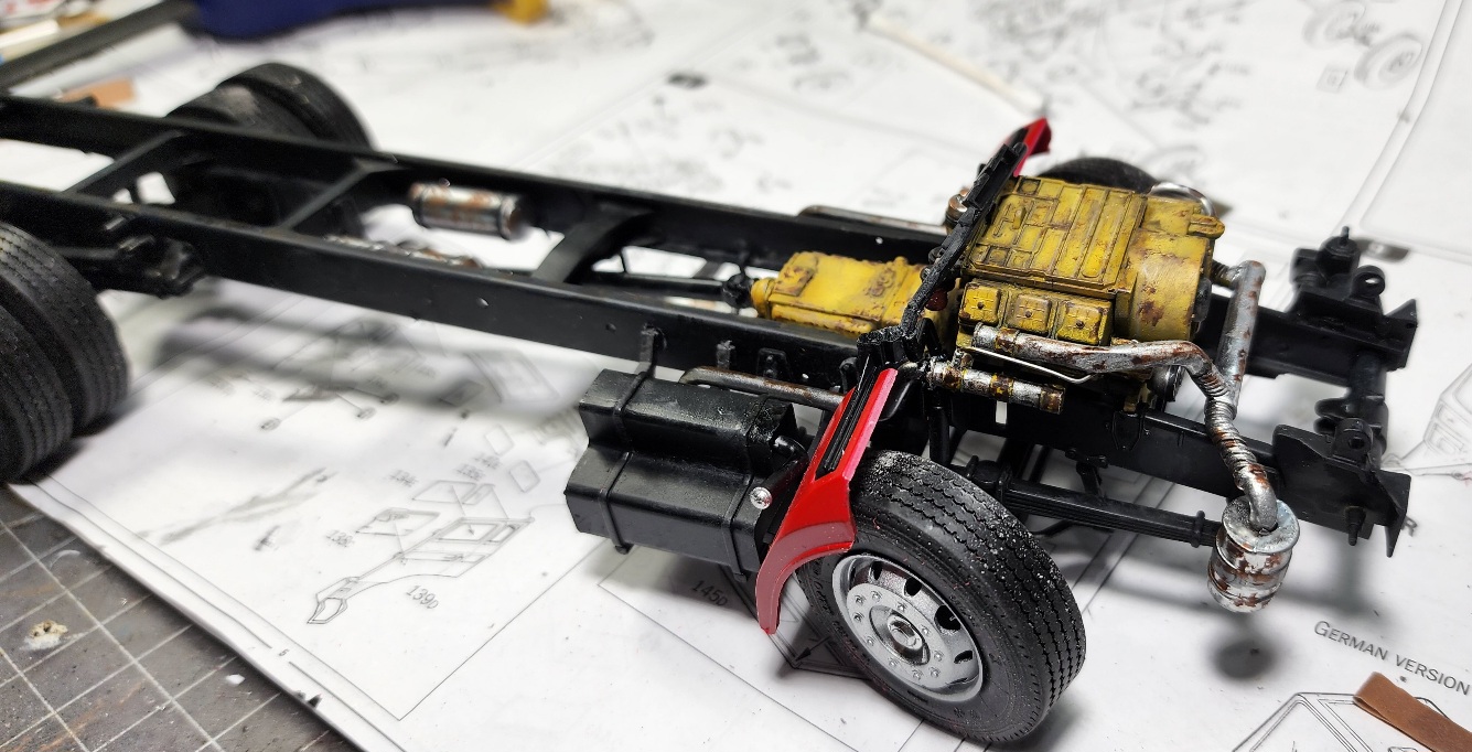

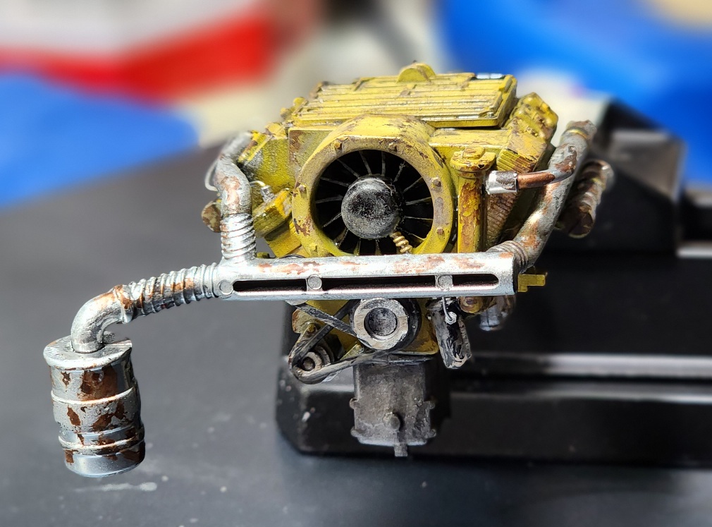

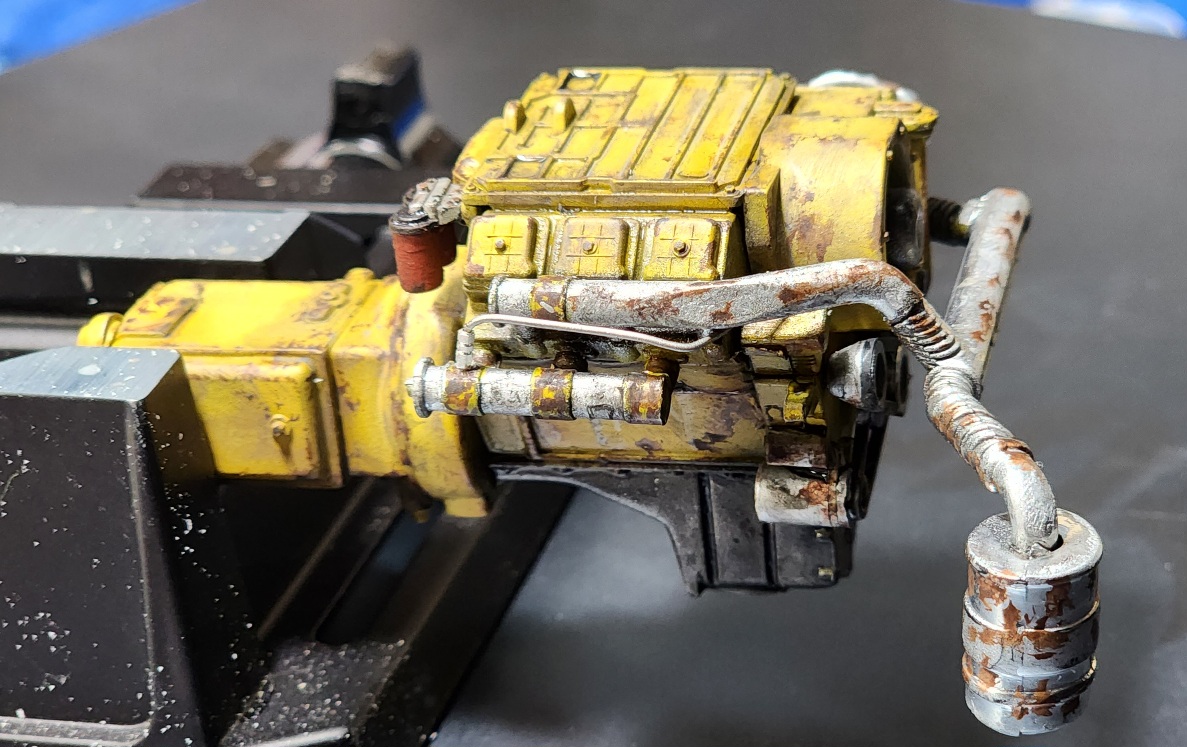

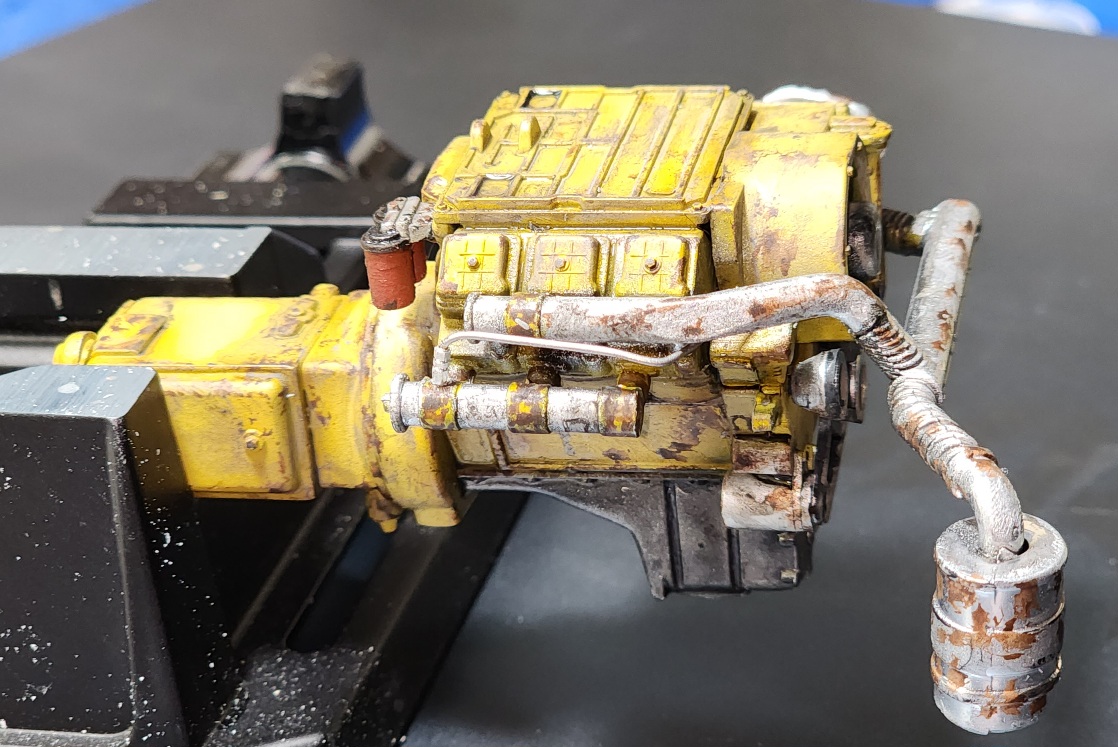

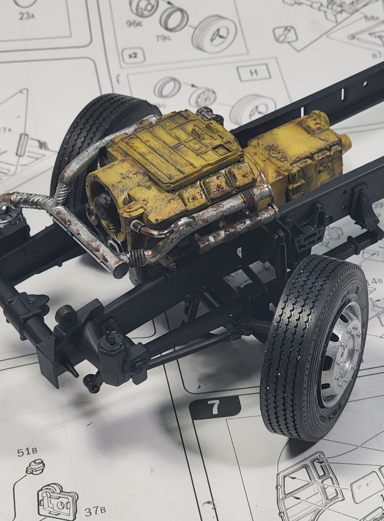

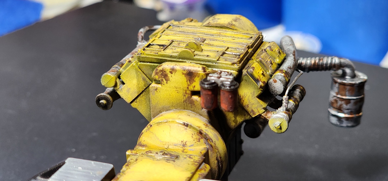

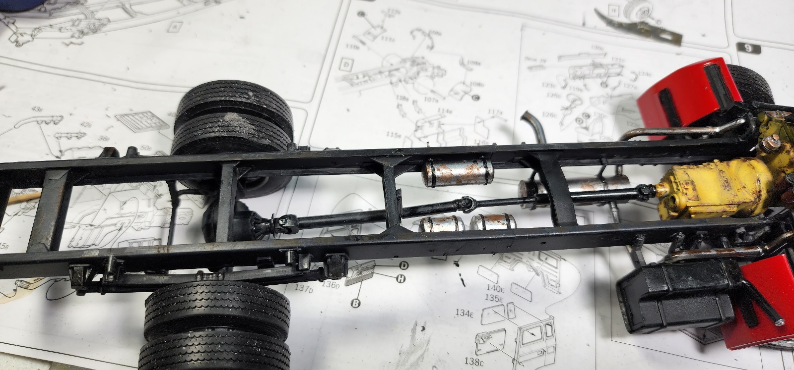

I found some photos of the motor. I have routed some lines to what I can obviously see. There are some other lines that look cool, but end at nothing on top of the motor. Here is the motor so far.
And, that is where I am in the build. I will put the motor in, hopefully tonight, and go from there.

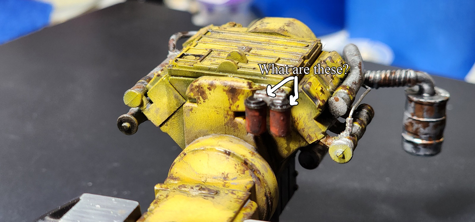

Fuel Filters I do believe.

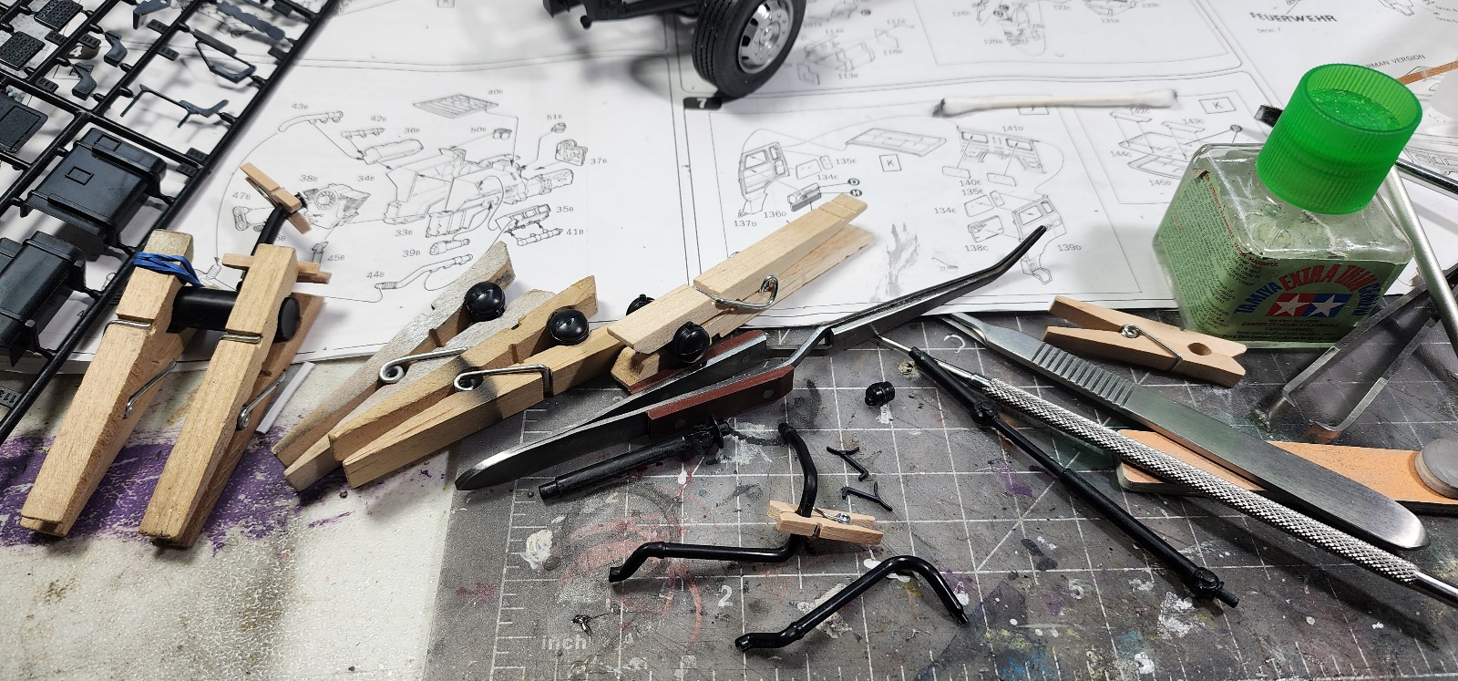

The front steering arms are in. Oddly enough, I had never heat set a pin. I used an old exacto blade and heated it with a candle. The front steering works:
This plastic is the softest I have ever dealt with and is a pain to make the seams go away without taking half of the piece with it. I may not carry Italeri any more. Anyway, I have a lot of pieces glued up for tomorrow.
Yes, I think those are fuel filters, and it's possible the engine is a Deutz V6. i've worked on a straightr 6 Deutz. They are air cooled, that's the fan on the front of the engine.

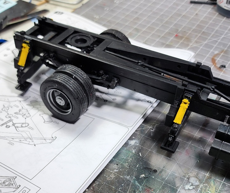

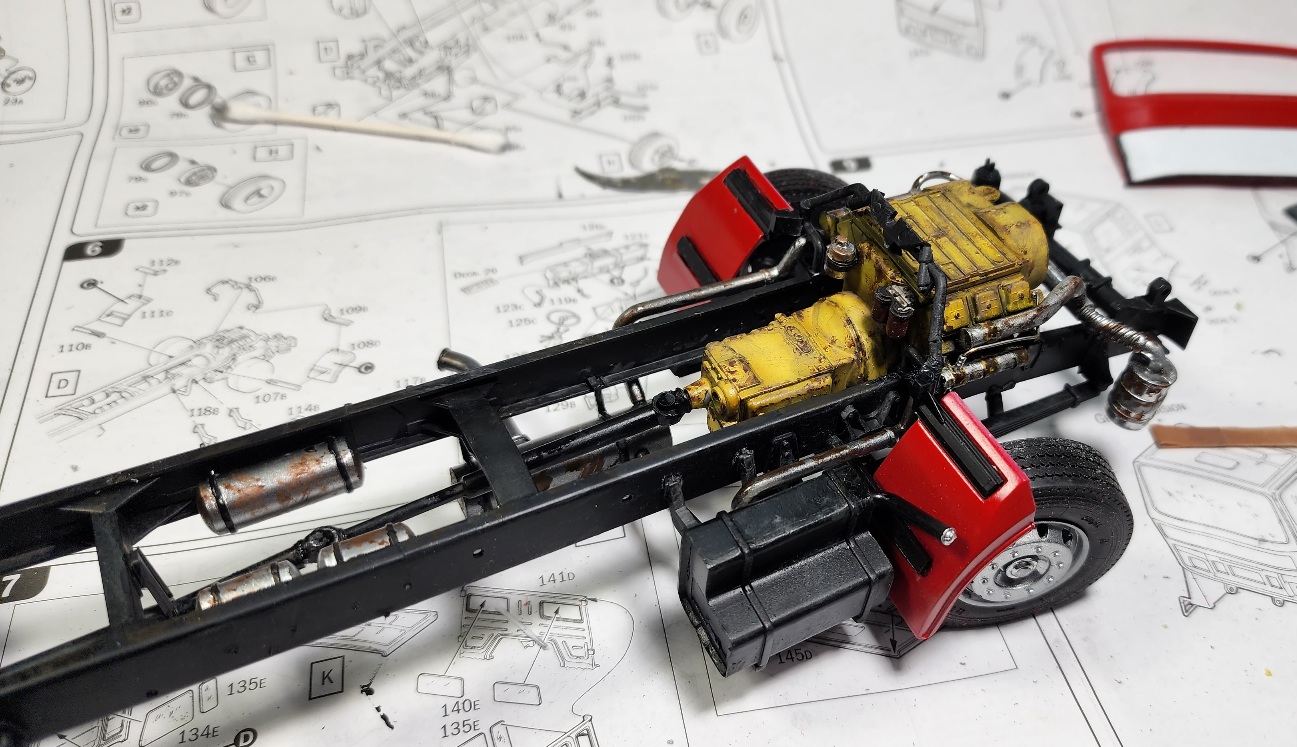

Chassis is done, I think. It is not perfect, despite my best efforts. The tires scrubbed on the right side fender. Not on the left. I trimmed the fenders to match so that neither side scrubs. Where butt joints were called for, I tried to drill and reinforce with a metal rod, to hopefully make it stronger for childs play.

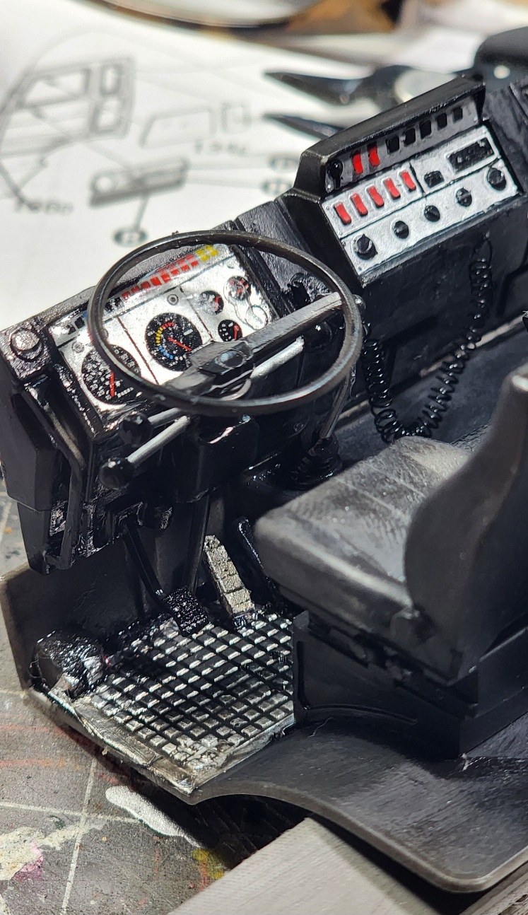

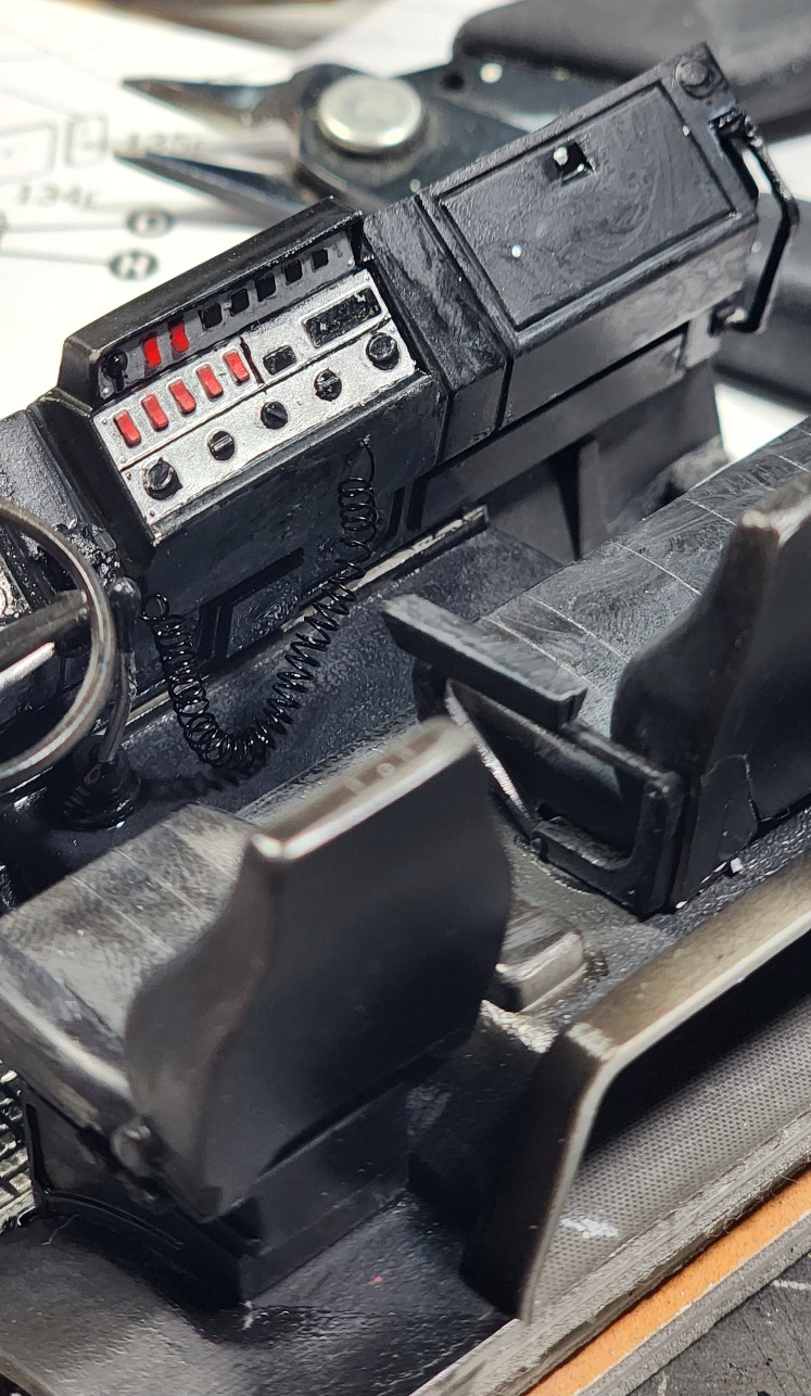

Cab interior. For the speedometer panel I used clear UV resin to create the glass. I painted the interior semi-gloss black, then weathered with Vallejo "engine grime " drybrush to simulate wear and dust. It is my overall "dust" go-to and it is fairly effective. I added the accelerator pedal with styrene and painted a mixture of Vallejo Metals "burnt iron" & "gold". The "CB" Mike if styrene for the talk box and the cord is extra fine black fly tying wire wrapped 30 times around a small rod, the CA glued into place. The steel plate floor board is Matte Aluminum Bare Metal Foil then a black wash added.
Overall, I think it as close as I can get to the Clarkesville FD interior.

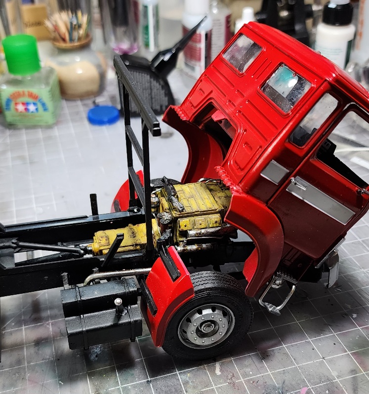

I got the cab put onto the chassis. At first I misread the instructions and glued the bumper to the cab. Hmm, for some reason, the cab would not tip to reveal the motor.
...look again....OOOOH, The bumper glues to the chassis! Much better.

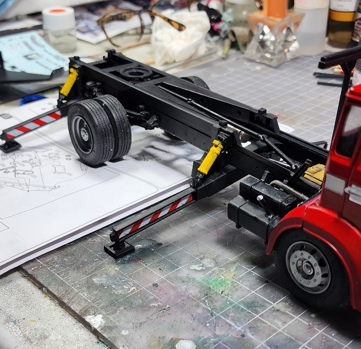

The stabilizers are installed but not weathered at all.
They retract, but, without some sort of stop, they come all the way out of the sleeve when extended. I may need to figure out a stop for them or Griffin will get frustrated.

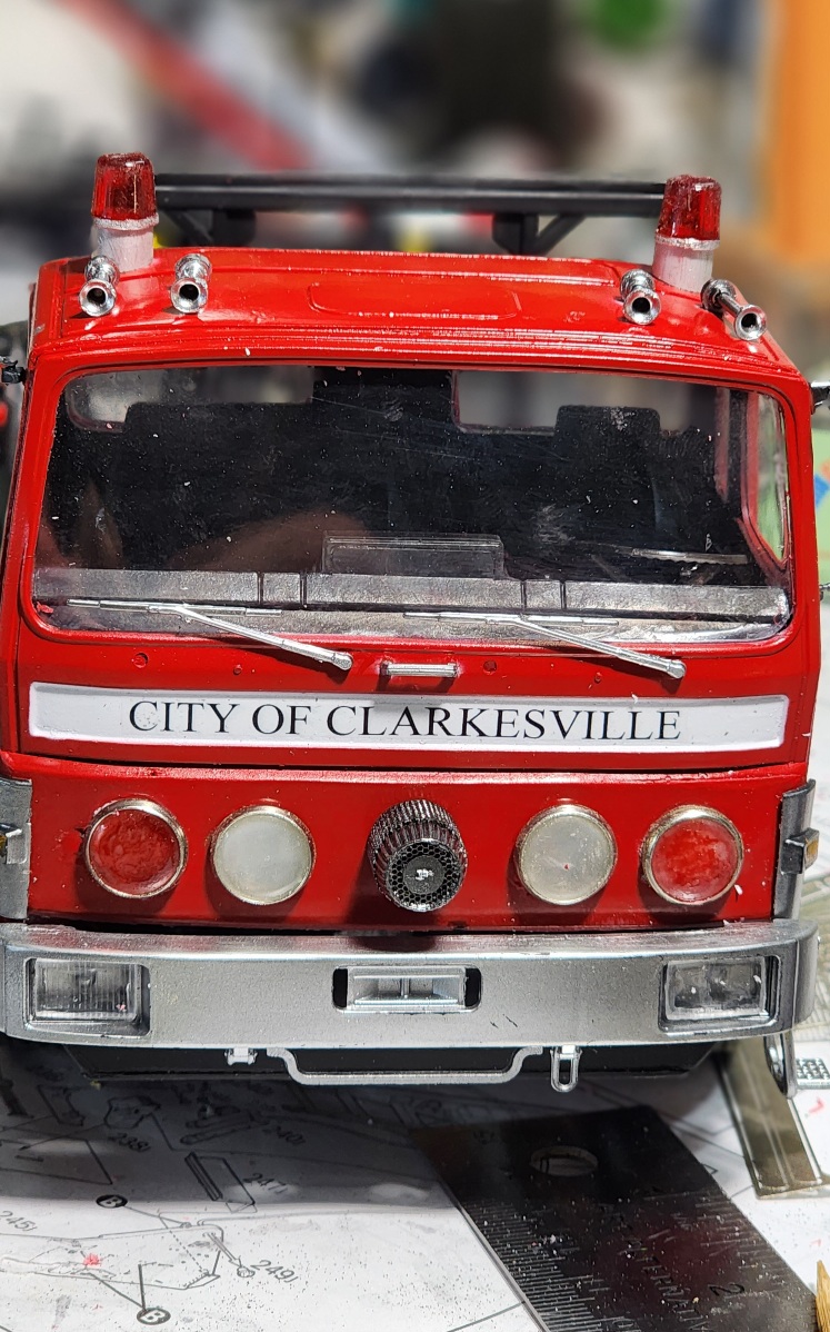

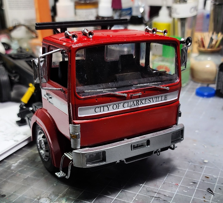

My decals did not turn out well, except for the "City of Clarkesville" along the front (because it is applied to a white background). I tried painting the decal sheet white, then printing. Also epic fail. GATOR! Help!

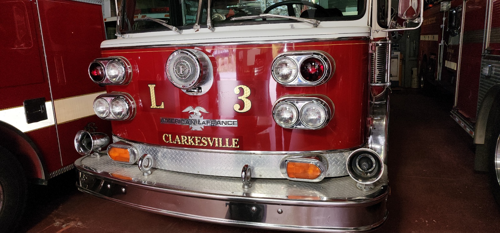

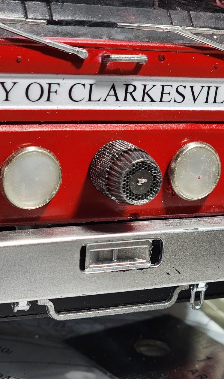

As for the rest of the front, here is my reference:
And here is how I dealt with it...
The centerpiece is some kind of cable TV fitting, dolled up with some PE pieces for a Ford Mustang. The "F" is from the word "FORD" and the screening is from the "grill". The headlights are opal snap buttons used in sewing. I sanded the backside flat and CA glued all in place. I am content with it.

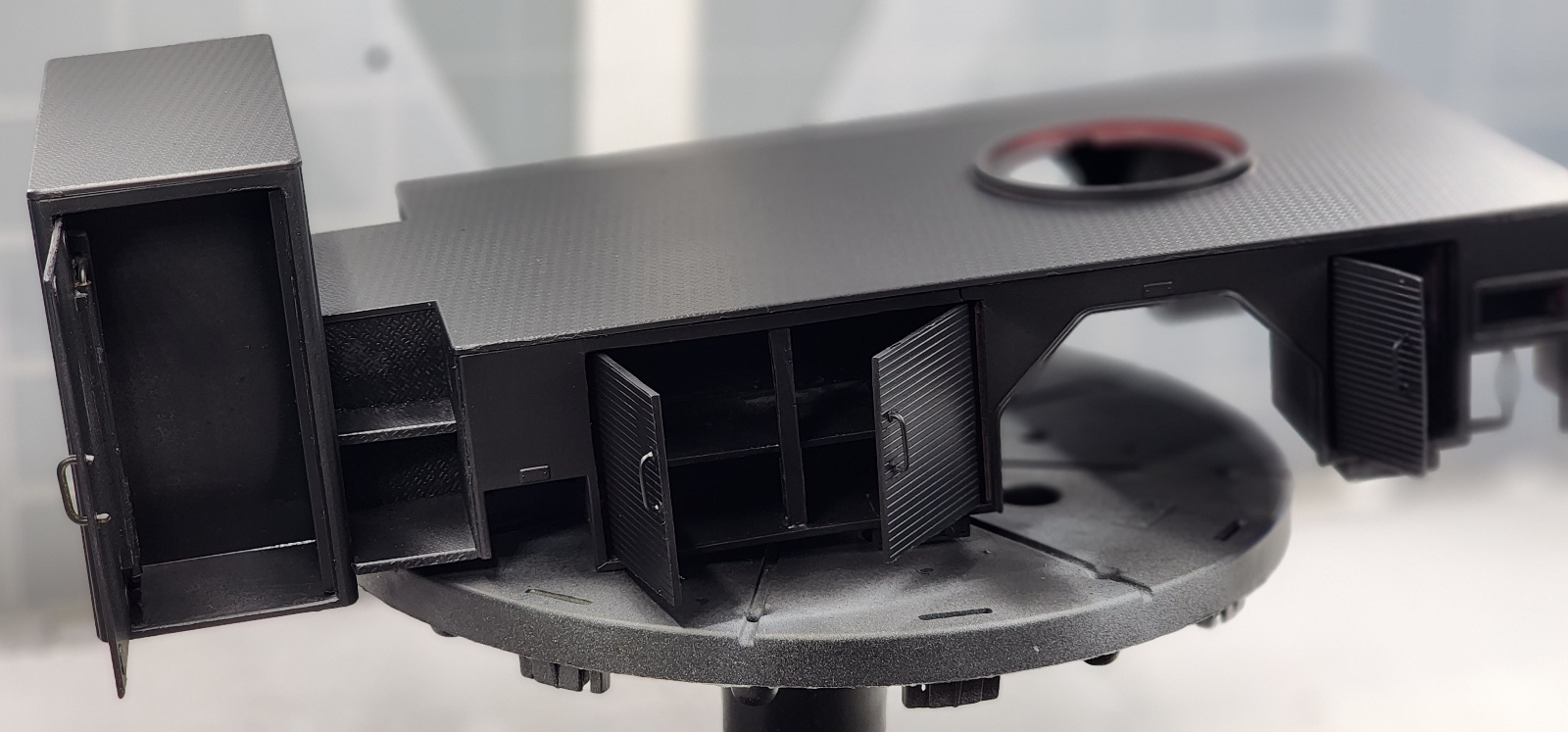

I also got the rear deck assembled, and yes, I opened all of the doors and put shelves in the compartments, and it was way less of a big deal than expected. The compartments were there, why not make use? The doors were meant to be roll-ups, but they ended up hinged. The wide doors were cut in two. I have it initially primed in black:
Not pictured is the door for the gas tank access, which became a pocket door and levers up then slides back into a pocket. I will get a shot of it soon.
